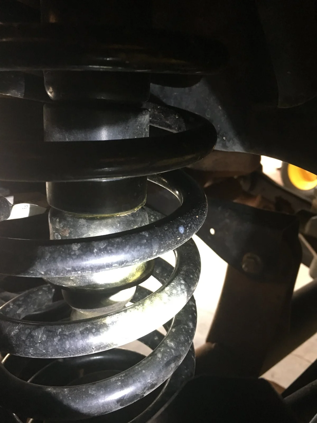

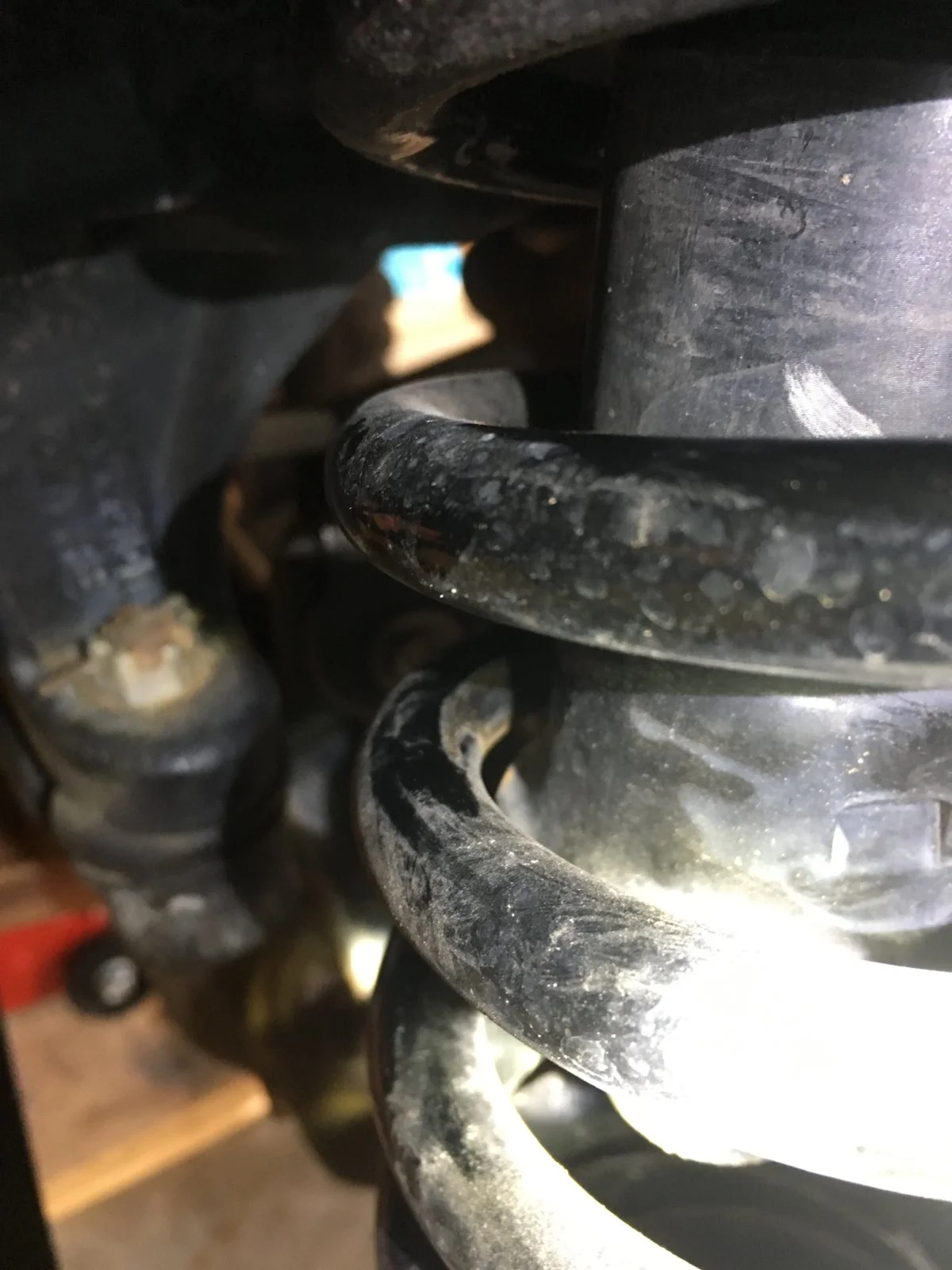

Check this out.
Drivers side bump stop cup rubbing OME spring
Passenger side is clearing fine
That's what 1 1/16" shift of axle will do. Not good hurry up trackbar!
Wow! That is surprising your front axle shifted that much. Mine only shifted about 5/8". Make sure you coil spring is seated properly in the coil buckets. When I added coil spacers to mine the coil spring was shifted bit and hitting the coil bucket frame. Made a annoying rattle till I could figure out what it was. Not that this is related in any way to your DW.
