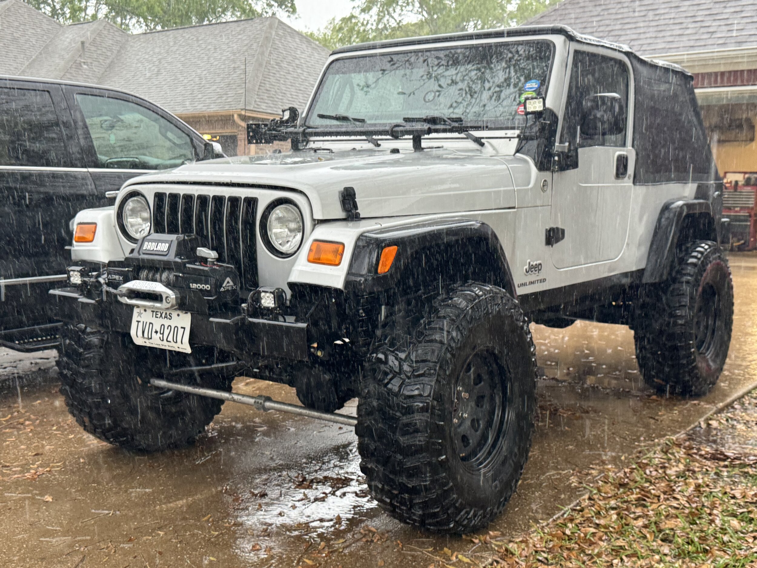

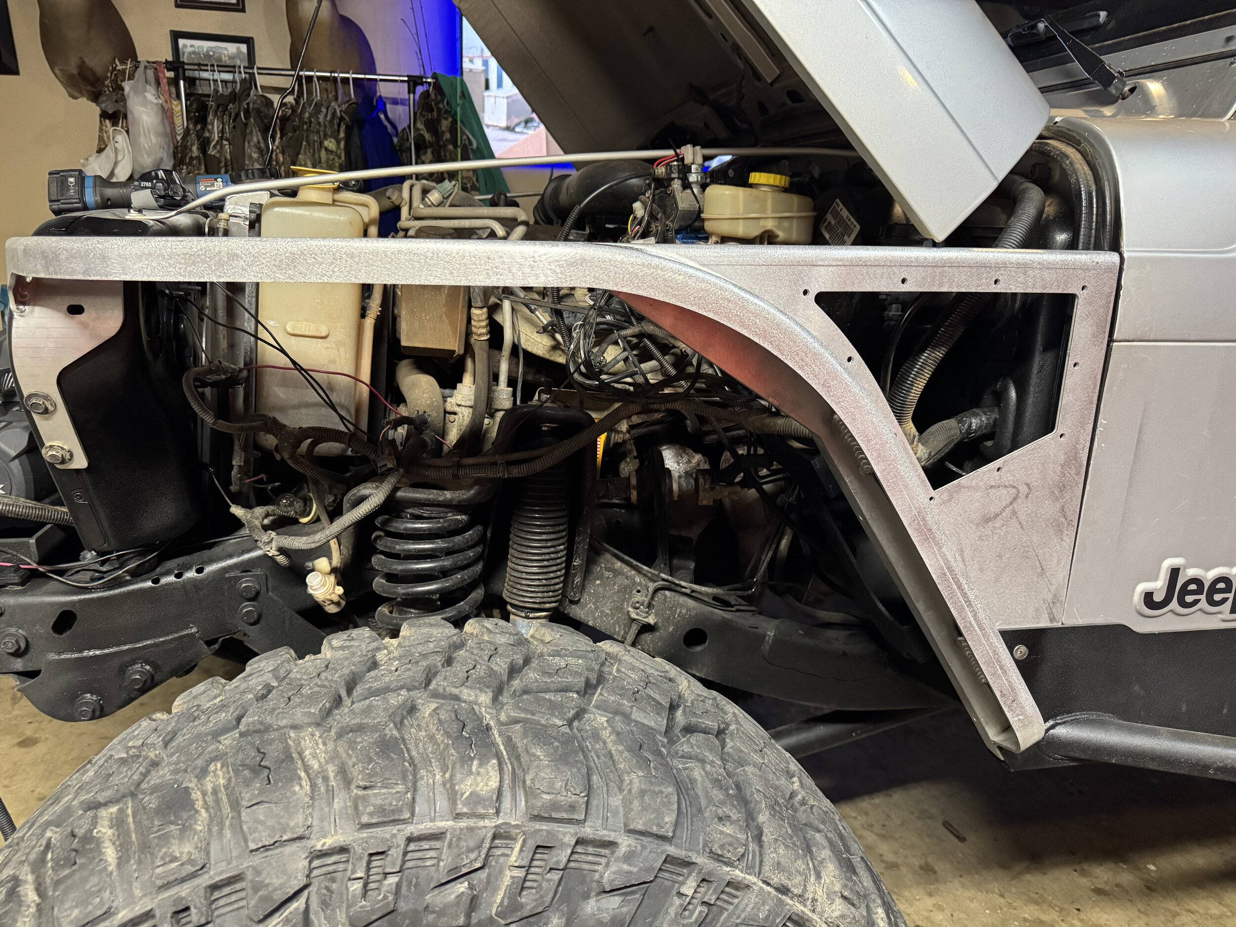

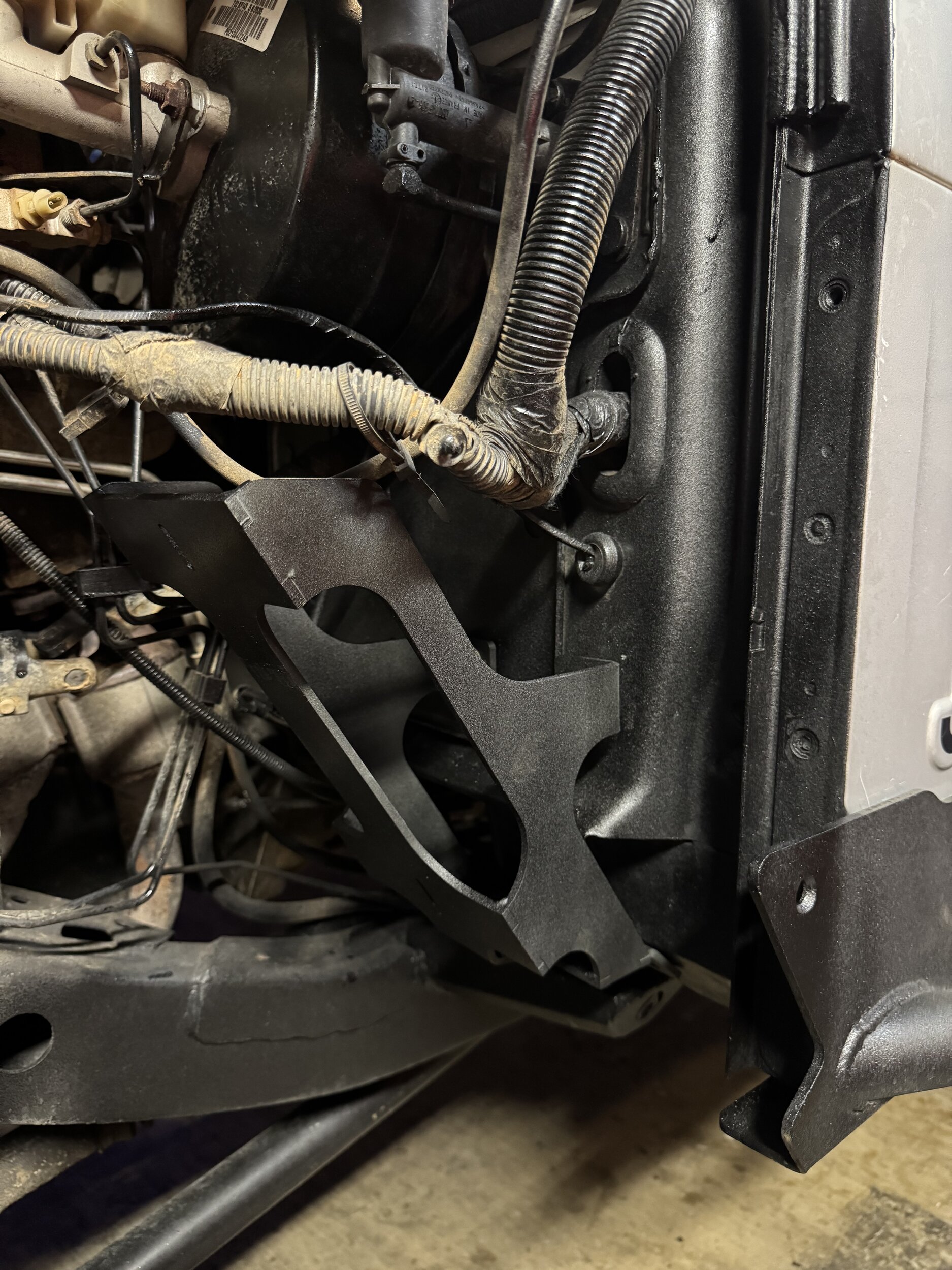

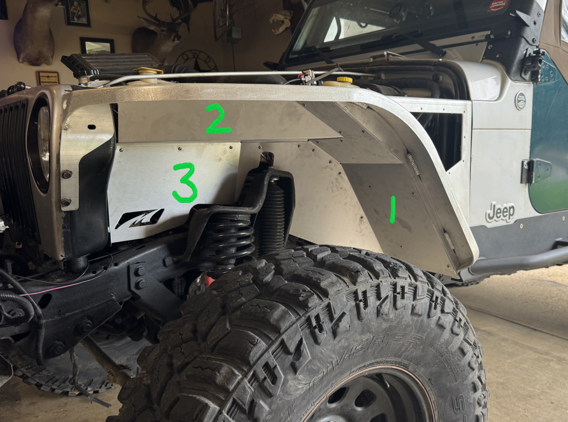

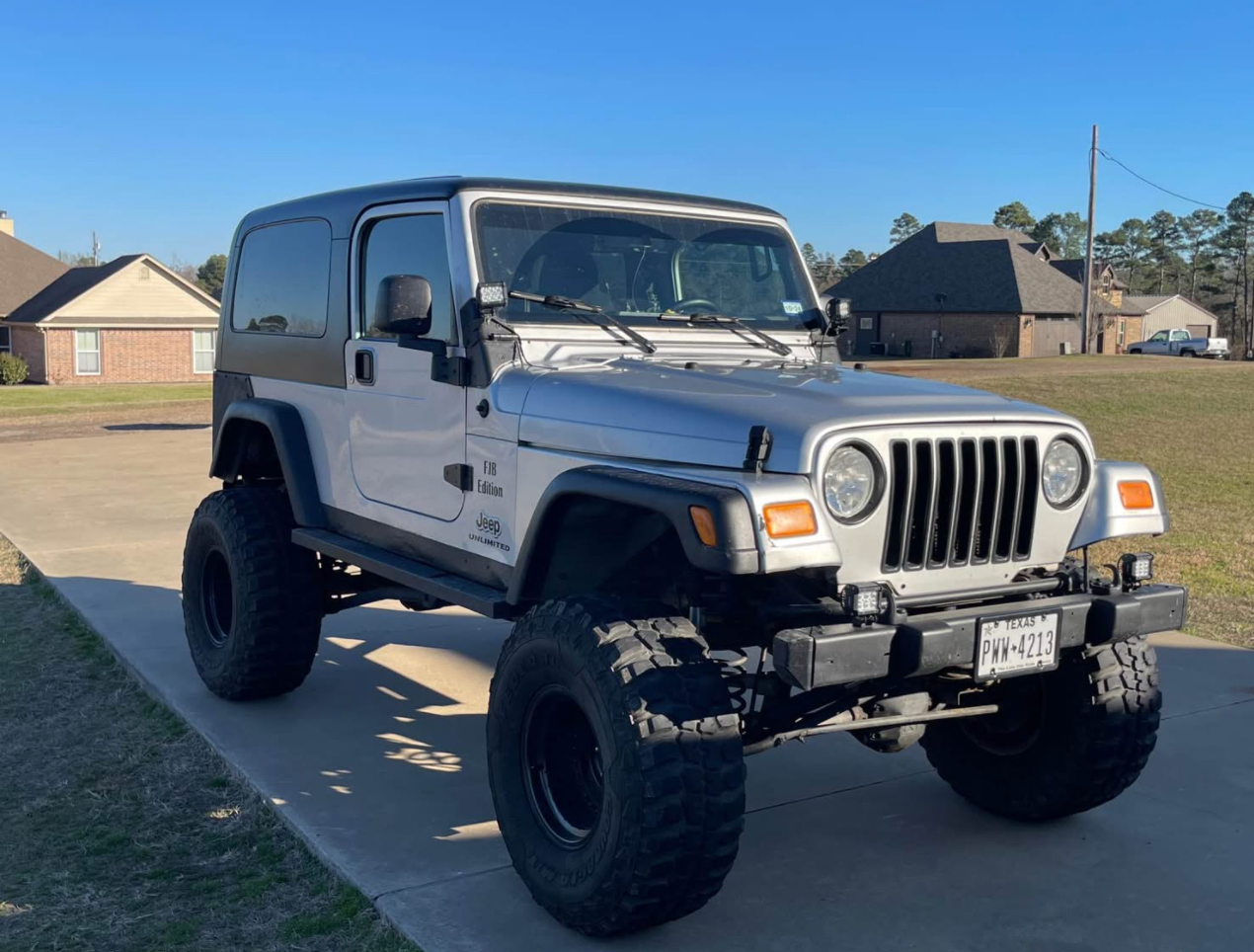

The holidays and the weather have slowed me down, but I need managed to check the box on another small project. I was gifted what I think is a Quadratec QRC Front Bumper. Maybe not the most high-end option. But certainly, an upgrade to the stock bumper I was running.
I didn't like the look with my Motobilt Highline Fenders so I took a cutting wheel to the bumper and made some slight mods. I am partial, but I think it came out great. See before and after pics.
Next on the list is replacing my stock fuel tank with Motobilt's 19 Gallon Fuel Cell. Then, I bought front and rear JK Rubicon Dana 44 axles that I will plug in.

1000x better!!! Looks good!

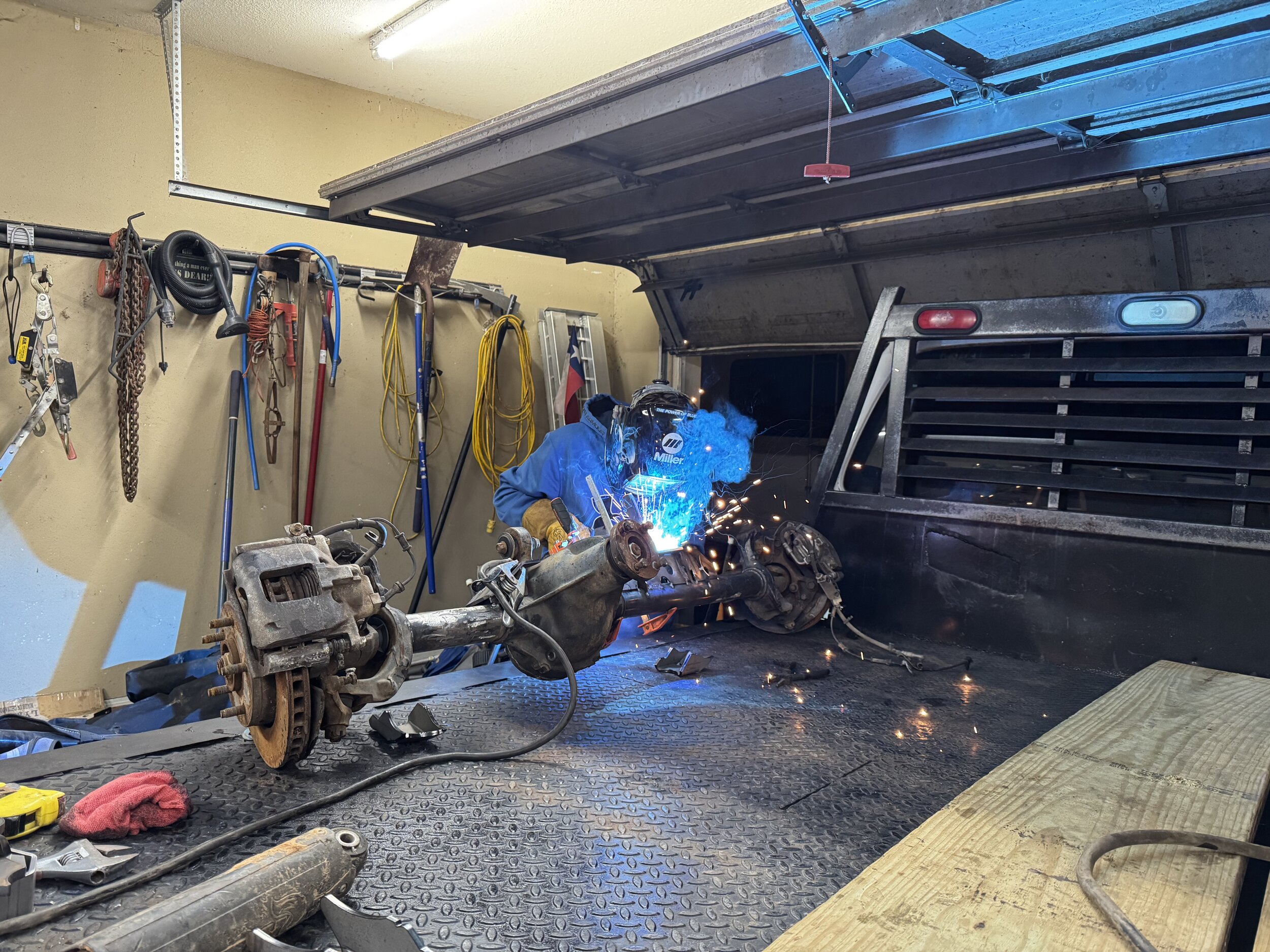

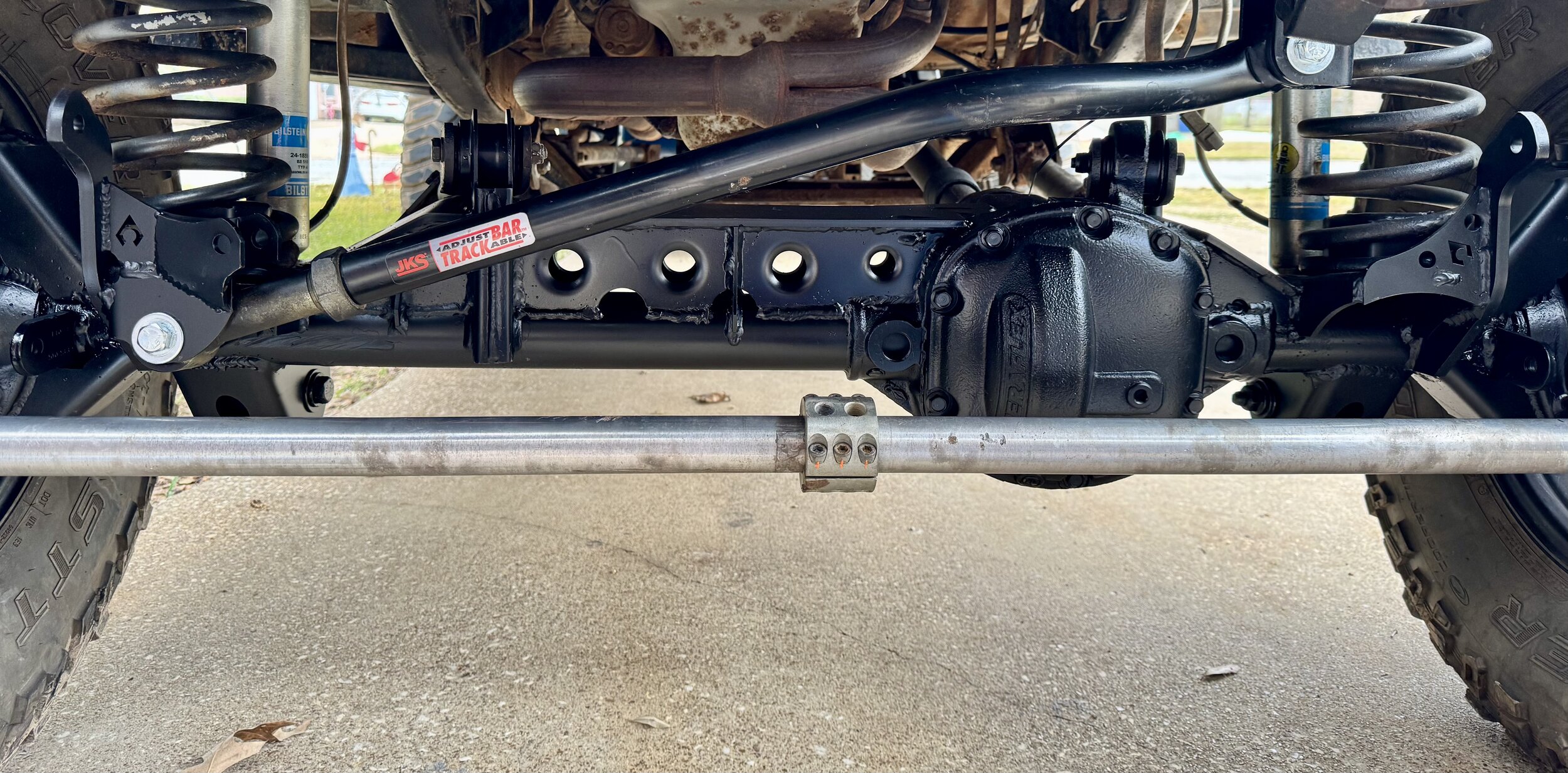

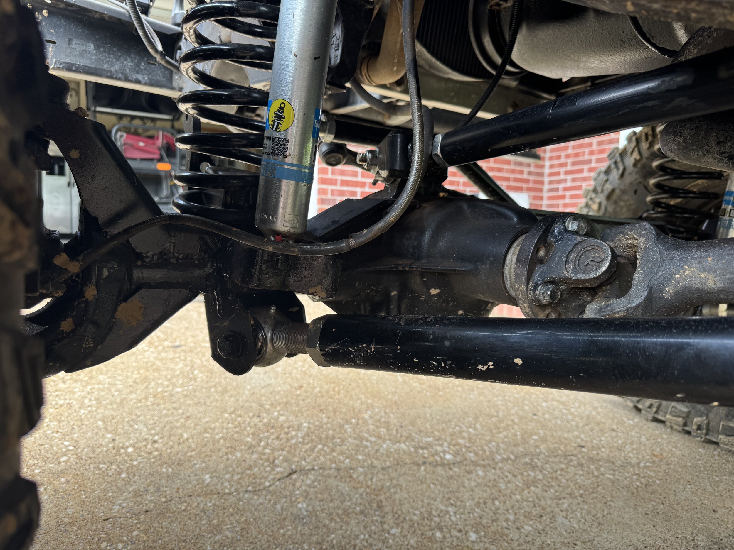

Next up, JK Rubicon Dana 44s with 5.13 Yukon Gears, Yukon Chromoly Shafts, Poison Spyder Diff Covers, Front is Trussed, Sleeved and Gusseted, Rough Country HD Ball Joints, HD Tie Rod Ends and a Power Stop Big Brake Kit.

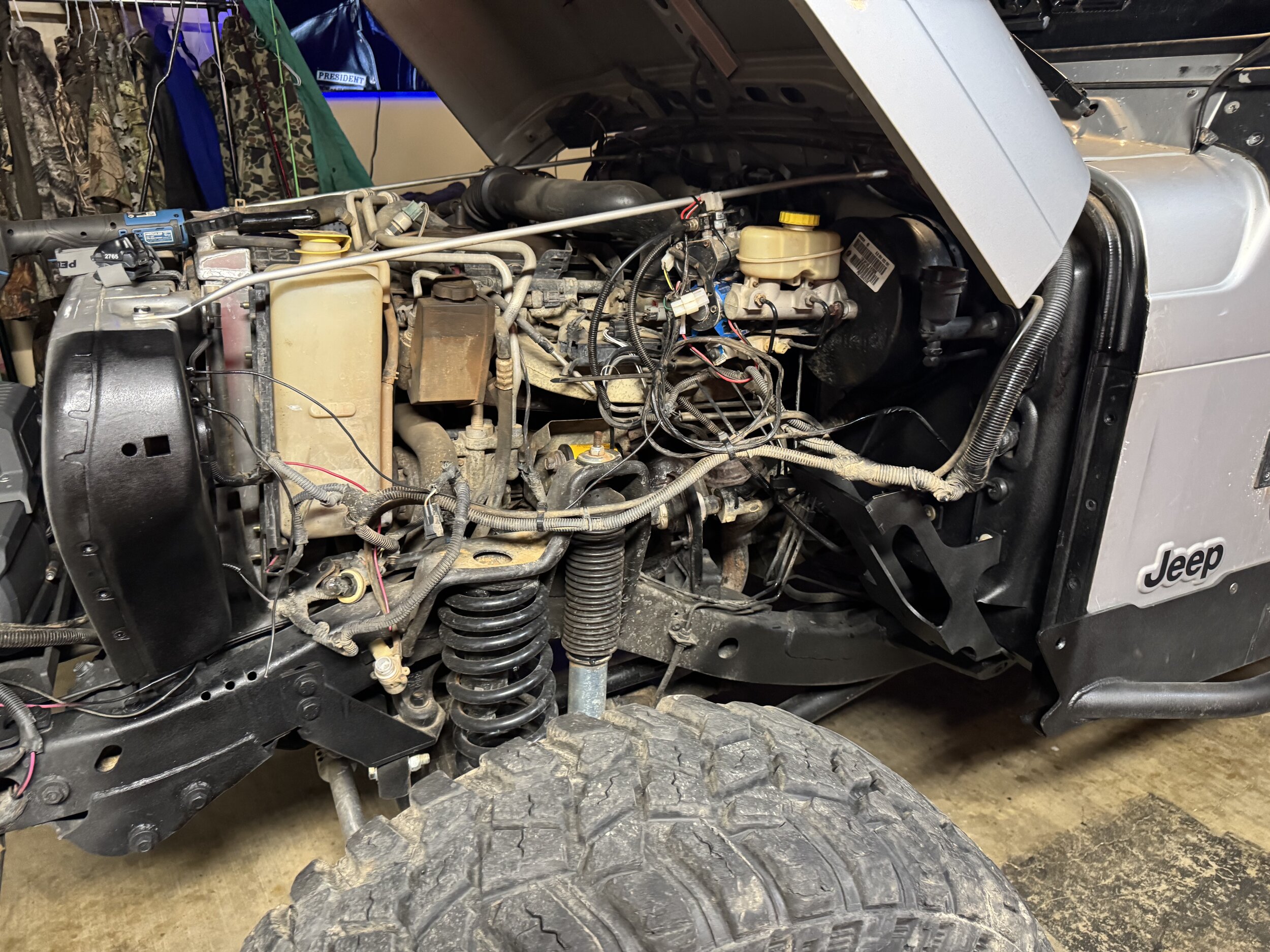

The LJ has developed too much dead space in the center of the steering wheel. Playing around on the rocks, it doesn't matter. But, it's dangerous to drive on the road.
Looking over everyone's advice on tracking down the culprit(s), I found the Lower Steering Shaft Support Bearing needed replacement. Apparently, they are notorious for poor design and eventual failure. The stock bearing was well past its lifespan.
I upgraded to the aluminum Borgeson design https://www.borgeson.com/tj-shaft-support-bearing-97-06
Also, I found conflicting opinions on the M.O.R.E. Steering Shaft Riser Bracket, but I figured it couldn't hurt. I have a 3.5" suspension lift, 1.25" body lift and 1.5" engine mount lift. It makes sense that the new bracket would help keep angles correct. https://www.quadratec.com/products/12590_042X_PG.htm
You can see big differences in the pics between the old and new parts.
After the install, the steering is mildly better. But, not good enough.
The u-joints on the steering shafts seem to be tight.
There is a lot of play inside the steering box. Moving the shaft by hand it is not tight at all. I assume adjustment would be a temporary fix at best. Looks like purchasing a new steering box is next.
Update to the steering dilemma. The problem was the steering gear box.
Not a surprise with a 21-year-old vehicle with 132K miles.
The first pic shows to two sets of marks. The yellow marks indicate how much play I had before replacing components. The red marks indicate how much play I had after replacing the lower steering shaft support bearing.
The new box from Detroit Axle has zero play and makes a huge difference.
