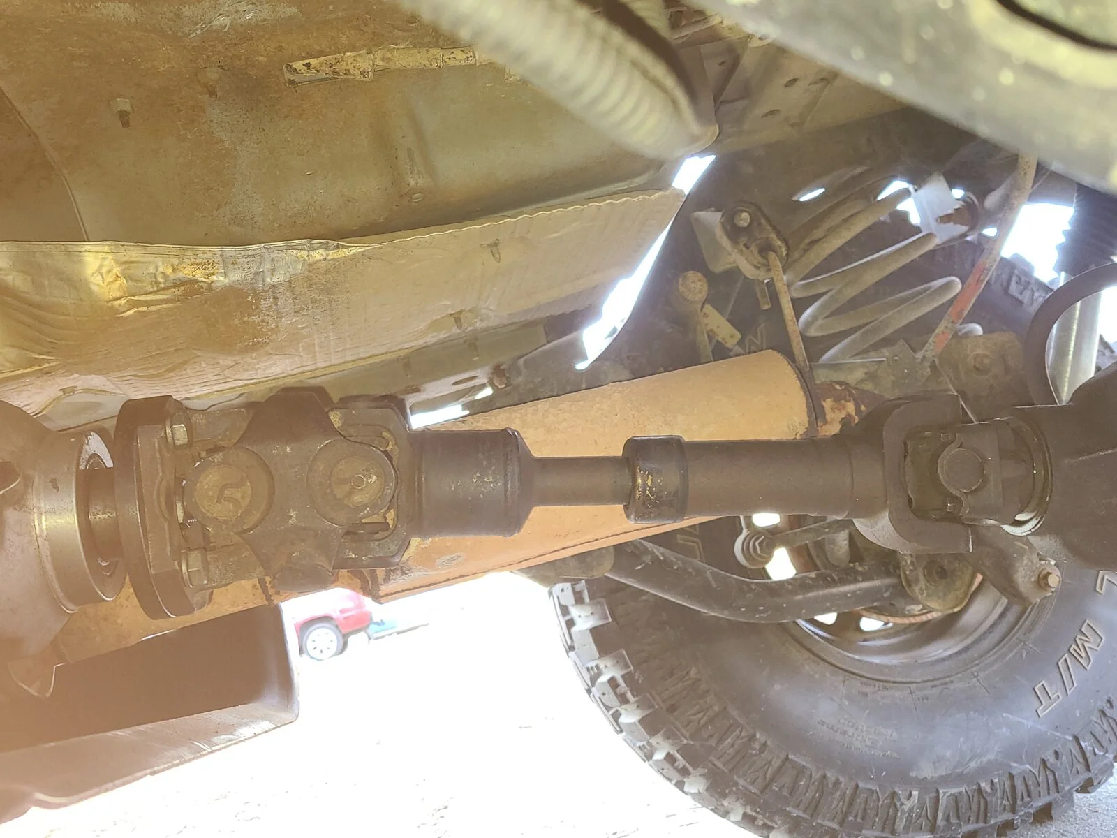

As the guys above stated, super short SYE. My guess is also JB Conversions. It has to be either them or Teraflex. I think both companies have changed the design slightly in the past few years so the yoke you have does not look like the the same yoke you'd get if you ordered the same thing now. The good news is that yes you indeed do have an SYE and all you need is a regular old double cardan drive shaft. Make sure to get a custom length though, because you have the super short SYE the standard length shafts (which are made for standard SYEs) will be about 3 inches too short.
