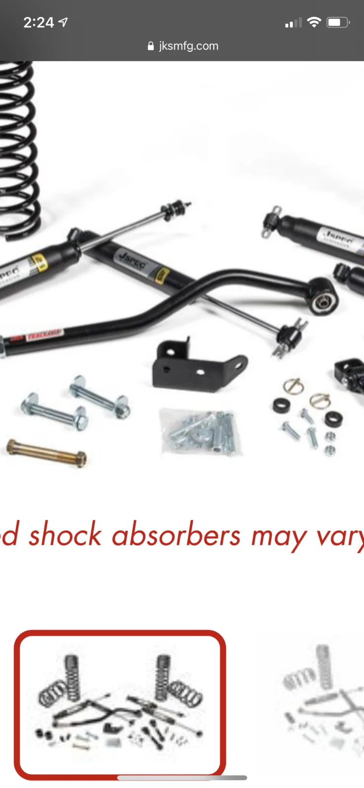

Can anyone tell me if the track bar relocation bracket that came with my JKS lift angled appropriately for a tummy tuck? I have an adjustable track bar in the the bracket right now. Just not sure if I will need to swap out the bracket. Thanks
I have been using the same TB bracket on mine w 3.5” and 1.5 drop skid for a Time without issues. The TJ also use to have on w 4” of lift and 2” drop skid and never an issue either.
