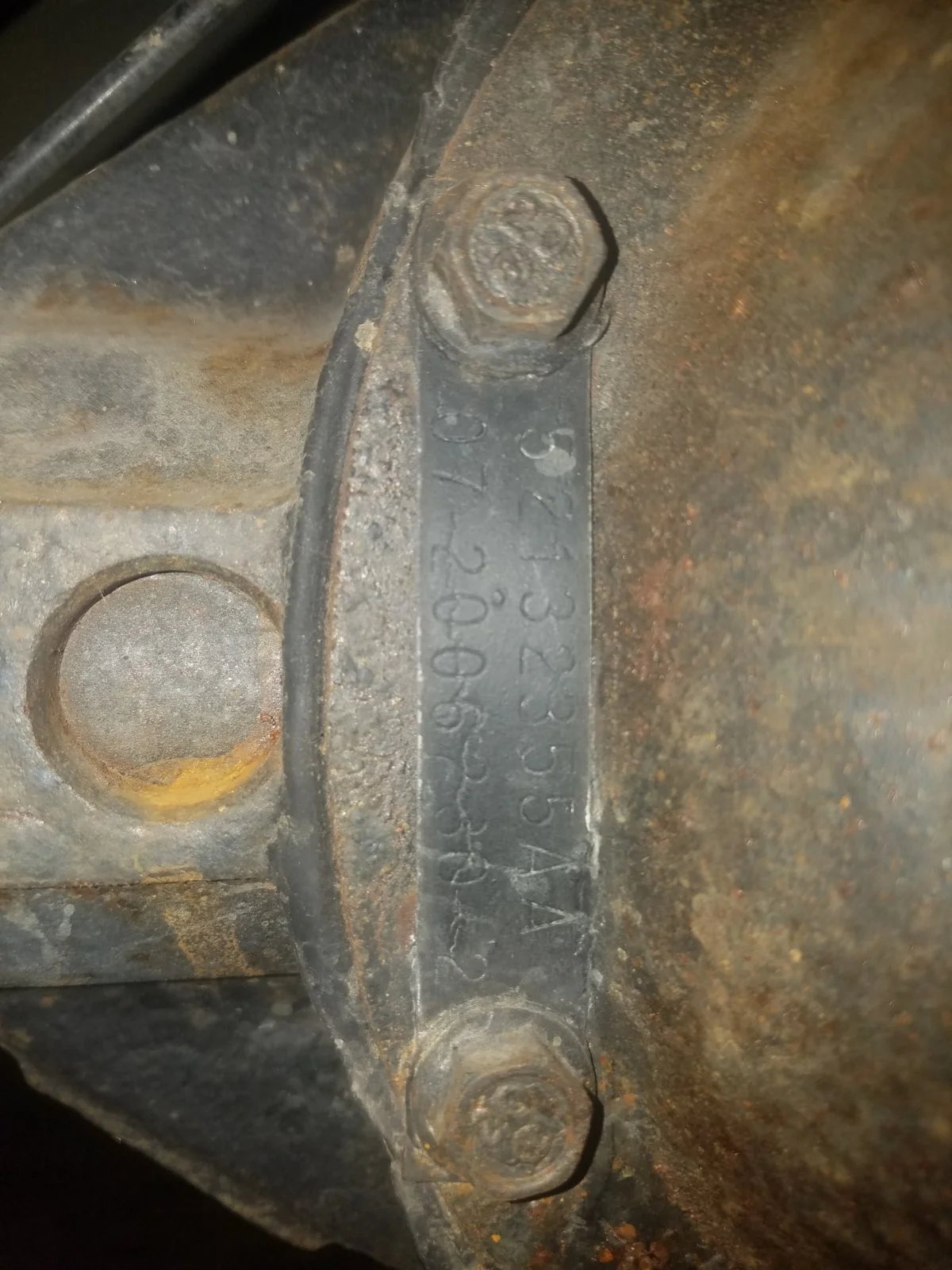

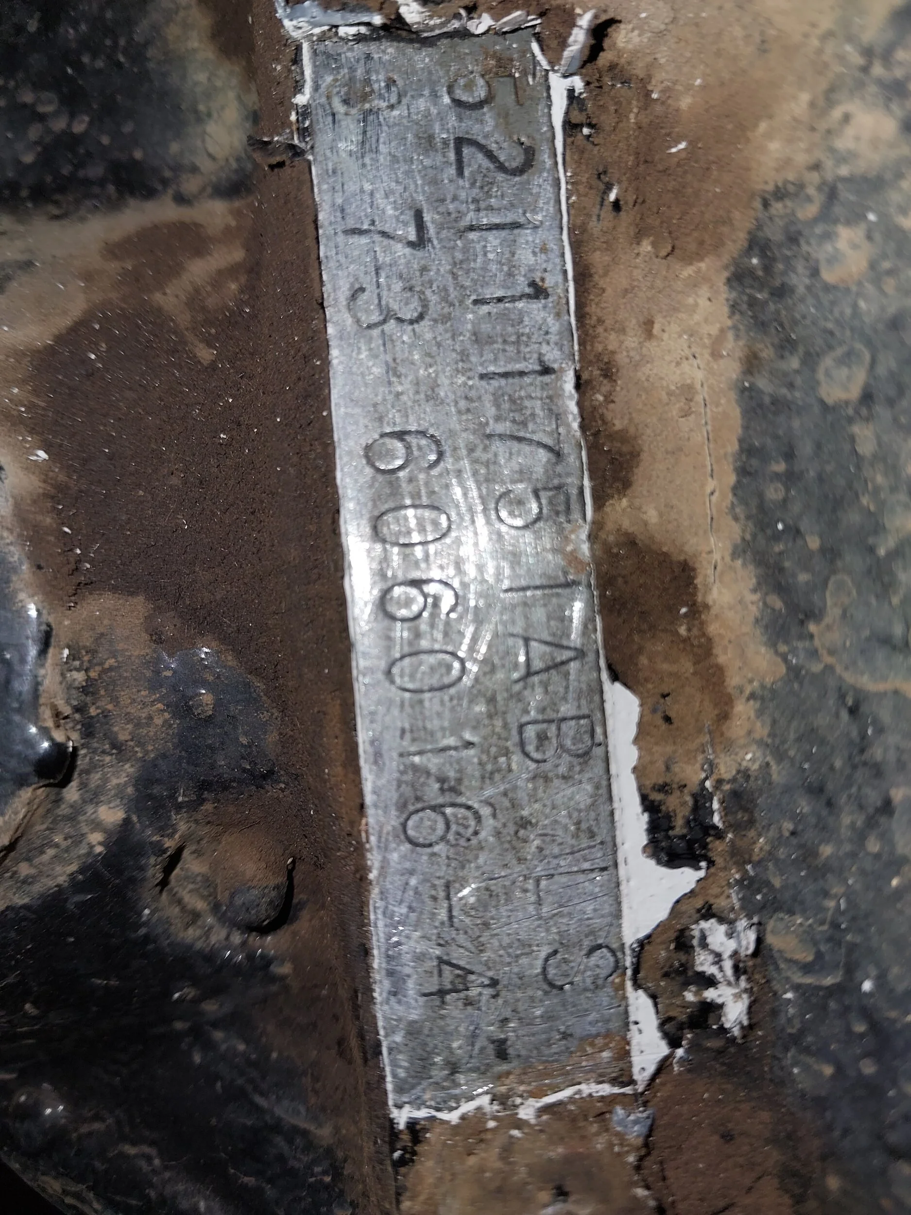

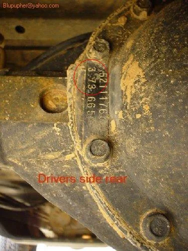

Since it's a Export model I would crawl underneath first and verify what gears you have. There should be a tag on the diff cover that looks like this.
This is how you decode what it says.
https://www.differentials.com/technical-help-2/differential-identification/
This way we make sure you don't get the wrong information.
Reactions: Jerry Bransford
