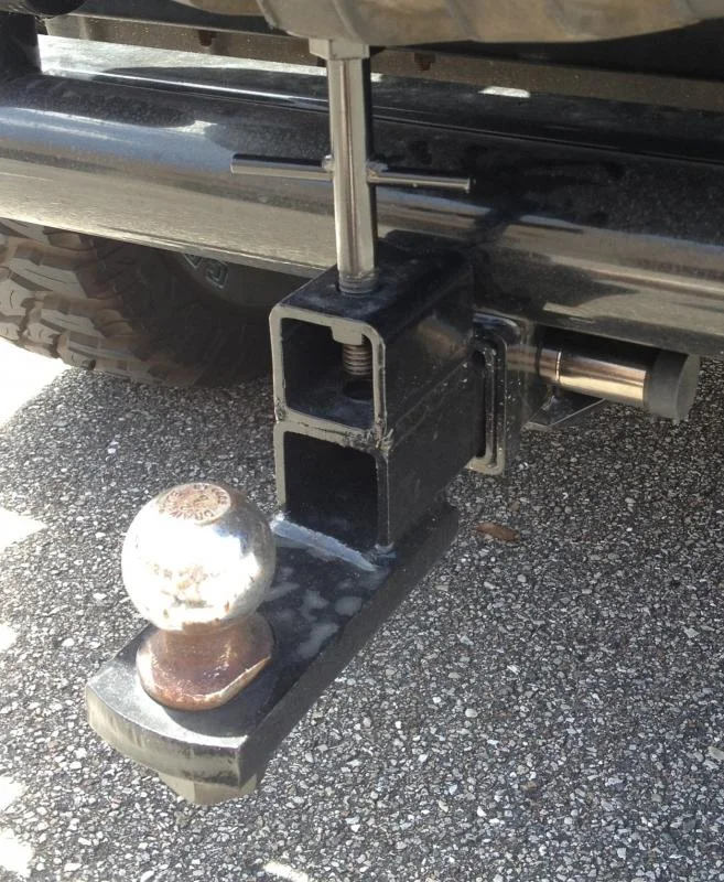

Do you happen to have a hitch receiver on your bumper?
Before I had ever read Blaine's post about his wife's 35s on her tailgate, and before I bought a bumper mounted carrier, I made this. Everything I read on the forums cautioned me about putting anything heavier than a stock tire on the tailgate. I never used it off-road, but if I had a I probably would have put a ratchet strap around it and the tire to secure it.
Cool - so l9oks like a pice of threaded stock with nuts to tighten and set hight?
Yep, just a large bolt with two "handles" welded to it and threaded to a nut welded to the inside of the hitch.
