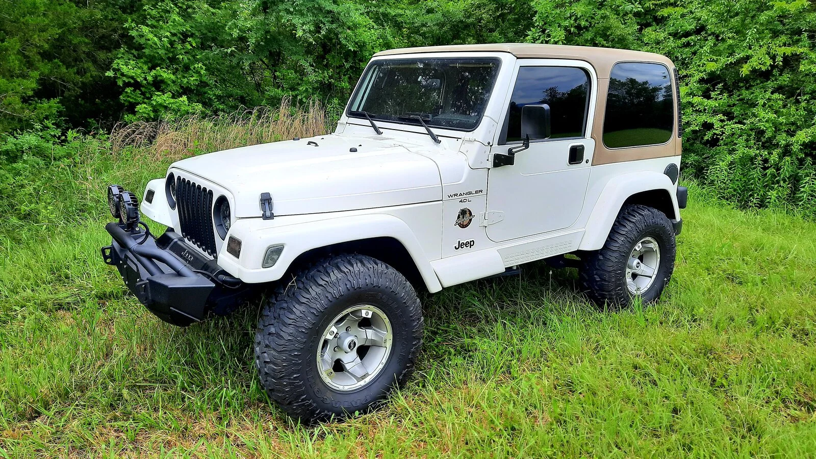

I'm running 33x12.5x15's with a 2" BB lift. I ride in the woods and on mild trails with zero problems and no rubbing but I'm also not rock crawling, mudding or doing any serious wheeling. Here's a pic so you can see how it looks.
How much did you end up extending your bumpstops?
I don't have any bump stop extensions nor do I have any jounce bumpers. The suspension was like that when I bought it from the previous owner. I just added the new wheels and tires.
Its my daily driver so I don't beat the hell out of it offroad. I plan on a 3" suspension lift and a 1.25" body lift when funds allow so I'll set it up properly then. For right now, I take it easy and there's no problem with rubbing.
I'd be wwwaaayyyy more concerned about running those pantagnoia's 🥺...or however the hell they're spelled.
The Jeep looks good though and I dislike white on a Jeep. Still looks sharp!!!
Thanks. I'm not worried about the tires at all, as a matter of fact, I love em. Ive had them for a year so far and they still ride smooth and just as quiet as the day I put them on.
I know there are a couple very outspoken haters on here who detest these tires but I haven't had a single problem with them and would highly recommend them.
