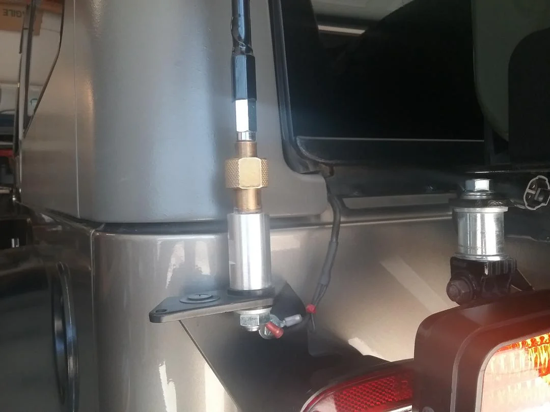

NMO mount using PL-259 coax connector with Larsen NMO-2/70SH dual band ham antenna

Midland GMRS antenna with NMO base:

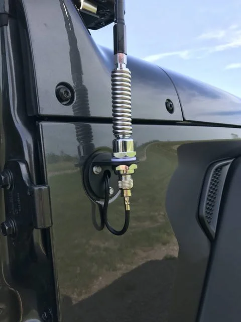

3/8" stud mount for CB antenna with typical coax connectors:
3/8" Stud Mount with Firestik CB antenna (ring terminals rather than PL-259 connector):
