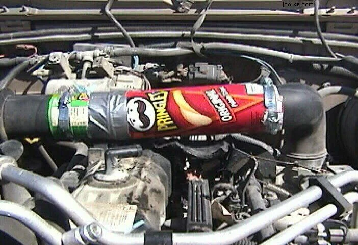

And paper can handle higher temps than most plastics. Just have to make sure the glue can handle it. The wall is a bit thin on a pringles can. Maybe try a carpet core tube?

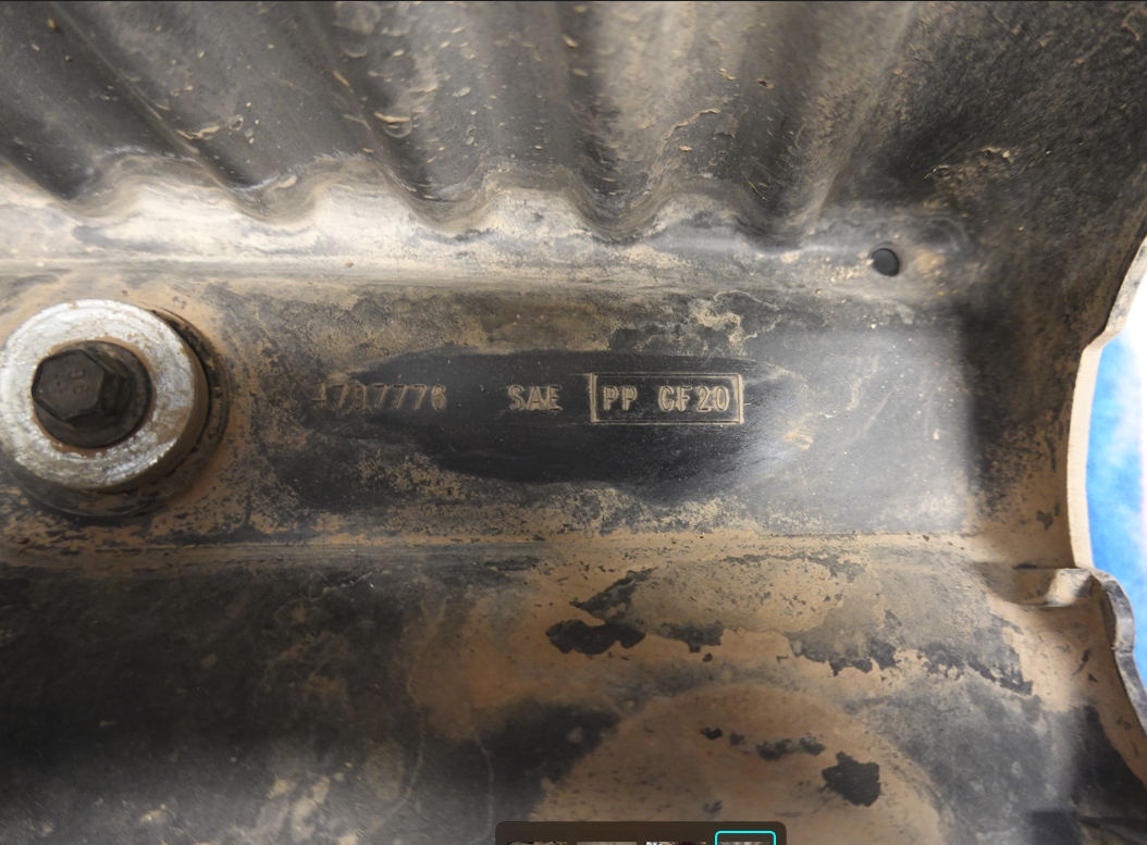

Per the 2-3 letter symbol they imprint on most plastics used in the automotive industry (and elsewhere), the air box is polypropylene.
https://en.wikipedia.org/wiki/Resin_identification_code
Ok, it's 20% carbon fiber, reinforced polypropylene. Probably why it doesn't like to play well with most glues or welding sticks.

If it matters, we were able to finally locate the same symbols on the lid to the air box and then the air horn. The air horn is just straight PP with no CF that we can find.

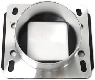

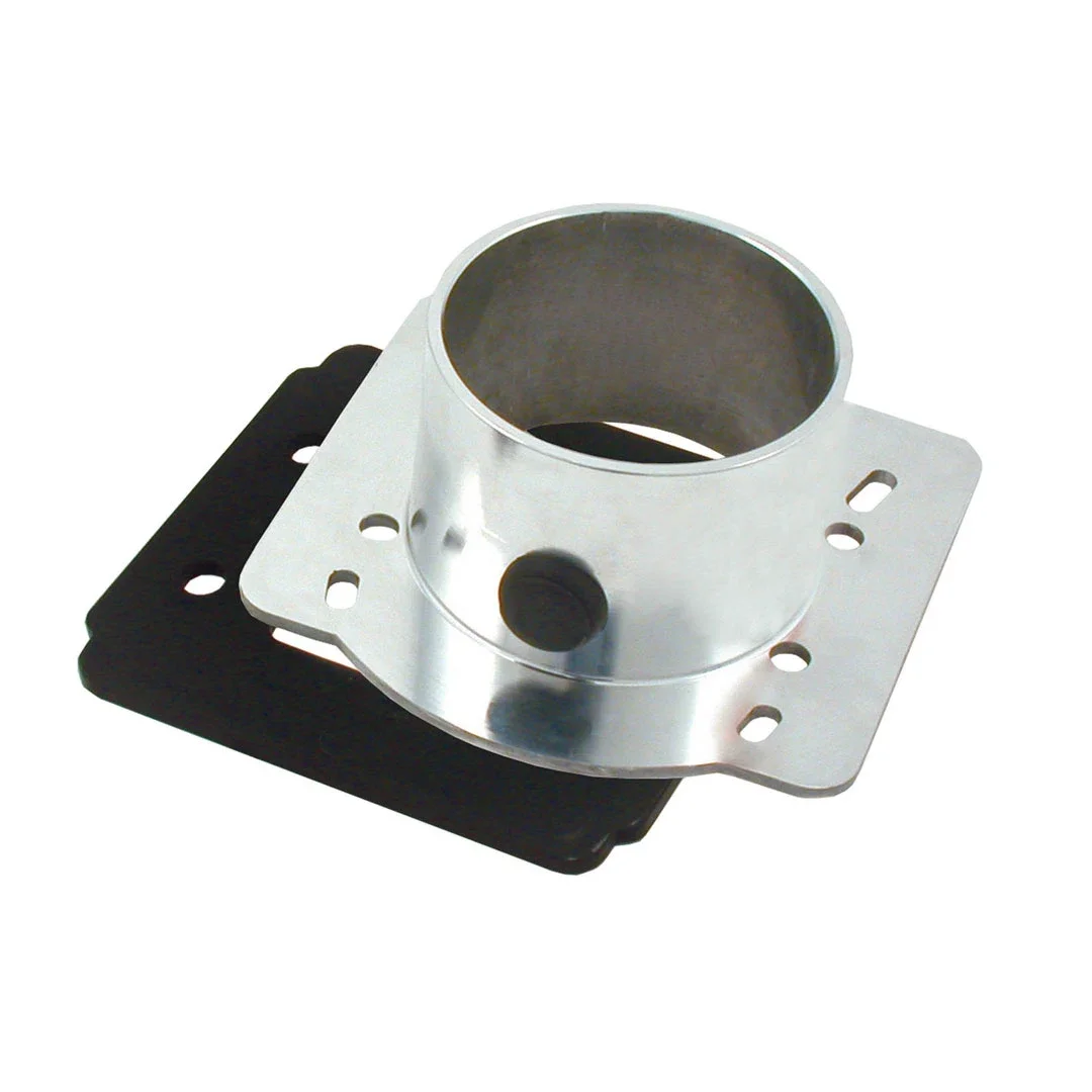

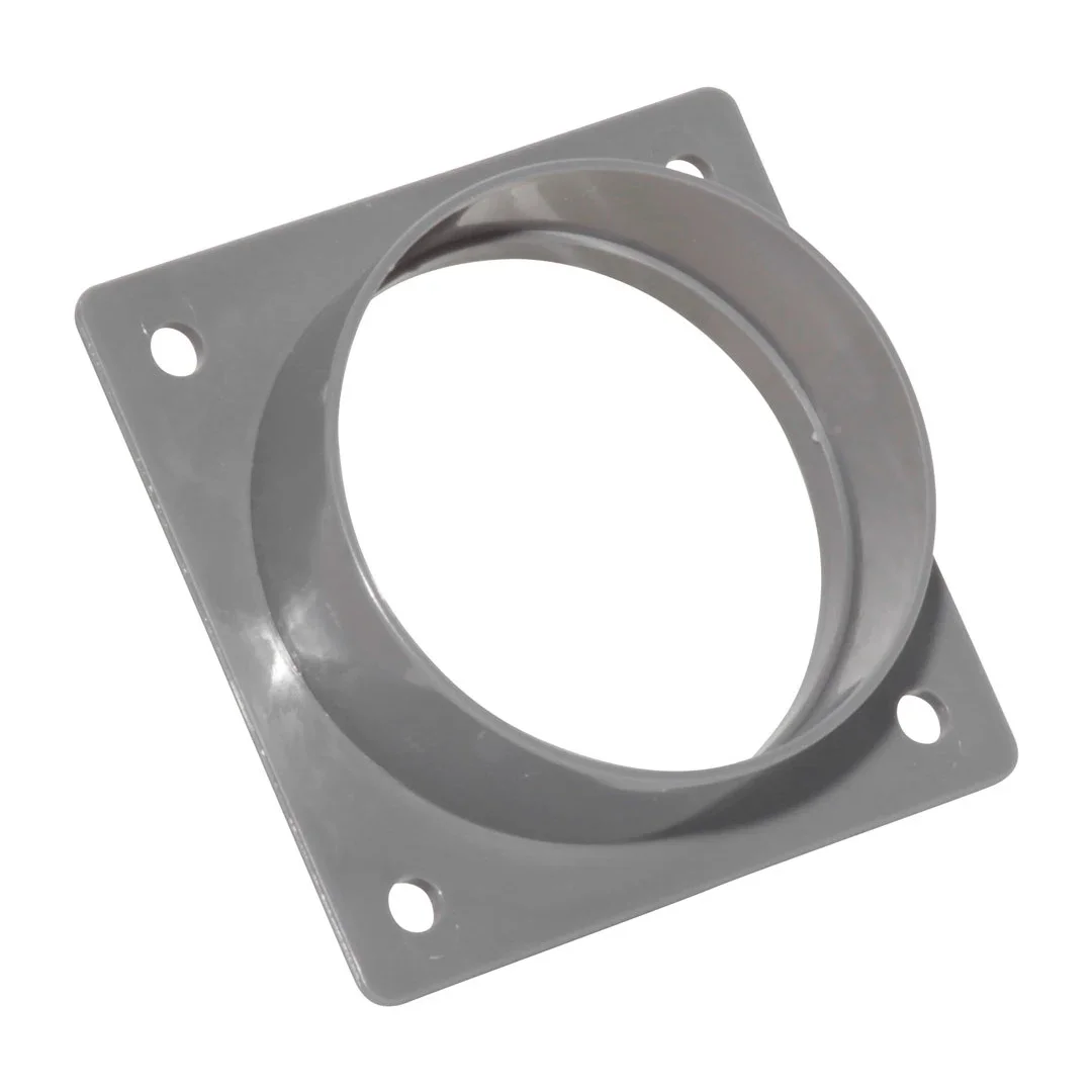

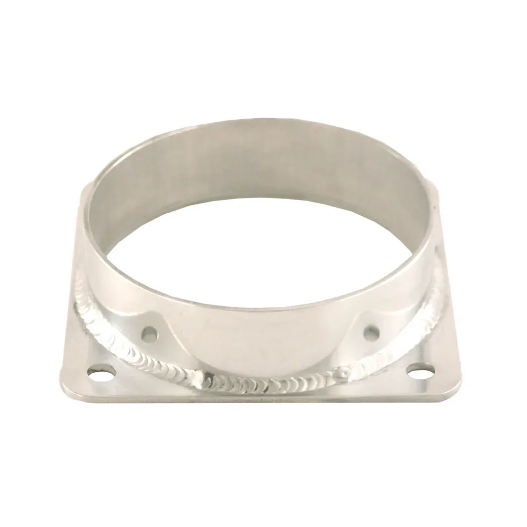

Looks like the Spectre Performance stuff is ABS for the 3" size
https://www.spectreperformance.com/accessories/8148-air-duct-mounting-plate
4" gets you the option of aluminum or ABS
https://www.spectreperformance.com/accessories/91489-intake-tube-duct-mounting-plate
