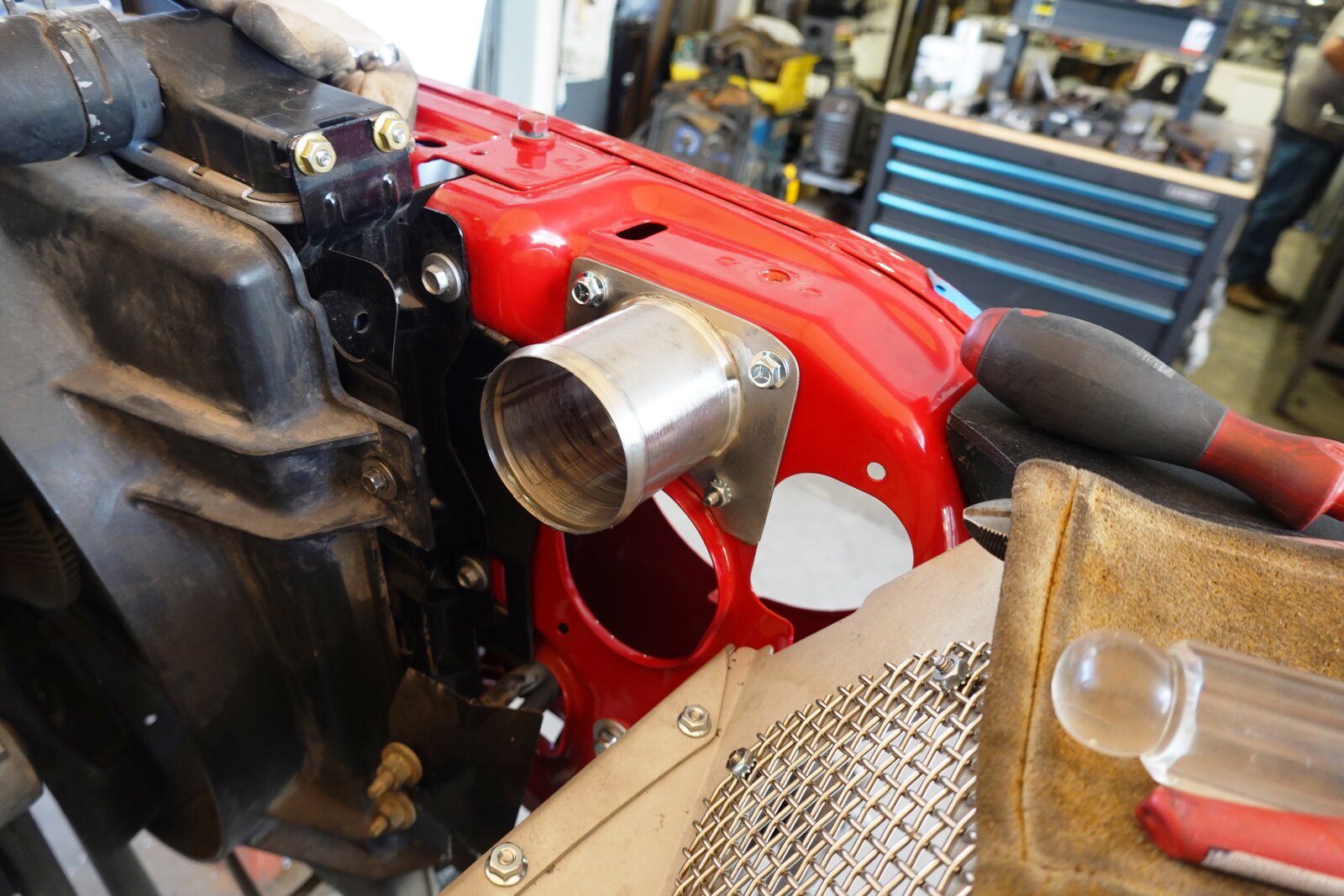

That fitting should be for sale on the BMB site.
Not really. All that will do is create 50 different examples of out of control wonky installs using crap like vacuum hose, dryer vent hose and some cobbled together bullshit that disgusts everyone. There's the picture, if you can't do that part, you are going to also suck at the rest of it.
That and I'd have to sell it for 100 bucks to make it worthwhile and that isn't fair to anyone.
There are already many different hacked up intakes out there. This could help (maybe) for some people.
Also, there are many options for intake tube, elbows, and fittings on the web. I just cannot fab that bulkhead adapter. Unless you tell me that it's an off-the-shelf part that you modified.
And it might be worth $100 for me to buy pre-made.

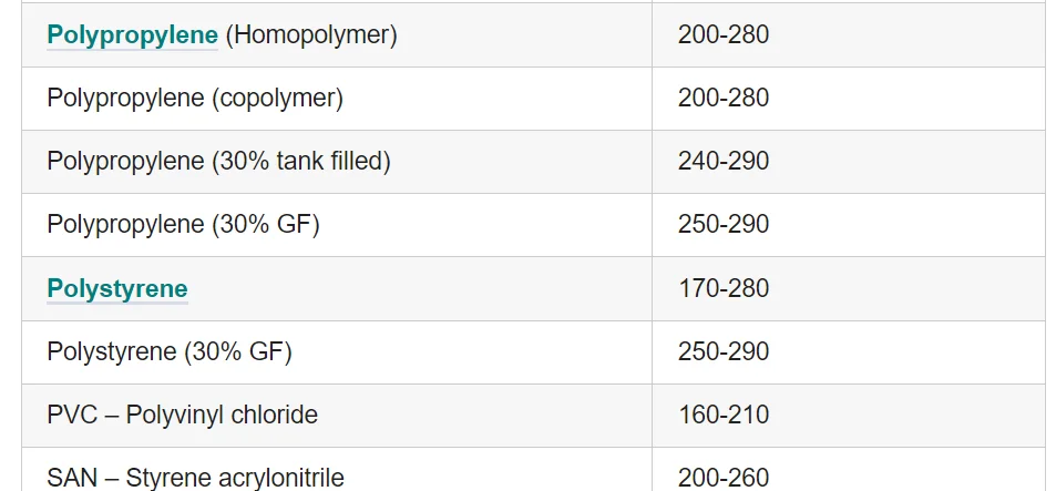

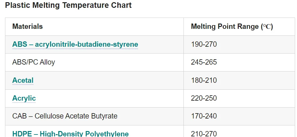

A quick search shows polypropylene melts at 327 and abs at 221. They both get soft way before melting. You'd be better off with some semi-rigid dryer duct.
Guess I should have done some research in the first place...
Your search resulted in different temps than my search did. Mine shows PP does have a slightly higher melting range, but it's not all that different. Either one will easily hold up to under hood temps. Aside from that, it looks like ABS would be more durable than PE or PP as well as being easier to work with for the average DIYer. The only drawback I saw to using ABS is, it is lesss resistant to certain chemicals. I'll have to look into which chemicals are harmful later.
374° to 518°f for ABS,
464° to 554°f for PP
https://plasticranger.com/melting-point-of-plastics/
