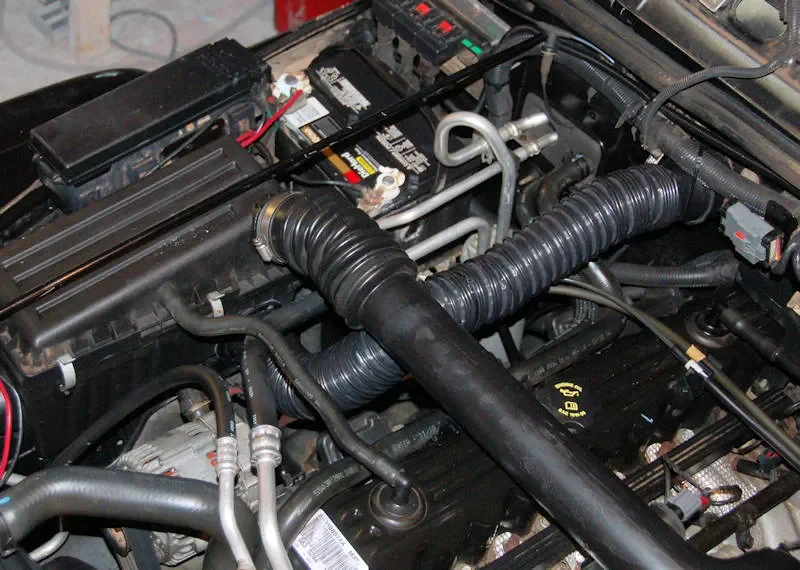

I wouldn't use a kit. I would remove the inlet off the stock box, and fab a sheet metal assembly to go between the box core support. Would seal it up and pull air through the headlight opening. I dont do deep water.

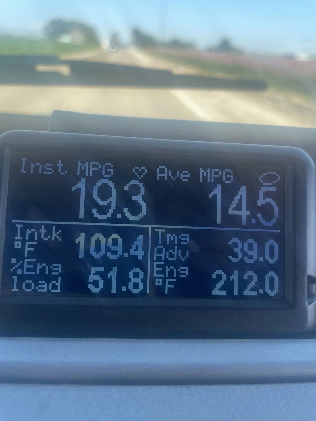

I had a chance to measure my IAT, different position on the 05 than the previous years. But 102 degrees on the weather app and 109 on the intake temp- hard duct to behind the headlight-In all the discussions I wonder if its lost this could be categorized as power preservation? The initial under hood temps at start up are ambient and the you get a gradual fade as temps rise. At least that is part of my thinking.

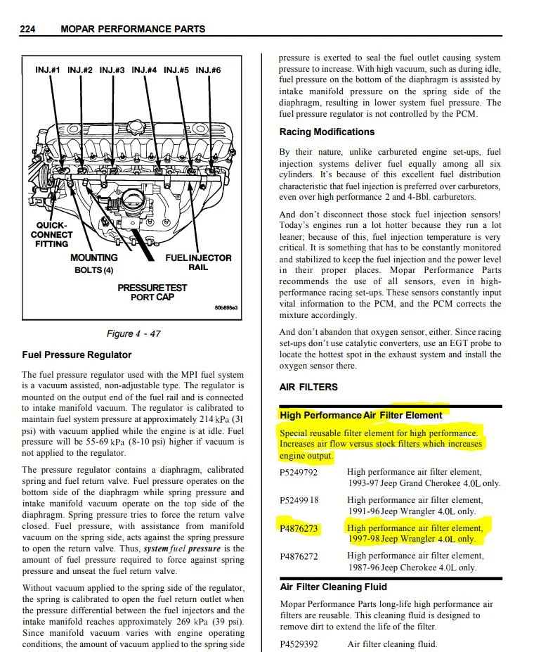

Read this today in an old Mopar manual. I wonder if this bit of information will convince those who believe there is no benefit to replacing the factory filter.
That wouldn't be the first thing they got wrong when writing the FSM. Even the chief Jeep engineer, James Repp, has confirmed over the years that the OEM stock/factory air intake system easily flows more air than the 4.0 can consume at WOT at redline rpms.
