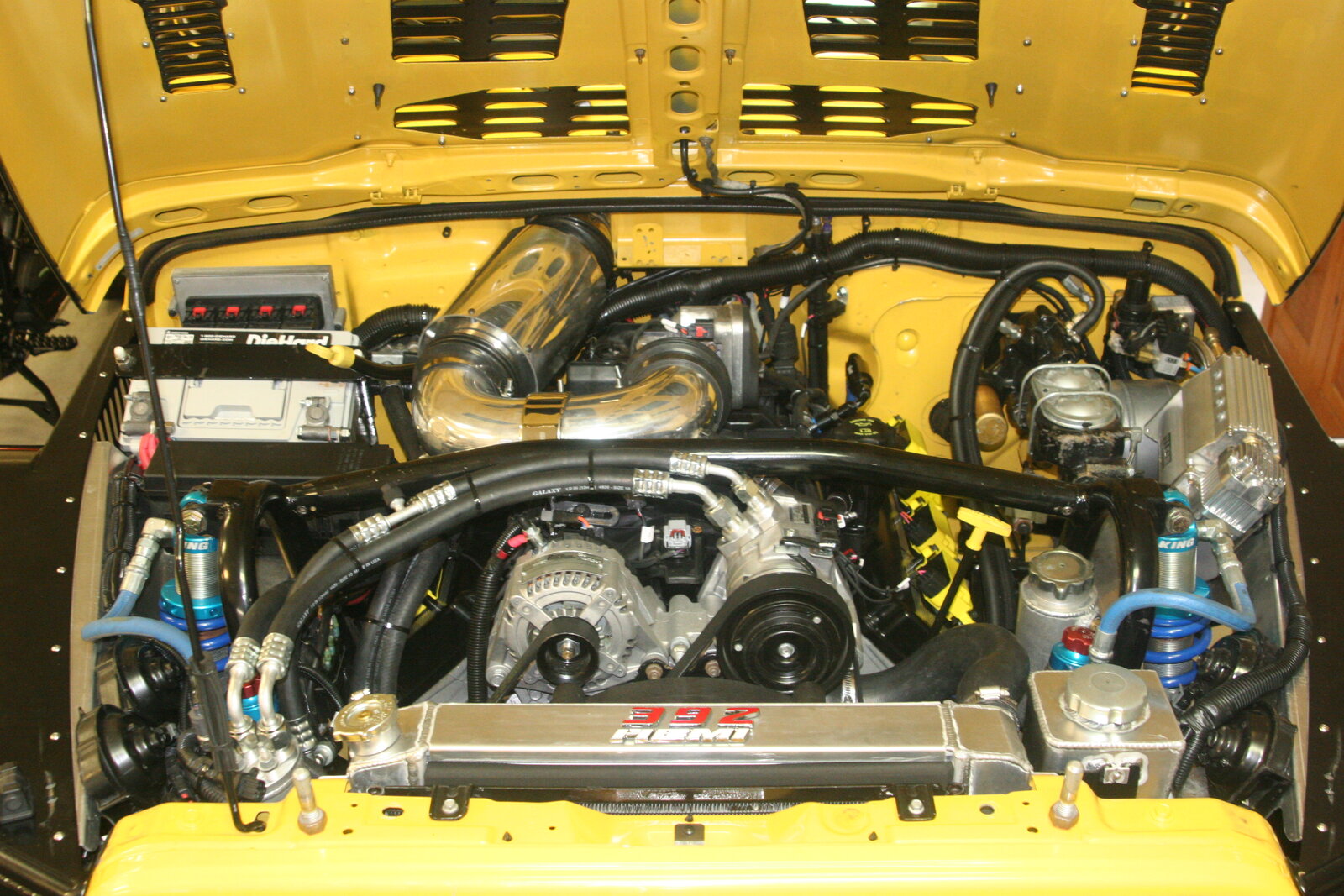

Well....if I could find the motivation to do it, I think the best setup is cowl induction. You get cold, outside-the-engine-bay air in an area that's high (to avoid water) and high-pressure when highway driving, for a little extra boost when you really need it
The cowl area isn't going to be under any pressure. It's open at the top AND bottom. One down side to a cowl intake like that is your are going to hear it a lot in the cab, although some people might not mind that much. Still, I agree it's a good option.
I can't hear mine in the cab at all...
(Note: Other factors may be involved... ;))
