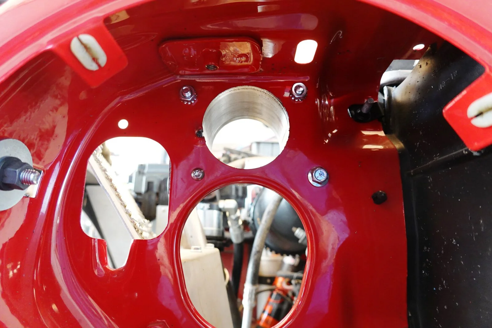

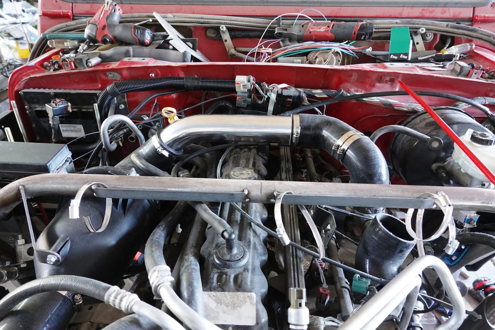

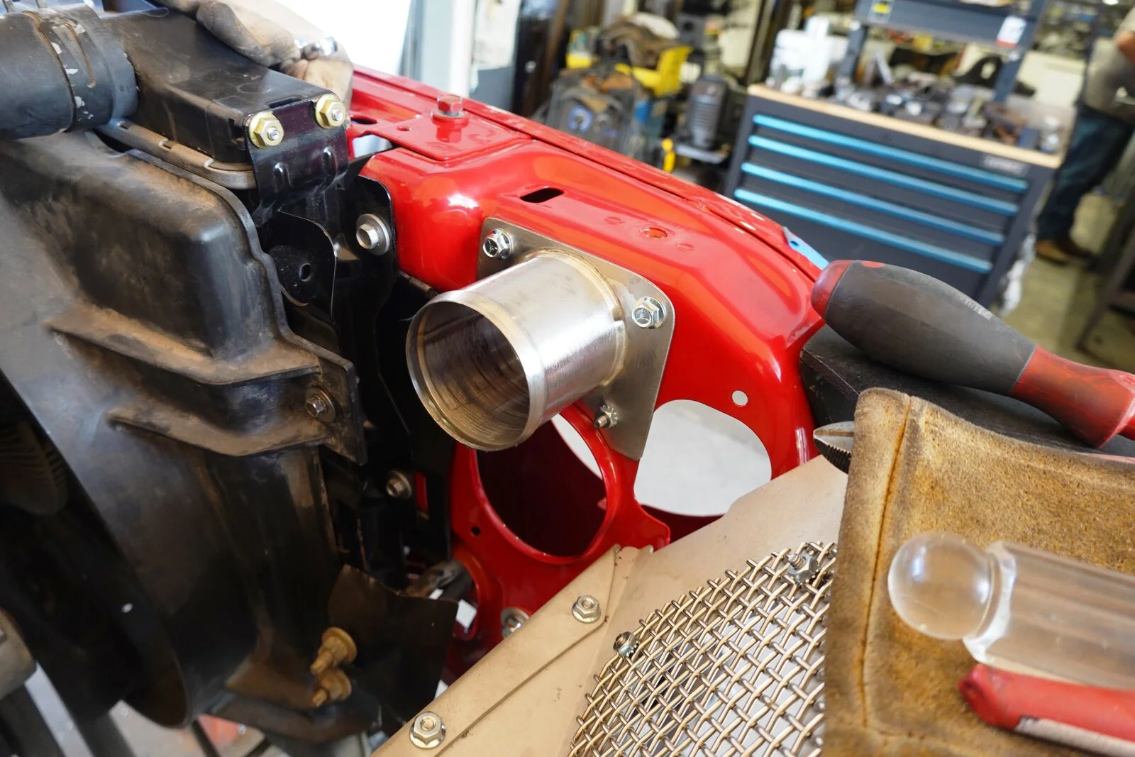

  • Cooler air holds more oxygen particles. Think we all learned that in basic physical science class. Now the number that sticks in my head as a rule of thumb formula is .9% for every 10 degree drop the engine see.(its not a linear law but for our discussion close enough) If you have a ducted true CAI and not just a cone filter under the hood and can achieve a 20-30 degree drop of ambient at the engine- its a gain across the whole curve- about 2-3HP at 2500ish rpms(approx 100hp at the flywheel) and 3.5-5.5hp at peak hp on paper.

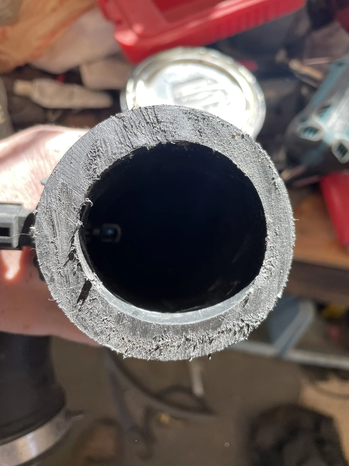

  • Now if the CAI enlarges the pipe- well that opens discussion farther- My observation is the throttle body is 60mm, when I cut the cross section of the straw between the airbox and the throttle body its 50mm ID, the air horn is 42mm ID. Which begs the question -what is sized appropriately- the 60mm throttle body or the 42 mm air horn? But moving on from that observation - changing sizes from a 50mm pipe to a 76mm pipe straw has another science/engineering findings. It just less restrictive- moving from a 50mm to 76 mm pipe is like 2.5 times more flow- dont get hung up on the unnecessary CFM argument but is simply means that atmospheric pressure has less to over come pushing air into the engine. So if I presume that the factory throttle body is correctly sized, then keeping the throttle body that as the constraint would beneficial , more oxygen -yes?
I think these two facts support that there is improvement available over the OEM design but saying if you disagree still- none is loosing engine power in this situation. There are other arguments to be had such as CAI is certainly not the way to go if you like swims in the rivers, oil gauzed filters in dust may not be such a good idea, but true cooler air getting to the engine... I never seen anyone disagree that cool air is not beneficial and objectively speaking the TJ is the only vehicle I have seen on this side of the millennium that attempts to draw warm under the hood air. Just my thoughts on this and you might imagine I did build a CAI.
