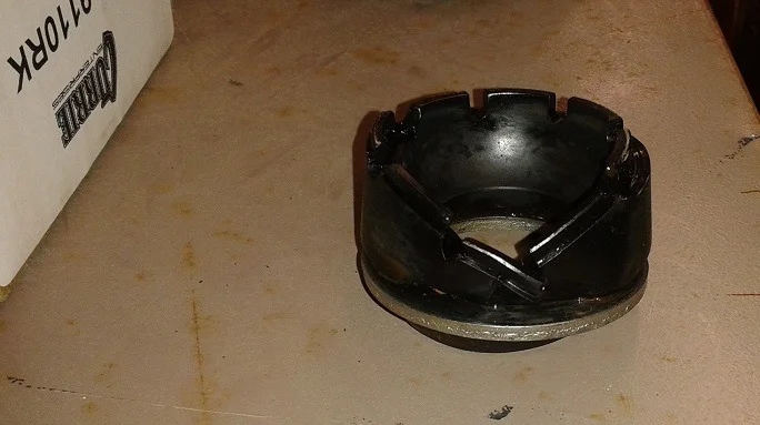

Different kind of flop. Look at the pics of my arms with Johnny Joints. They will roll from side to side over time. The arms are straight, so there is no orientation to maintain. If those arms were bent, they might need to be held in position with a bushing that will return to center.
Ohh, I got you. The key word was roll. Then I got the picture. That might be the case.

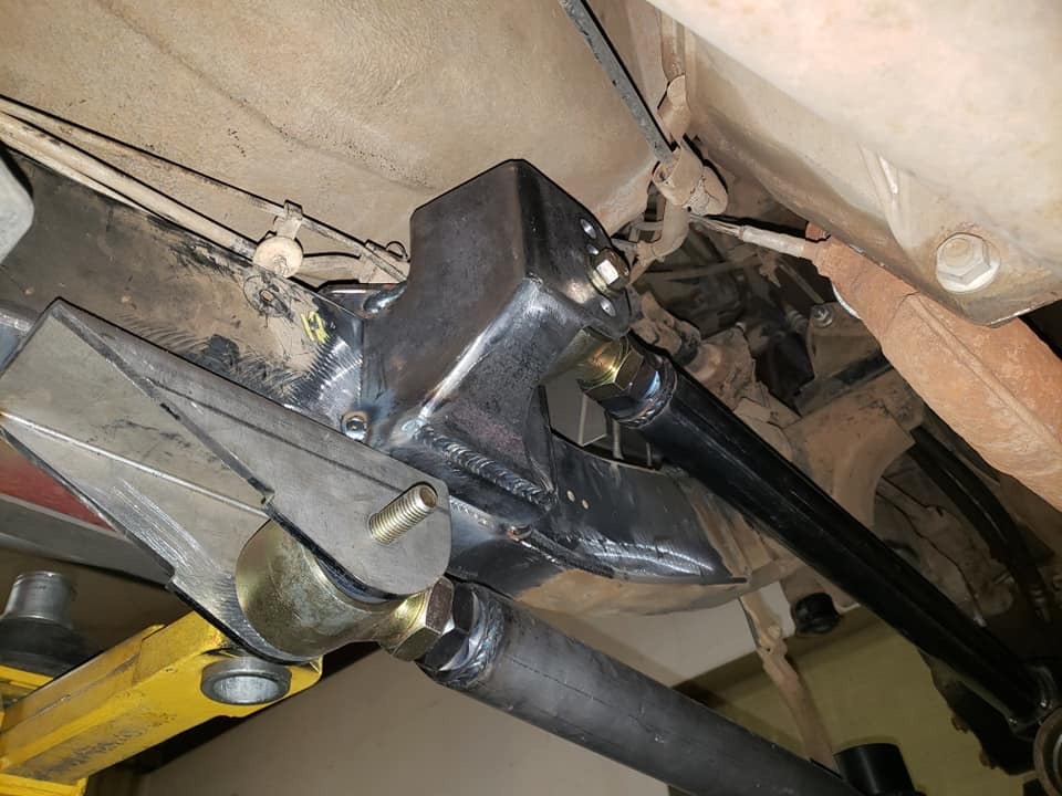

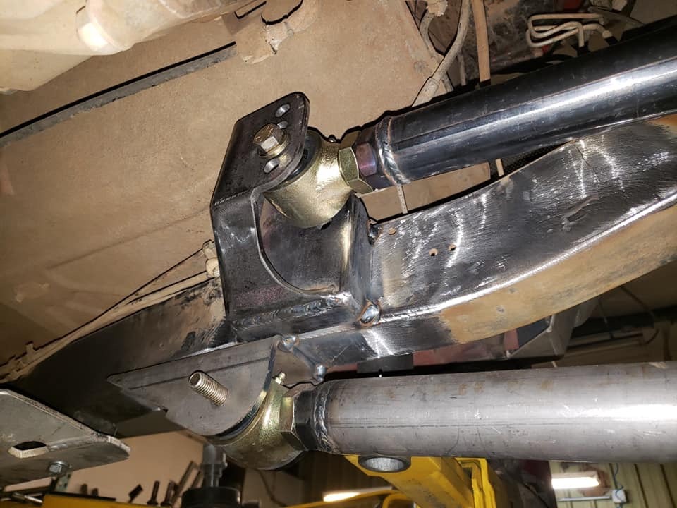

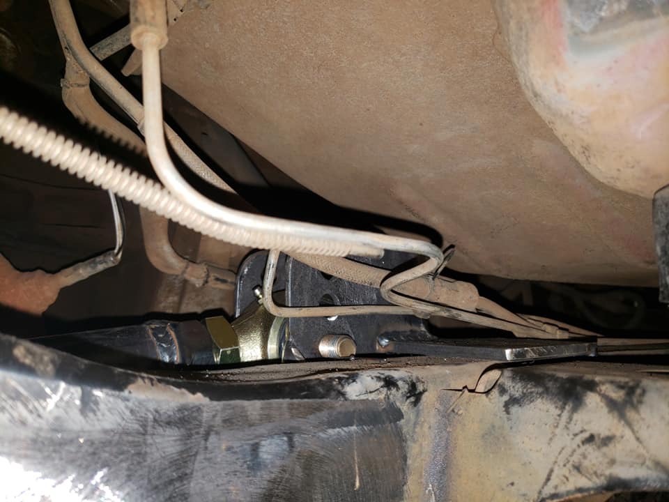

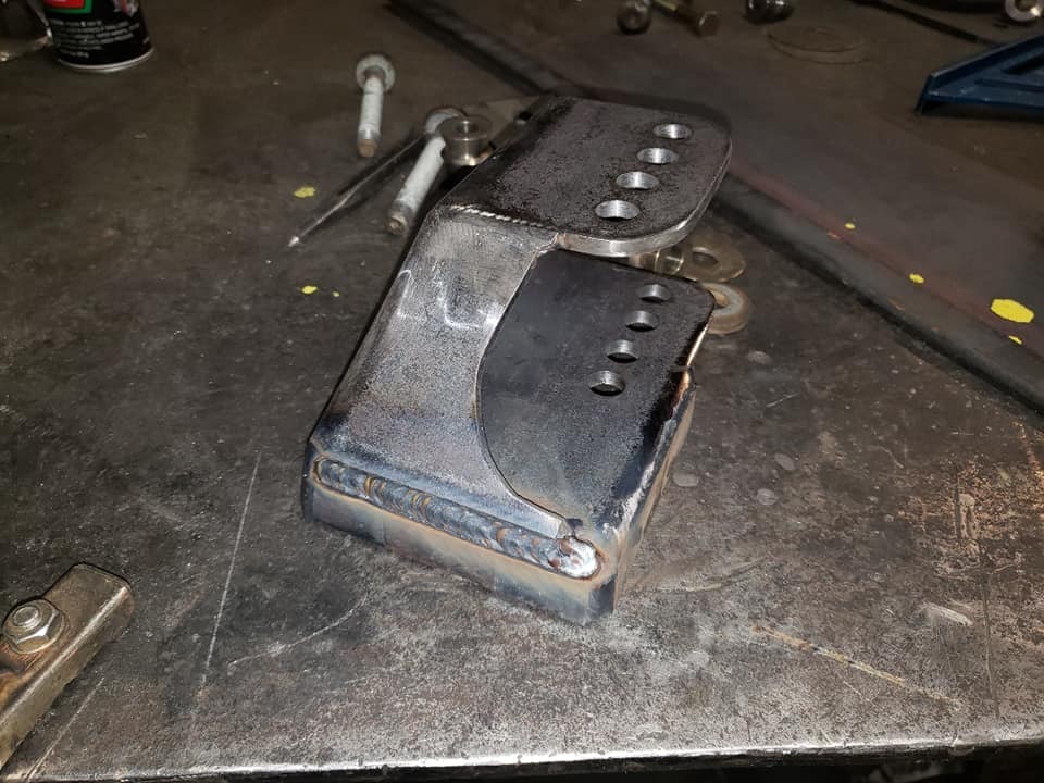

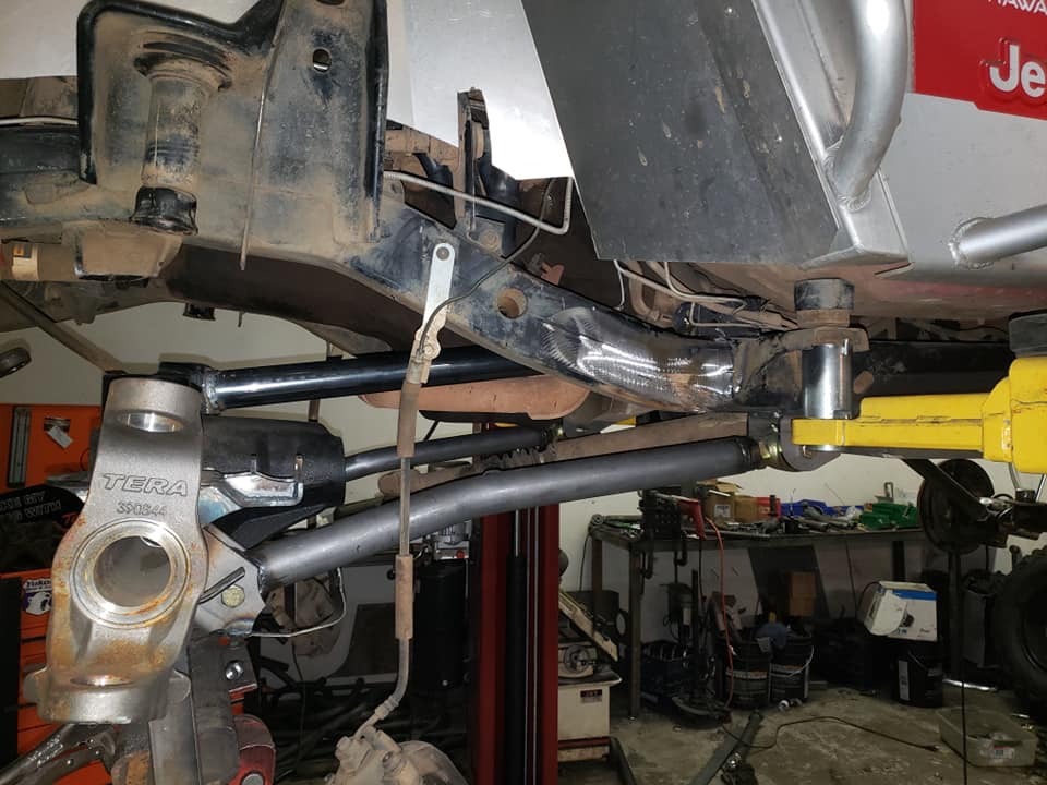

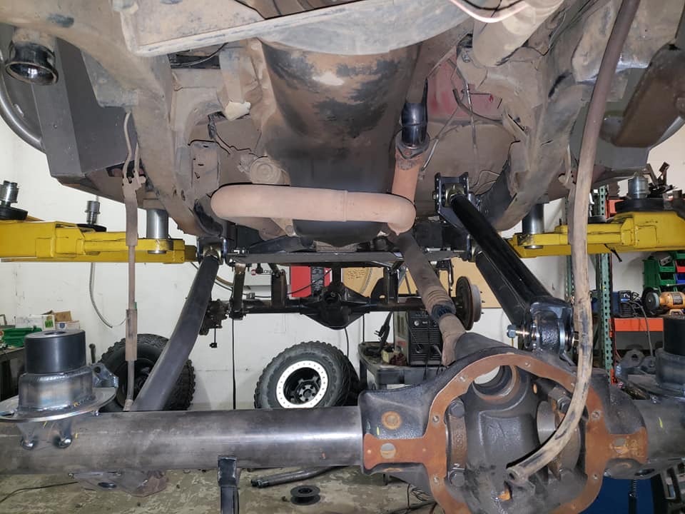

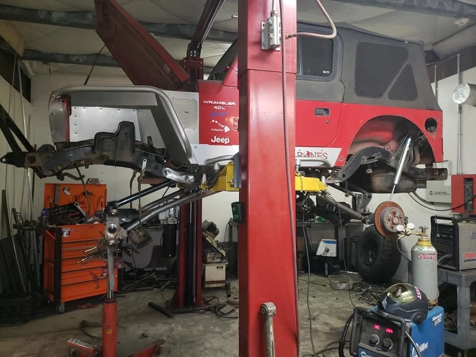

I’m assuming this is his mid arm kit. He posted these yesterday.
