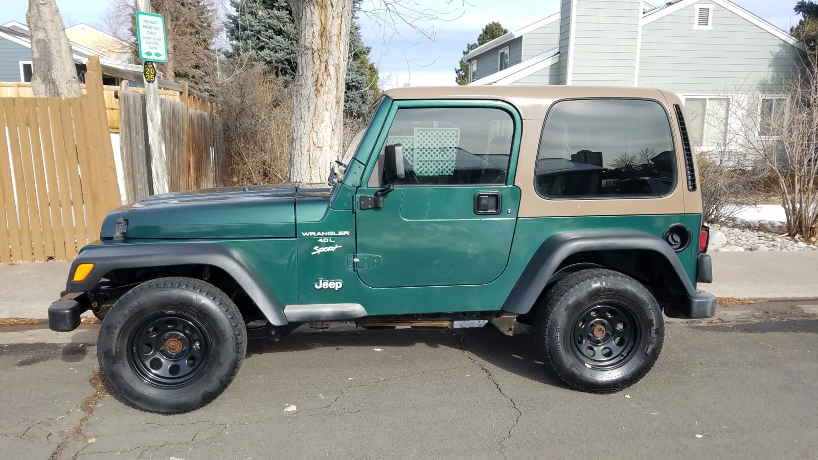

Meet my 2000 TJ sport!
  • 4.0 I6
  • 5MT (NV3550)
  • Dana 30/Dana 35 axles
  • Stock 3.73 gears
  • Almost no rust!
  • 200K miles on the dot when purchased
My goal is to build a Jeep that I can run some of the trails I used to do in my JKU Rubicon that had 35s and a 3" lift. I sold the Rubicon a year ago to get a more 'affordable' truck and do some dirt biking. I love dirtbiking but I also miss 4x4'ing and the fun social aspect of it. The truck has shown me that if you leave something stock it's very dependable and tame to drive on the road... but that's no fun! So I bought this jeep recently during the cold months here in Colorado for a relatively good deal (Just under $6k).

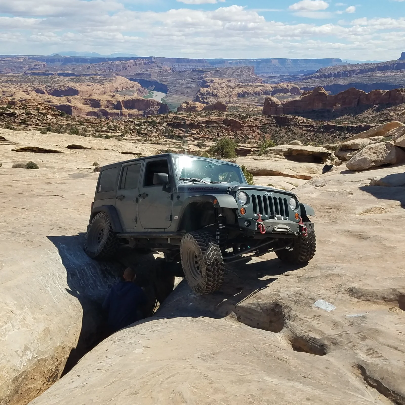

  • My last jeep doing some crack:

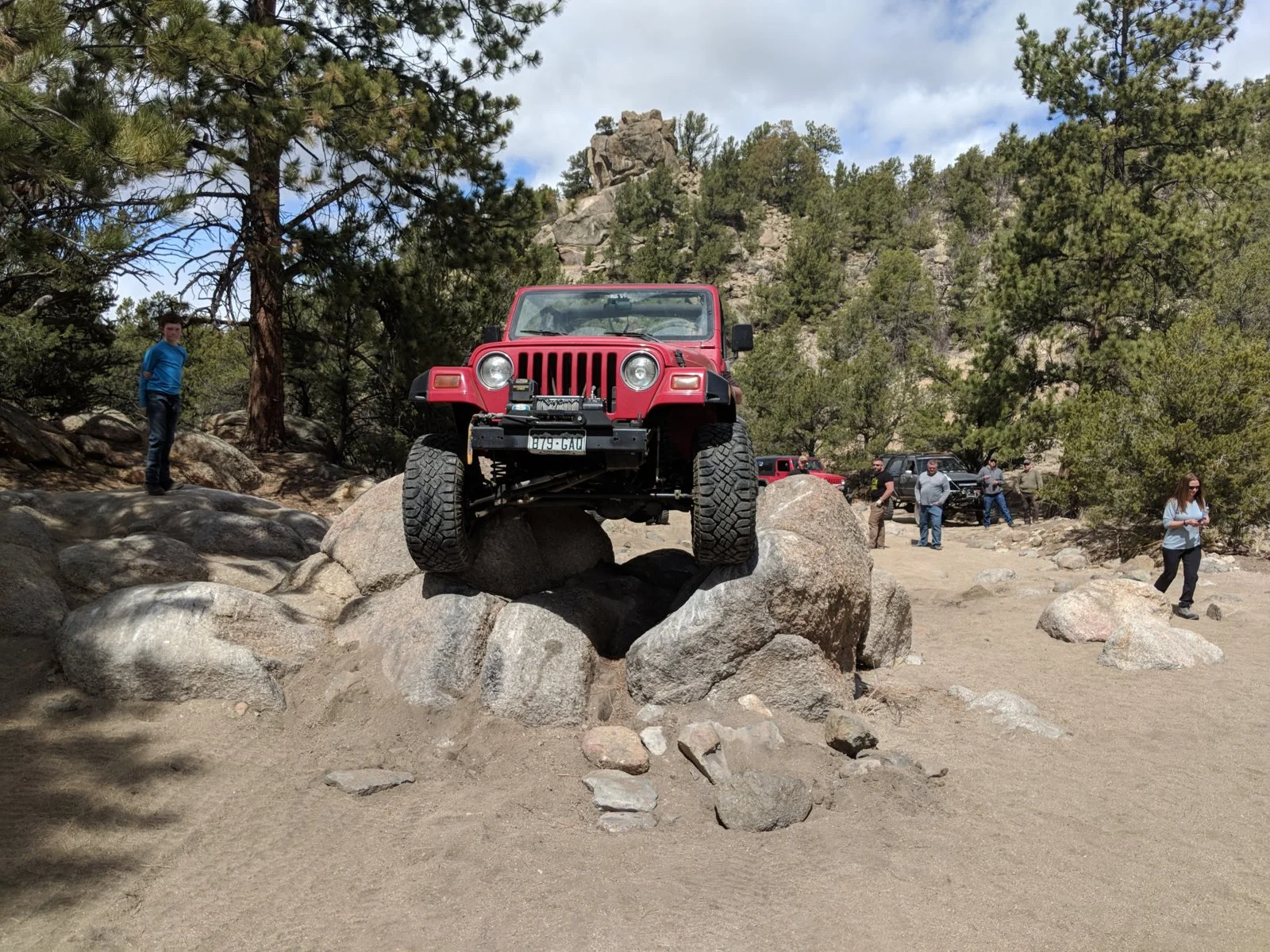

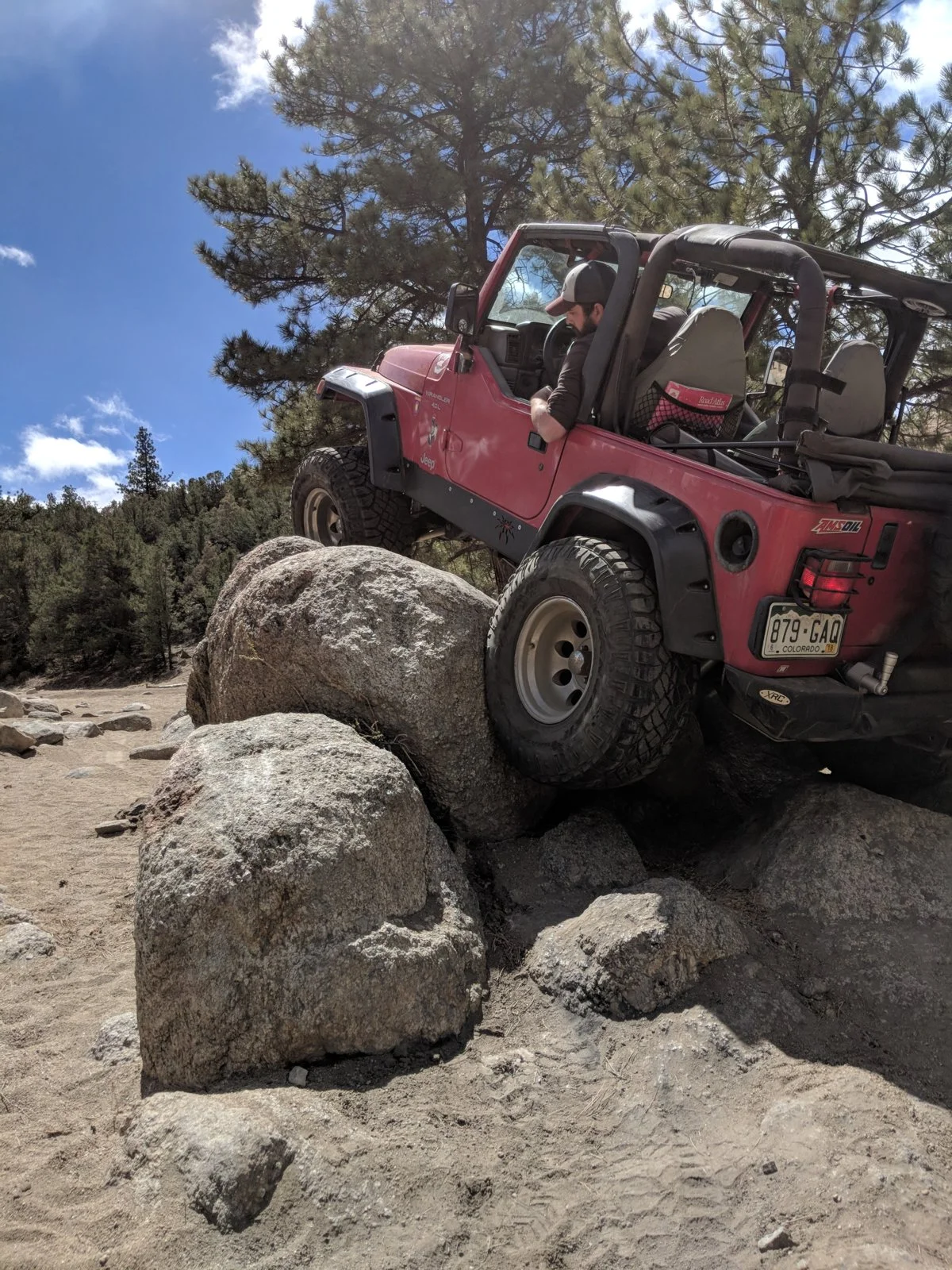

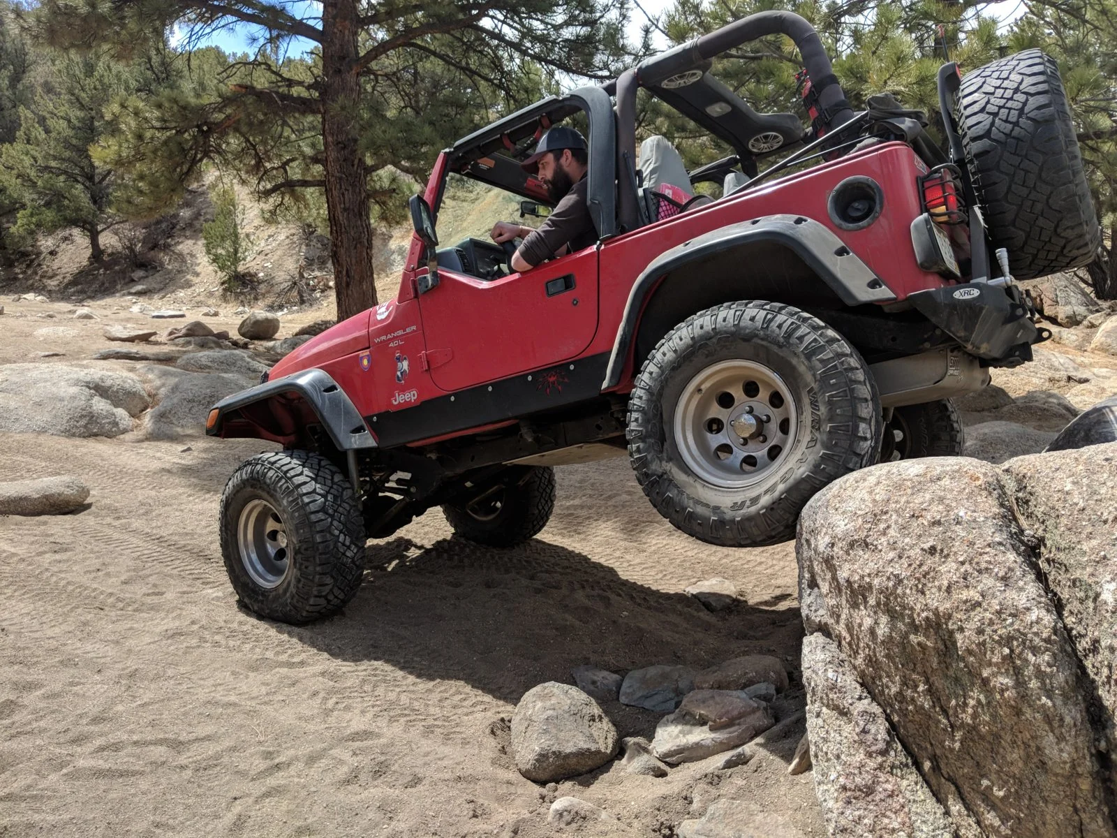

A 4" suspension lift with 33s is pretty darn capable. I ran that combo for a few years and went everywhere the guys on 35s did. If I was starting over, Id begin with the zone 4.25 combo lift and tummy tuck. It allows you to build off that platform and is affordable at $450 or so.
Ive yet to see a documented super35 break. I wouldnt even think twice about getting it if I had a Dana 35.
Your articulation will depend on your shock lengths and your bumpstops. Cycle your suspension early and learn what to look for. This is a step that gets skipped more often than not and really defines what a quality build is.
With the steep passes thruout CO I would go a step deeper in gearing. 4.88 with 33s. Just my preference though.
Theres an active CO group on wrangler forum. We should get one started here though...
This was 4", a 1.25" BL, and 33s back in April on the Rock pile @ Chinaman Gulch
