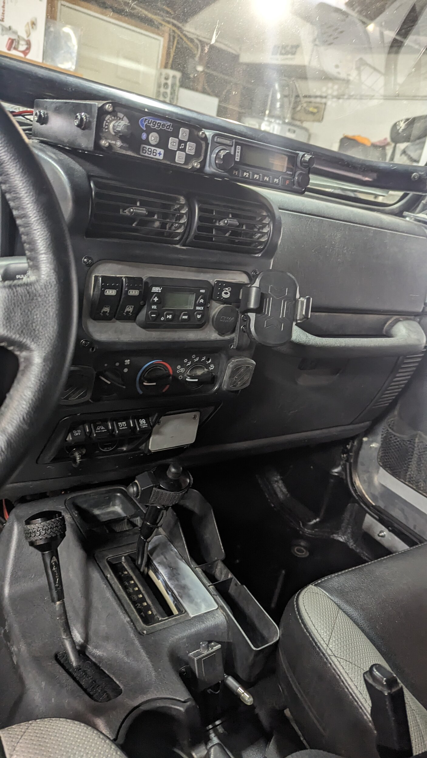

I have all the rugged stuff, if that's what someone wants they should shop their clearance or buy when it's all on sale.
I really like the intercom setup it's so easy to talk with your passenger or hit the PTT button and talk to the other rigs using gmrs.
So, you're saying you can be talking to a passenger freely, and then tap the PTT button for GMRS? That sounds awesome.
Do you have the unit in the dash, or under a seat, or...? Do you have plugs run into your dash for headsets? How often, if ever, do you need to fiddle with the head unit?
Yes, internal comms are always on. I have a PTT on the auto shifter so I can use the GMRS from my headset and Mrs App has the PTT on the passenger grab bar so she can talk.
Intercom is on one side of my console, near the dash, and the GMRS is on the other side. Mounted almost vertically. I bought the extensions so I have headset receptacles zip tied to the seat belt receptacles. Also have another headset cord run to the back for the daughter, she can talk internally but has no access to GMRS that's for just the "driver" and "co-driver"
I rarely mess with the intercom unit once it's setup other than turning it on and off.
