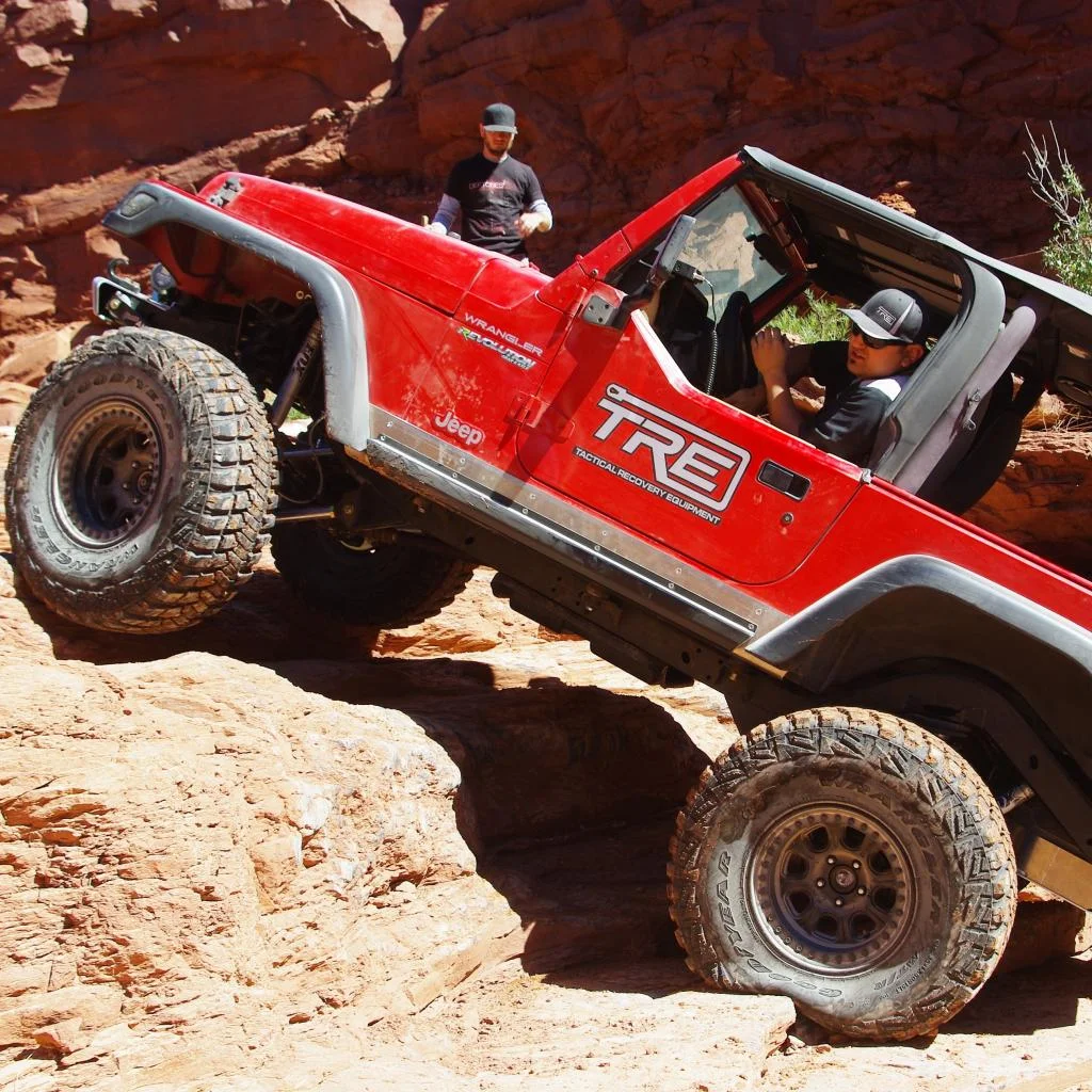

None whatsoever....I tested this Jeep at decent speeds in the desert and was quite happy. Mind you that TJ is very light, and bump-stopped correctly. Had it been a 6cyl and any heavier I would have used the standard Currie 4" springs.
Oh and the Jeep in that picture has HPD30 front and Dana 35 rear with 5.13s!
