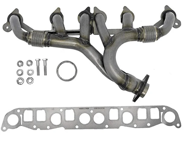

Yes, the fix is installing a good quality header with flexible steel flex joints at both sides like this one. They're all over Amazon.com and eBay, most have favorable reviews but that's the key to making a good decision, reading the reviews thoroughly and concentrating on the one star reviews to find the real truth.
Should look like this... notice the steel accordion-like flex joints which the original early factory header did not have. They're what was added to stop the cracking caused by the headers being flexed by engine torque.

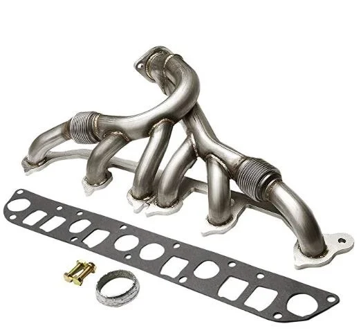

There are not a lot of options when it come to exhaust manifolds for the 2.5, the cast iron OEM type aftermarket manifolds do not fit properly because there are casting issues and the capped outlets (for the YJ 2.5 O2 sensors) tend to fail rather quickly. Banks is one of the few (oem pattern) headers without quality concerns, I've been using an Ebay special SS chinese header (also oem pattern) with good results since 2017 and I could buy 4 of them for the same cost as Banks, not that I like replacing them but it has worked without any issues. As far as the exhaust system is concerned Magna Flow's SS systems are hard to beat.
