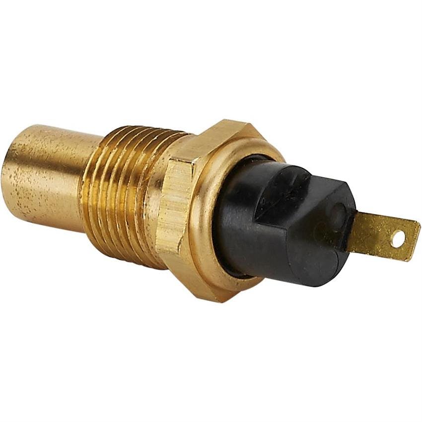

For reliability I am most comfortable with a simple switch that grounds out a preset temperature- using it on the ground side of 40 amp relay and it should be pretty robust. I just have not seen a way (yet) to find an additional port to thread one of these into other than on the radiator hose Tee I have seen. Ideally I want to be in a water jacket location- Used to be able to source a Tee that would thread into the engine to run two sensors - like old Fords would used -been keeping an eye out in the u-pull it yard but no luck.
Older 4.0 cylinder heads had a CTS at the rear driver's corner that would work perfect for this. There is still a boss that I believe can be drilled and tapped. I was planning to do just that, but it's already there in the Edelbrock head so I'm going to use it when It eventually get that head swapped on to trigger my aux fan.
