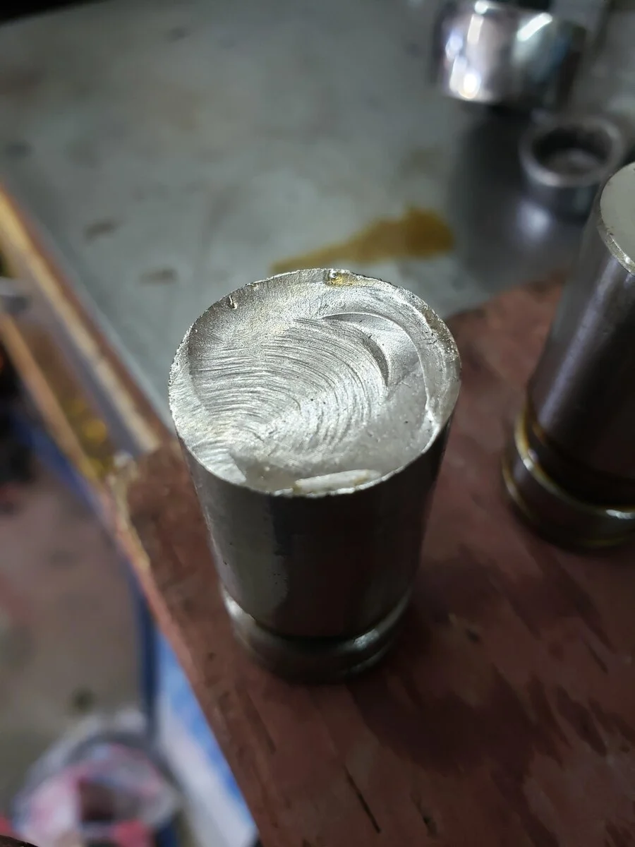

I agree that lifters on an old cam is not the way to do it. But a lot of people have done it and gotten more than 20 miles worth of driving. I needed a year which was 3k miles for me. Didn't happen. I rolled the dice and got 20 miles..... This failure, however, is a little interesting. Of course the cam is wiped out. With 150 compression on all cylinders, I wonder if i just get a reman, or do a full proper cam job. I just spent $400 on a fully rebuild head....
Dude that sucks. If the lifter is that worn, the cam may still be good. I’d get new lifters (they are $5/each) and load then back in. Obviously change the oil filter. Then get some zddp and rotella t and try it again.
This is a brand new lifter. 20 miles and the entire bottom sheared off.... Never seen that before.
This happens when lifters and cams mismatched. During the break-in period both cams and lifters are hardened together. This allows for better cam and lifter life. When you mismatch new lifters and a hardened cam, or vice versa, you end up with metals that will chew on each other. May need to do a full engine flush just to be safe and clean the oil pan and pump pickup.
Wow! That's harsh. I have used new lifters with an old cam (most recently on a Ford 200 cid straight six) without issue. Put another 20,000+ miles on it before selling it to a guy who drove it another two years without issue. Obviously, your results were quite different. Seeing that pic of your lifter might make me reconsider my past decisions. :unsure:

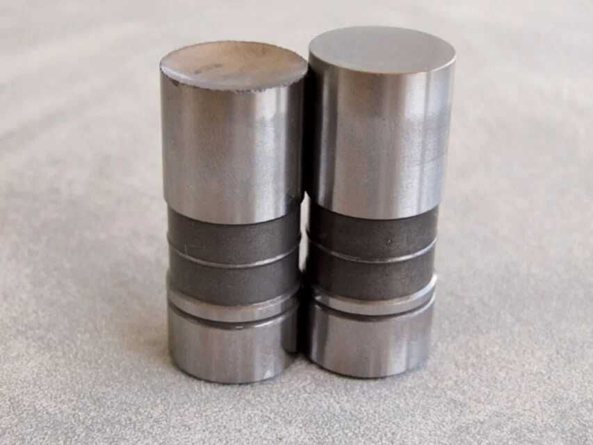

While mismatching old/new flat tappet cam and lifters is not a good idea and can cause serious problems, I don’t think that is your problem here.
If you can easily spin the pushrods I suspect incorrect lifters.
Might be worth checking. Couldn’t hurt.
Hard to say for sure without putting hands on it but I think this picture nails it.
Most people who put new lifters on old cams get those results. My issue isn't a wear issue, its a component critical failure...
