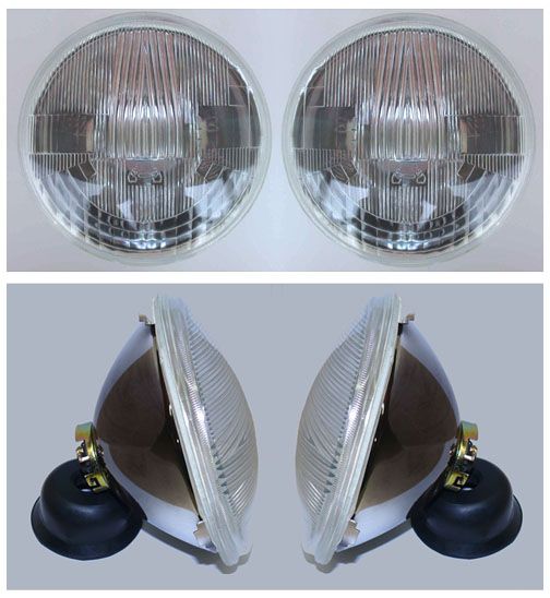

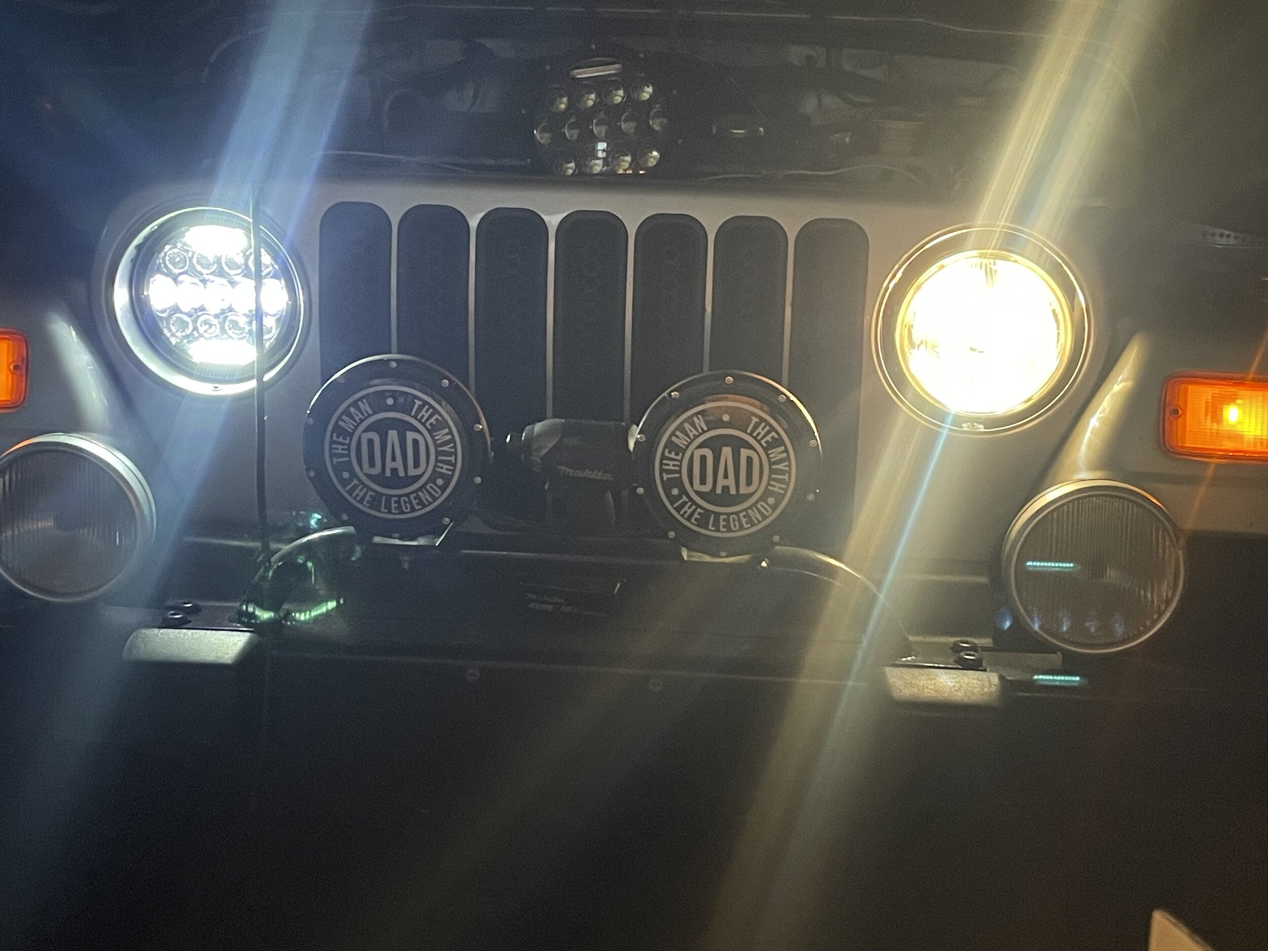

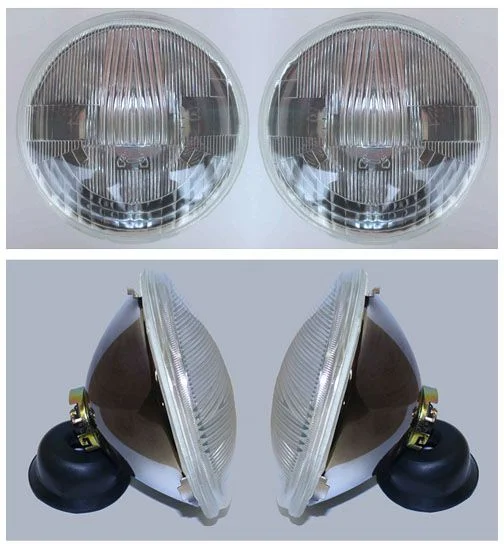

Bug eye LED lights on the passenger side new traditional glass lenses E code spec H4 n the drivers side.

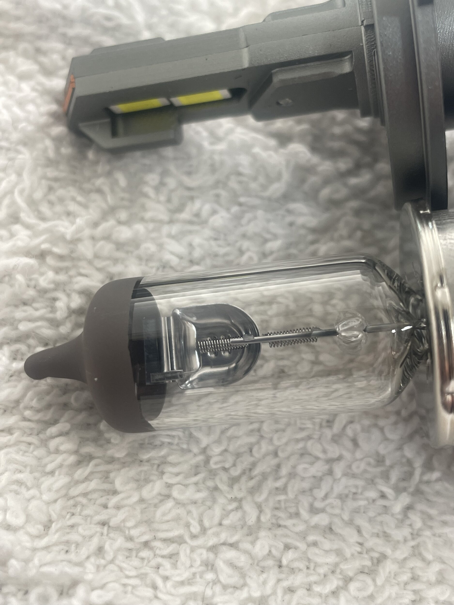

So these lights bring back the traditional headlight look however with the supplied 55/65 watt bulb they were dimmer and the 3500k color range just didn’t seem to cut the darkness like the 6000k do. So some months have passed since the switch back to halogen- Considered moving up to a brighter version of the halogen H4 but…I read up on the Auxbeam LED and the attention to the chip placement. I drank the cool aid and order a F15 version of the H4- not the brightest option Auxbeam offers but a step up from Halogen. At $35 a pair they seemed to be a good pairing to with the Bus Depot e-codes.
Nice side. Merit of running LEDs is I could tell the difference at idle stacking the halogen headlight load, heater motor and seat heaters load on the electrics.

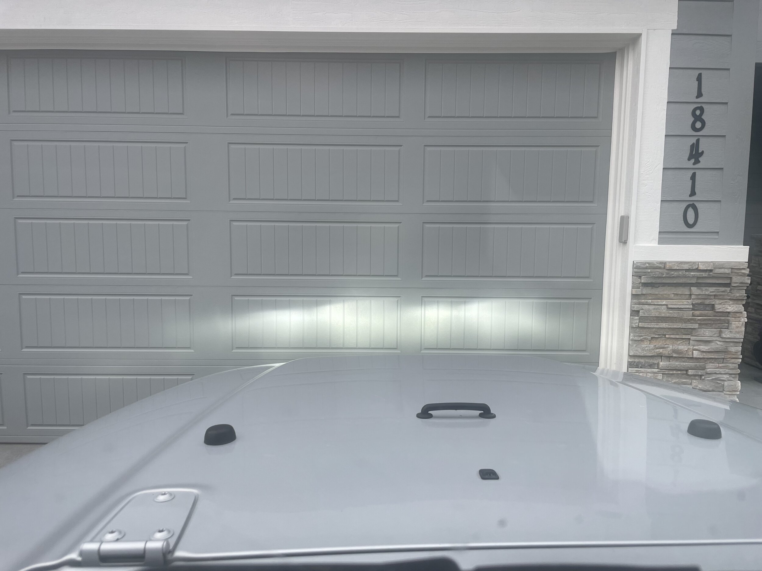

Still light outside but you can see the e-code pattern is still a crisp cutoff. Tomorrow I might actually get to try these after sunset. a missed taking the photo f the color difference/brightness but it’s is quite noticeable. So I know a few people bought the Toyota units so just sharing that these maybe something to consider if you want migrate over to LED.

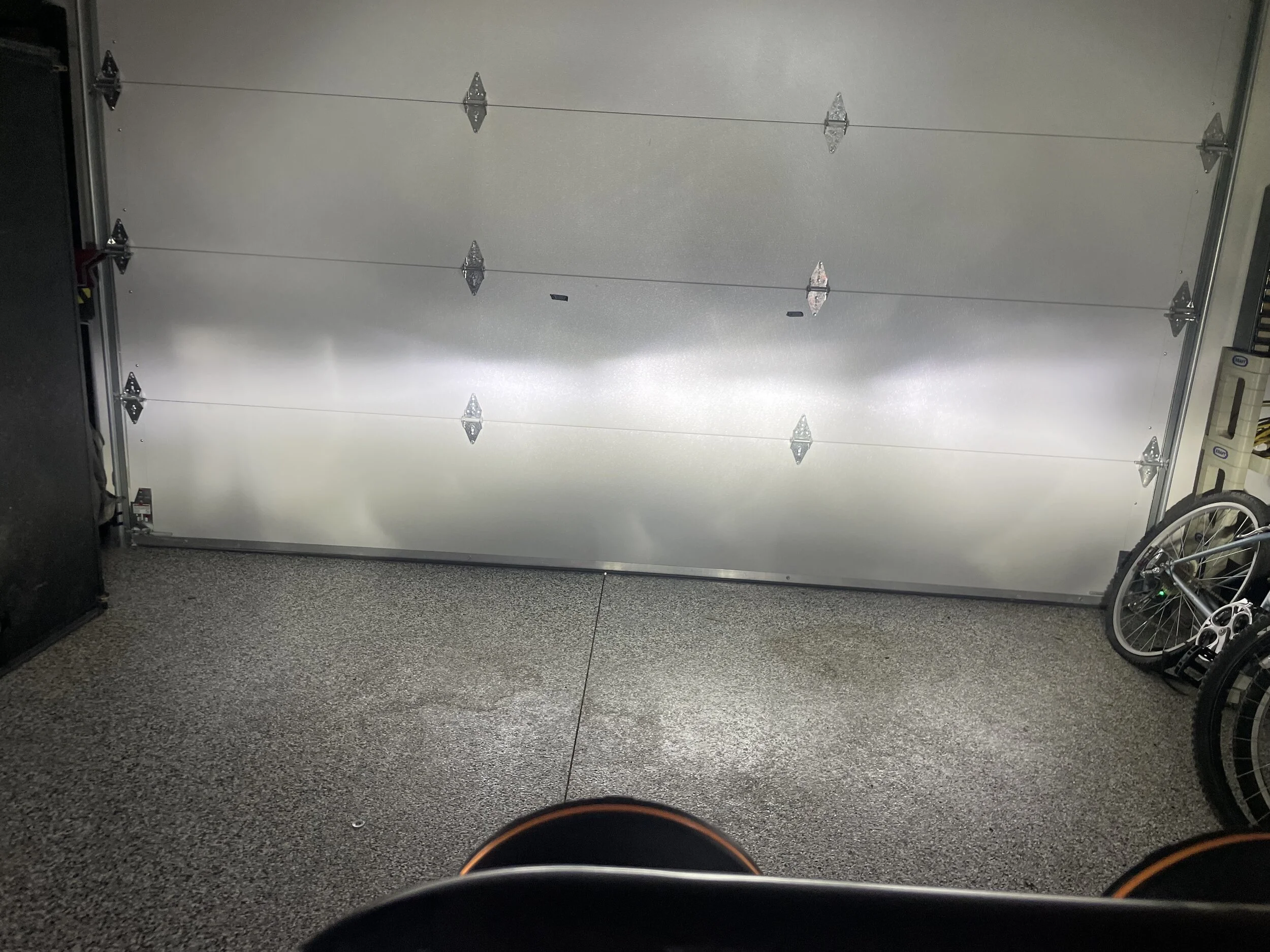

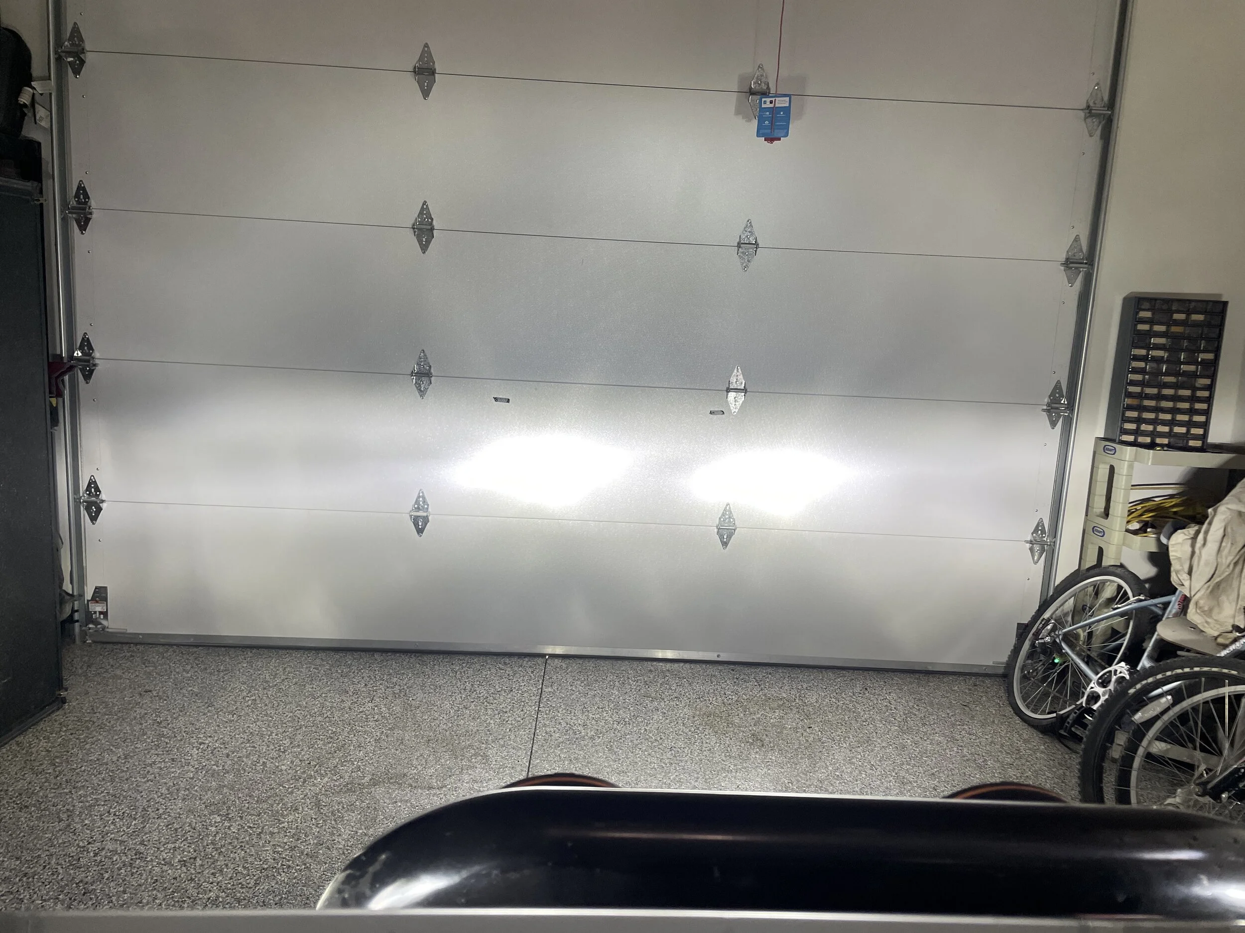

Garage sale today so finally the Jeep fits back in garage and can do a better pattern check.
Low beam
High beam
Late last night was my first time getting a chance to use the headlights - had to run me down a teenager doing donuts behind my fence in the empty sub last night. Was immediately noticeable it was brighter.. I know that AUX beam has brighter lights but honestly when compared to the stock Halogen wattages these F15 are already significantly brighter. I would be concern with their other bulbs if you dont get to bright.

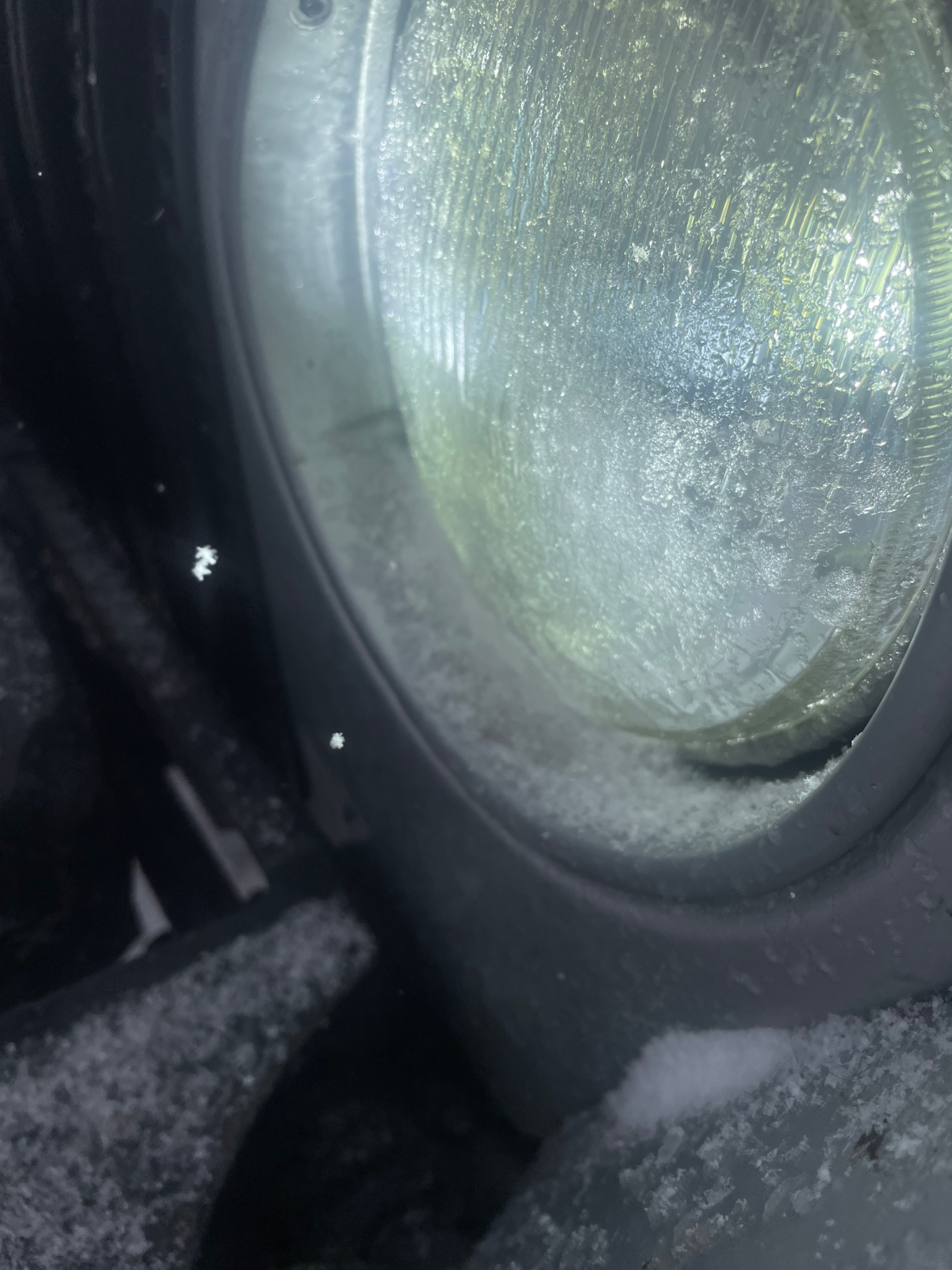

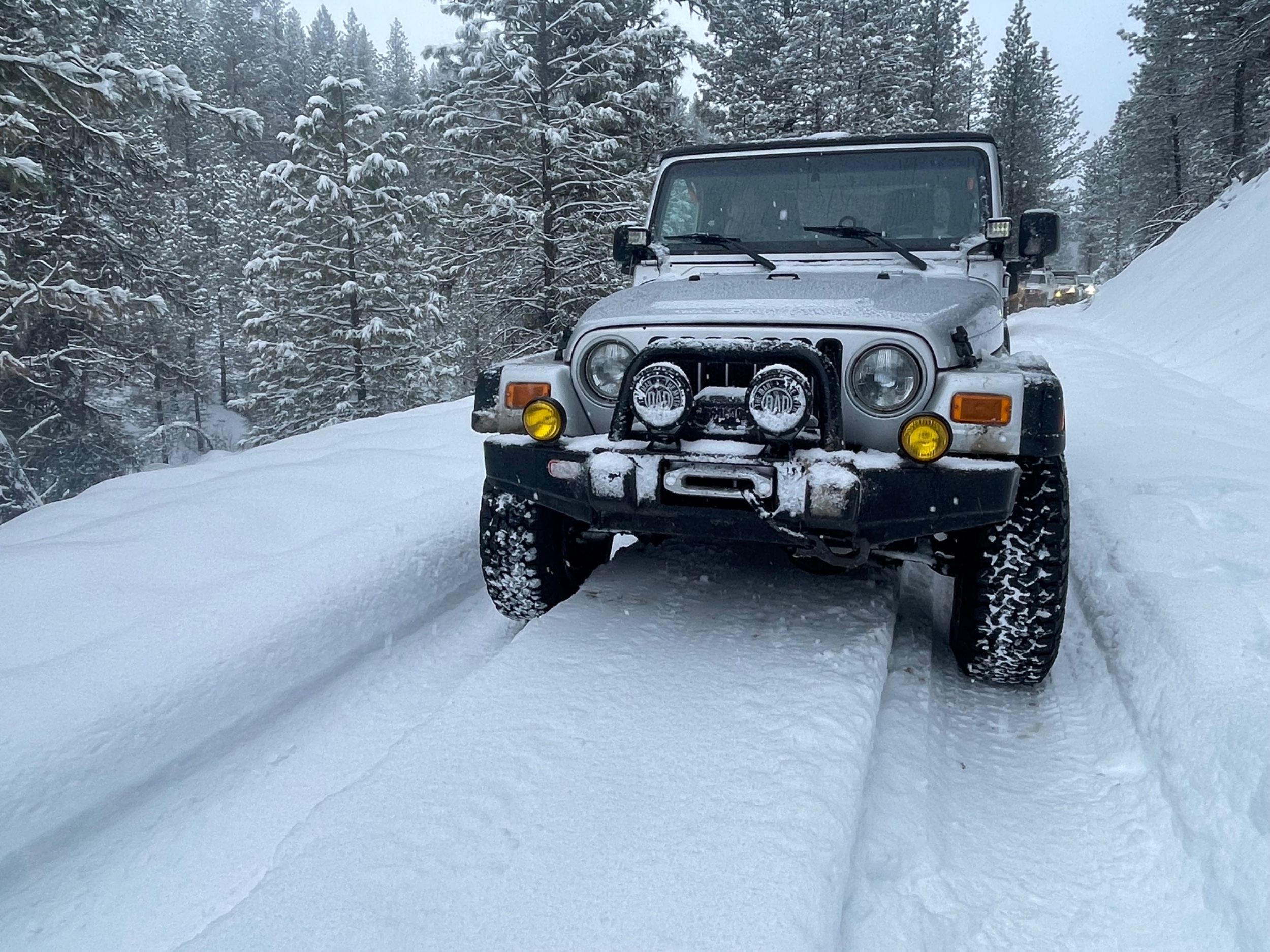

Lets hear more of your opinion after snow ice an ice fog. Led may not have enough heat for the winter.
Just to give a honest feed back loop…. Ice, ice baby. Could not tell a difference running down the trail but if the snow had been heavier it would have built up.
Keeping the fog lights with the H3 and intentionally not going all led was a good decision.
My thoughts exactly. The E-codes and Auxbeam bulbs I have run the risk of plugging up when the snow is coming down hard and driving right into it. I thought about switching my fogs to LED but figured it would be better to not press my luck.
