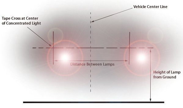

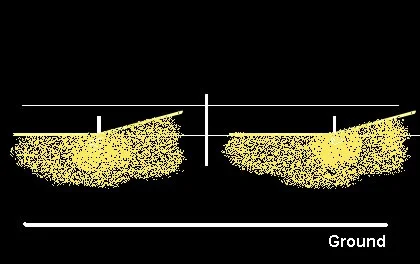

Some observations about Hella E-Code halogen headlight aiming:
The charts and illustrations for DIY headlight aiming (including those on the How-To in this forum) show an aiming pattern that is quite a bit higher than the aiming pattern recommended by DanielSternLighting.com, which has a chart showing how much to lower the headlight pattern at 25' based on the height of the headlight axis from the ground. For example, for my lifted jeep the pattern would be lowered 4.5" from the level typically shown on most headlight aiming charts/illustrations.
I first aimed my lights using the method referenced by @Chris in his How-To and observed that the low beams were OK but the high beams were so high as to be useless. Like this:
I then re-aimed my headlamps 4.5" lower at 25' using the Daniel Stern method, under the solid horizontal line shown in @Chris's illustration rather than above it, like this:
When the headlamps were lowered the low beams lit up more of the pavement closer to the jeep as would be expected, distances were still lit much better than with the stock headlamps, and the high beams were no longer in the trees and useful again.
My conclusion is that for Jeeps, particularly lifted jeeps, the Hella E-codes need to be aimed lower than is generically recommended. YMMV.

Mr. Bills,
I bought the Hella E codes, mostly on your recommendation. No regrets. They are significanly better than OEM sealed units.
I tried adjusting them based on the "How To" thread, but didn't like the results. I was on flat level terrain and had "targets" with crosshairs out to 25'.
Ultimately I covered each headlight, one at a time, and adjusted the other to where the pattern was pointing to where I wanted. I didn't take any measurements, but I'm sure my end results were similar to yours, slightly lower than the crosshairs.
