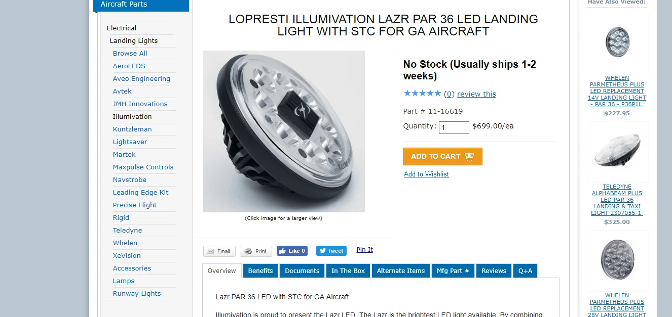

More Power I use these you can see .5 Mi
