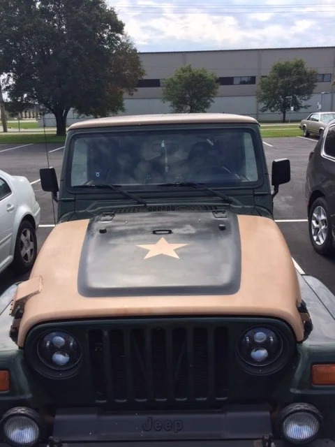

well again eating crow here.....I have since the last post, sold the trucklite lamps and I am now running JW Speaker LED (gen 1). Yes I still think they look weird BUT the lumination is impeccable.
here they are on my jeep
LED headlights are to me what the "butt crack" is to you from the body lifts. In my opinion, they have no aesthetic value, though I'm sure they work well. But as with everything, beauty is in the eye of the beholder. Having said that, I gotta say, Chris, your latest acquisition is a beaut! But close the hood before taking a pic, next time. It looks like a displaced body lift with that gap going on... :D
