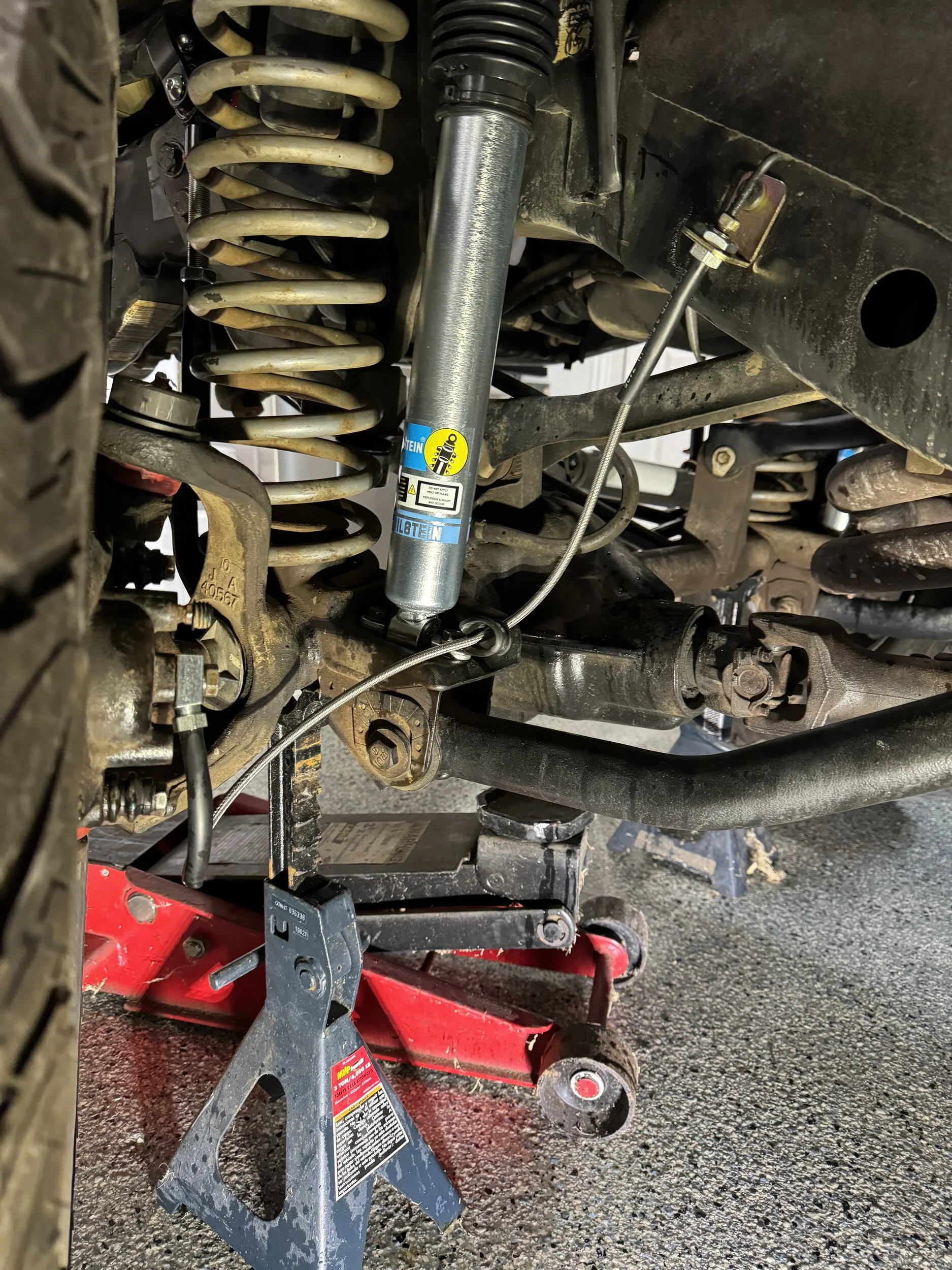

Hey there! Just installed the stainless steel brake hose kit from Extreme Terrain on my 2006 Unlimited that I recently purchased in late December. I noticed my front brake hose was worn from tire rubbing during rotor and pad change. The kit is great, but it lacked instructions. Any tips on securing the hose while allowing free movement during turns? Also, would love to see installation pics from others! The photo is what I ended up doing. I tested it before reinstalling the tires then again once I installed the tires. All seems to be smooth, time will tell!
https://www.extremeterrain.com/crow...el-brake-hose-kit-for-06-lift-8706-yj-tj.html
What you show would probably work fine. I have seen others zip tie it to the body of the shock.
