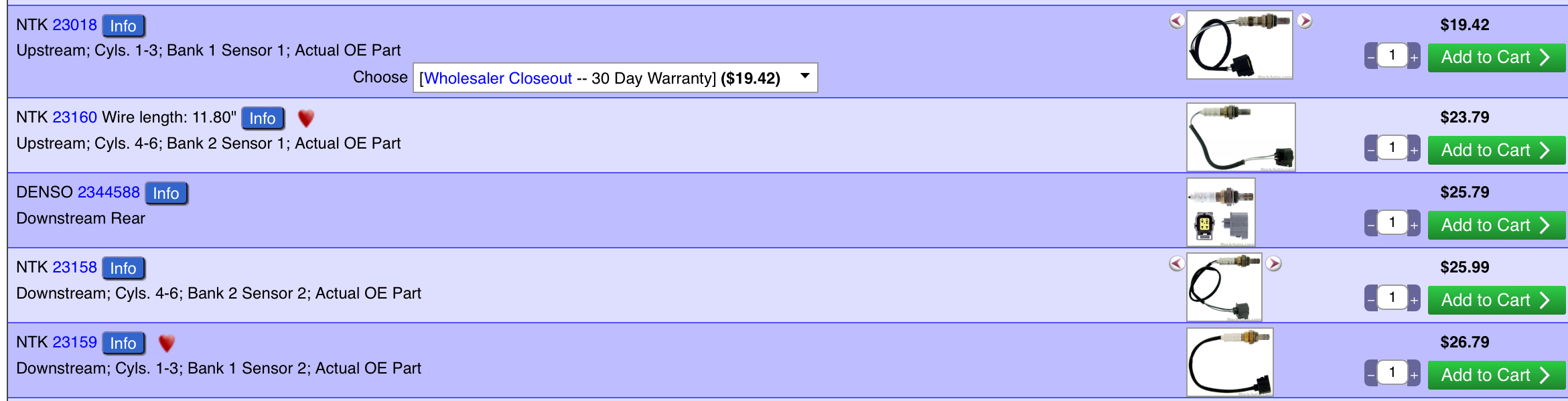

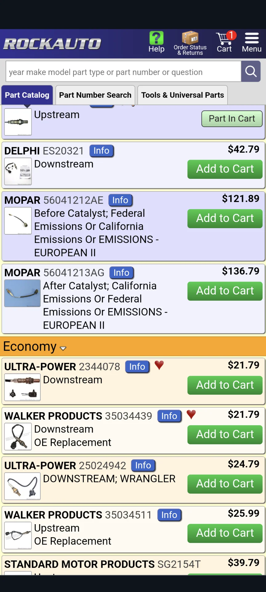

I found all four o2 sensors on RockAuto about two weeks ago, I snagged them up. They may still have some available. Just checked still there in case you want a set for the shelf.

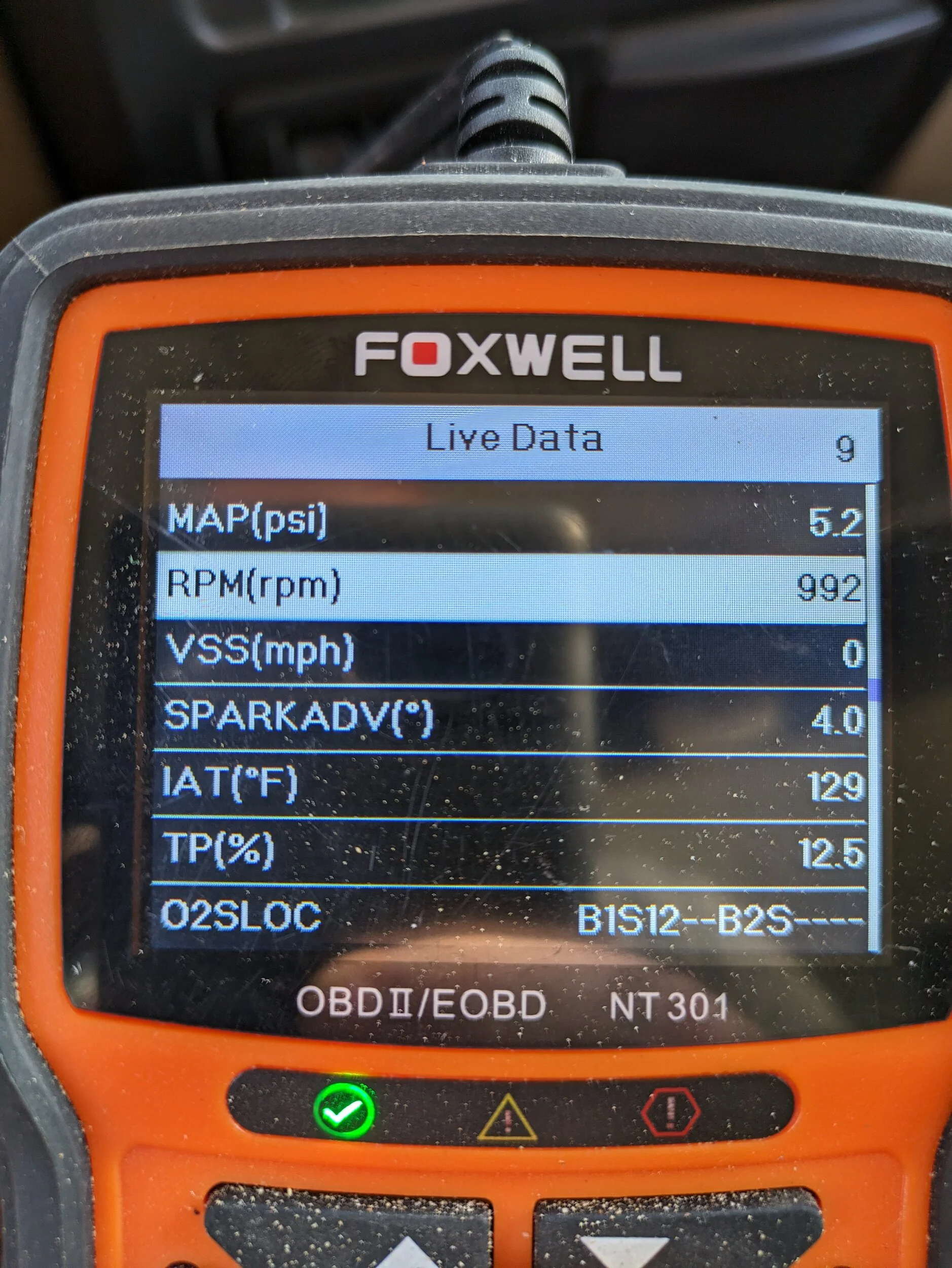

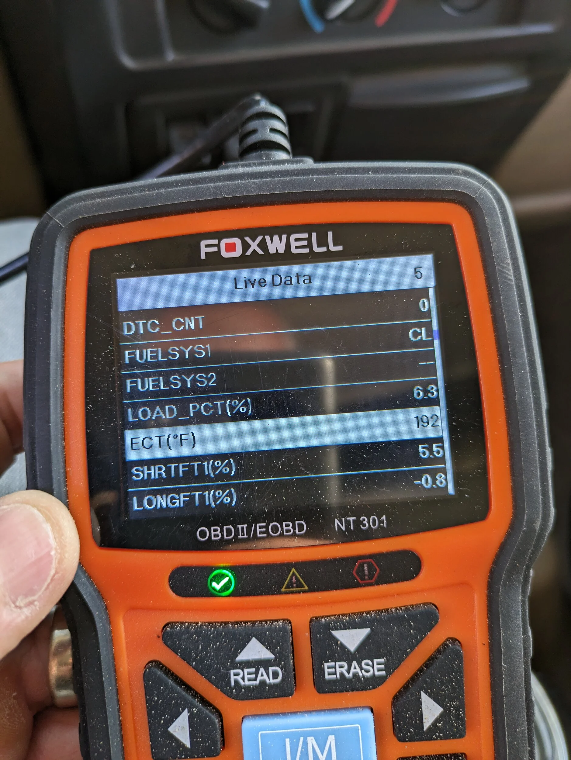

Yeah 192 is low. Is it possible a lower temperature thermostat like a 165 or 180 degree was installed instead of the correct 195 degree model?
It's possible, I've owned this Jeep for about 2 years, and haven't replaced the thermostat in that time. Could the high NOX and the low engine temp be possibly related? From what I've read, high nox is caused by high combustion chamber temps, so I would think the engine running cooler would be better for reducing NOX?
