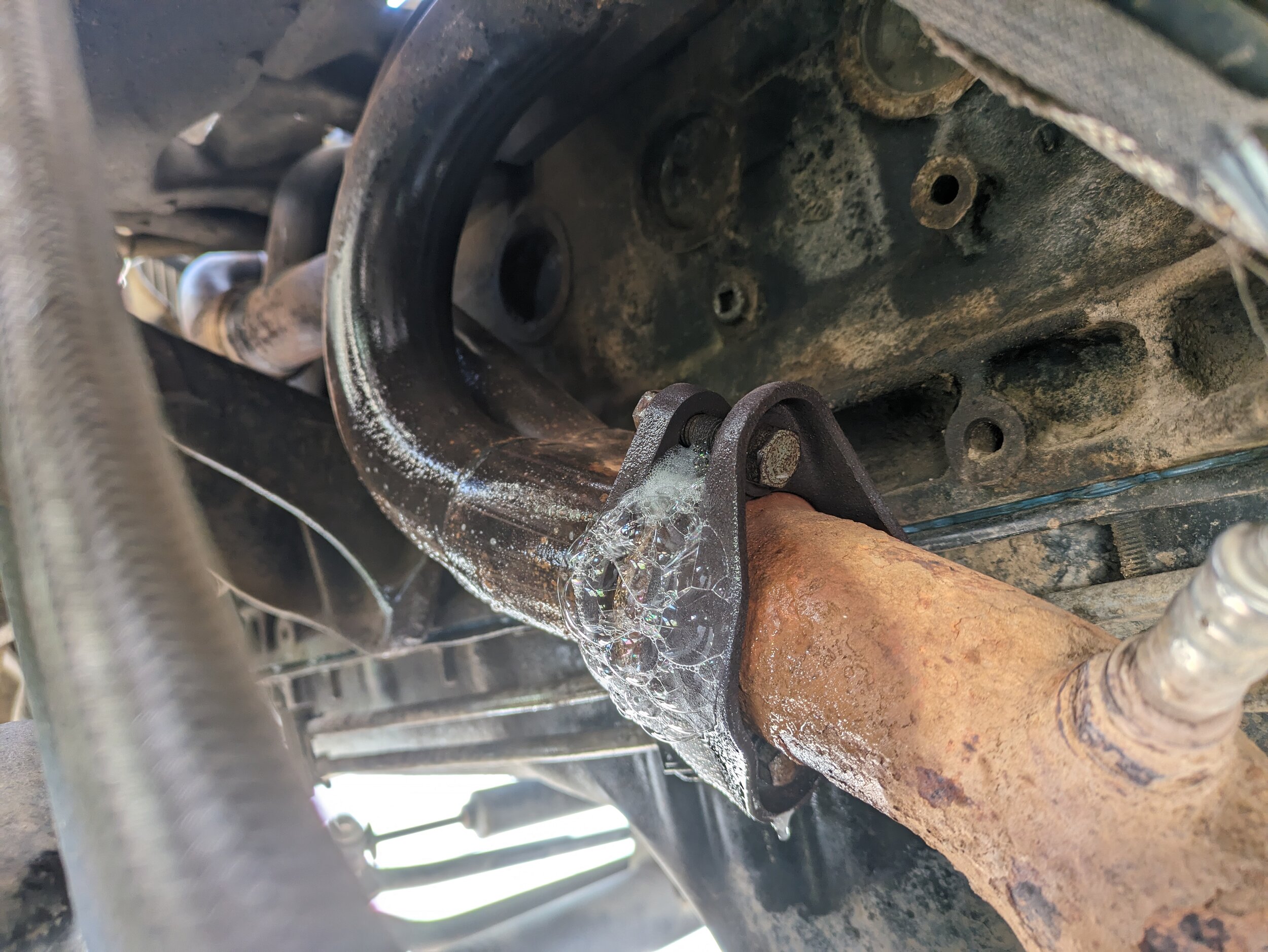

I leak tested the exhaust today by blowing air through the tail pipe with my shop vac. Only leak I found ahead of the cat is at the manifold to the exhaust pipe flange. I believe the FSM says torque spec for these flange bolts if only 23 ft lbs? I checked both bolts and they were already at or exceeding 23 ft lbs.
Am I wrong on this torque spec? I don't want to break a bolt, but I also need this leak to go away.

I would like to get this flange sealed properly and retest it to see if that improves the NOX. From what I know, any leaks prior to the cat will cause NOX to increase. I want to rule that out as a cheap solution before spending big money.

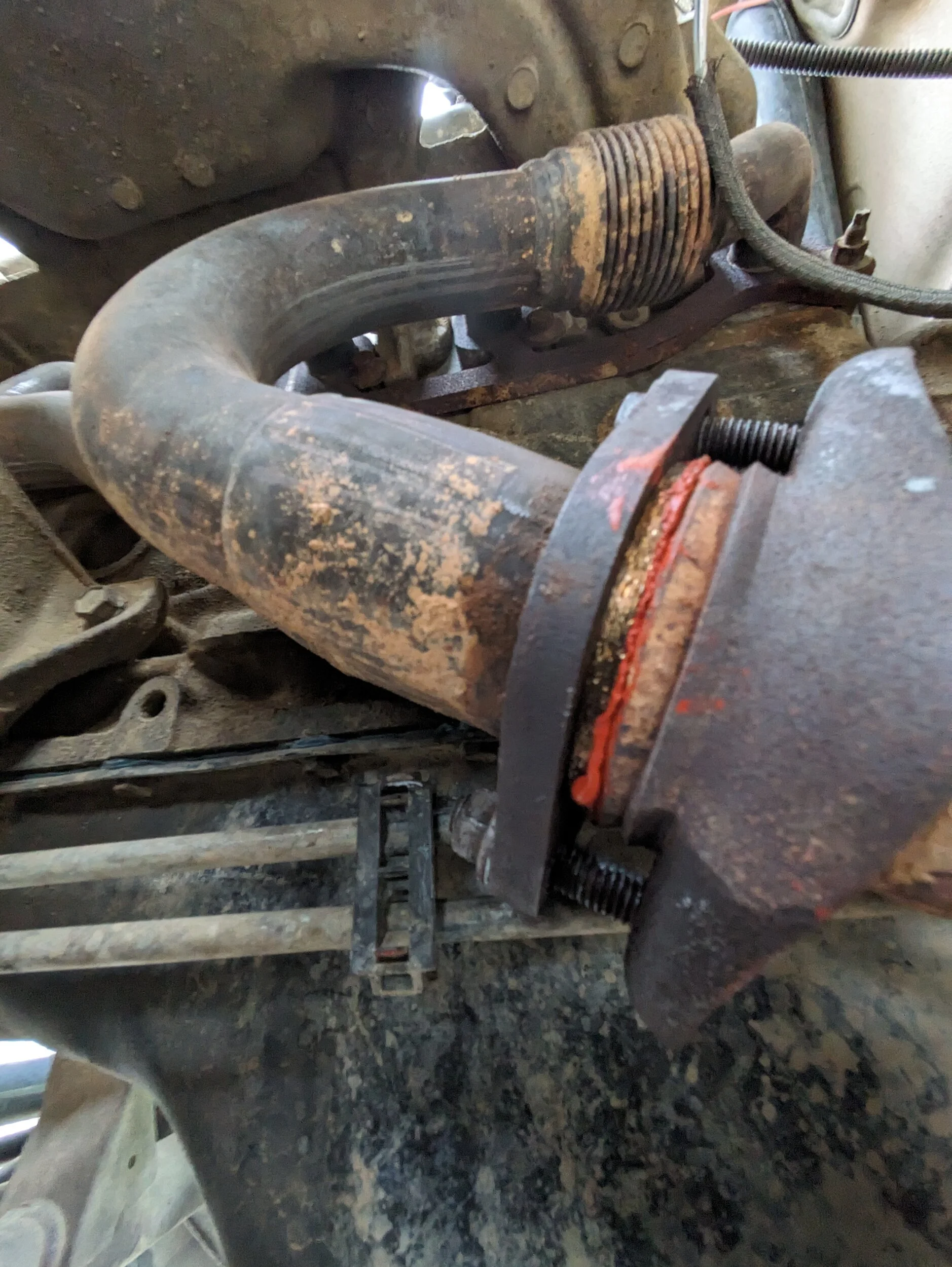

I've never had anything but trouble with those donut seals. Really been thinking about using a healthy coat of high temp RTV like Permatex Ultra Copper.
Might just want to start with a new donut seal.
Oh, and my exhaust kept loosing up...that would in turn let the seal errode and the chunks ended up in my CAT.
-Mac

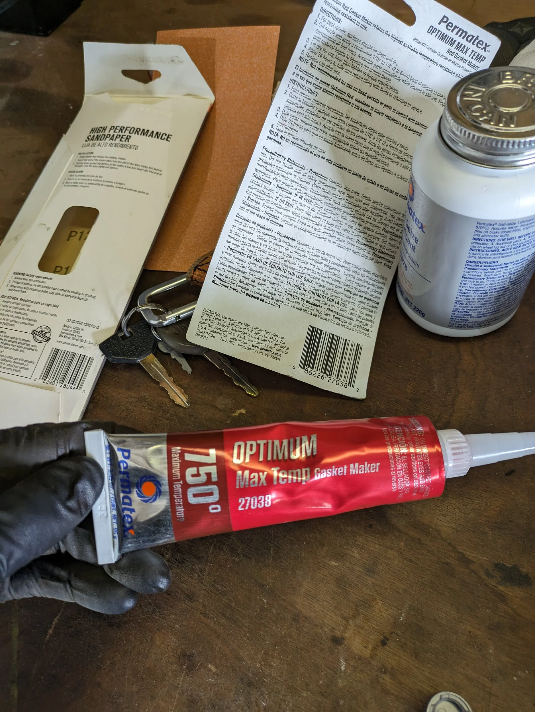

Hey Mac, if you were going to use high temp rtv to seal this flange, how would you go about that? Line both sides of the pipe with it before replacing the donut seal?
You really don't want to goop up the gasket. Just get another.
I agree. But I went through three gaskets and replaced the header and mid pipe. All mine leak just enough to cause the OP's issue. Luckily for me no smog test in OR.
Next time I have mine apart I'll probably try what I'm suggesting...but again...no actual experience.
Probably should just cut off the donut flanges and replace with a v band...but I don't want to void my Banks header warranty because I'm guessing I'll need it a few times.
-Mac
-Mac
Like it or not I went with your suggestion Mac. I'm going to let this cure tonight and then take it back in for a retest this week hopefully and see if that solves it or if I move on to the cat.
