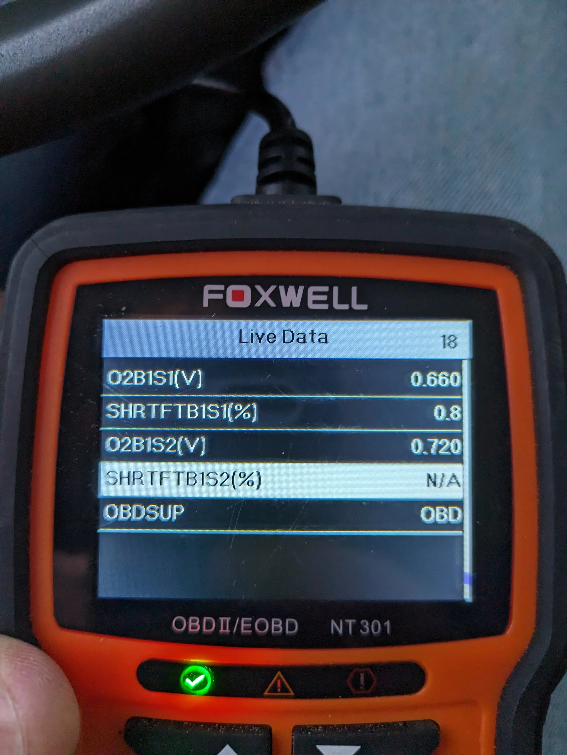

Here's some live data pulled last night, looks like the O2 sensors are at .7 and. 6v roughly?

And the voltages are not above.9v which is a gross simplification of the sensor operation but good enough to convince me you don't have an O2 issue.
-Mac

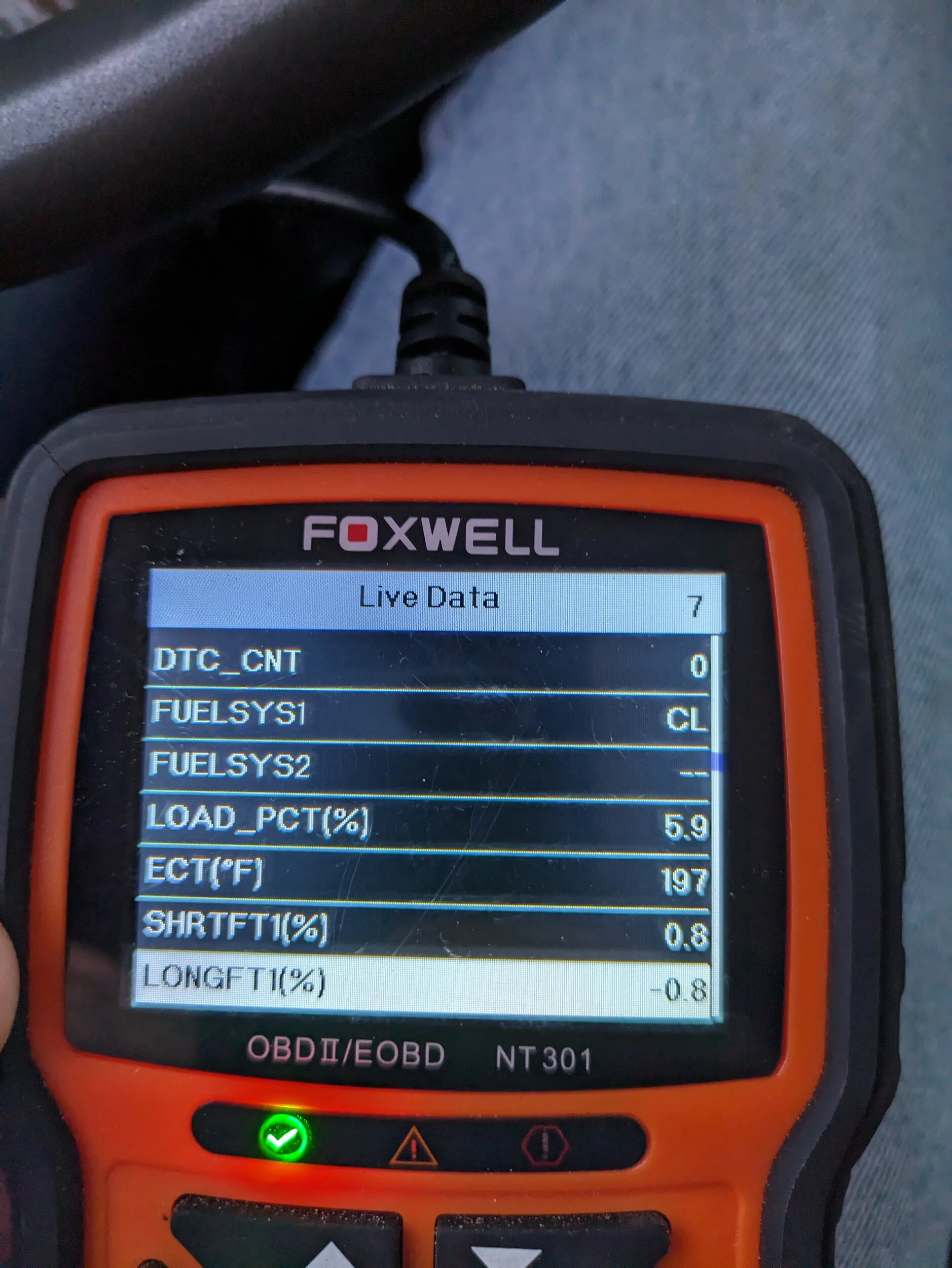

Today I was researching short and long term fuel trim and how to interpret results. I was monitoring live data in my driveway and the long term fuel trim was slightly negative around -0.8%, so slightly rich, but from what I've read is well within tolerable limits. One other interesting thing, I read you can diagnose a possibly faulty O2 sensor by disconnecting a vacuum line and the shirt term trim should immediately become positive indicating a temporary lean condition. When I did this, it had no effect on short term trim. So it's also possible my O2 sensor isn't working properly?
I would greatly appreciate other thoughts from anyone knowledgeable on fuel trim and diagnosing engine problems based on these results!
