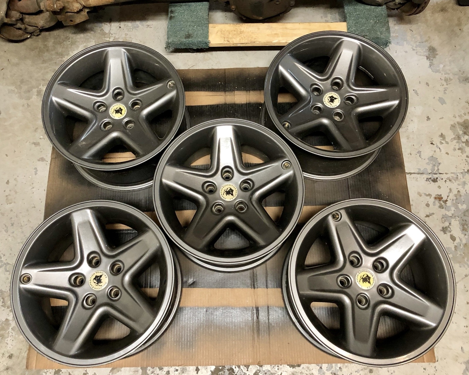

After more research I opted to scrap the JK wheel idea and actually came across a really nice set of 16x8 AEV Bridgers in Argent.
Going this route gives me a 5x4.5 bolt pattern and a backspacing that shouldn't need spacers. I also have a set of Cooper STT Pros in 315/75R16 that will be delivered tomorrow.

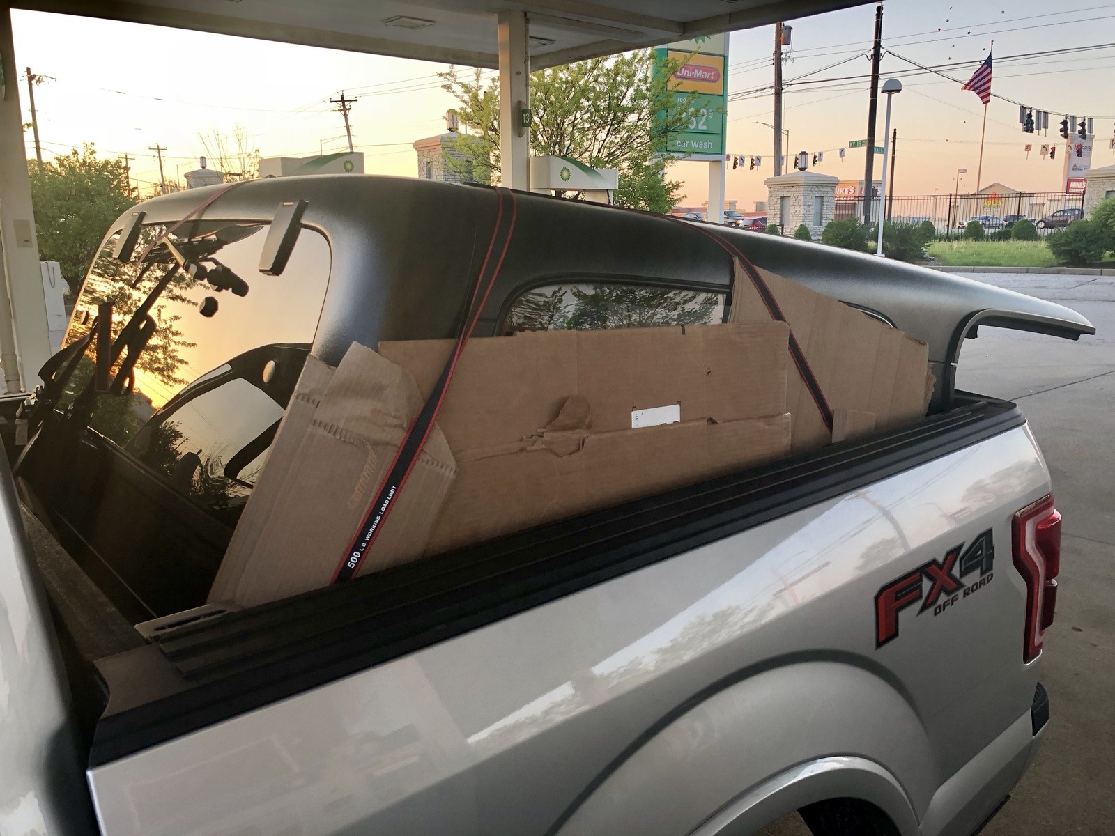

Told myself that I didn't need a hard top for the LJ since I have one for the TJ and it was mostly good at just taking up space in the garage. Then today this happened......
In the long run I'll be happy that I got one and will allow me to store the LJ outside in the winter without worrying about my frameless Bestop taking a beating. Now who has nice instructions on putting together a hoist?
Damn you have been bit lol. Your gonna have one nice LJR. That top looks mint.
Yeah I typically get sucked in to stuff like this pretty hard. This situation is different for me as I've got my TJ that I had specific plans for (and parts purchased) so when I moved over to the LJ my OCD kicked in and the build focus continued.
The top is in fantastic shape, just a few lighter scratches in the rear corners from a CB antenna and a pulley system that I may not even bother to touch up for awhile. It came up for sale yesterday north of me and I ran up this evening and picked it up after coming to an agreement. I'm happy to have one even if it will be stored for most of its life.
I also grabbed a set of TJ Half Doors a week or two ago.
They're in pretty decent shape but the passenger side door has a rolled edge on the bottom from a friend of the previous owner who dropped it. I'll end up doing some body work on that area (continuing my auto-body education) and then prep them and repaint both doors with a factory color match (they're already my LJ's color but need to be redone). I'll then throw on a set of OEM mirrors and probably have the lock cylinders rekeyed to match while I have the door apart. The interior panels are the light tan color from earlier TJs so I plan to prep and paint them with a color match for my Dark Slate Gray interior. SEM seems to make a color matched paint but has anyone else come across one in that interior color that works well on plastic/vinyl?
I honestly don't care about the hard top, but you're killing me with the half-doors score. I'm on the prowl for a pair big time. I was even tempted to discuss a trade with the guy I sold my TJ to, but I think I'd just be dumb to do that.

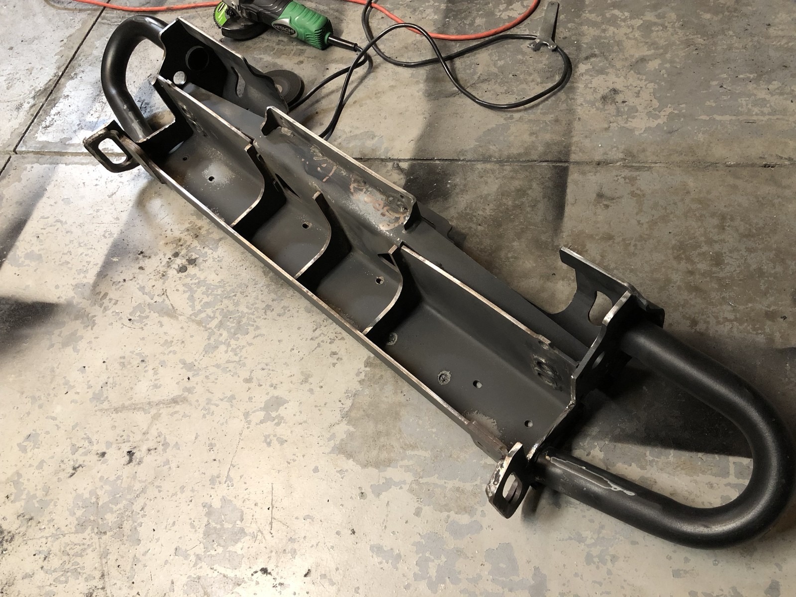

So I spent some time this evening getting the TJ ready to put up for sale, putting a few little things on the LJ and then worked on my Mopar front bumper so I can hopefully get it to the powder coaters tomorrow.
The bumper was in rougher shape than I thought when I got it. There was water and a good bit of rust trapped behind the front rubber bumpers and lots of areas where the powder coat had started to break off (powder coat hates sharp angles or edges and will typically separate easier from them over time). I had a local stripping place spend a few minutes on some problem areas but I still needed to hit some spots with a stripping wheel.
I also needed to modify the rear mounting area so that it will work with the Currie Anti-Rock I will be installing.
I contemplated having a welding shop cut out the areas with a torch but decided to go ahead and hit it with a cut off wheel and grinder. I made some rough measurements and marks after mounting the bumper on the frame but since the Anti-Rock isn't installed I couldn't check for perfect clearance. My hope is that I took off enough to not interfere with the Anti-Rock while leaving as much material as possible for structural integrity.
Tomorrow I'll drop the bumper and my Savvy control arms off to be coated. This will be round two on the control arms as the first color didn't come out right at all. Hopefully I can get them back before the weekend so we can start suspension work, fingers crossed......

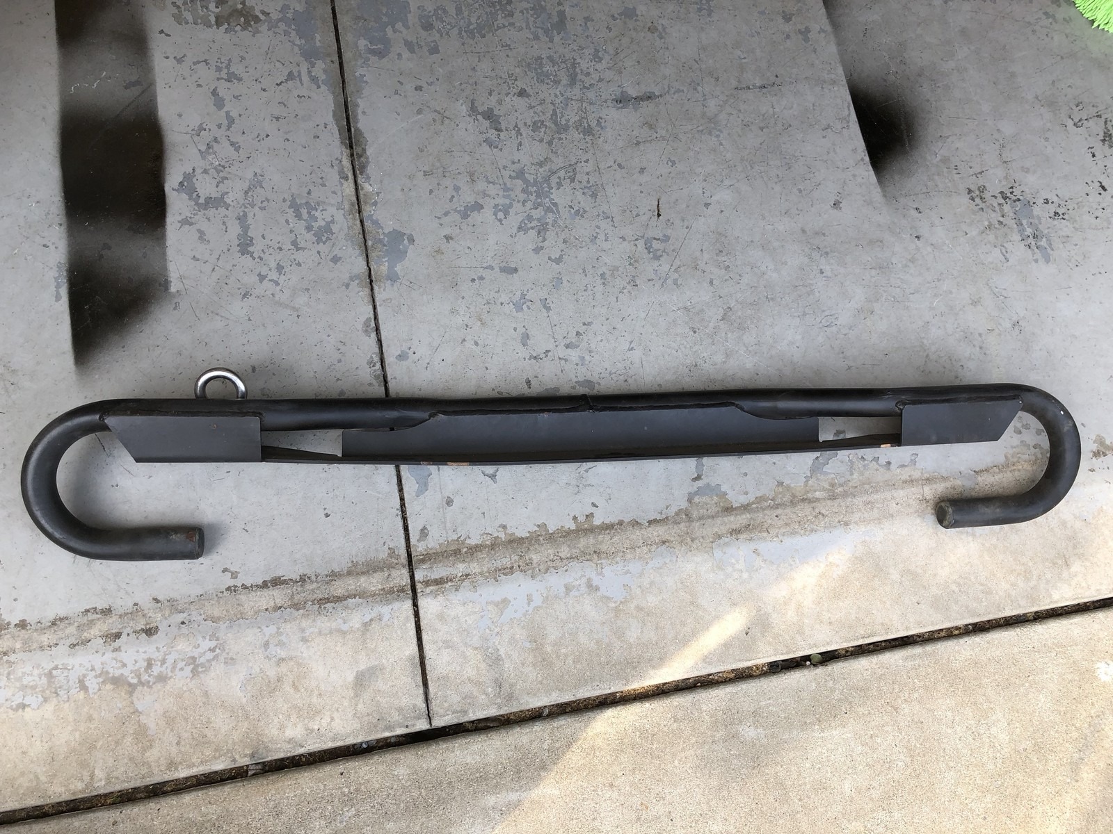

Today's delivery was a pretty good one. Mopar Rock Crawler Corner Guards by AEV.
I came across a NOS (New Old Stock) set last week and jumped on them. Shipped to me in the factory box with all hardware and installation pieces. Pretty excited as they'll pair well with the Rock Crawler front bumper, AEV wheels and I've got a lead on a rear bumper as I type. Hopefully that works out so stay tuned.......
Also, anyone know if these play nice with something like the ExoGate?
I think it would be tough with the exogate as there’s a big piece of metal that goes around your passenger tail light.for the exogate
Reactions: techster82
