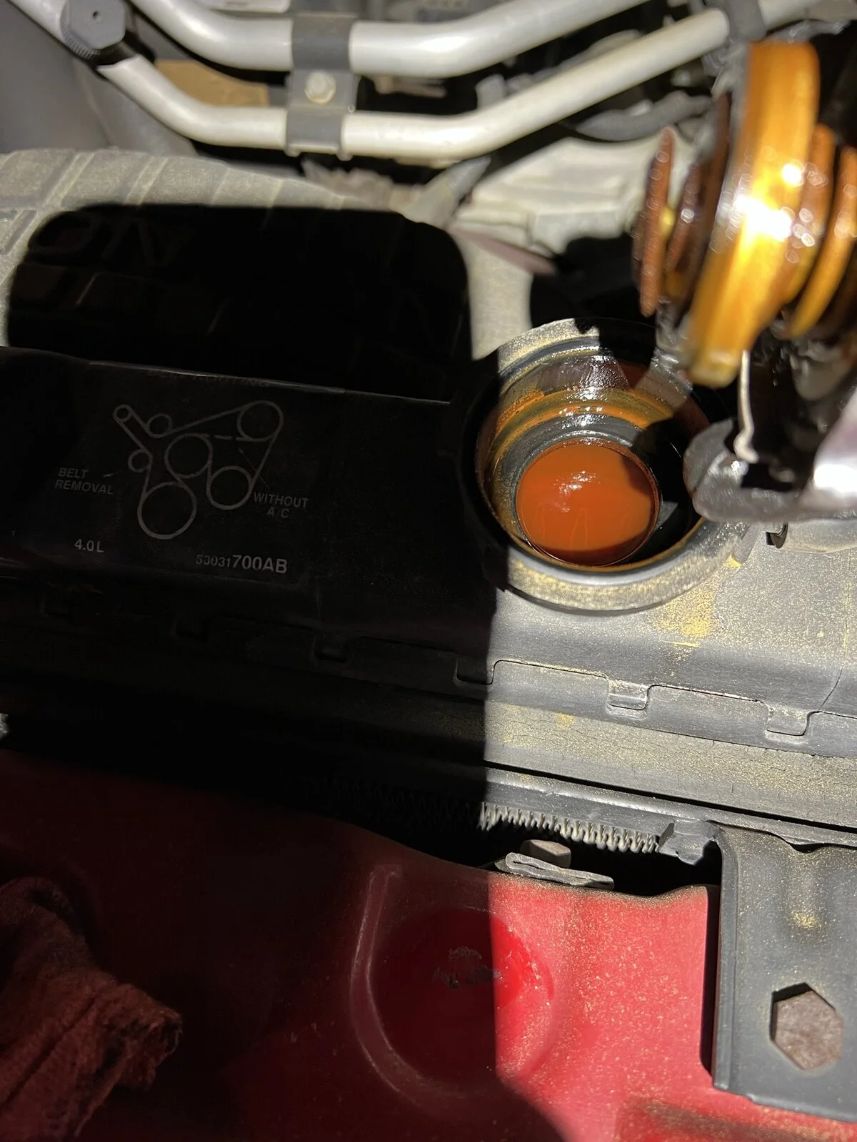

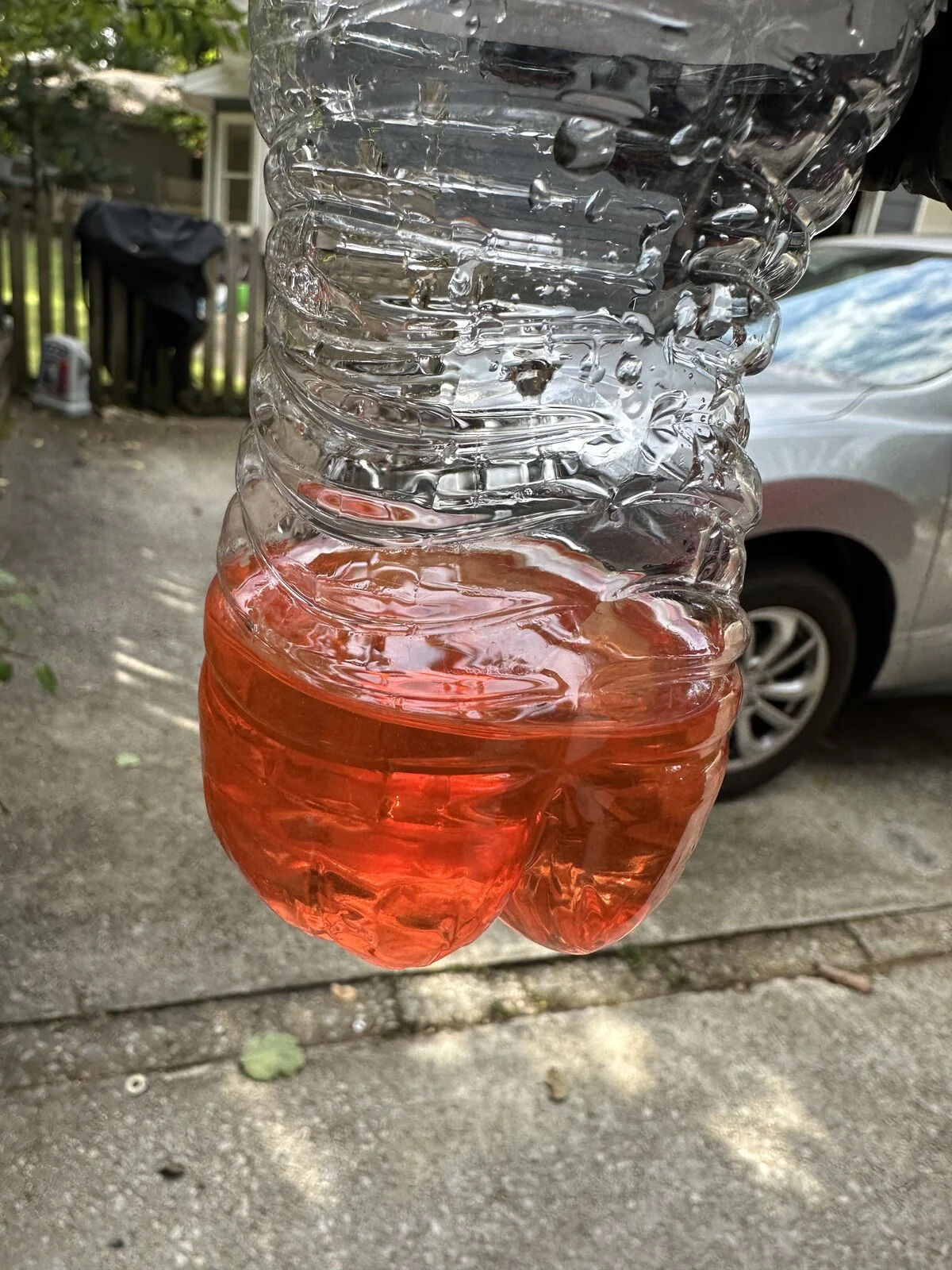

History is spotty, I picked it up last October with ~32k on the clock after it was mostly parked during the PO’s divorce. I did the typical fluid changes when I got it last year + replaced the rad cap with a new stant after the coolant was changed. Attached is what the coolant looked like before it was changed last year. Everything I’ve worked on has been original, so I’m assuming the water pump is as well.
Thermocure is in order for this weekend.
That's not coolant, that's a pumpkin spice latte smoothie.

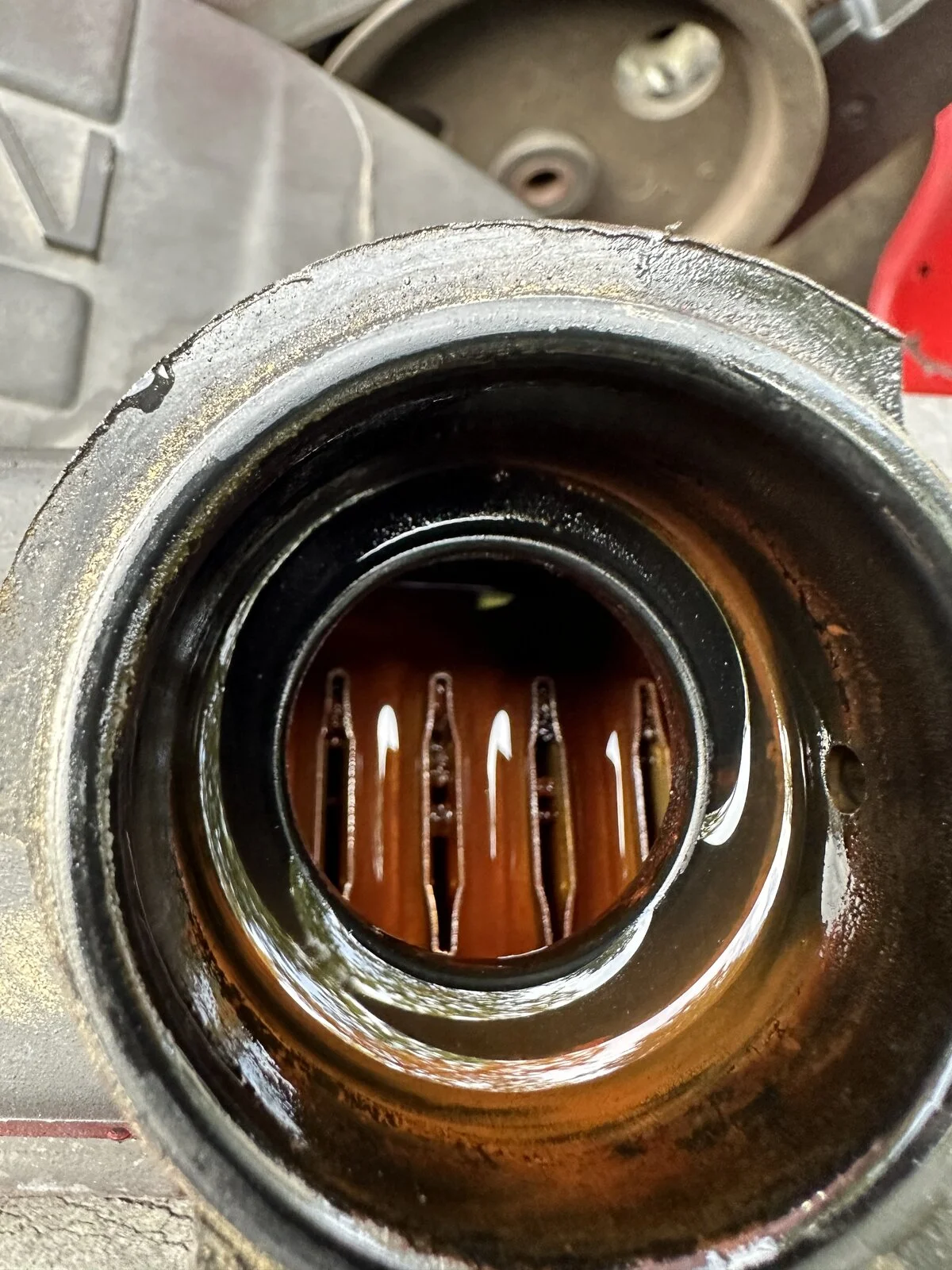

What I drained out…I can see crud/rust between the fins. So far I’m getting better temps with just Thermocure and water.

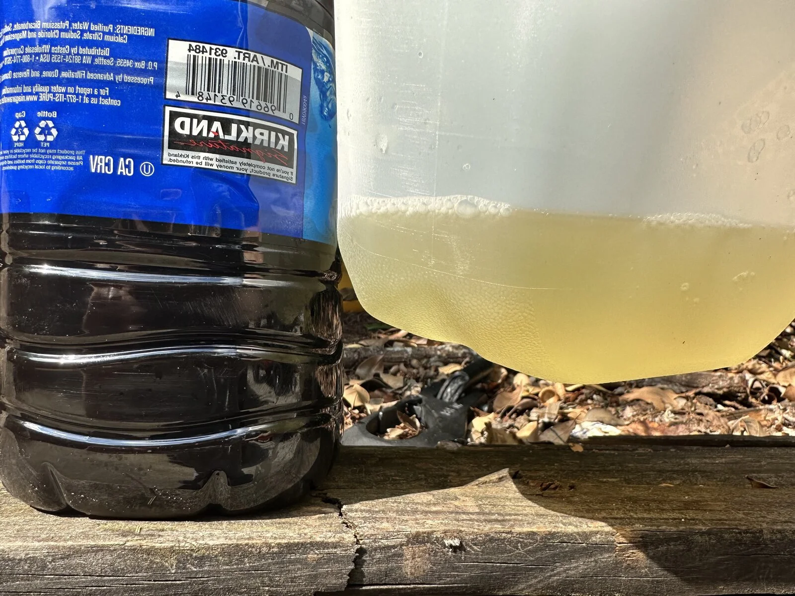

How it started and how it’s going. Should I expect it any clearer?
On the right is good, how many flushes to get there?
I'd put in the thermostat the way it should, a Mopar etc with the bleed hole drilled into it. A touch of grease on the lip will help it hold in place and get the clean surface or new cover that goes over it. Then fill with 50/50 HOAT like Zerex 5 and Distilled water.
Let it run and look for the thermostat opening up etc. I usually run it on my driveway that has a slight incline, and when it goes down, add a touch more until it steadies, then put the radiator cap on. Fill the overflow and done.

I ended up with two bottles of Themocure so I put one in on Saturday, run for about an hour ish, then drained and flushed with the hose on Sunday it was pitch black. What’s coming out now is from the second bottle and and ~3hrs of runtime since Sunday. I think I’m on flush 4, not including the time I just let the hose run down the radiator. I’ve been using old 5gal water cooler jugs…way easier than milk containers.

Here in the Austin, Texas area, so much calcium and other minerals, I don't wash mine with anything but distilled. It's a pain to a degree, but I just try to keep anything out. But it looks good you should be good to go.

the first two times I ran the hose the help get some of the extra crud out, the rest have been distilled
