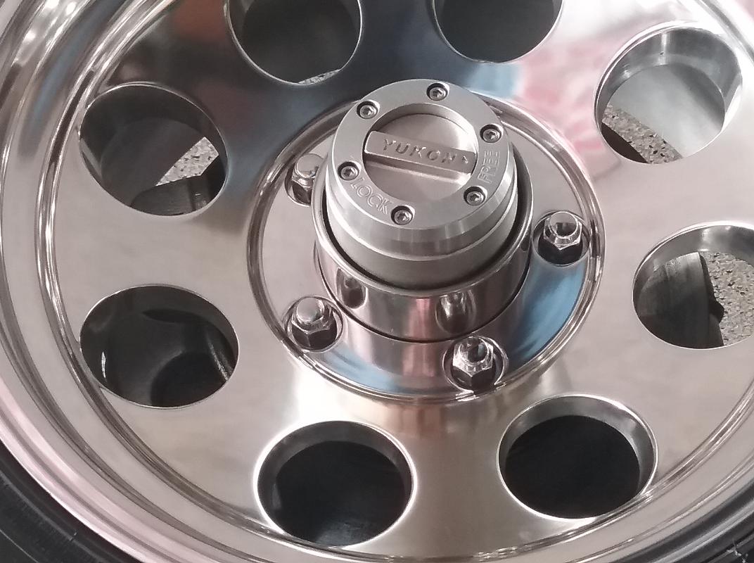

The rear shaft rarely has an issue. They do, just not very often. That means you could do a hub kit up front, unlock them for flat towing and only have to deal with one driveshaft. A bit of prep work and the right tool and that's a 2 minute job.
^^ This.
I have been flat towing jeeps since the mid 1960's. Every one has had manual front hubs, including my LJ.
Back in the day, before big engines and big tires and lockers, there were kits to convert the rear axles on CJs to full floaters in order to add Warn hubs or interchangeable smooth and splined drive flanges so that nothing in the drivetrain would spin during flat towing.
^^ This.
