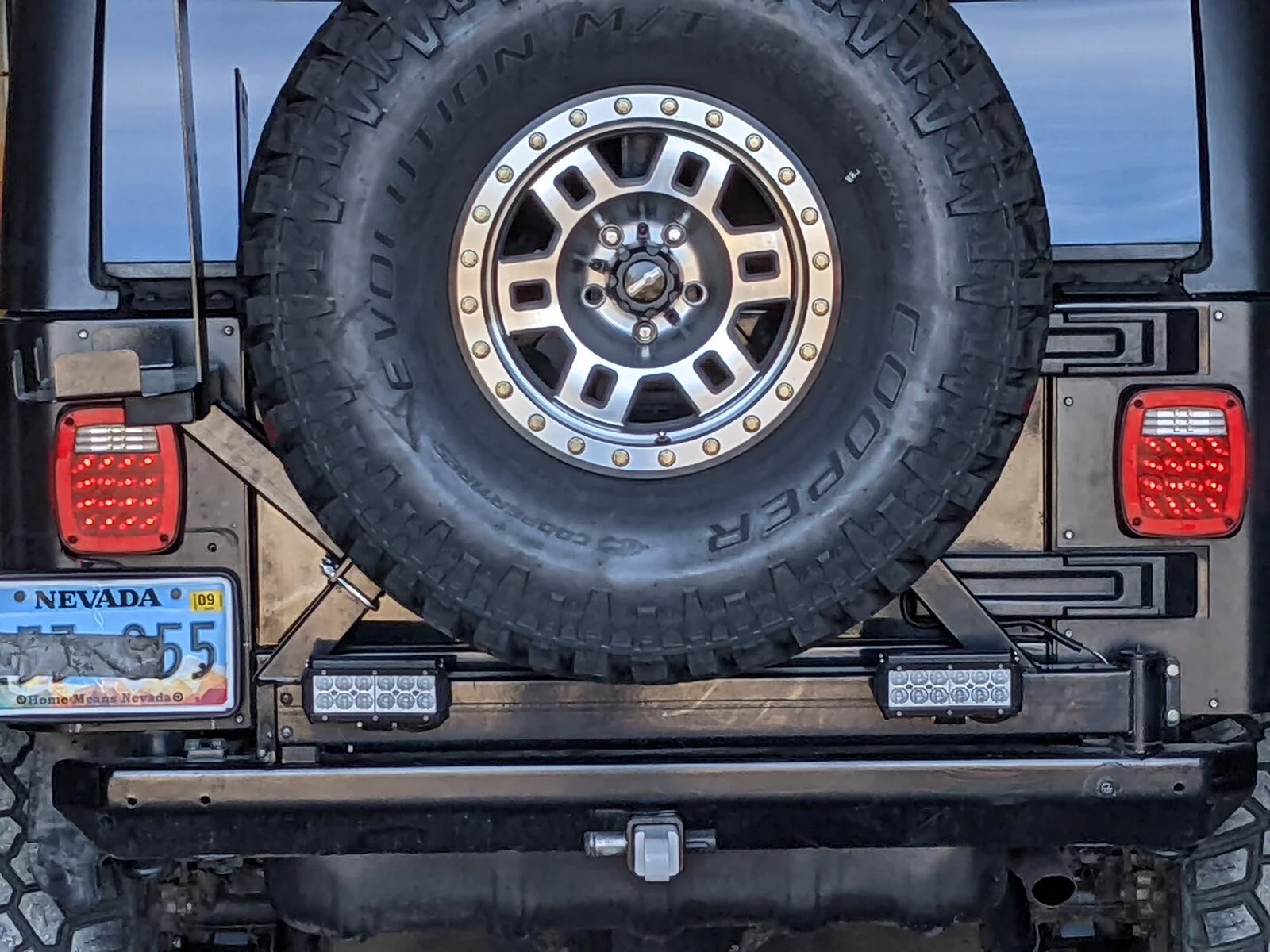

I mistakenly let myself believe the MetalCloak would not require license plate relocation. Quit mid-install to reassess. I won't do OEM flush mount with corner armor in place, or any that require cutting - too much work for my taste. Hoping I can convince my local TJ buddies to take these off my hands and I'll just bite the bullet and go MaxBilt. A minor cut in the OEM license plate holder is all that's required to fit MB and I'll get some plate bolt lights for that.I'd love to hear your thoughs after you install these. I've been curious about them. I like the lower profile but not enough to spend the $ on the aluminum.

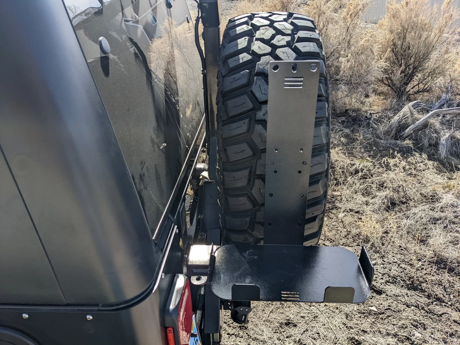

Are those rock hard can mounts?

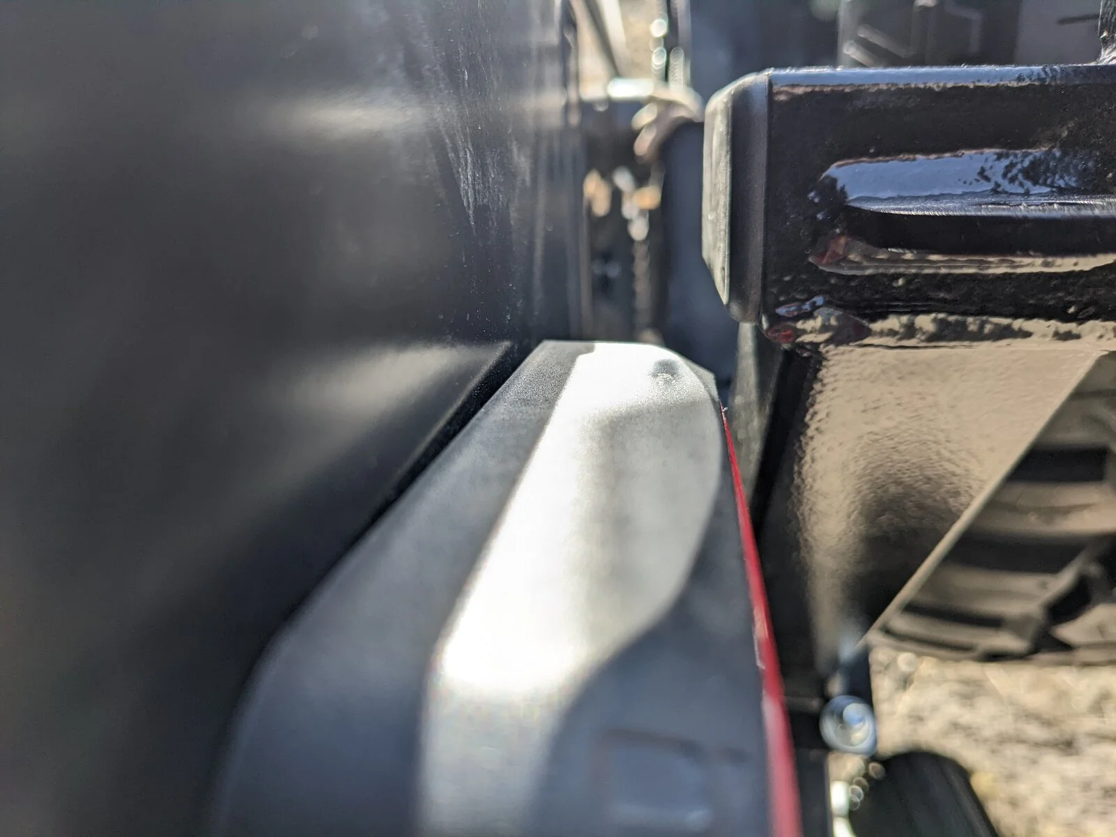

Yes, and the reason I did the LED lights. OEM tails with guards would not clear the mount on the Currie bumper. RH said driver's side would not be an issue (without the guards) but passenger side will not work. (Even with the lopro LEDs I had to move my tire bracket out an inch to clear the top of the LED). I went ahead and did the LEDs, hoping the passenger side might work with the stubby lights, but it looks like the can carrier will work only when I have the hard top off, which might be fine because my summer trail rides/camping will likely be w/o the top. Still messing and measuring before I dump more coin on another can rack.Are those rock hard can mounts?
Thanks,it looks like the can mount need to be shimmed up.I know they are expensive if I’m gonna have to cut and reweld eBay has a set for 135.00 for both but most likely way flimsyer,and gas is heavyYes. And the reason
The Currie bumper has it's pivot much closer to the tub than other tire carrier bumpers. At least that's my assumption.
Didn't shim, just moved the tire an inch out with bumper adjustment.Thanks,it looks like the can mount need to be shimmed up.I know they are expensive if I’m gonna have to cut and reweld eBay has a set for 135.00 for both but most likely way flimsyer,and gas is heavy![]()
Oh I was talking about the platform,it looks like it’s falling off to the left,is that a cb mount too,will be checking on these,I have just bought 2 wavian cans for overlandingDidn't shim, just moved the tire an inch out with bumper adjustment.
1/2" spacer would have done it if there was no adjustment available. Just so the can rack could be moved up.
I'll have to check level on it. Nothing jumped out at me visually.Oh I was talking about the platform,it looks like it’s falling off to the left,is that a cb mount too,will be checking on these,I have just bought 2 wavian cans for overlanding

I'm liking the Metalcloak LED Tail lights....did you have to relo your license plate holder?

I modified the OEM bracket to screw into the lower OEM holes, screw mount license plate lights wires through one of the upper existing holes. Had to mount the plate, bend it up for access to mount the plastic bracket... and all sorta BS.I'm liking the Metalcloak LED Tail lights....did you have to relo your license plate holder?
It looks like he did based off of the dirt embedded from moving it.I'm liking the Metalcloak LED Tail lights....did you have to relo your license plate holder?
So does Metalcloak mention the need for relocation in their ad for their knock offs?I modified the OEM bracket to screw into the lower OEM holes, screw mount license plate lights wires through one of the upper existing holes. Had to mount the plate, bend it up for access to mount the plastic bracket... and all sorta BS.
Then I found the Savvy bracket online, in stock even. Would have gone that route probably.
