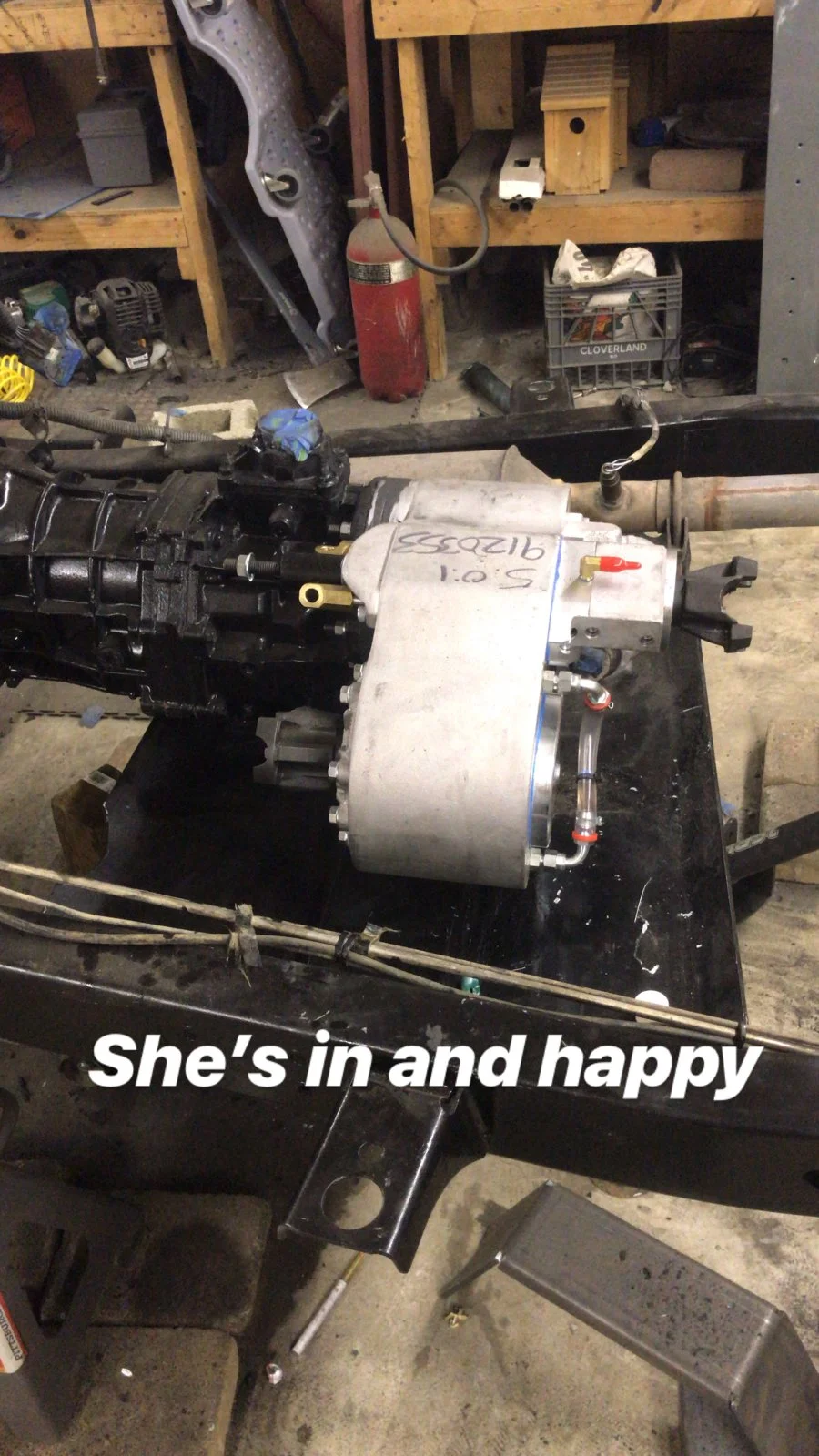

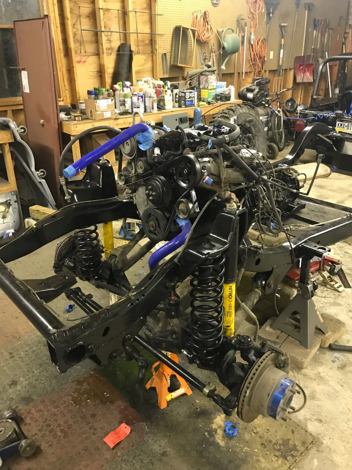

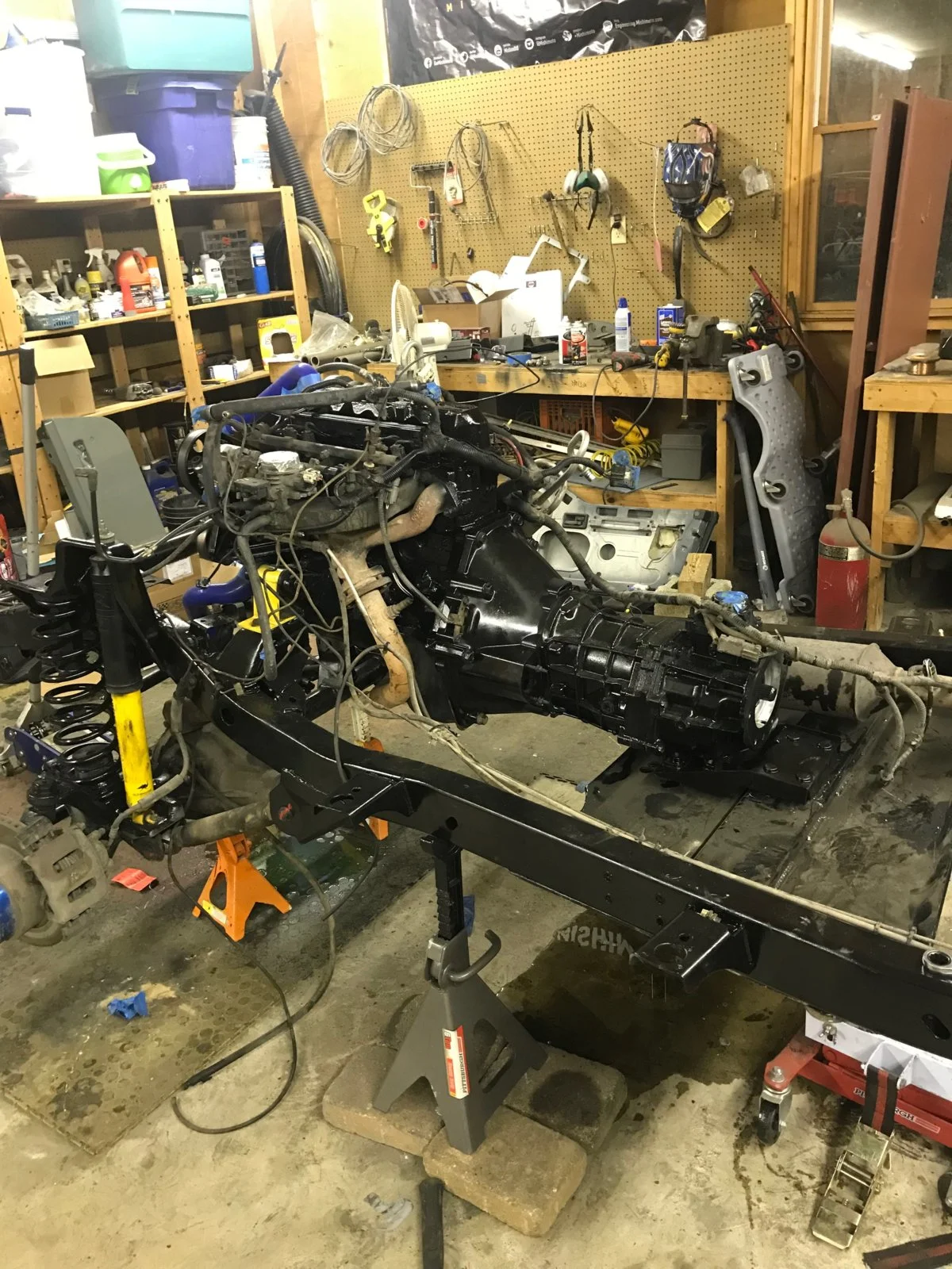

Spent last night after work getting the engine and transmission bolted in and lined up. Also got the engine etched, primed and painted. Got new Mishimoto coolant lines installed and installed my new PSC power steering pump as well. My atlas got delayed a week so it wont be here until next week and I am suppose to have the jeep done by the 29th. So the time Crunch is way to extreme and I'm sweating bullets but we will see what happens.

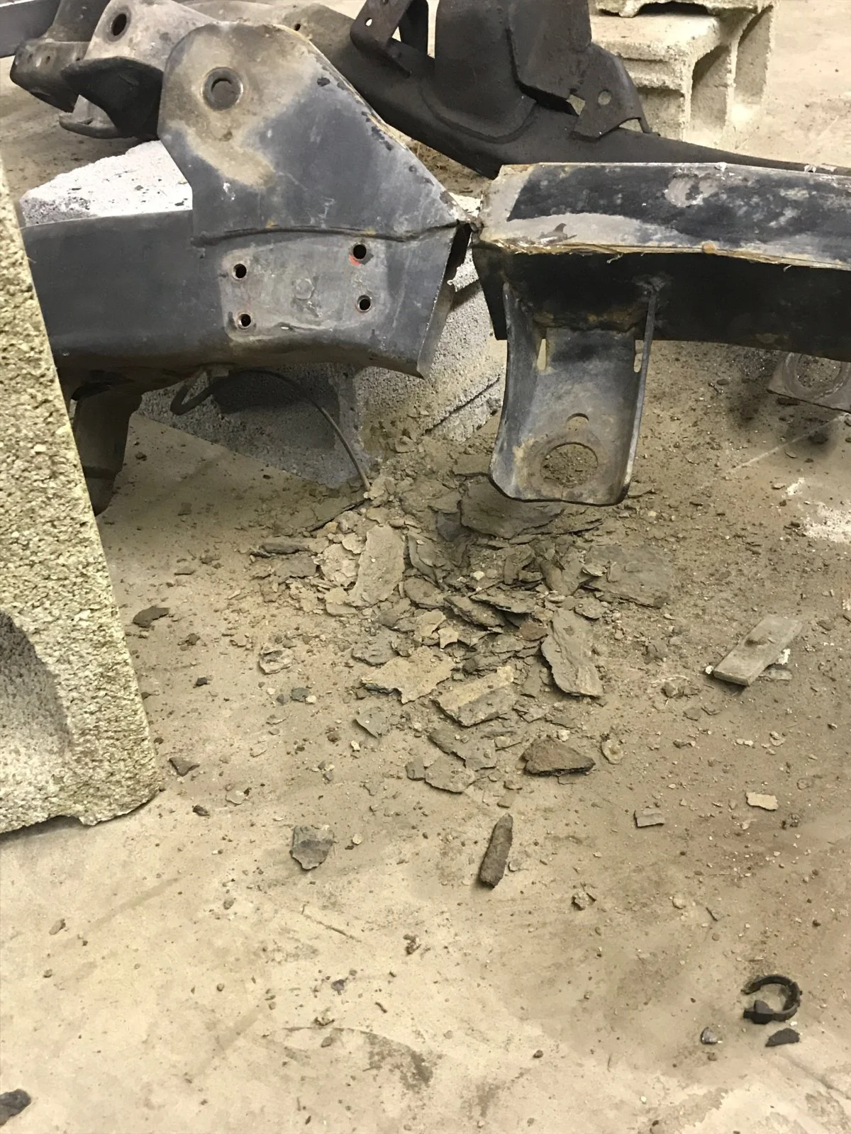

Sorry @Mike_H haven't forgotten about the highline details and write up. Just been swamped trying to get this thing back together for next weekend. This past weekend and week I managed to cut the old frame apart. Man please, everyone start washing out your frames and doing some sort of coating on the inside. This is the amount of rust I had fall out.

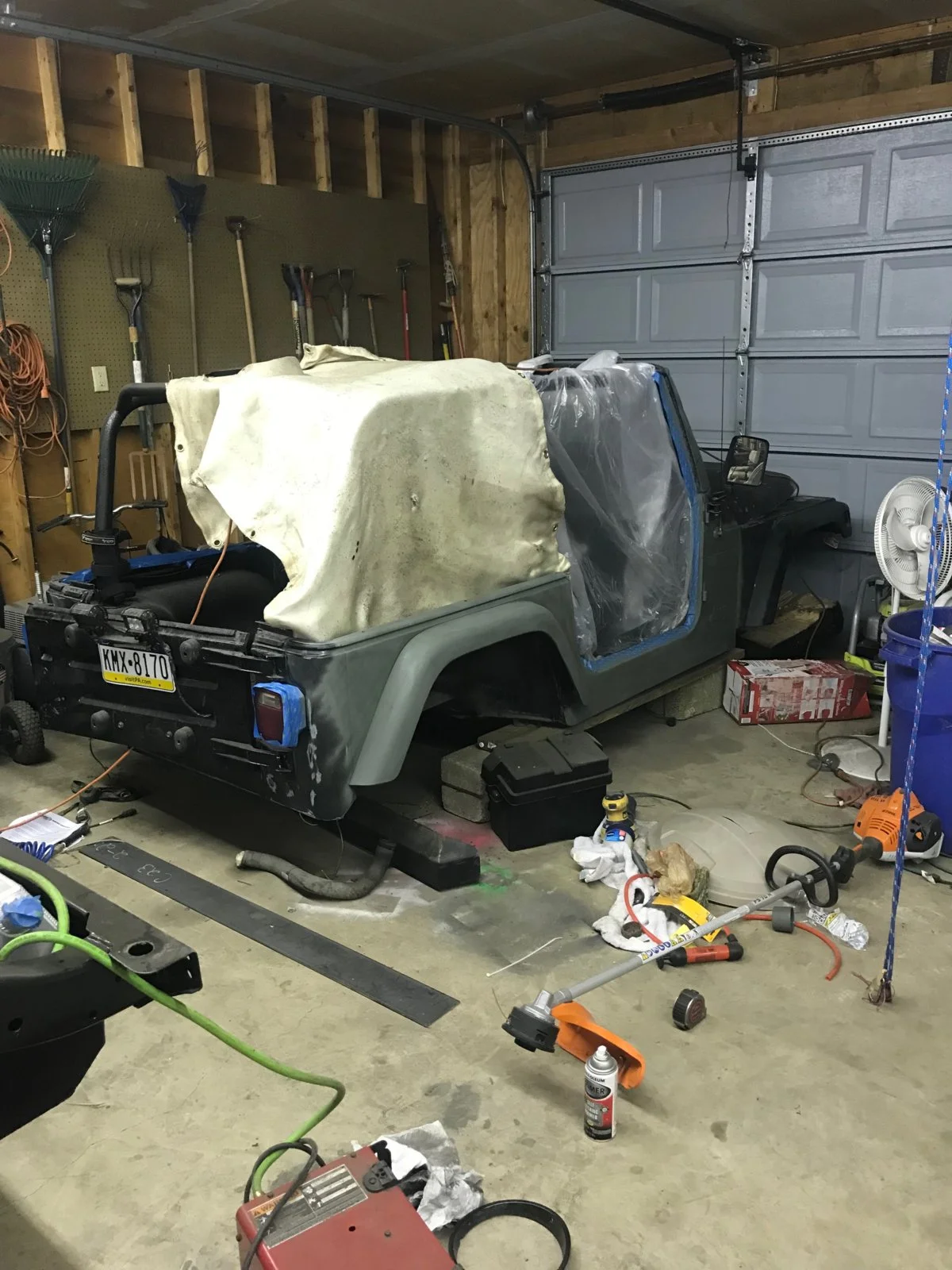

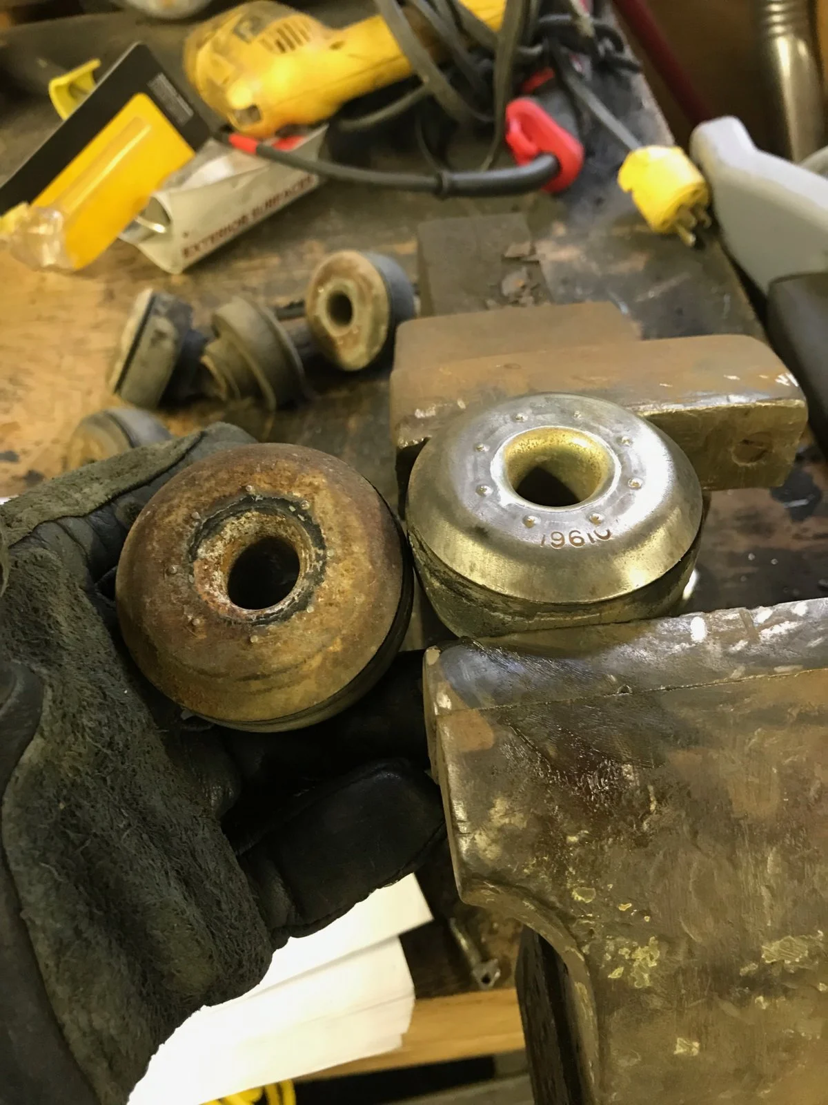

After cutting up the frame, I was still waiting for the atlas to get delivered so I started sanding and priming the Jeep to get painted. I also wire wheeled, primed and painted the body mounts. They were looking pretty rough but all seemed to be able to be saved. IMG-5759.JPGIMG-5732.JPG

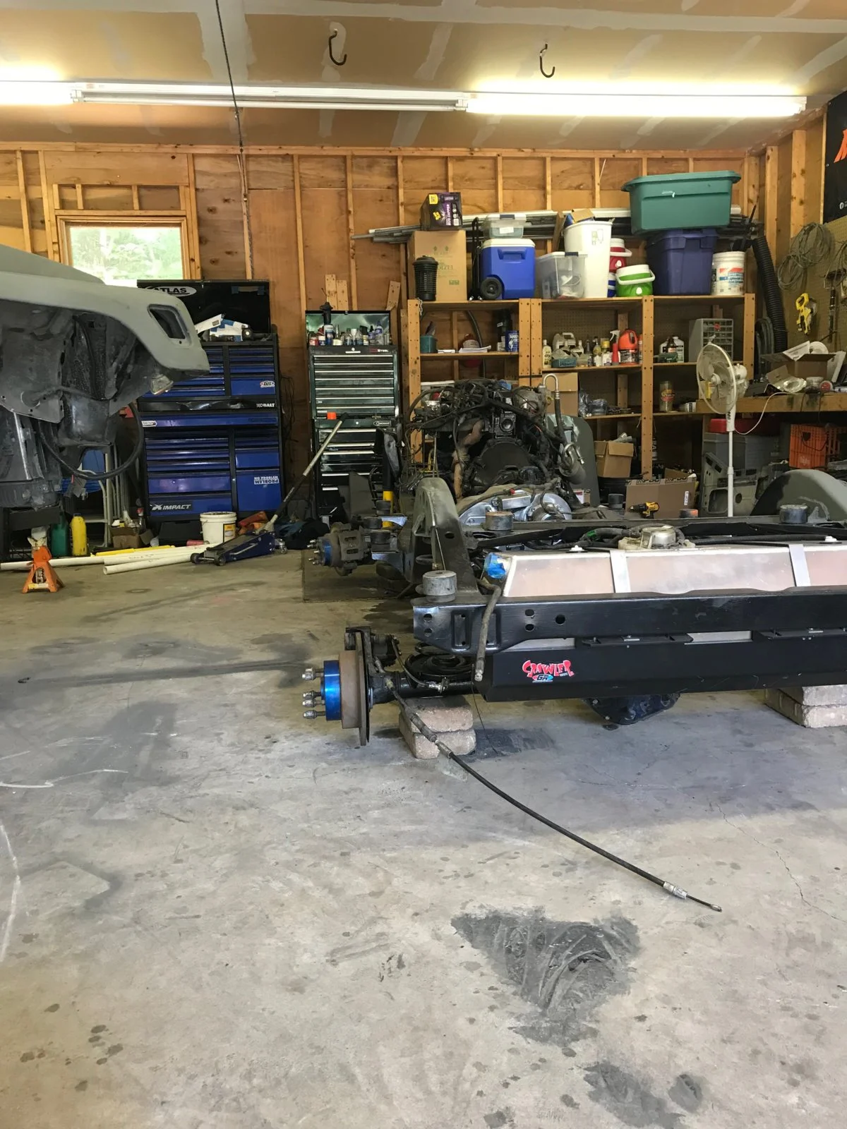

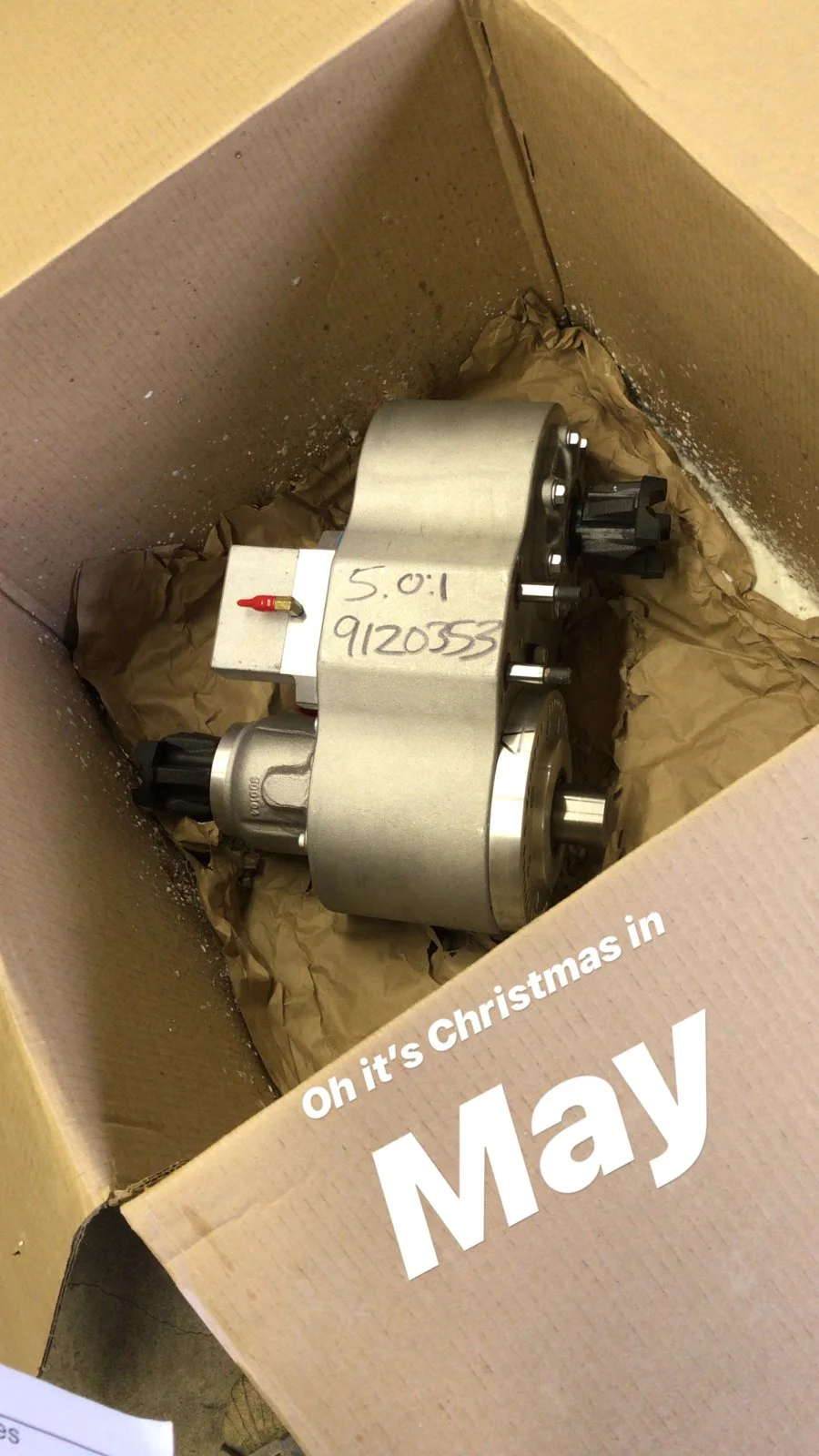

Finally the atlas got delivered Tuesday afternoon so I spent all night setting up and installing the unit. Went with a 5 to 1 crawl ratio because that 2.7 in the np231 was just way to fast. I'll see how she does next weekend but the next item on the list is a black magic brake kit upgrade inorder to be able to stop her. and I also spent last night trimming the axle bridge to be against the diff housing. I also have the GenRight double triangulated rear kit that allows for the 5 inch stretch. I got that welded in last night but didn't take any photos.

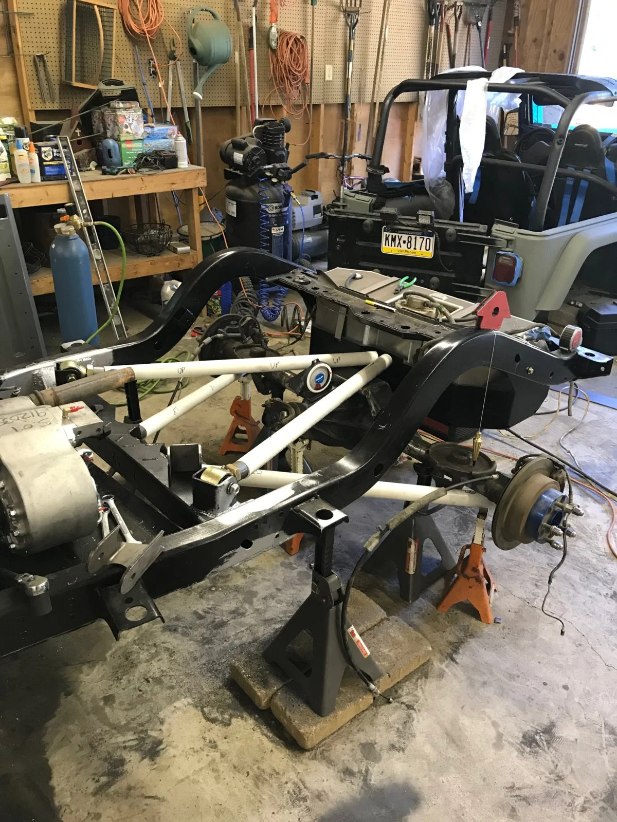

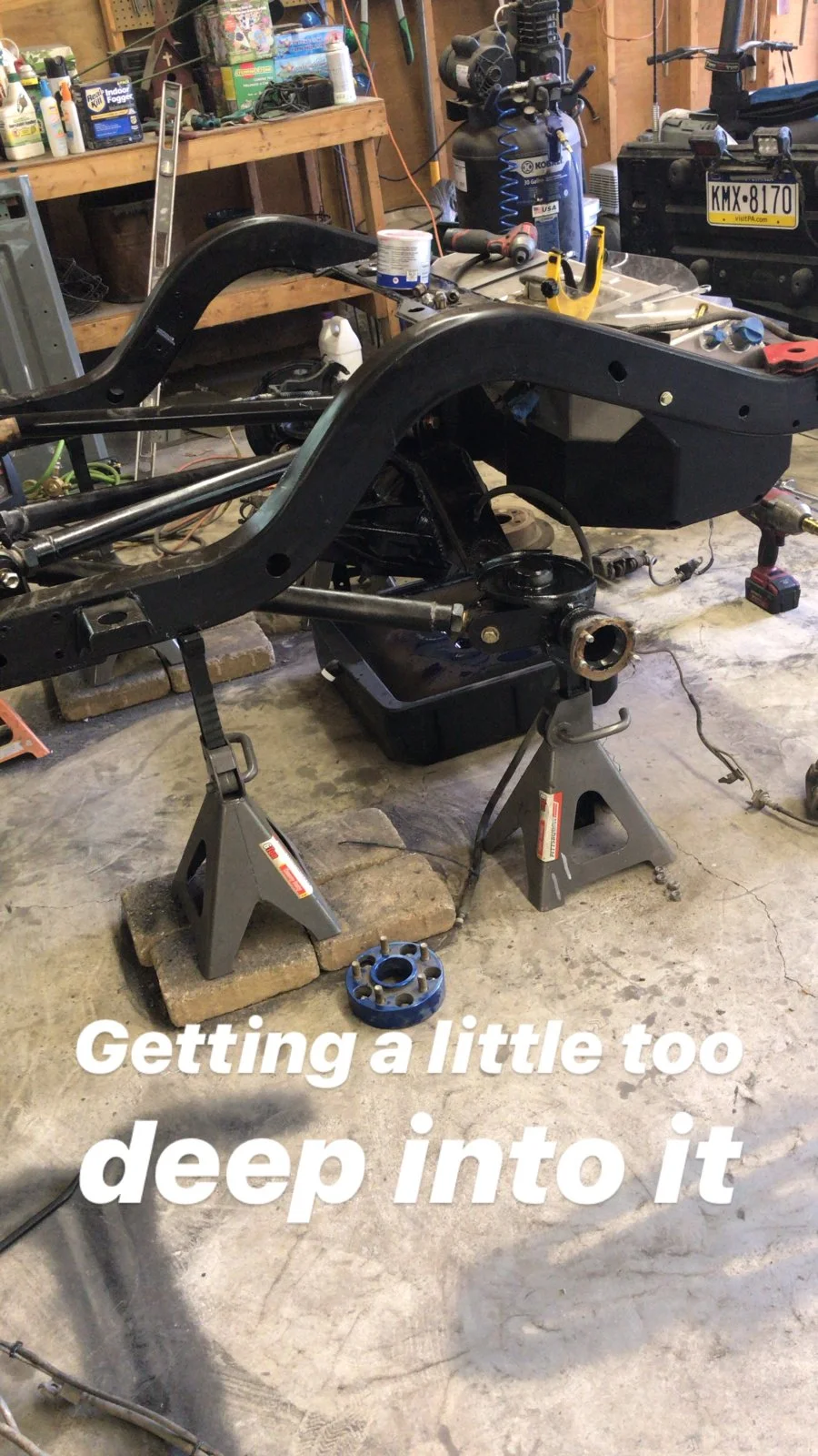

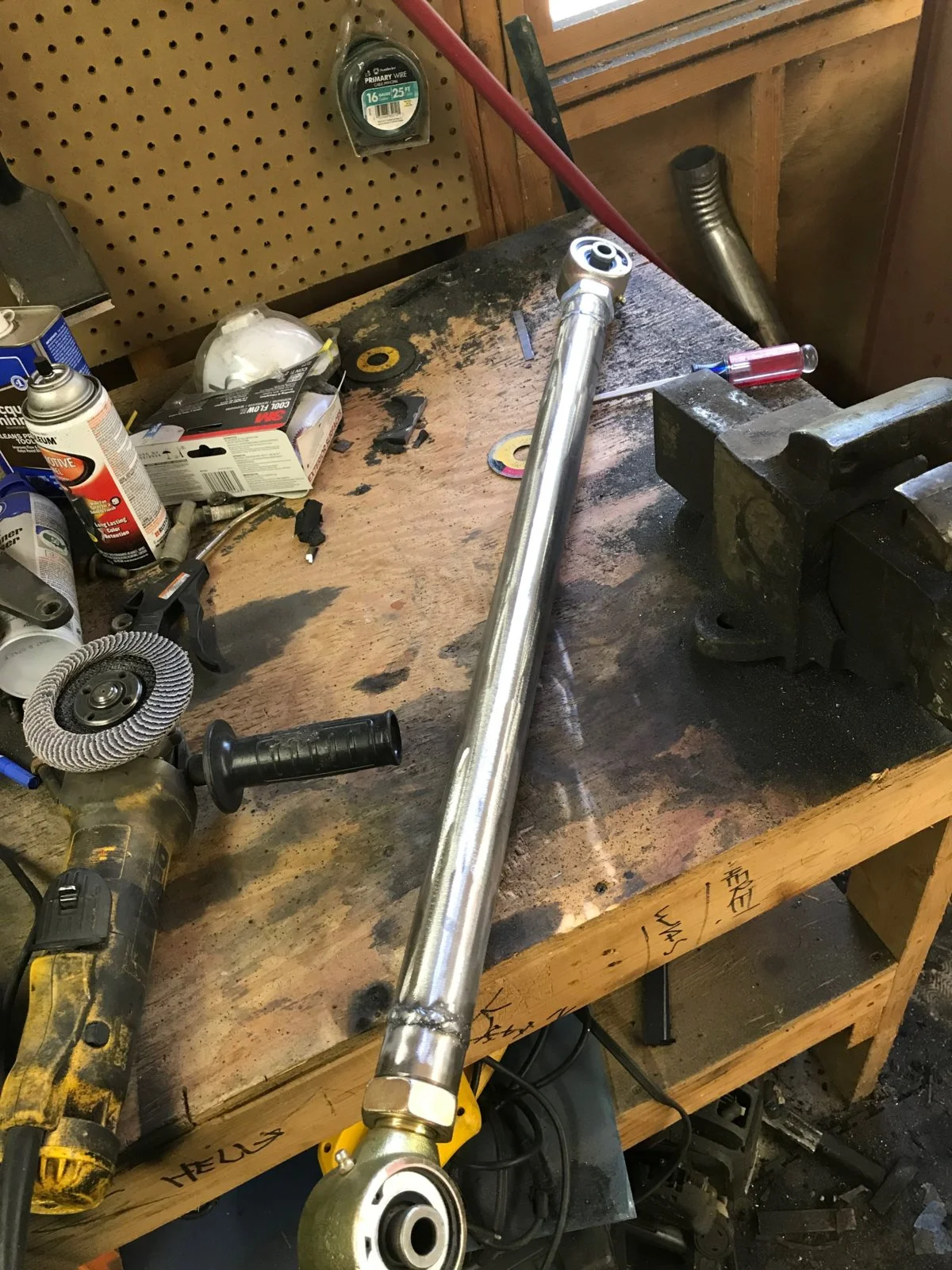

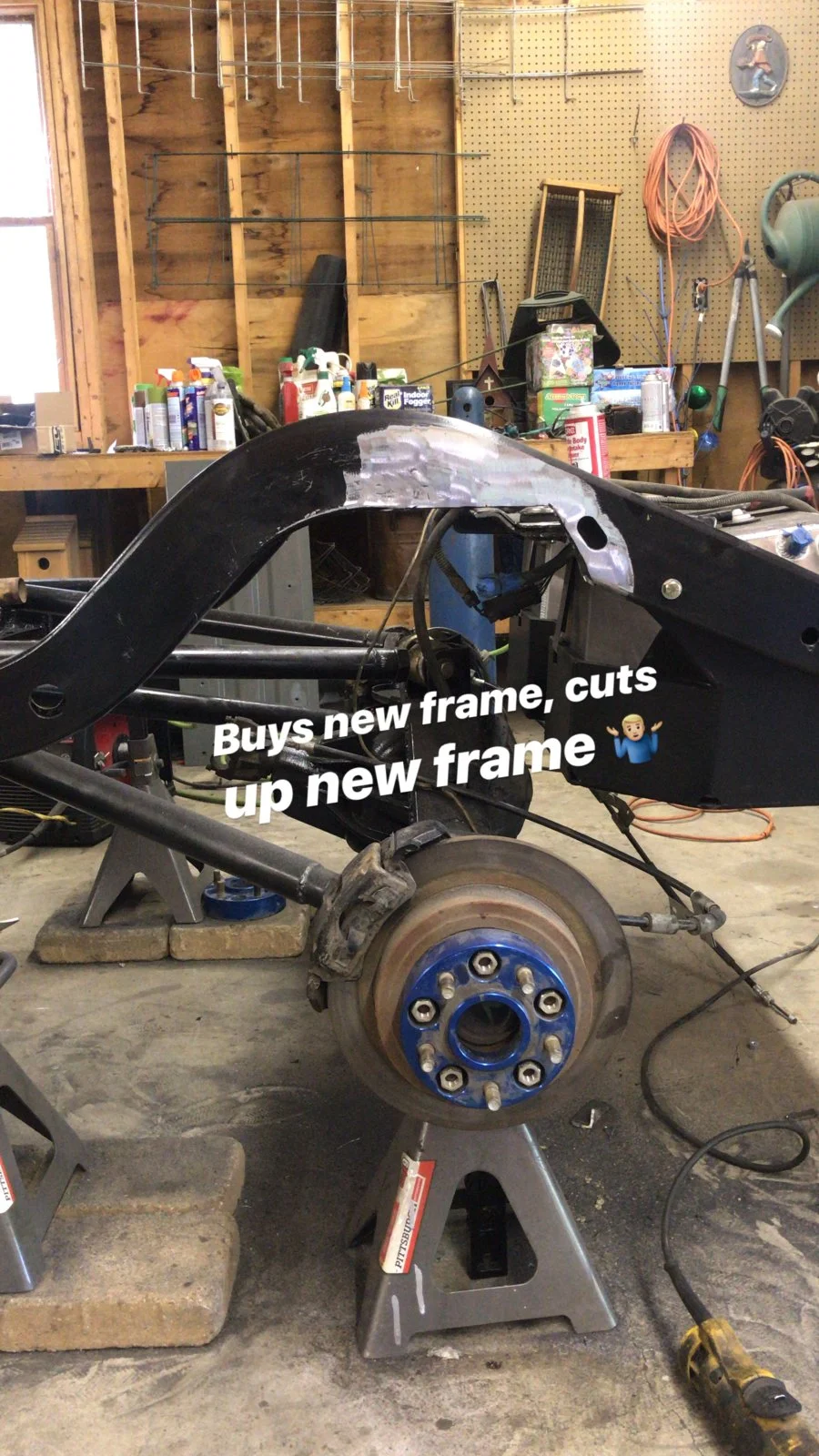

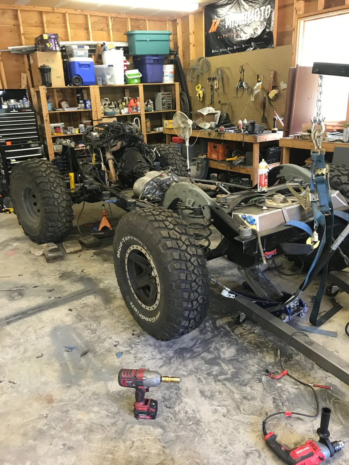

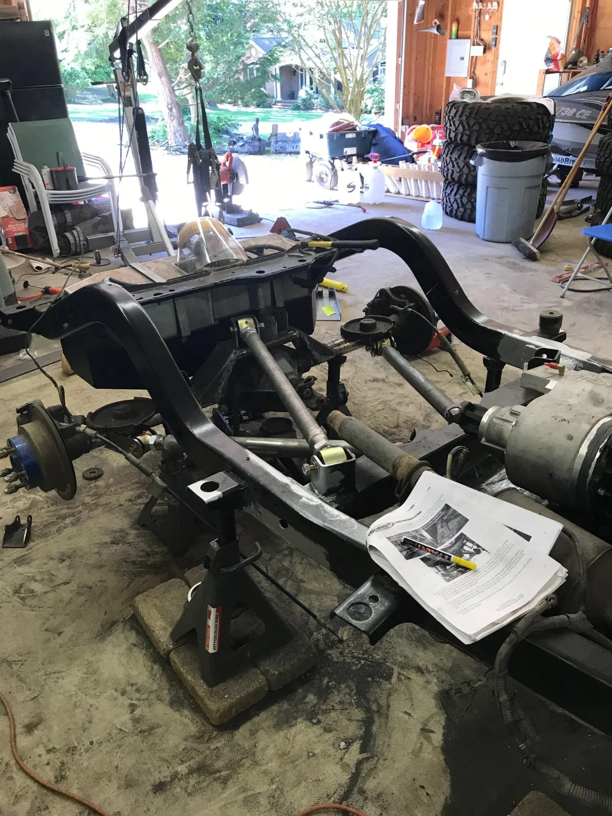

So this weekend was pretty busy for me. Got the Genright Double Triangluated 4 link 5 inch rear stretch in. Man did that take a lot of calculating, measuring and welding. Created the arms in PVC first which really helped fine tune the length.

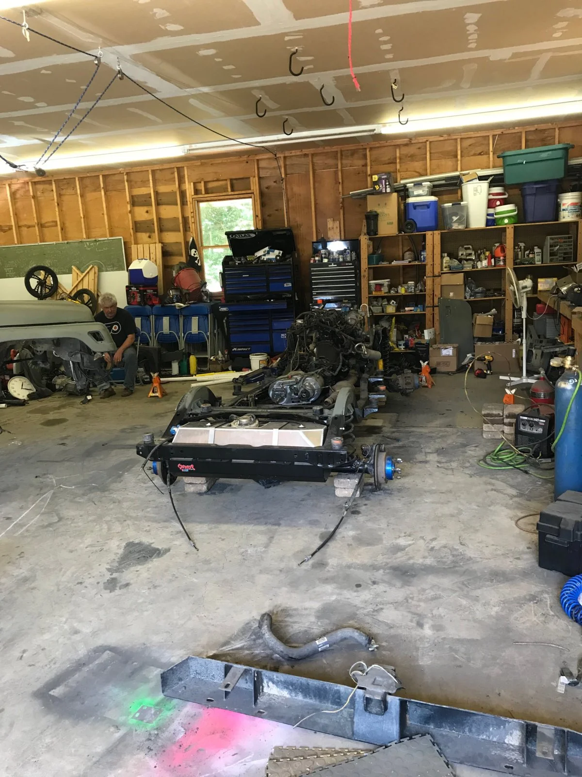

I then flipped the calipers to the front, threw the tires on and took some measurements. Used the engine hoist to get the frame up to ride height and measured from spring perch to where I wanted the new spring perches to sit. Took out the angle grinder, hacked the frame up and tacked in the new perches. Threw the springs on and drank a few beers when she sat level.

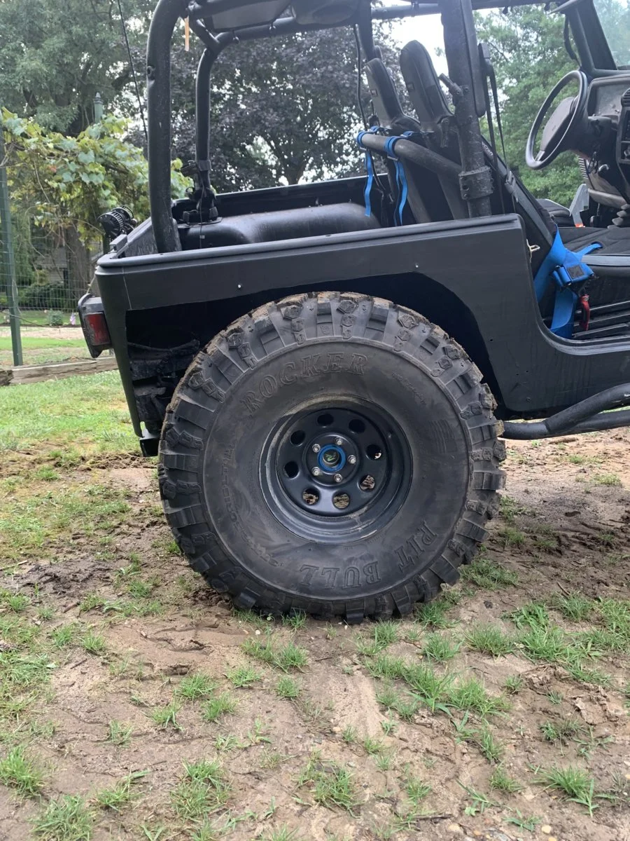

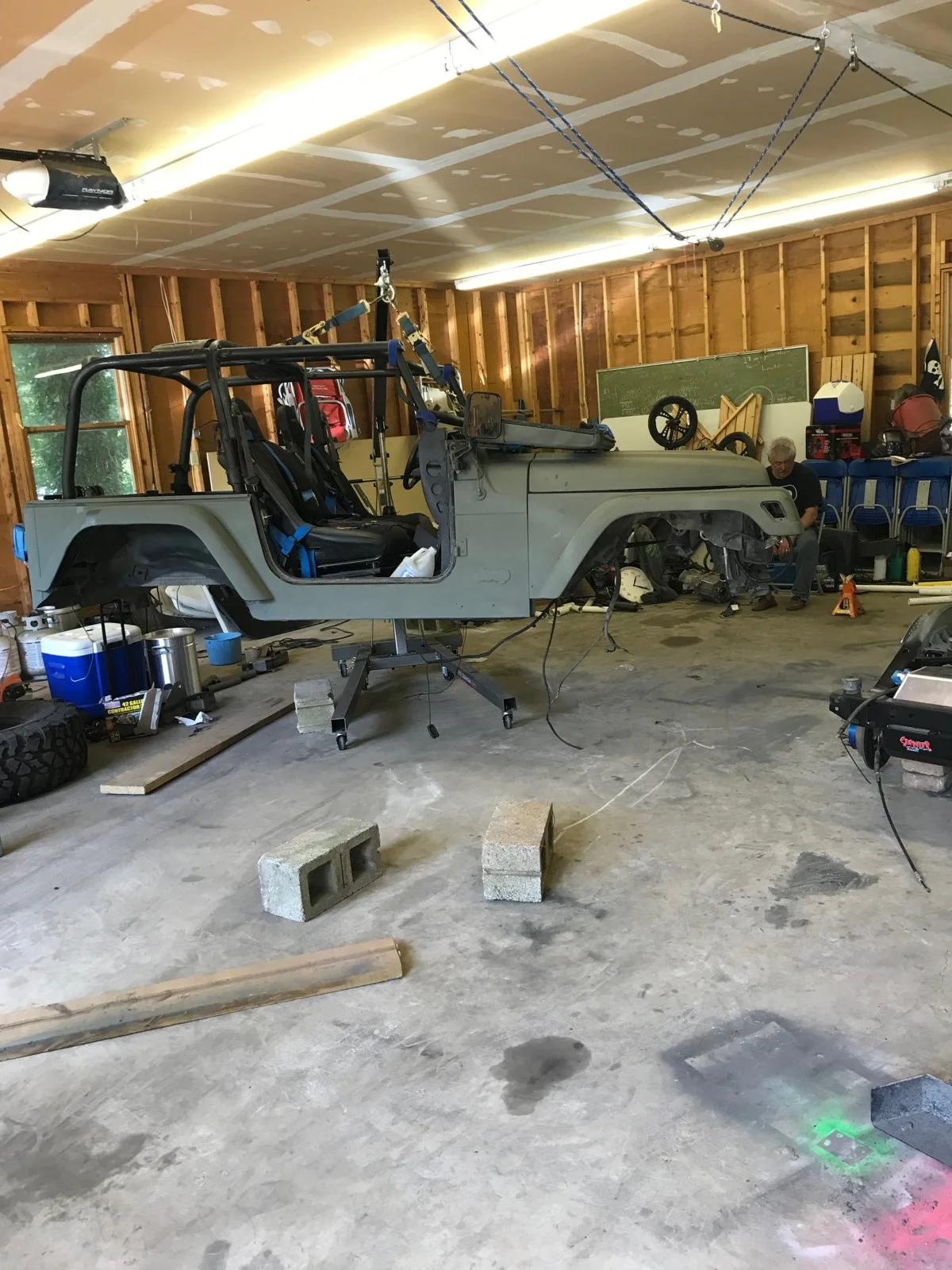

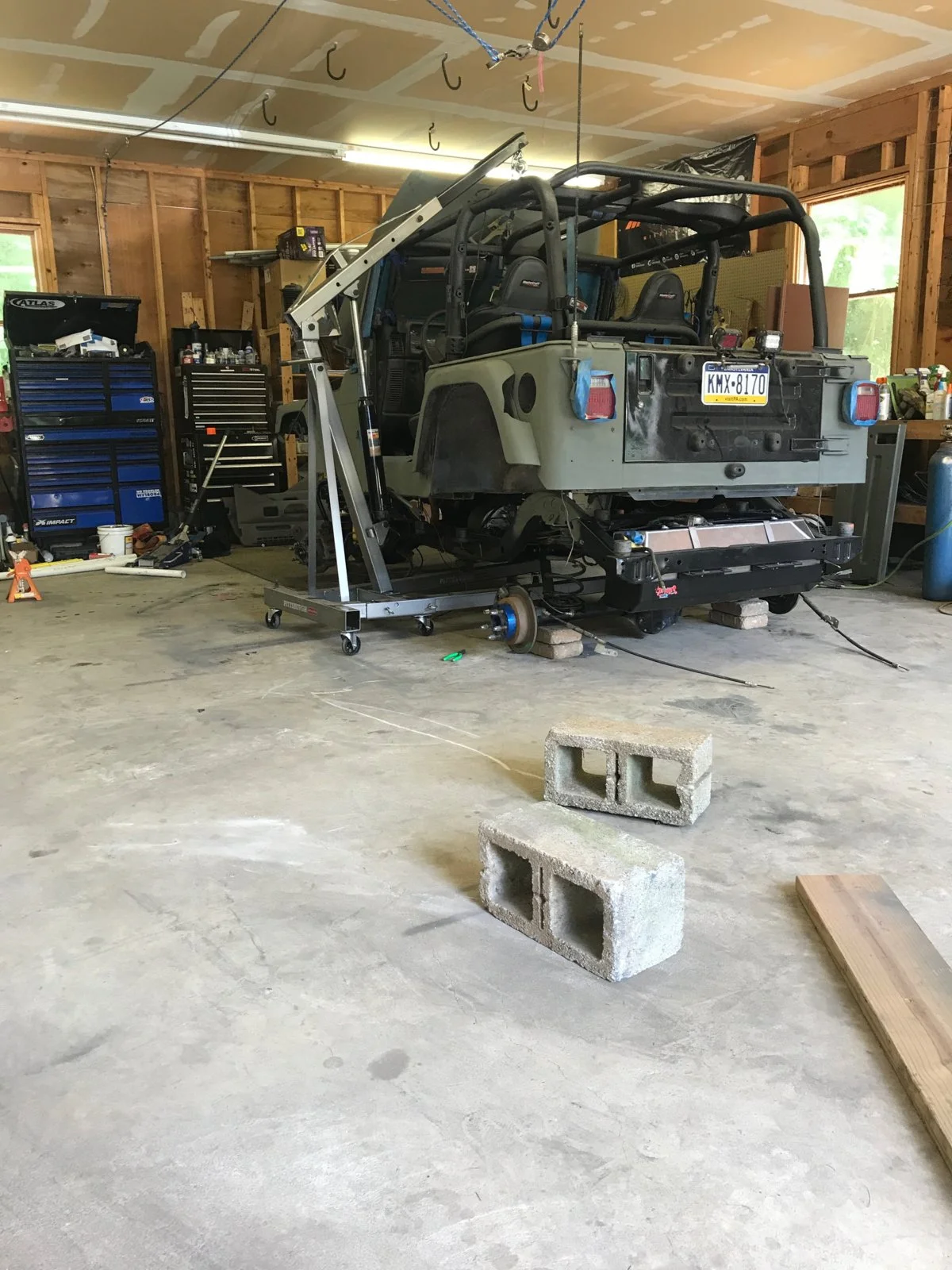

I threw the 33's on it to try and get the frame low enough to get the body on using the engine hoist. But I ultimately had to put the frame on 2 blocks to get the engine low enough.
58067110680--A42C9323-574C-4E19-B8A1-EFE8E86E148C.JPGIMG-5865.JPGIMG-5863.JPG'
Boy was the tub a real pain to push around with the hoist. You can see my dad needed to take a break half way through lol. IMG-5864.JPG58067555765--75EDFAFA-01C4-4E5F-A203-33AB665411CF.JPG.

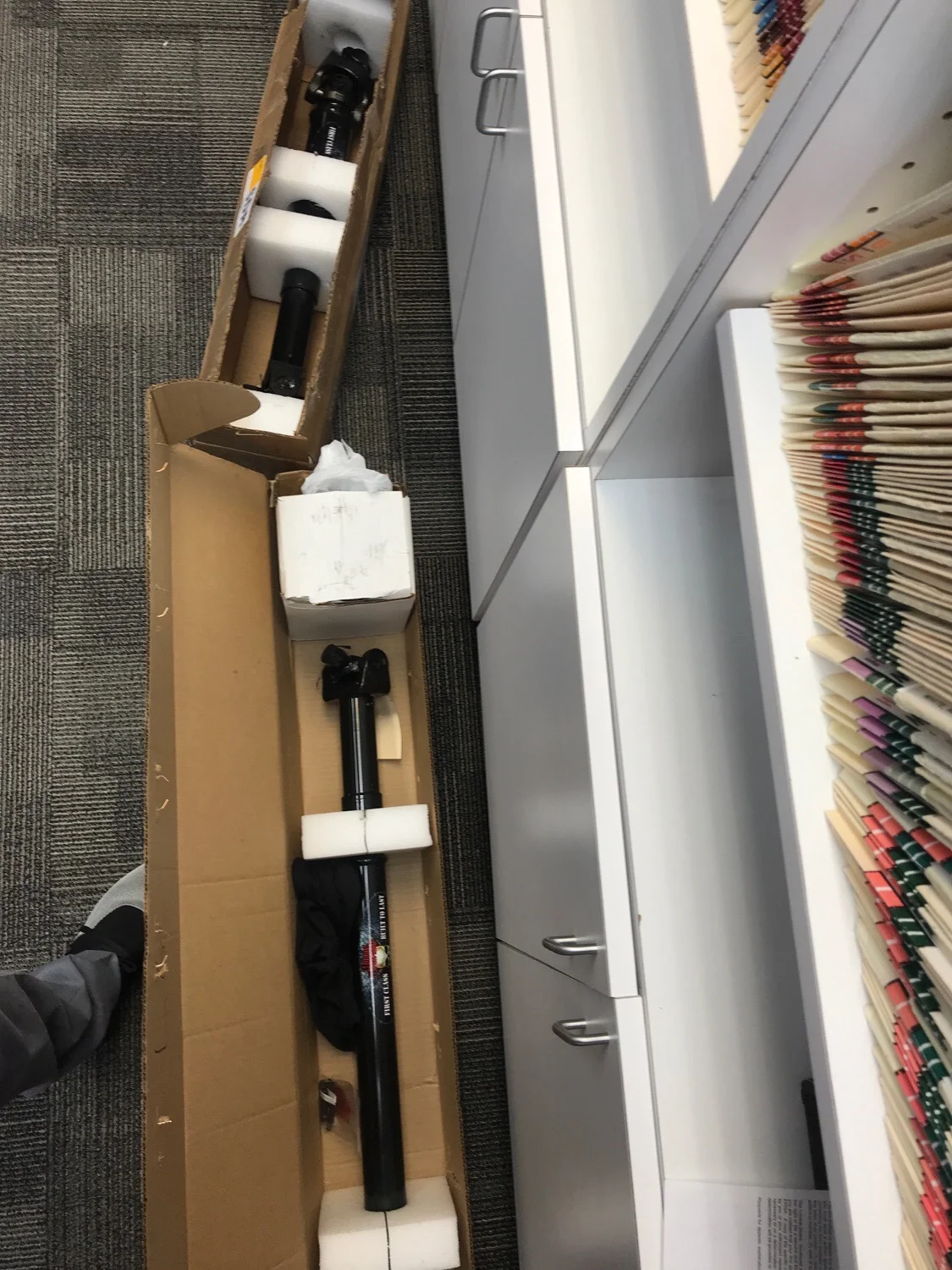

Today Santa came and brought me driveshafts that I got from Adams.
Got them in 3 days which was fantastic as the jeep is suppose to be on a trailer thursday night for a full weekend of wheeling this Weekend at Rausch Creek for Krawling for Cops.

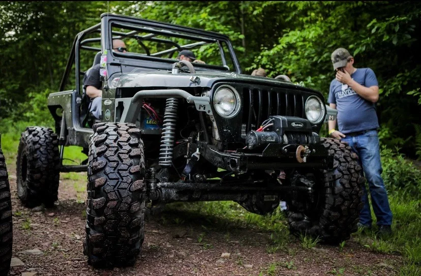

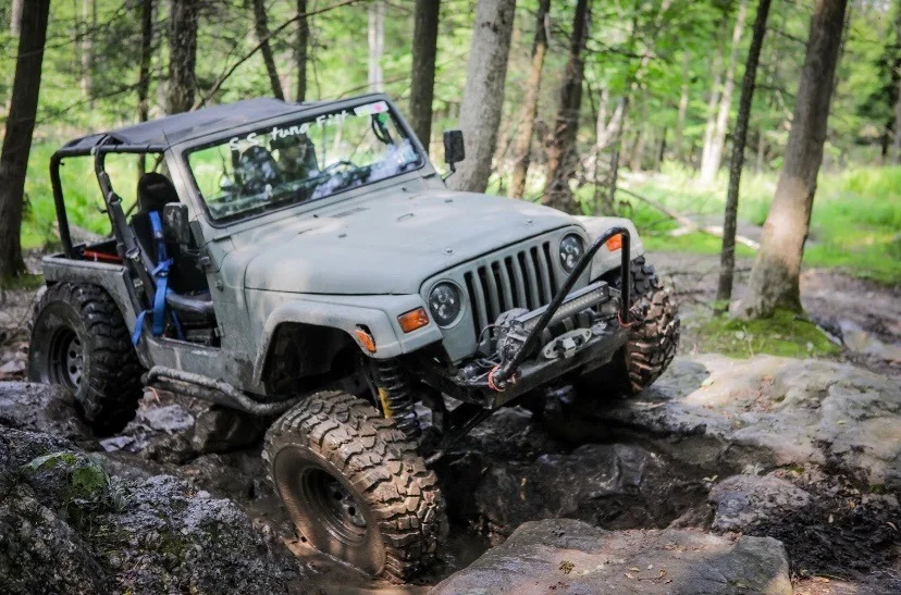

Quick update, we made it to the rock crawling event on the weekend of june first. Krawling for cops at Rausch Creek in Pa. Didnt get any paint on her but had her running minus having a ps high pressure line have a catastrophic failure. Napa next day delivery is a god sent.
The Rear double triangulated rear is amazing along with the stretch. The atlas 5 to 1 is an absolute beast when it comes to needing to go slow.

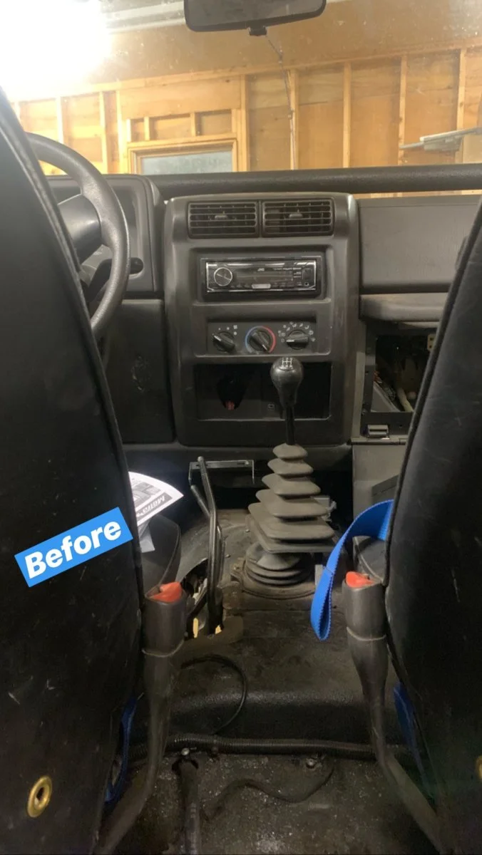

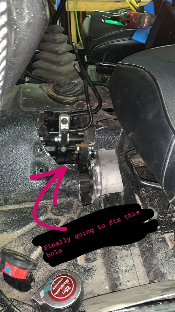

In order to get the atlas to fit with the tummy tuck, part of the floor had to be cut out. So we ran that whole weekend with this hole.
Reactions: TJ Starting and JMT

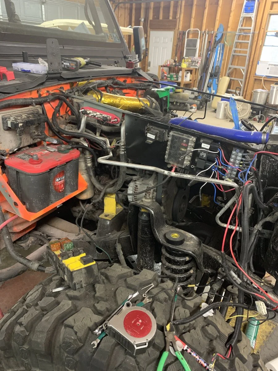

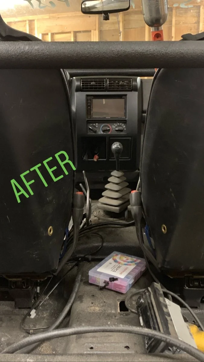

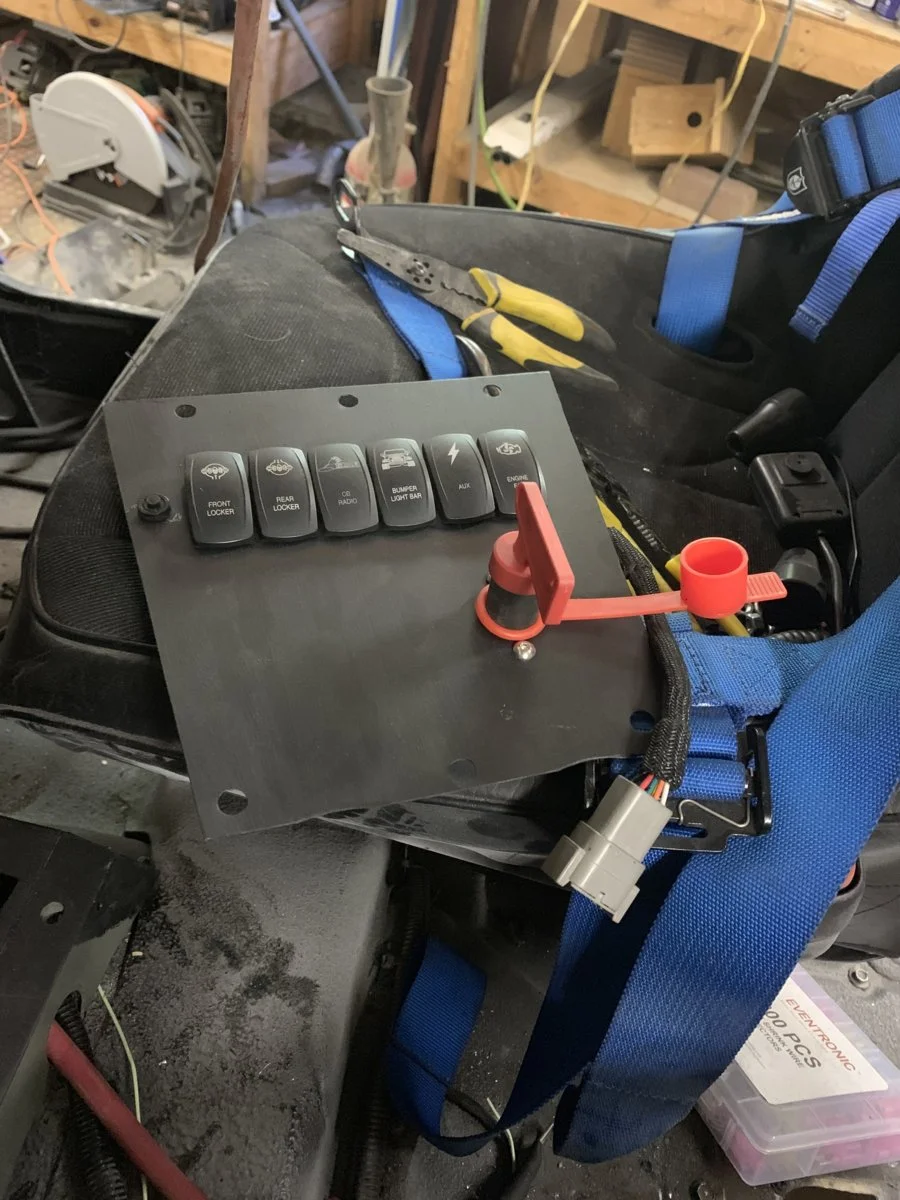

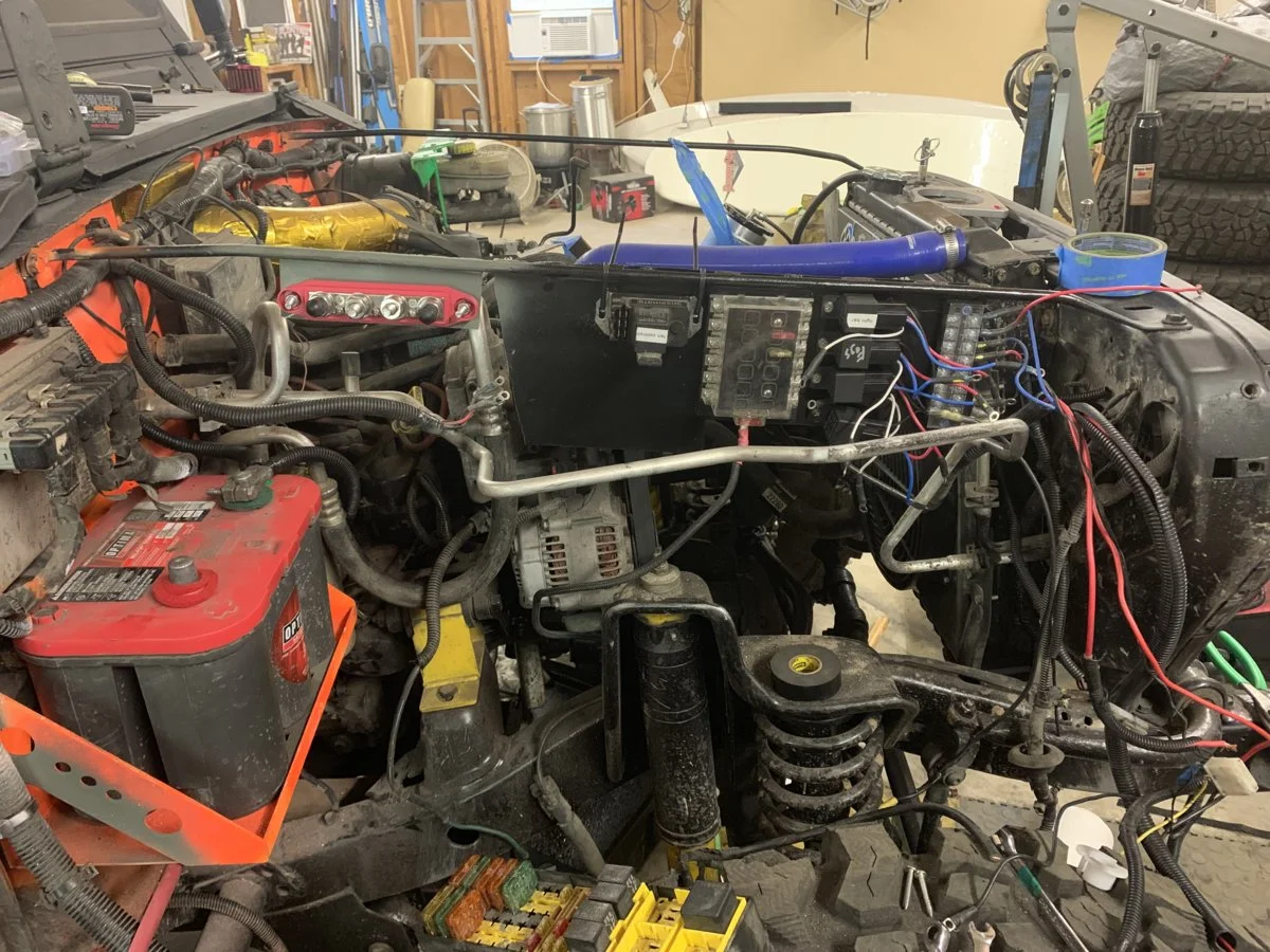

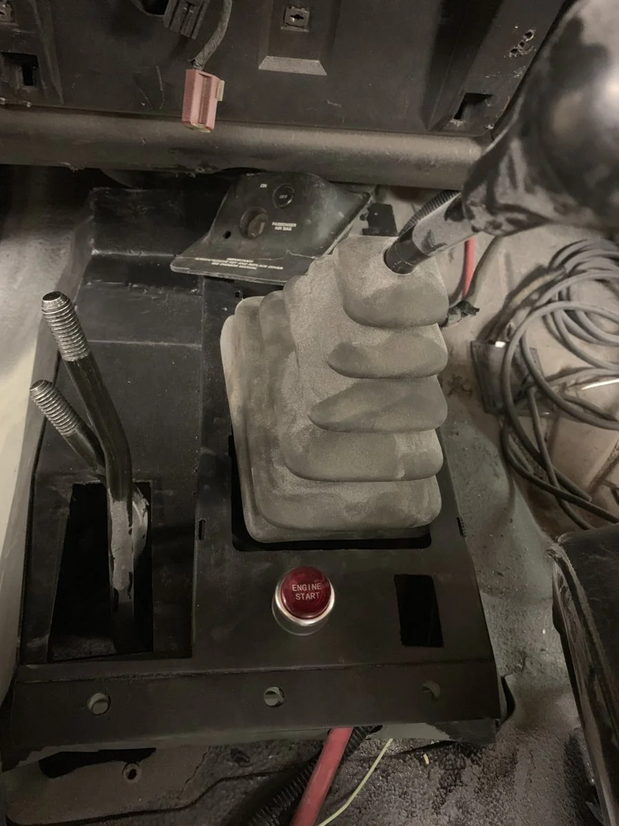

With redoing the power steering pluming and moving the reservoir. I am once again redoing all the electric. I was running with Buggies and learned a whole lot from these guys about what they did for their electrical systems. I absolutely love the quick battery disconnect and complete electric system shut down. I welded in a new battery tray new mount for the electrical components (its been updated last night but didn't take any pictures. I took my tuffy console and removed the e-brake. Going to relocate it to another position in the jeep. Took my spod switches and created a custom center piece to hold the switches. Welded in new cup holders4188E2CB-A3D8-43B0-840F-467812FD2CEC.webpIMG_0438.webpIMG_0441.webpIMG_0442.webp
My overall goal is to have little to nothing on the fenders for quick removal. The fuse box at this time is the only thing staying on the fenders. I am extending the fenders to meet the corner of the tub since I did the DIY highline kit and extending the arches reward a tad to keep the tires from rubbing (i do not want to stretch the front axle)
Also updated the radio system and installed a back up camera. Its a kit from crutch field and I am absolutely in love with it. It works flawlessly, took about 2 hours to cut the sub dash and to run all the wires. But the transformation was well worth it. CE0AD6D8-85BF-47DA-9DF8-B16087ADF5B1.webp3EF3E689-9C10-4FE8-BBCD-80740A40D205.webp

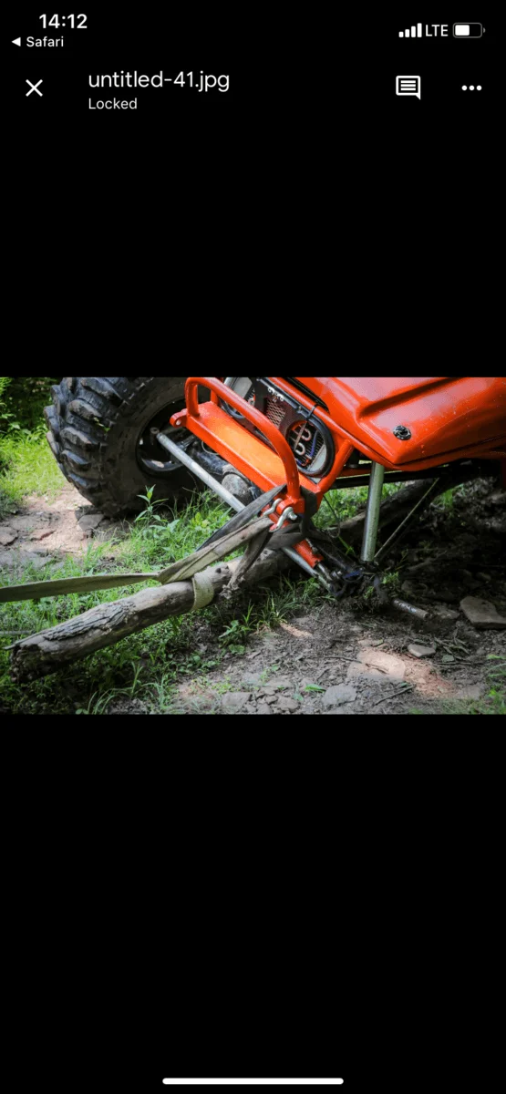

Here are more pictures of the Rigs in the group and the aftermath of a day of wheeling hahah Nothin like a little log sledding through the woods to finish the day. IMG-0177.webpIMG-0172.webpIMG-0171.webpIMG-0180.webpIMG-0170.webpIMG-0192.webpIMG-0189.webpIMG-0190.webp

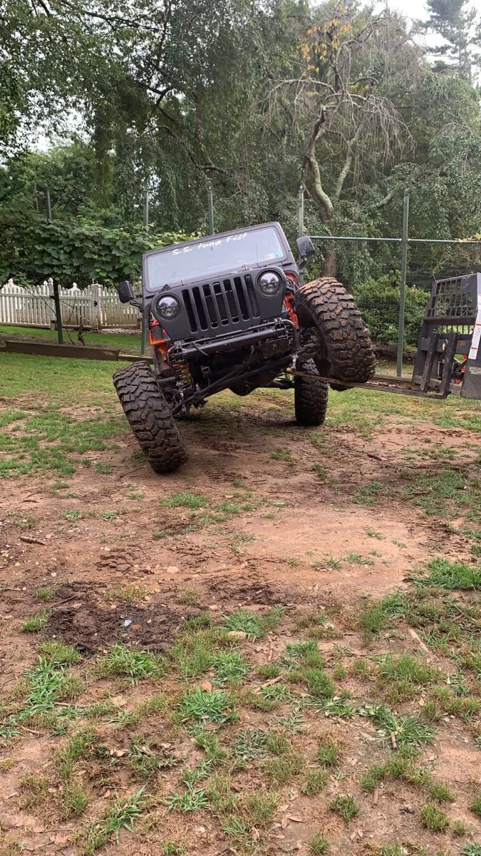

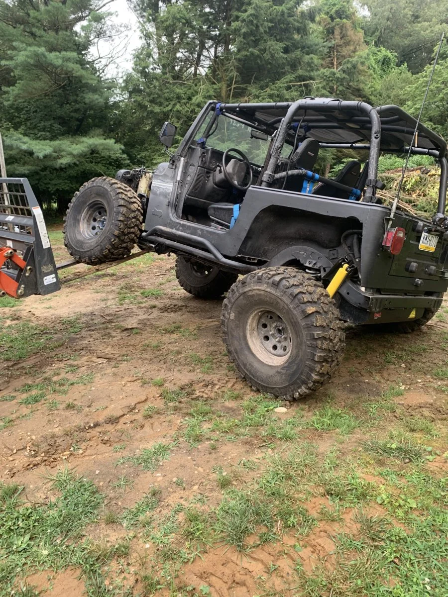

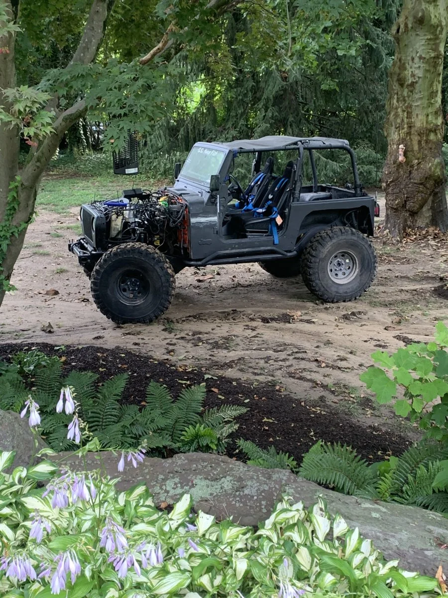

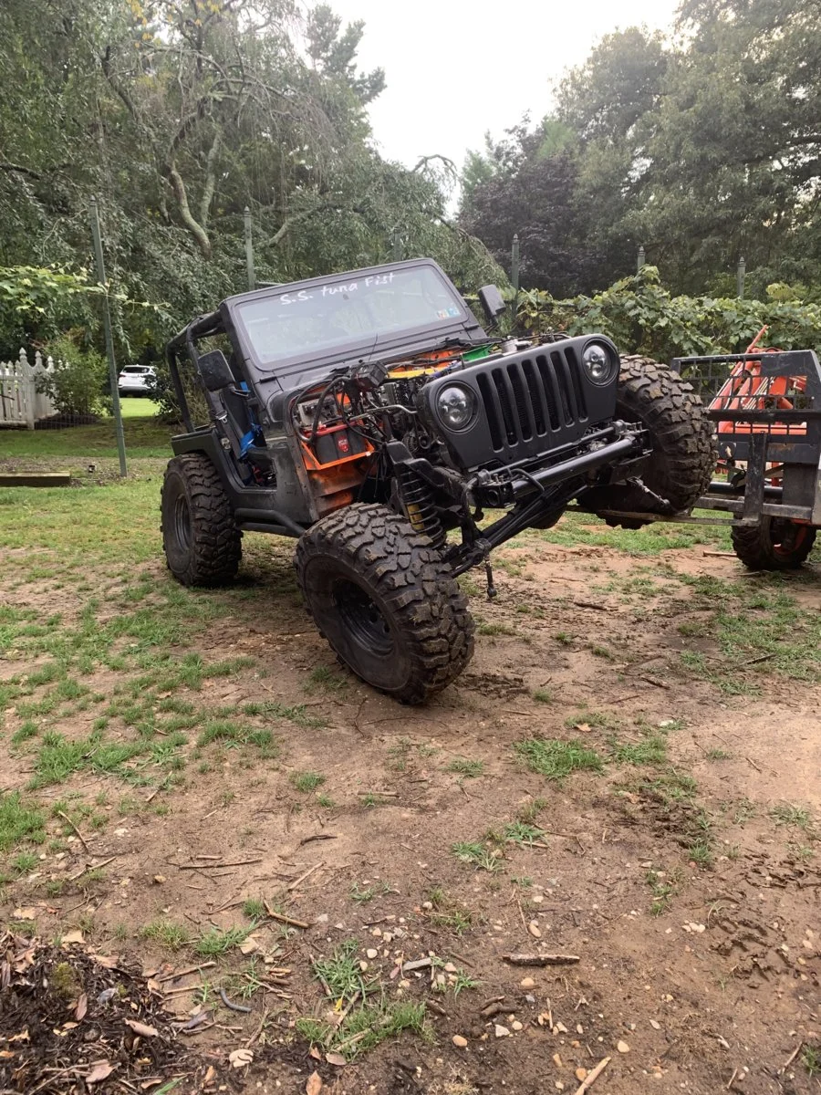

Got the wiring done this past weekend so took her out and played on the fork lift. Got everything working without the fenders on which is what my goal was.
