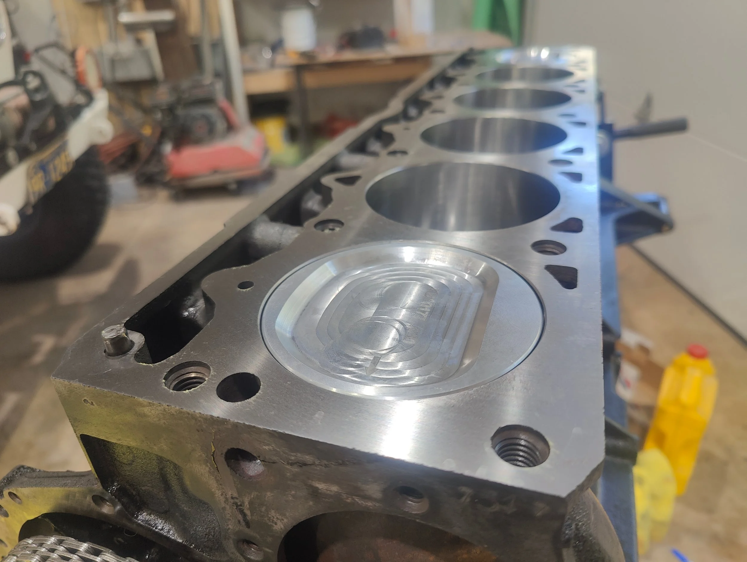

Nah you don't tell someone who just rebuilt their axles to replace them...
Stroker!
-Mac
I thought it was "TUNS and fodeez"...
