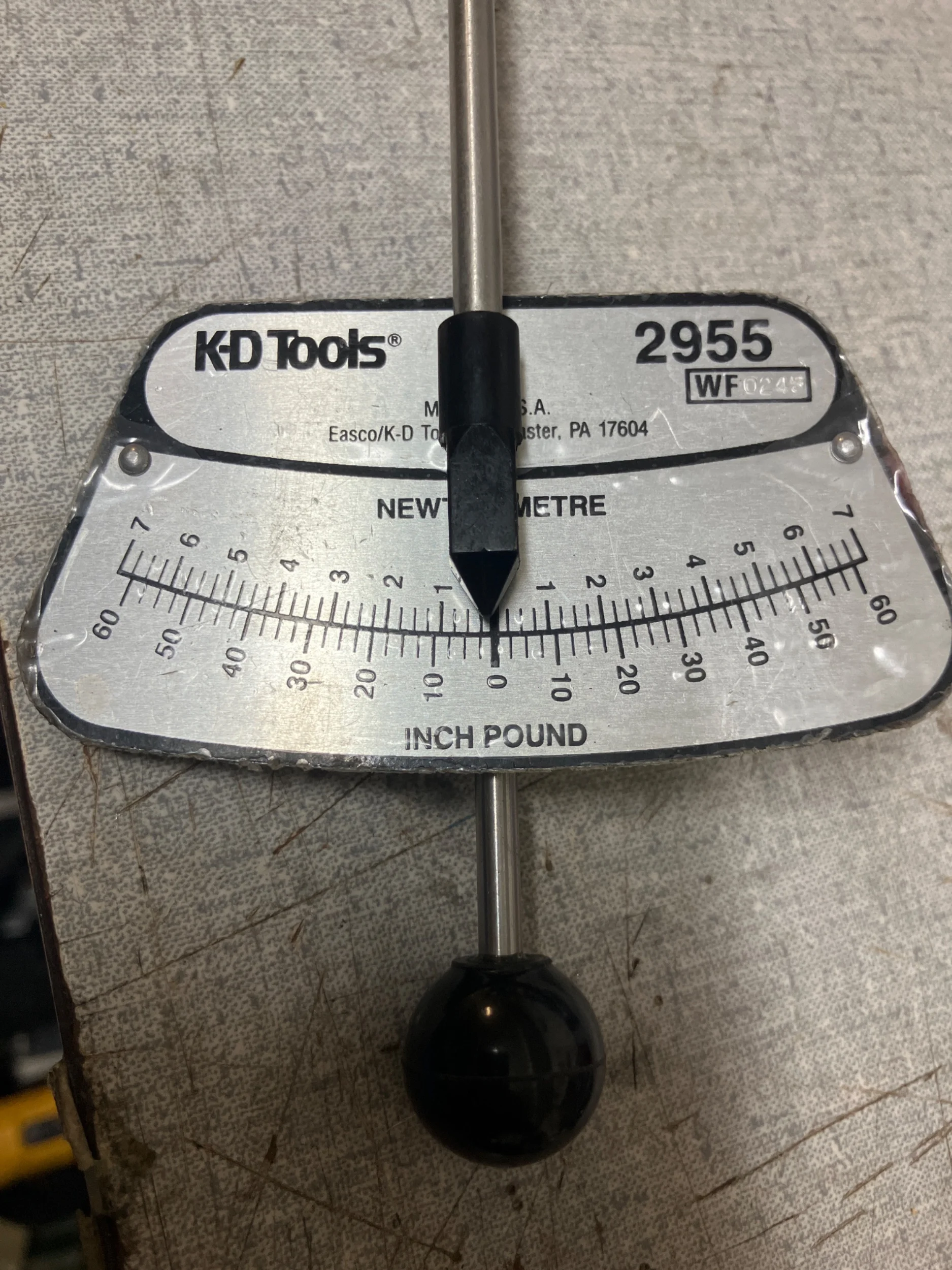

do you have a beam-style inch-lb torque wrench? What resistance are you seeing right now?
I do not - I'm asking if I should get one to check...

Sorry, long day at work. With a crush sleeve, you're pretty much at the mercy of where it needs to be. I don't personally like the "mark the pinion" method because you can see resistance go way up with less than an 1/8 of a turn. If you think it's tight now, you can't make it looser to fix it without a new crush sleeve.
See if you can get a beam style in/lbs torque wrench and see what it's at.

In case you need a part number:
Reactions: Zorba

Just ordered one, should be here tomorrow. Push come to shove, I'll get to learn how to install and setup a crush sleeve! HA!
I forgot to say the wrench above is 1/4” drive and the socket for my pinion nut is 1/2” drive so it took some adapters to make it work.
Yep - had to order a 1/4" to 3/8" adapter, can get to 1/2" from there.
EDIT: Shit! No I don't - mine's the opposite. Back to Amazon I go...
https://www.amazon.com/dp/B07BFGN53Y/?tag=wranglerorg-20
This is what I use. Cant remember what drive it is (probably says in that link but I’m in Vegas so why am I even replying?)
But for the adapters, have you never heard of Harbor Freight?
Yea, that's what I bought. Its available with 15 different names stamped on the tool. As for the adapter, I just went back to Amazon and added it to my order, which will be here tomorrow. Didn't even have to get in the car and drive down to Hazard Fraught!
