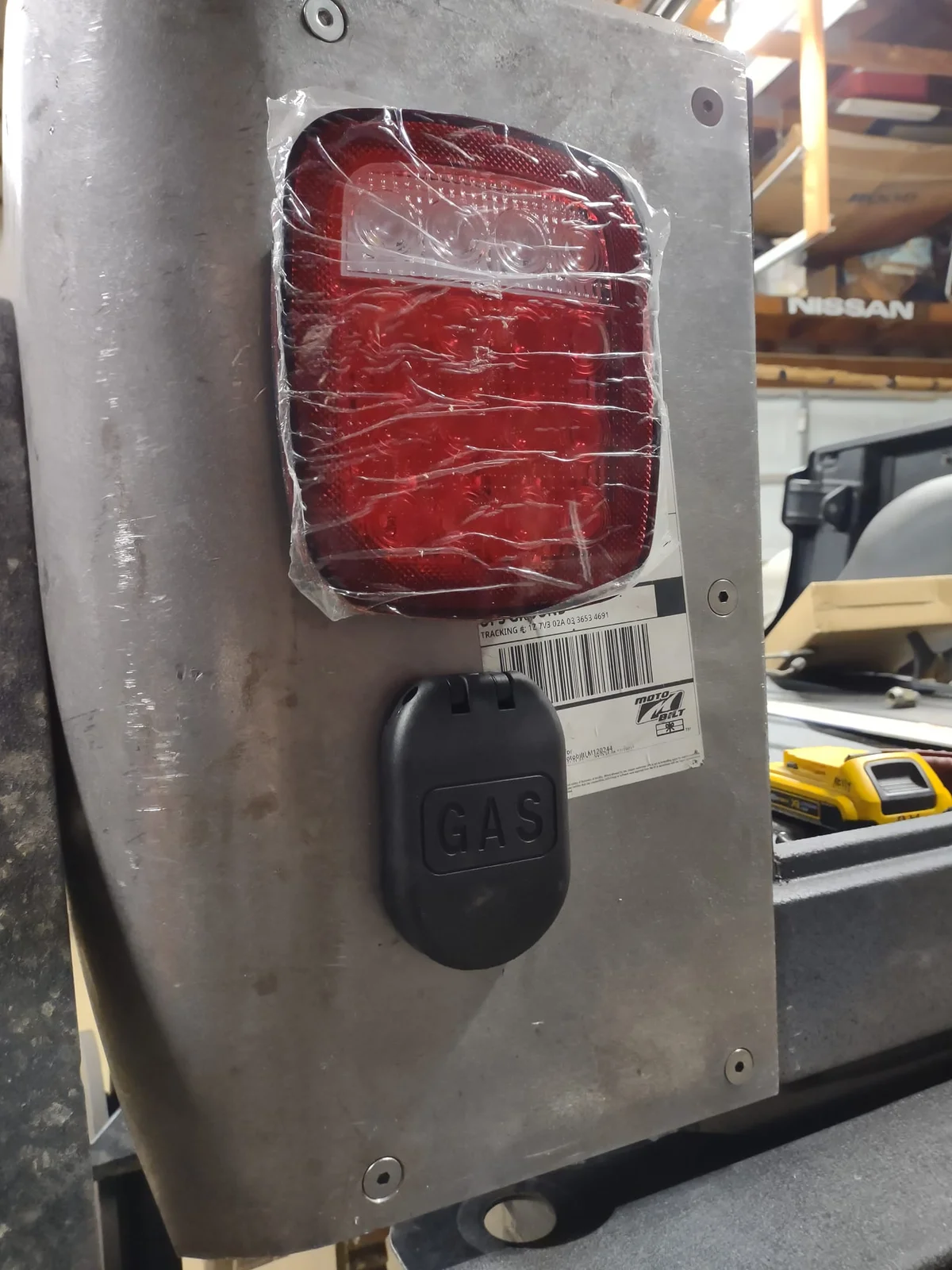

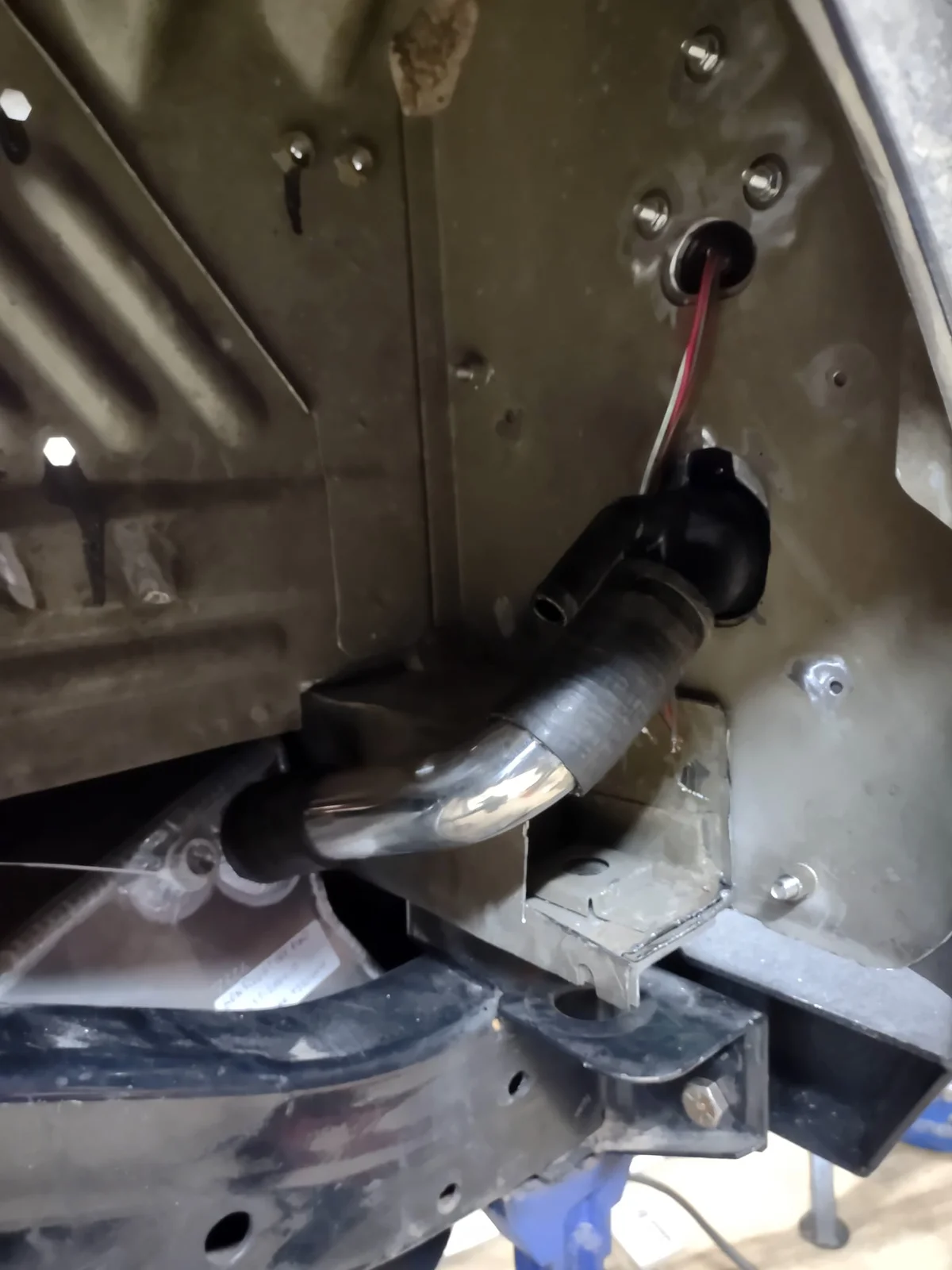

Got this off FB it isn't mine.
A boat gas cap and a piece of leftover stainless wastegate tubing from my Honda makes for a perfect filler neck on a stretched TJ

ya they got that 1 on amazon for like 20$. it being plastic might be just fine up high under the lamp but not an option for the side.
for you guys with the tanks still underneath that 45* neck is the design you desire, unless you opt for an angled bezel.
