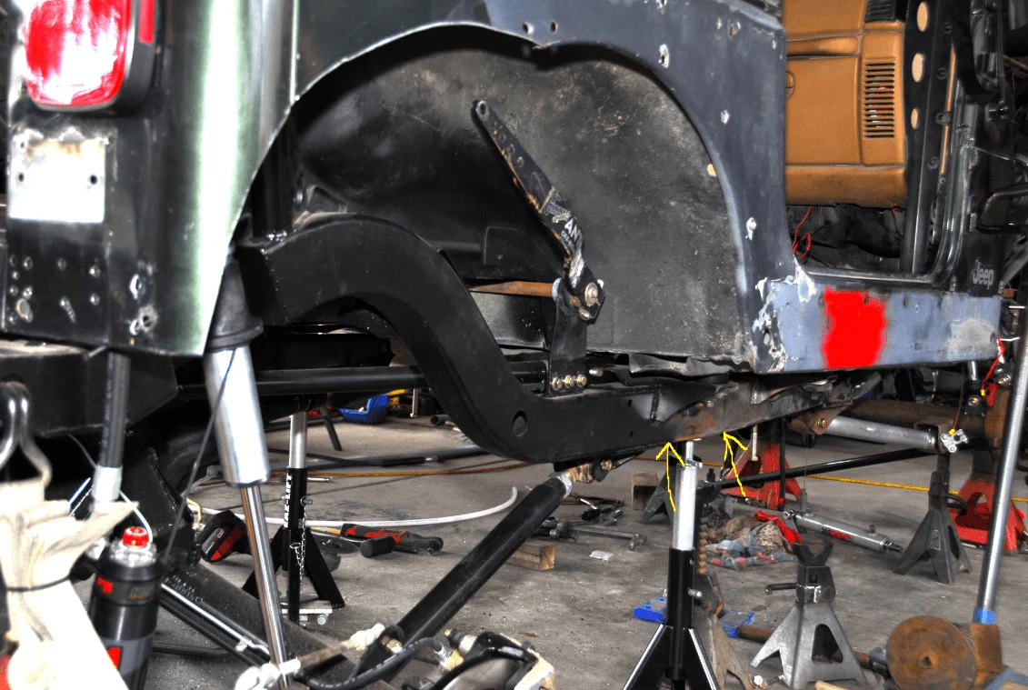

Now my question is HOW? Yes I know a new suspension system. Custom or? Best case from what I can figure out is the Savvy Mid Arm kit. So hopefully @mrblaine will comment here if this is possible. One picture he shared with me and I hope I'm not wrong for reposting it.
86357
MrBlaine: This is 104 on 37's with 7" of up in the rear and 6.5" of up in the front with an 8" rear stretch and 2ish of front and a 21-22" belly height.

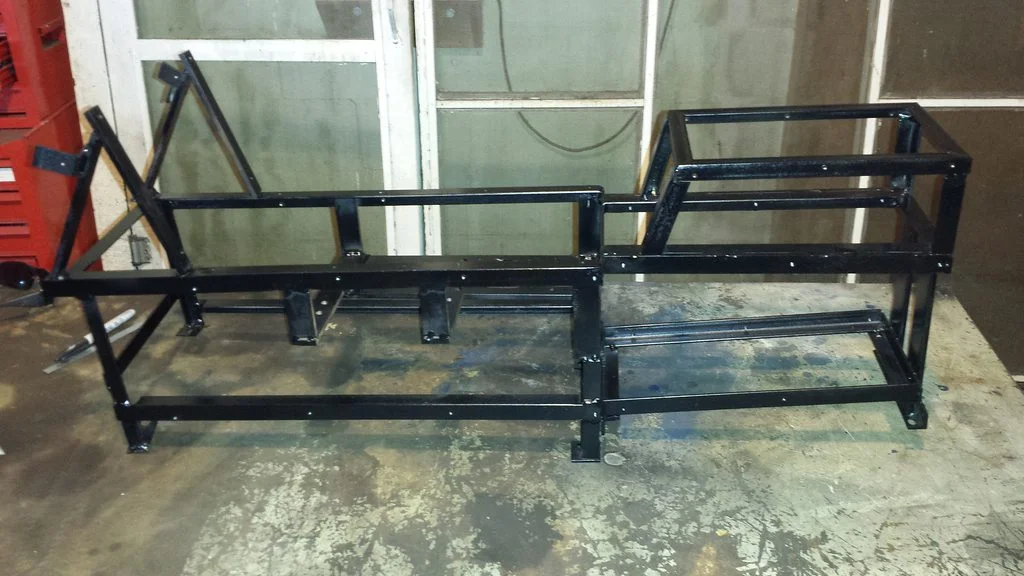

The interior is also going to get an update, new gauges in my center console. A custom lower center console something like this.

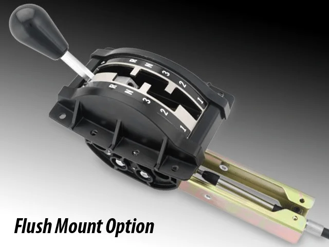

Then get rid of the stock automatic shifter for a Winters Sidewinder flush mount shifter.

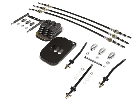

And some cable shifters from NW Fabworks

The how is like this-
This rig had an existing Savvy rear mid arm bracket set on it. We cut the frame right in front of the midarm bracket and moved it back exactly 8" as shown by the two yellow arrows. It came in a 94", we moved the front forward 2" by virtue of setting the coil over mounts on top of the axle tube which is an automatic stretch since you need the body of the coil over in the part of the frame up front that bends inwards to clear the OEM spring.
