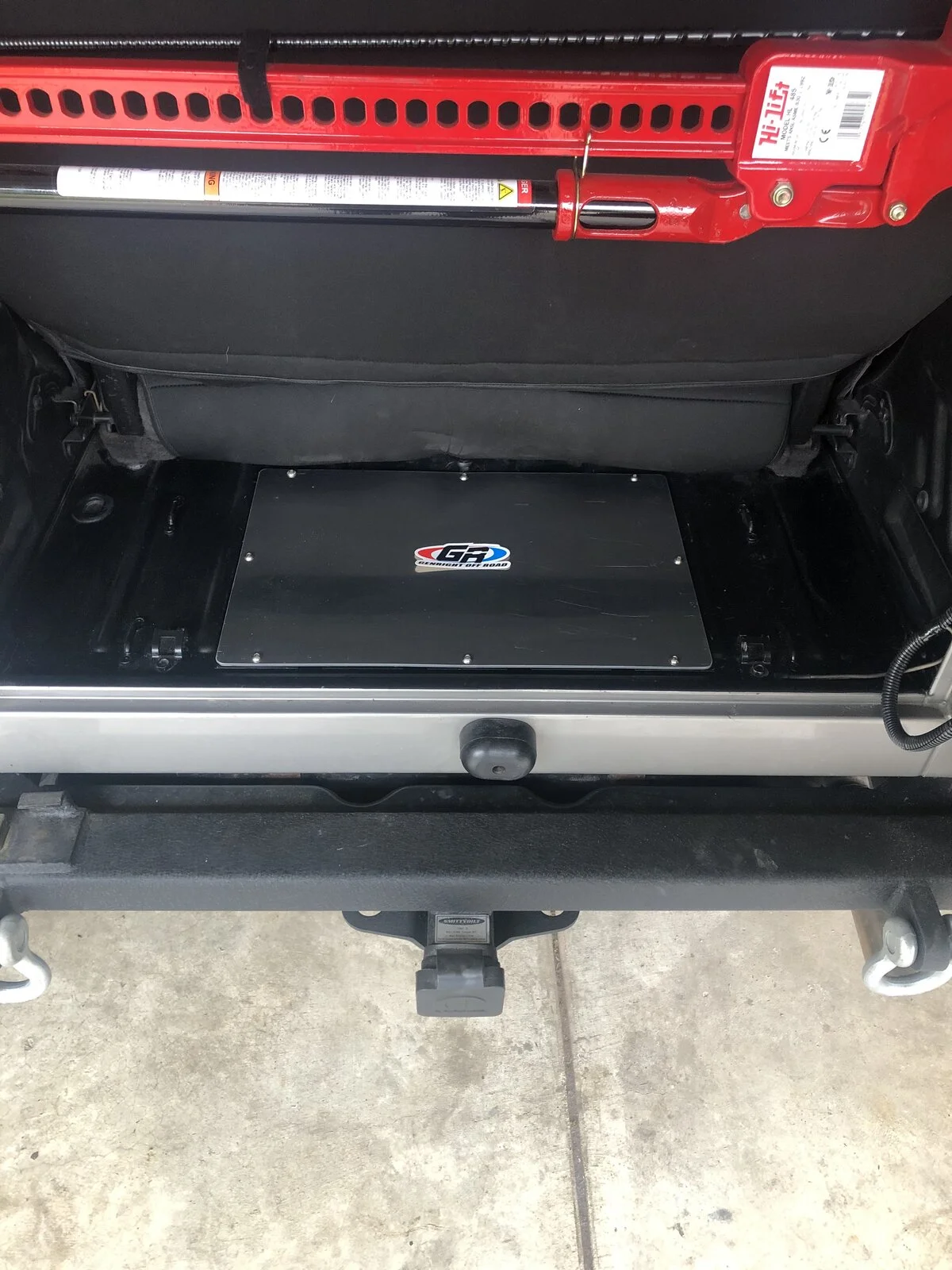

Guess I'm the dissenting vote here. I installed one and think it's a great mod. Wasn't hard to do at all and I didn't need to drop the tank to do it.
First off, I have a 1" body lift so that helped with the spacing between the tank and the floor. I used a short metal cutting blade for a jig saw. Took about five minutes to cut out the piece. Blade came no where near the top of the tank.
The only issue to watch out for is the rear tail light wiring. You can't really see it as it runs through a channel type area all the way at the rear. I nicked a wire on mine but I think that was because one of the plastic hold downs for the small wire bundle had broken and the wire bundle was sticking out a little. Easy fix.
If you do get one.....pay attention to lining it up correctly in the space........there isn't much room for error front and rear.

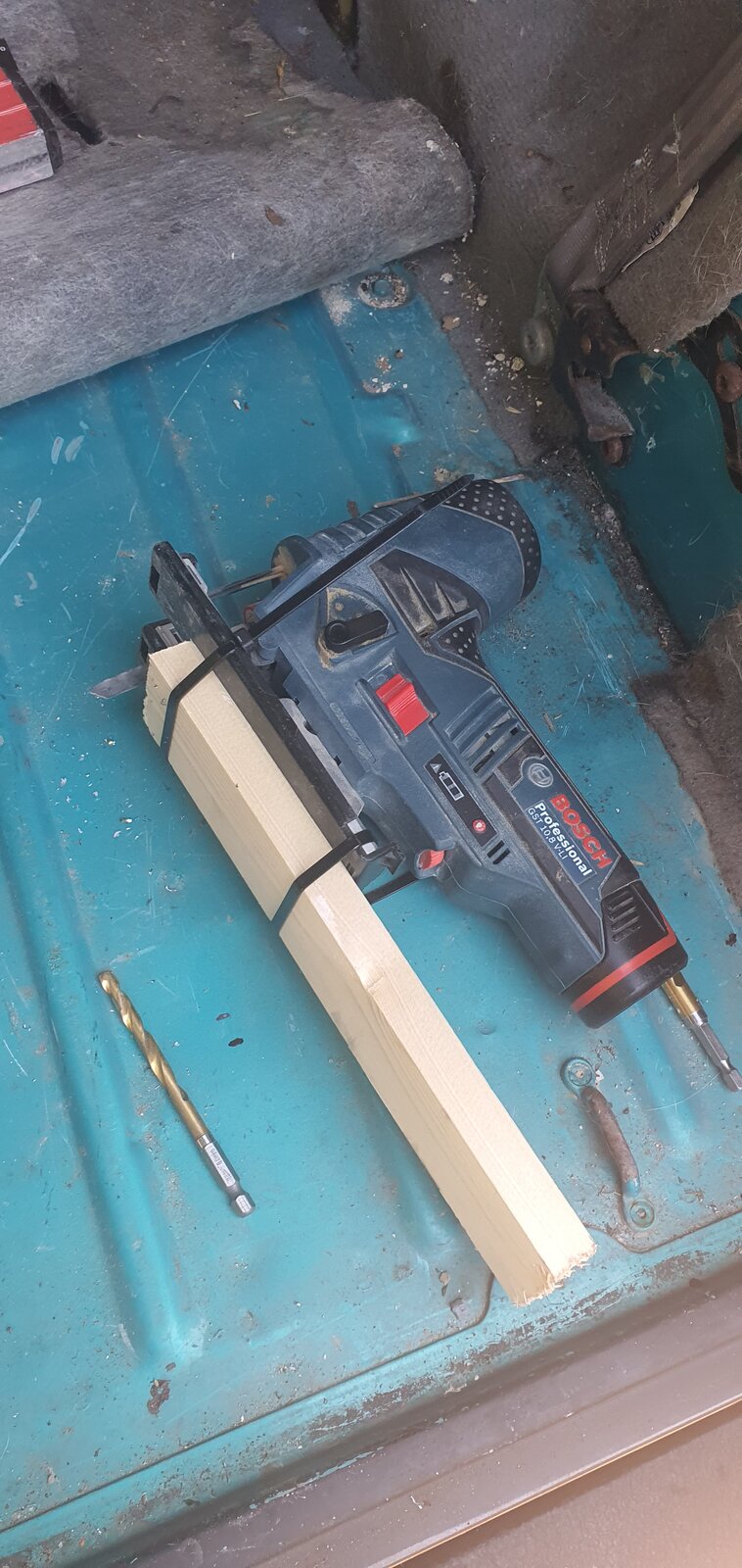

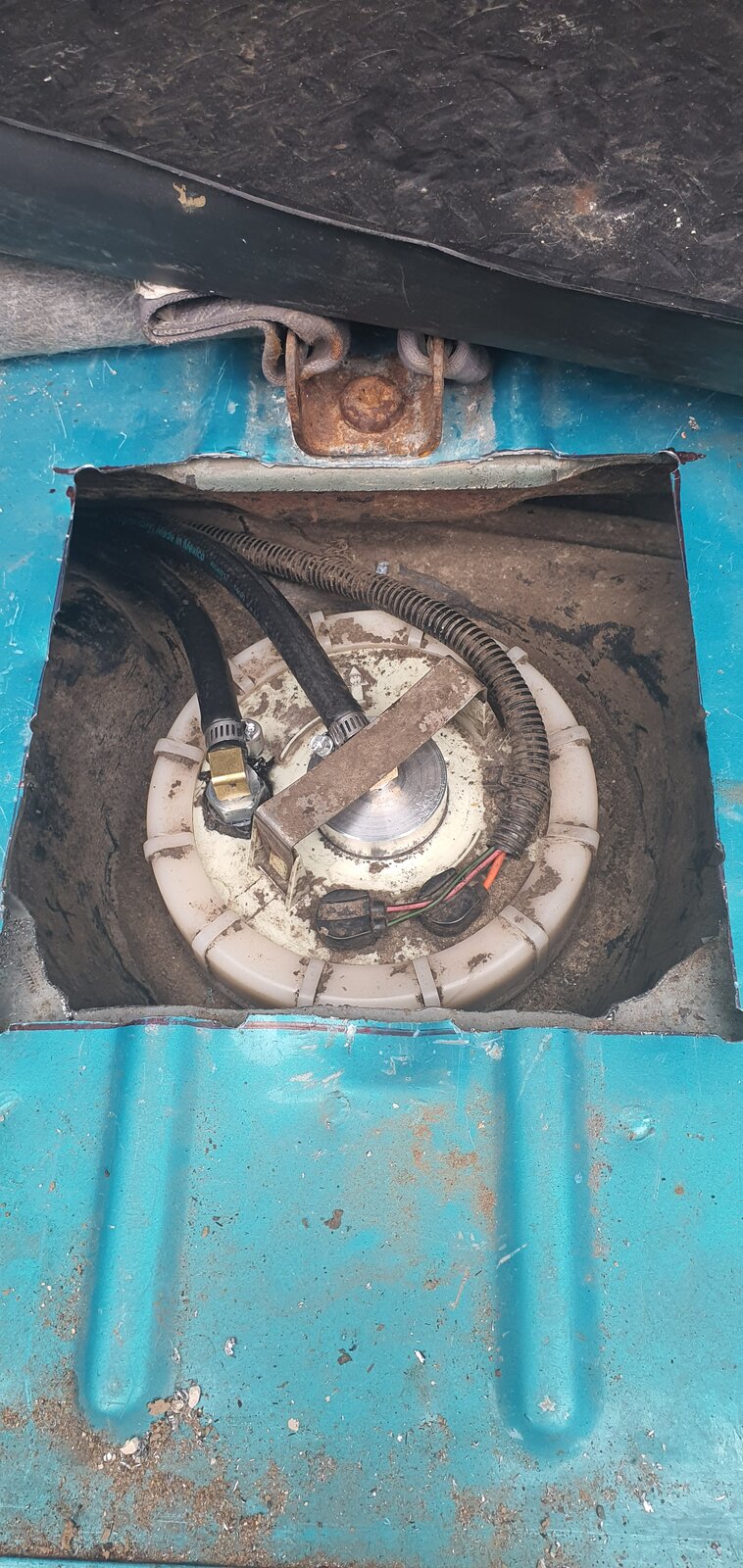

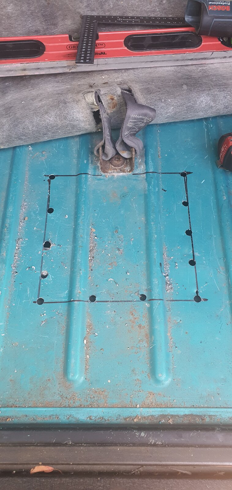

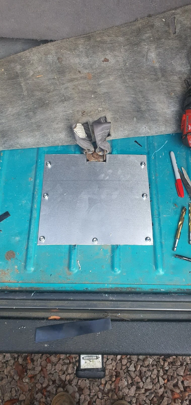

I read this topic and many others about adding a access panel and I went ahead and did it. Was pretty easy really, I didn't drop the tank to do it and I dont have a body lift. Excuse my depth guage jigsaw device but it did the job ha. Happy to give more info if anybody wants it. My hole was smaller than most I saw but was the perfect size to remove the pump easily.
I needed to remove my fuel pump to change the regualtor to the Novak bypass and add a return line (my TJ has a 350 chevy V8)
Looks good and functional, no channels cut, didn't have to buy a cover etc...I like it...
