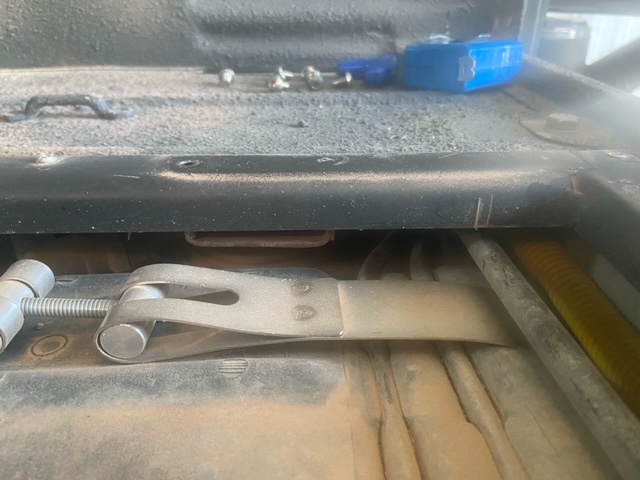

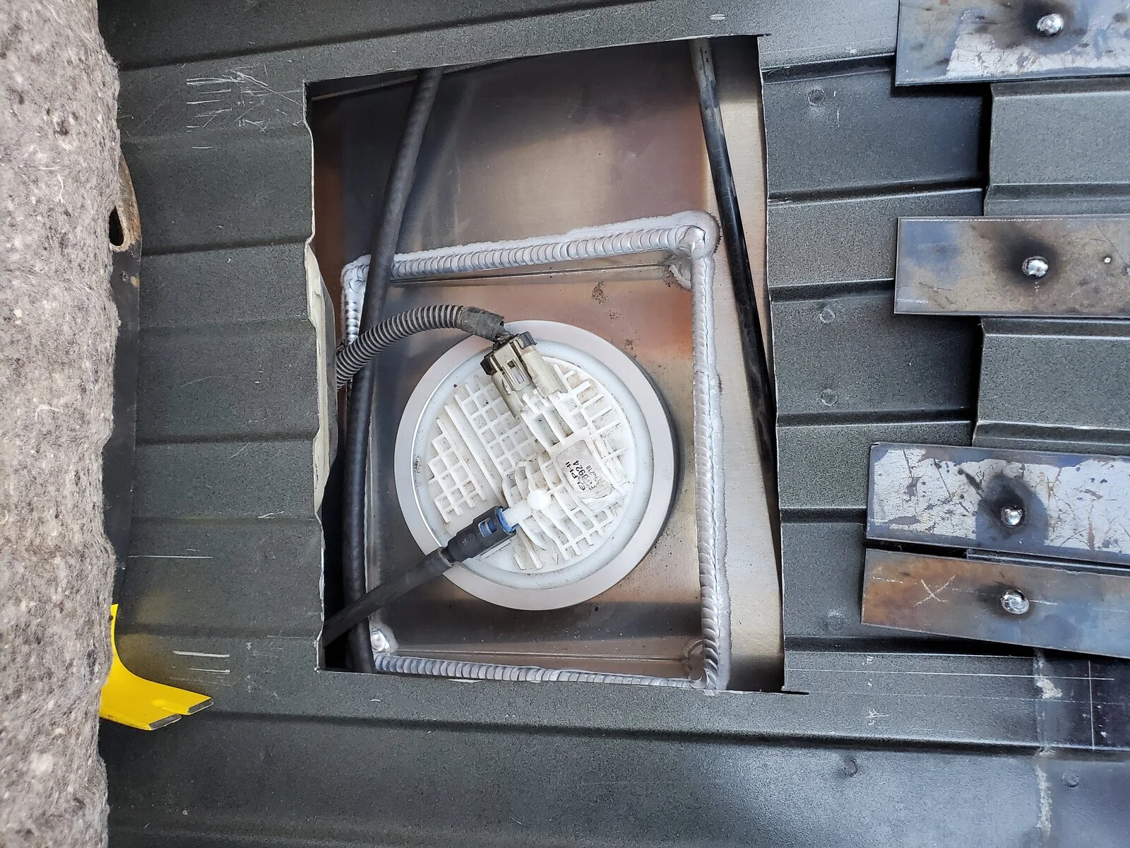

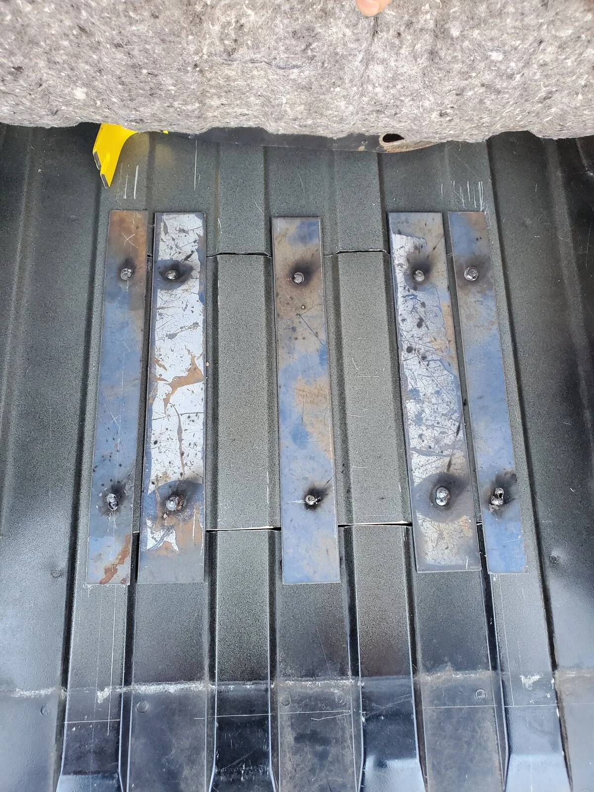

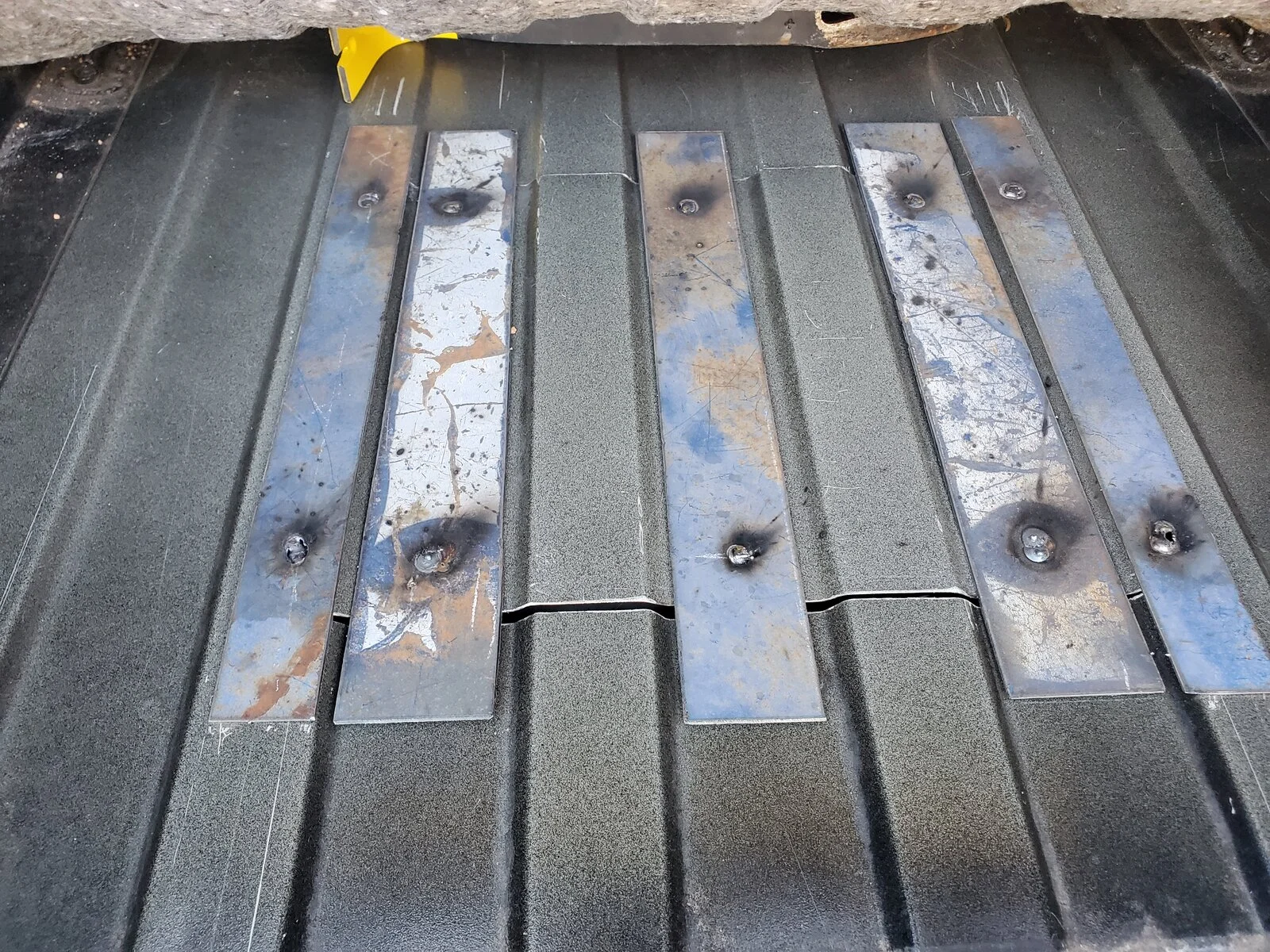

Thanks for the pics,it looks like it can’t be done without cutting the support,even with a smaller holeHere are some pics. When I installed the panel I had a 1" body lift with the stock gas tank skid plate. It left plenty of room to cut out the floor section without having to drop the gas tank. A few weeks ago I installed the Savvy gas tank skid which raised the gas tank back up into it's original position. So now it is much closer to the floor pan.
Pic 1 - Shows the orientation of the access panel. Note the location in reference to the bolt hole for the rear seat belts.
Pic 2 - Shows the access to the fuel tank with the panel off.
Pic 3 - Shows the channel that you need to cut through. You can also see the tail light wiring in the yellow loom. The stock wiring is not in any loom. It is fastened to the rear wall with ties. I put the loom in when I installed the Savvy gas tank skid to protect the wiring now that the gas tank is up higher in the space.
Pic 4 - Shows the channel on the other side of the opening.
Pic 5 - Show the location of the channel from the back lip of the floor. The centerline of the channel is 6-1/2" from the inside part of the lip.
Pic 6 - I'm trying to show the location of the tail light wiring in relation to the gas tank and access panel opening. Again, I installed the loom to help protect the wiring. This is the area where my wiring clip had broken and when I cut the access panel opening, it cut one of the wires. Actually the wire wasn't cut, it just chewed into the insulation. I have a 2006 TJ and I'm not sure all tail lights are wired the same throughout the years. On a 2006 all the tail light wiring goes to the drivers side tail light and then this small bundle goes from the drivers side to the passenger side tail light.
You are correct. You do have to cut through that one support. Is that an issue for you?Thanks for the pics,it looks like it can’t be done without cutting the support,even with a smaller hole

You probably could, but it might present other problems. It basically runs roughly through the middle of the opening. It might impede getting the fuel pump lock ring off or even getting the fuel pump out.Could you just leave that support in place and have two openings?

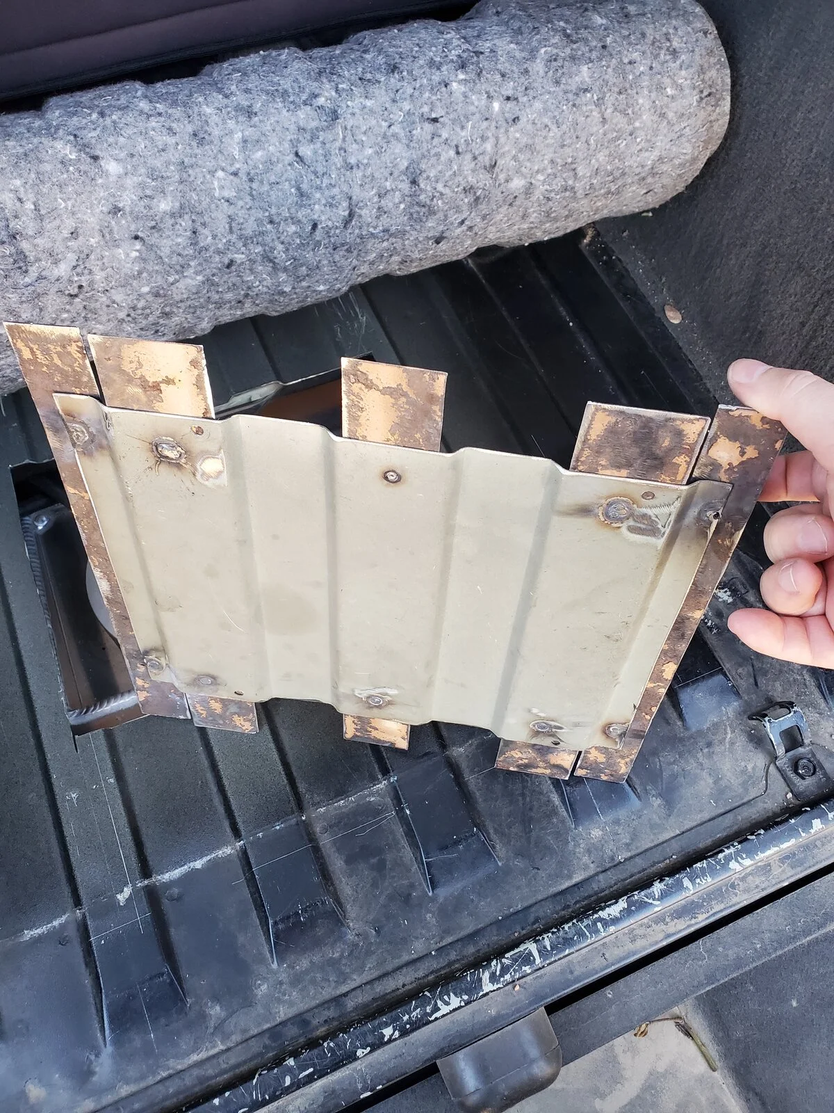

Actually he could have moved up about 2 inches and not cut that support that runs right at the back and still be able to get to his fuel pump and lines...OH and no KIT required, just a little know how and imagination...the slats were cut from a 50 gallon drum lid..I guess I could paint it or have it power coated....I'll seal it with silicone after that...Thanks for the pics,it looks like it can’t be done without cutting the support,even with a smaller hole
