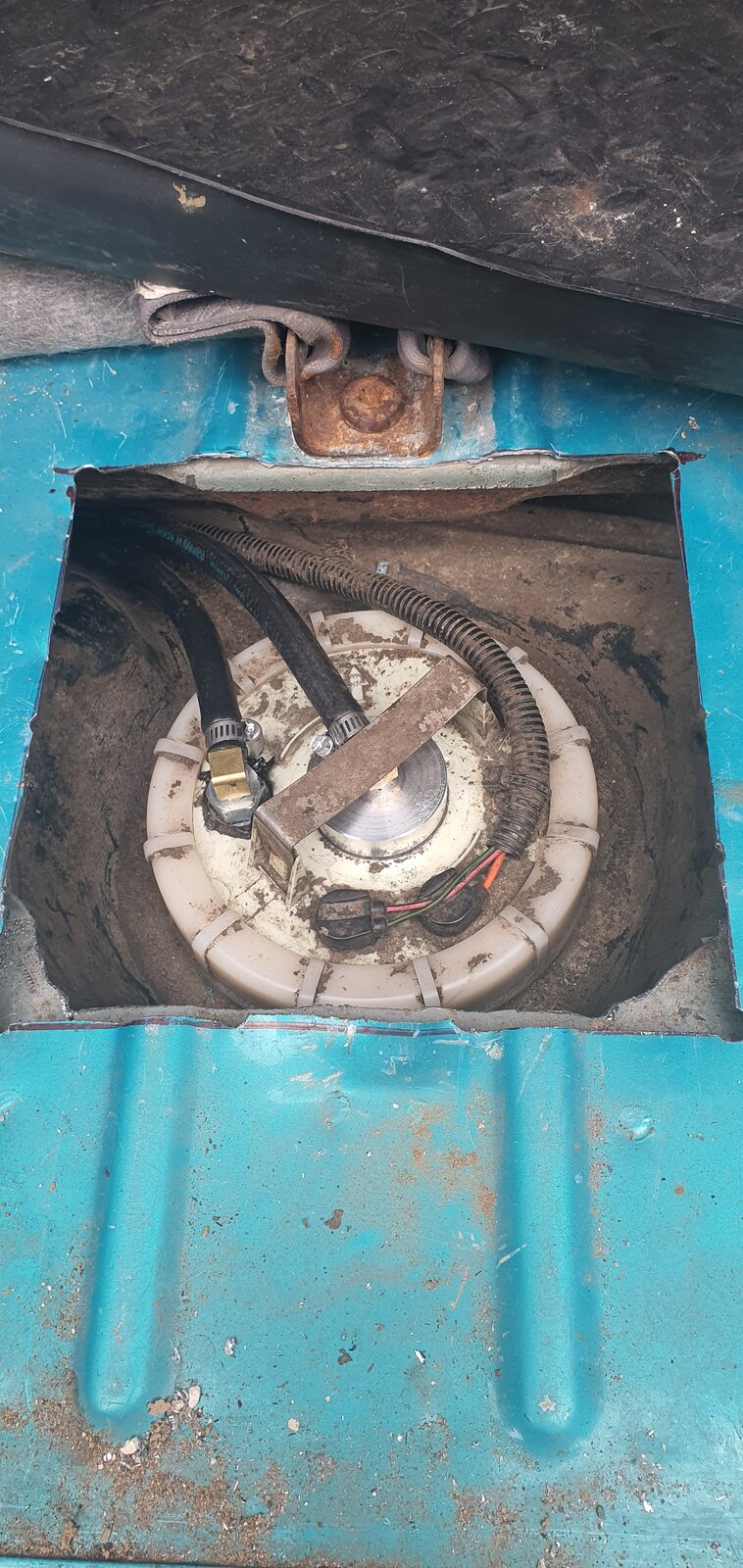

The front is right up against the seat belt bolt in the middle.

Much thanks for responding.
On yours didn't you have to cut into the body cross member? Looked at your pics in this thread posted earlier. Like the idea of not cutting that cross member which others were able to do. That is the major question I guess. How minimal far up from the lip (or other logical place to measure from) in back of tub (bumper end) does one need to go to cut and just miss that cross member?
Neither of those folks who missed the cross member in their mod (or partially missed... ) with pictures in here are active on this board anymore though. Not sure if one was not an LJ as well ... One below is a TJ. Looks like he still had to trim the cross member some though. .
Well dug deeper.. Tank is not raised..... nor did the person who did this diesel swap utilize the Jeep tank pump area. They added fittings to the tank in the back upper corners. right under tub brace's ... crud.
SSooooo will have to rethink all this. Think I can at least get in a 12v pump in there with much cussing nor dropping tank.

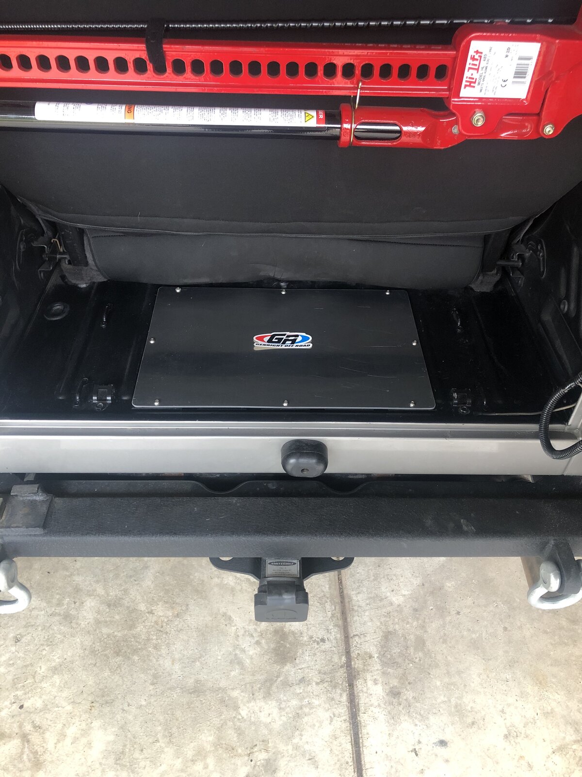

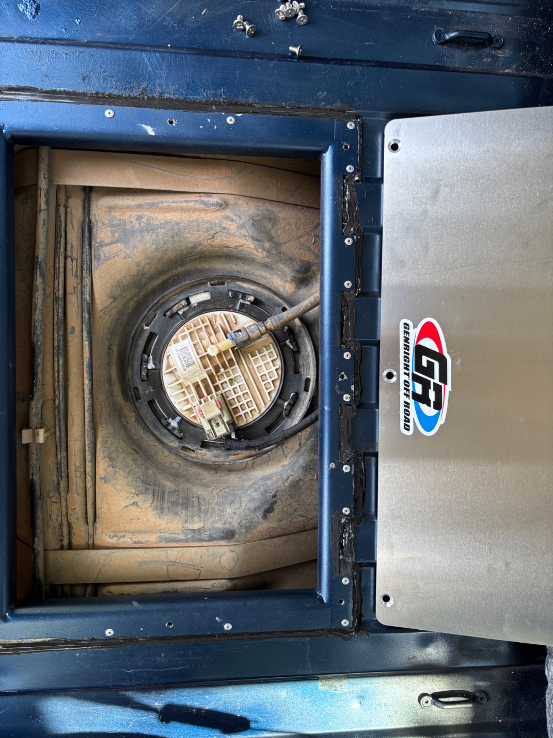

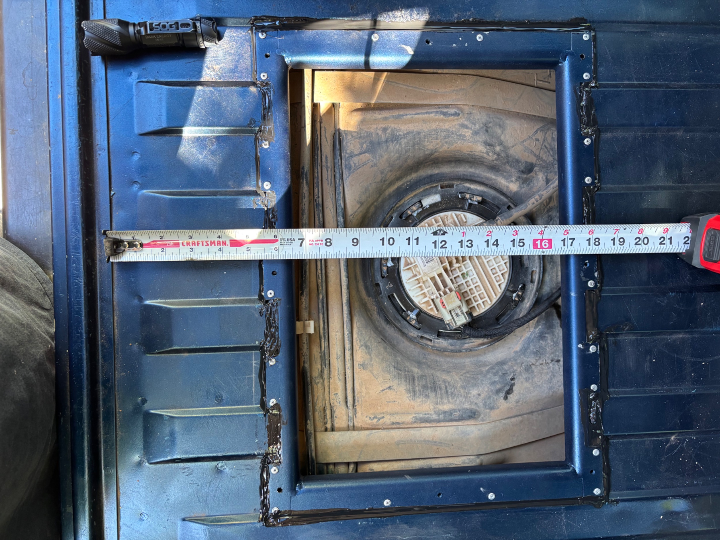

Adding reference dimensions if an LJ owner is considering adding a GenRight fuel pump access panel. There’s a specific design for the LJ due to wider floor ribs…. P/N: GST-5060 Long story short, the instructions for placement/ hole cutting instructions are, in my opinion, incorrect. They give a dimension of 4.9” whereas I went with something closer to 5.6” which ensures you’re able to have clearance to remove the fuel pump. See photos. I used auto seam sealer to seal the frame to the floor pan, that seems to work well. The reason I needed access was not for the pump, but to perform the tank filler plug modification to stop fuel spit when fueling the vehicle. This provided great access for that purpose and then when the fuel pump goes on a full tank, no need to fight with dropping the tank!
