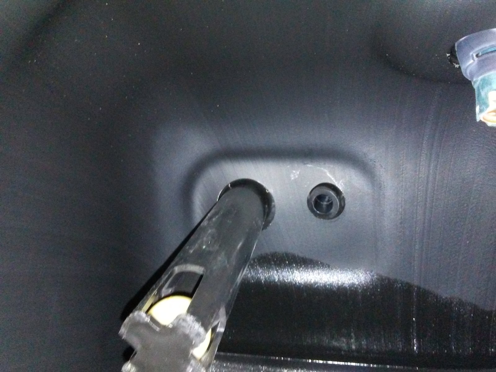

First, here is a picture of my gas tank, dropped from my 1998 Wrangler SE. If you enlarge this you can read that it is part no. 52018687AB, what Jeep lists as the 15-gallon tank.
The picture also shows the two tubes: the thicker fuel filler tube and the thinner vent tube. Next is a picture of the inside of this tank, showing where the two tubes come in.

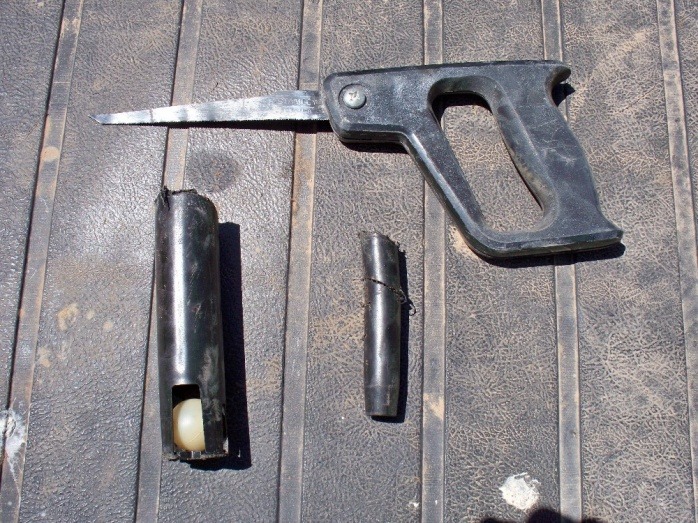

As many have said, you only need to cut off the thinner vent tube protruding inside the tank, not the thicker fuel filler tube. You do this by feel, since you cannot see inside the tank. The easiest way to do this is with a "PVC Cutter." This also makes a very smooth cut.
For those who are inexperienced, or mechanically challenged, or both (like me), it may be necessary to figure out the PVC Cutter. They are available from Home Depot for under $10, and from Harbor Freight for $7.50. They are all made in China, so it doesn't matter which one you get. They come with the blade closed, with no button to open it, and no instructions. As I learned from YouTube, you have to pull apart the two handles to open the blade. Then reach inside the tank with it, place it up against the side of the tank and around the vent tube that you want to cut, and start squeezing the two handles together to ratchet it closed. The first couple ratchetings are not cutting anything, then it engages the tube and cuts it easily like butter. As can be seen in the above picture, it leaves about 1/4 inch of the vent tube still protruding inside the tank. This cuts off about four and a half inches of vent tube, which can be seen along with the PVC Cutter in the picture below.

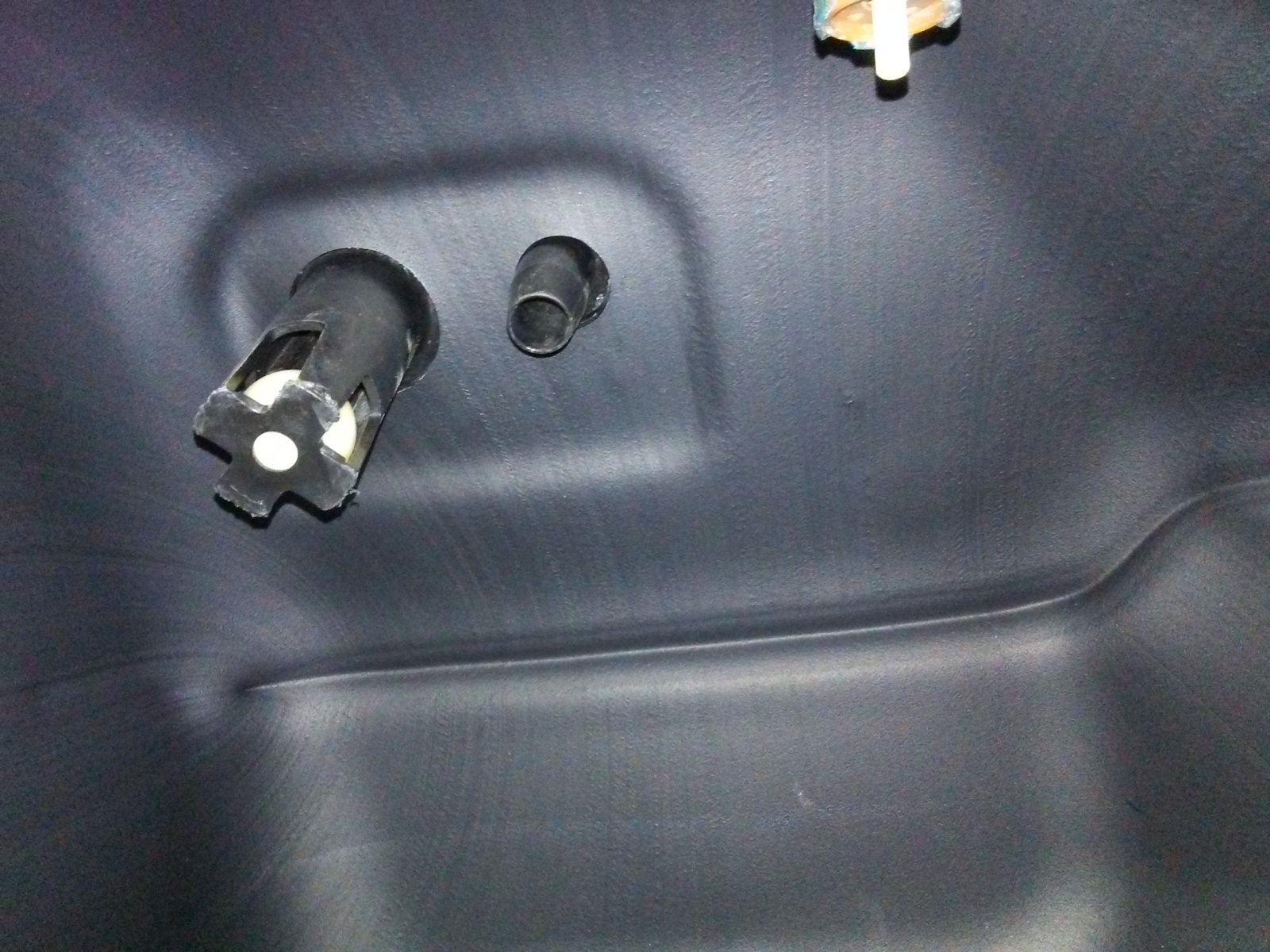

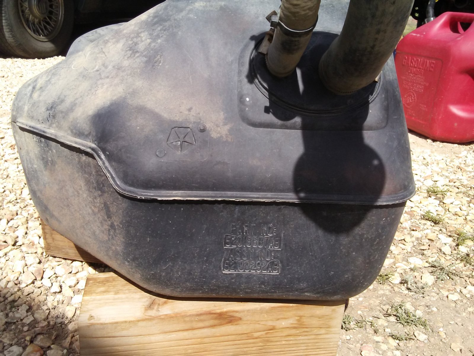

It turns out that I did not keep the fuel tank that I modified, after seeing some damage to the tank in two places. But this is a plus for this thread, since it allows a clear comparison between the two fuel tanks that Jeep offered on 1997-1999 Wranglers. Yesterday I went to FN Jeep in Colorado Springs and bought a stock 19-gallon fuel tank from a 1998 4.0L. It is part no. 52018768AB, what Jeep lists as the 19-gallon tank. You can see the part number in this photo:
The vent tube on the inside extends only a short way into the tank, as this photo shows.

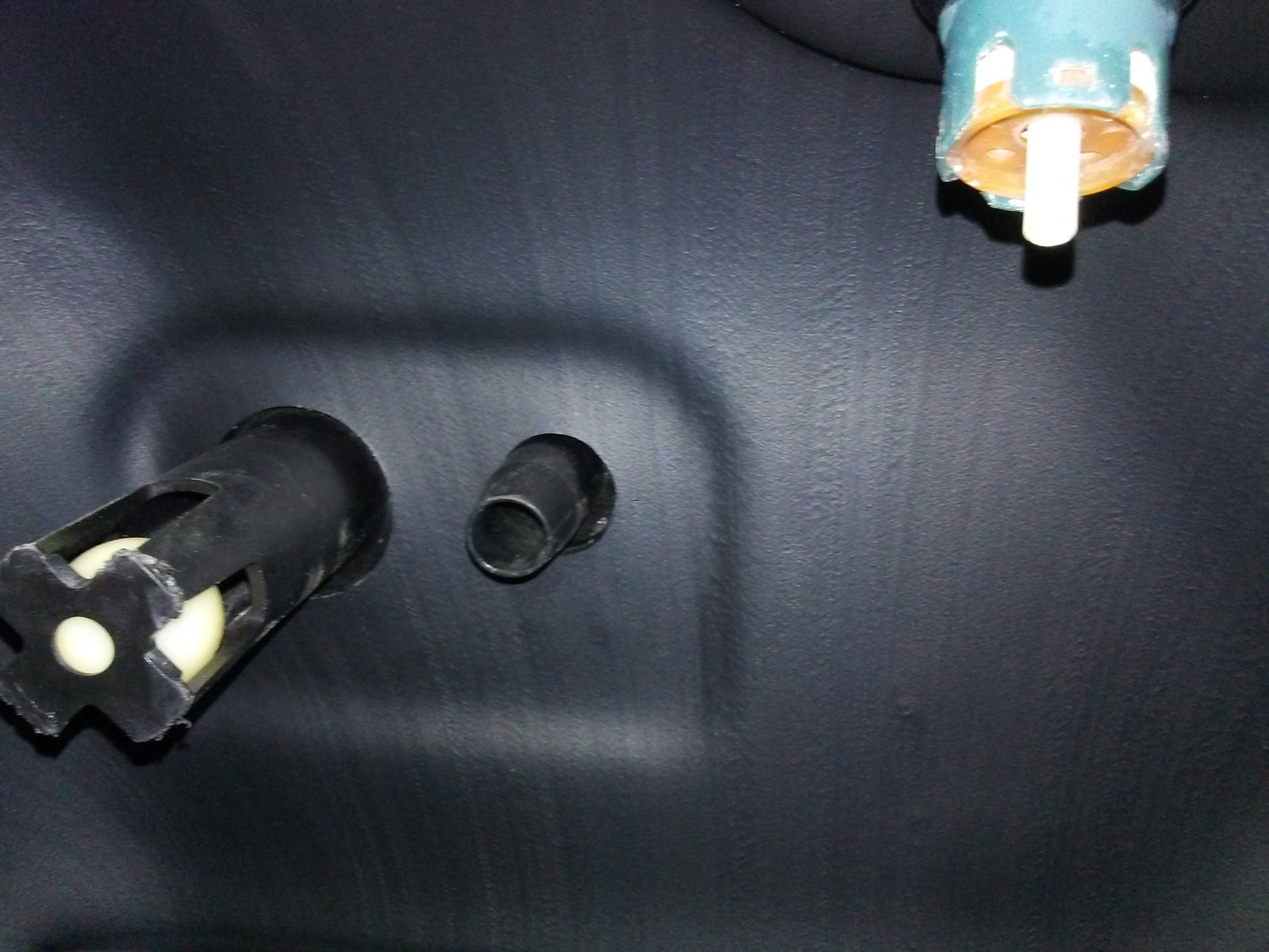

You can also see that the fuel filler tube is considerably shorter than the one on the 15-gallon tank. Here is another picture from the 19-gallon tank, showing this part better.
FN Jeep also had a 15-gallon tank from a 1998 Wrangler, like the one that came with my 1998 SE, pictured in my previous post. According to The 1999 Jeep Wrangler Owner's Manual (I found a physical copy), the 15-gallon tank still came standard on 4-cylinder models in 1999, like it did on the 1997-1998 4-cylinder models. Here is a picture of the inside of the 1998 Wrangler 15-gallon tank that FN Jeep has.
To be clear, both tanks are identical in size. Both have a 19-gallon actual capacity. The so-called 15-gallon tank only has a longer fuel filler tube and a longer vent tube, preventing more than a 15-gallon capacity.

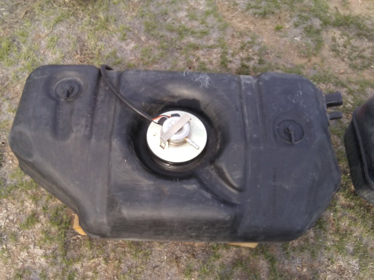

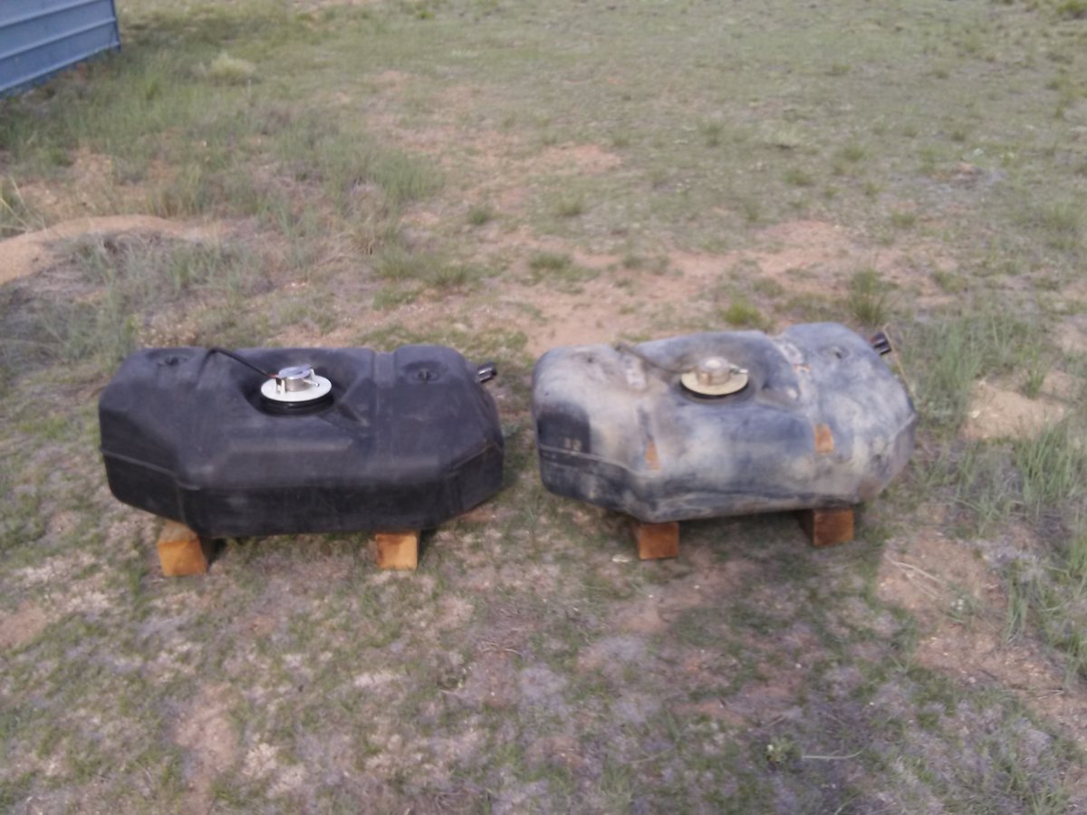

For the record, here are photos of the two tanks, showing that they are identical in size. The 19-gallon tank from a 1998 six-cylinder TJ, part no. 52018768AB, is the black one that we scrubbed clean. The so-called 15-gallon tank from my 1998 four-cylinder TJ, part no. 52018687AB, is the still dirty one that is black underneath the dirt.

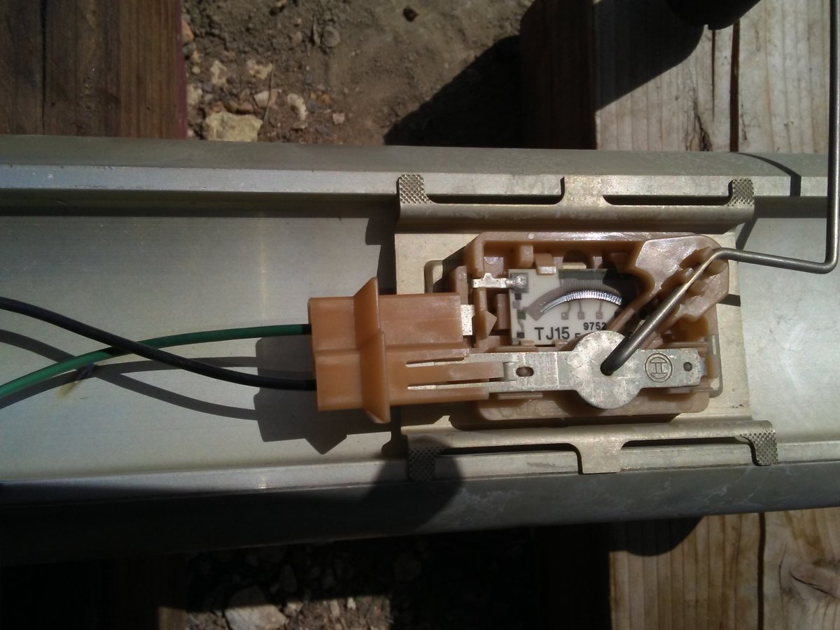

Questions about the fuel pumps in the two tanks have also arisen. As far as I know, they are identical except for the gas gauge float mechanism that tells the gas gauge that the tank is full at something under 15 gallons or something under 19 gallons. Those who have kept their 15-gallon fuel pump after making the modification to 19-gallon tank capacity report that it just shows full a lot longer.
The fuel pumps themselves are identical in size. I measured the height of my old 15-gallon fuel pump and the new Delphi FG1353 19-gallon one that I bought. The photo below is a bit misleading, because of the filter on the bottom of the new one and the electrical cord wrapped around the top of the new one, and the new one being a little closer to the camera, but they are the same height.
97890
The close-up photo of the old one shows TJ15 on the gas gauge float mechanism.
