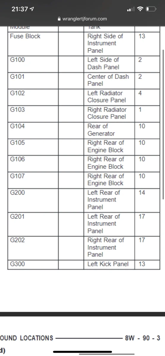

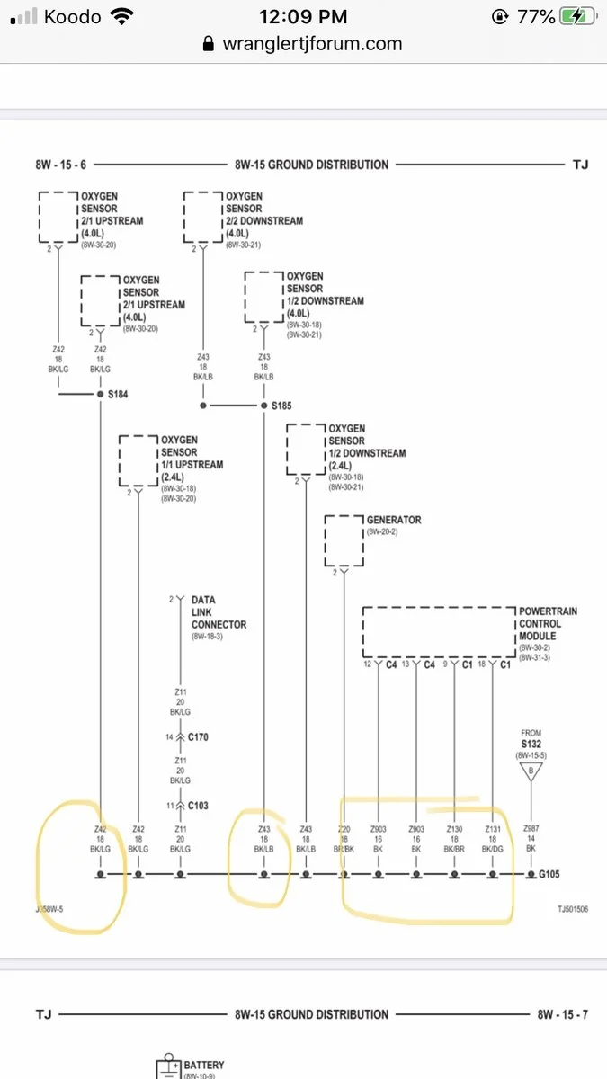

G105 ground location?

I’m driving myself crazy unfortunately lol I been eating, breathing and sleeping my Jeep for over a month now. It’s something to do with the engine wiring harness or the pcm. It’s one of those two but before replacing the computer I have to troubleshoot the harness which isn’t easy but there’s some old timer Jeep junkies on this forum that are awesome— they been helping me out a lot this past day or two now. Greatly appreciate it.

Hey turbo!!!! Can you tell me where I can find these ground points please !!!!???

It’s important to remember that everyone on here is trying to help in the way they know, effective or not 😂 I would start with taking each plug connection and shooting some contact cleaner in there - quick wire brush and cleaner on that oily stud, and use a voltmeter to make sure there isn’t a hidden short. Sometimes you have to sort through the unless stuff to find the good advice - but I promise no one here thinks you aren’t capable of fixing it yourself :)
spray some electrical contact cleaner in the female plugs to the 02 sensors?

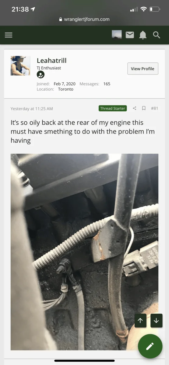

Look closely at the picture you posted in post number 81. See there are multiple wires crimped into single ring terminals.
Hi Daryl, I don’t know how to find post 81. Which picture is it? Is this the g105 grounding closest to battery behind the dipstick?
