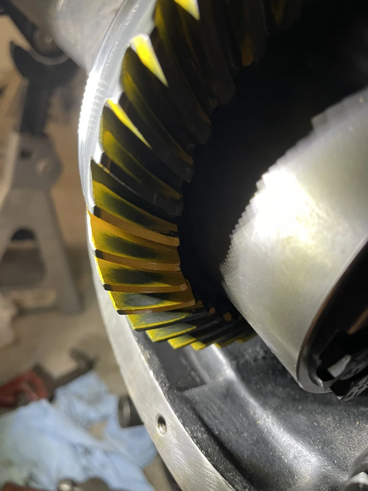

Gear pattern: a different perspective
I added .010 back to pinion depth. Preload at 16. Gear lash at .007. This looks good to me.

Might be worth doing some googling to find a kit with a combo that works combined with yours
His call i guess on if he wants to just run it or wait on another shim pack?
I like the .006" backlash it pulled the coast contact away from the outside
If I have to run the pattern a touch on the deep side I like to keep the backlash opened up a touch just to be on the safe side of running the gears too tight initially. And it is a front and while we want to set them up as best as possible, we can fudge a smidge without too much worry.
Also remember that really all we are wanting to make sure of the most is the location of the pattern from root to crown and not worry about heel to toe.
