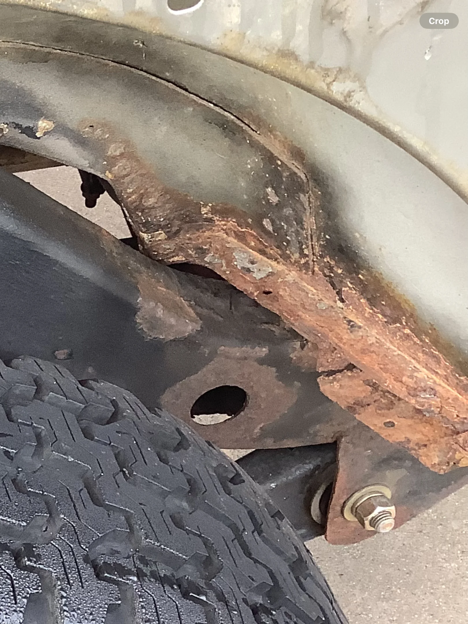

I forgot to mention, if you want to treat the rust rather than cut it out, get some Evaporust. It's not an acid, but a chelation fluid that will remove pitted rust without harming the base metal. Doesn't harm your skin, and about the consistency of water. But it works very slowly and needs to be kept wet. For small items I just leave them over night in a bucket of the stuff. For surface rust on otherwise sound panels I used a flap disc or sand paper to remove most of the rust and then soaked paper towels in evaporust and let them sit on the metal for a day or two, using a spray bottle every few hours to keep the towels wet. You can see the towels turn brown from the rust it leaches out and then you can wash off the evaporust and repaint or fix what's left. It works so well I threw all the phosphoric acid away.

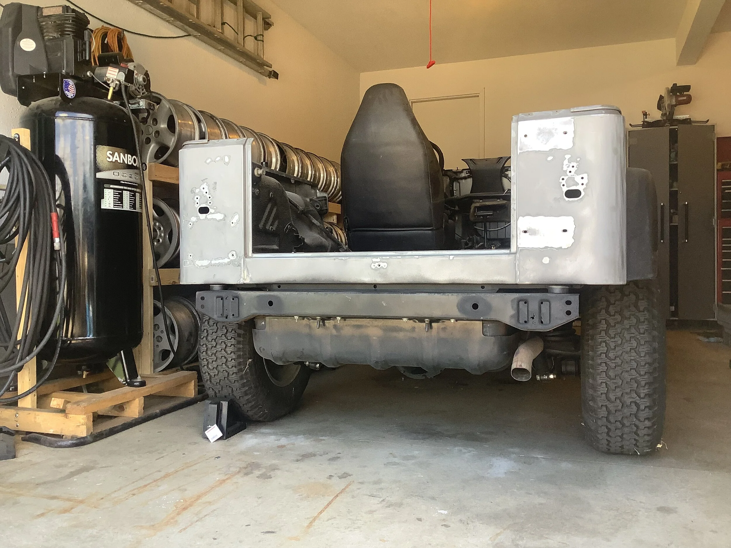

Rear floor pans were delivered today

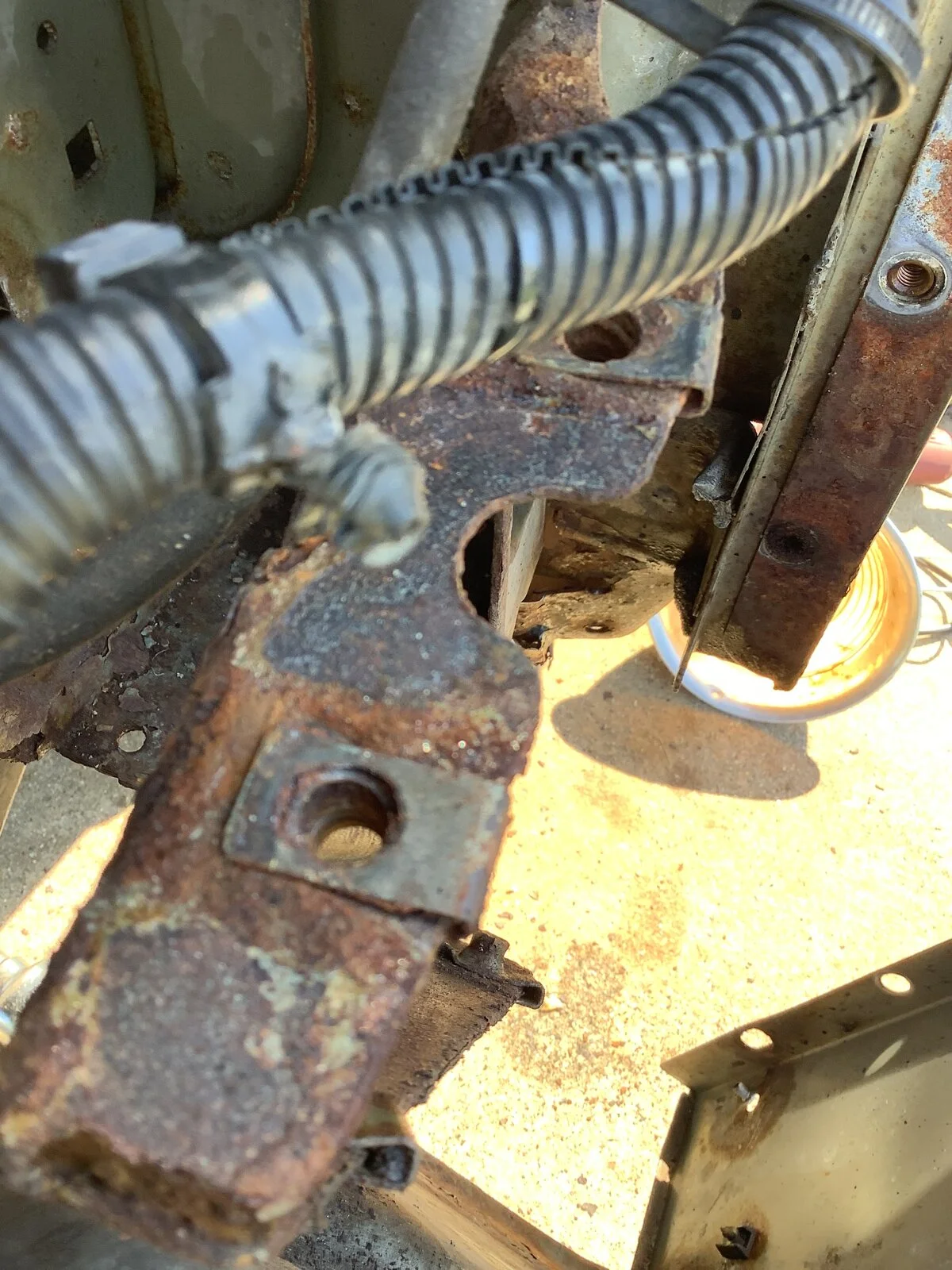

This mornings progress:
-Drilled out some of the torque box spot welds

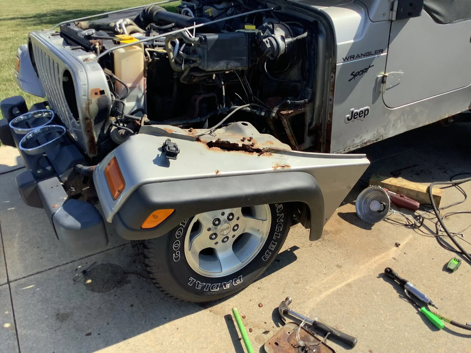

-Removed fender (easier said than done!)

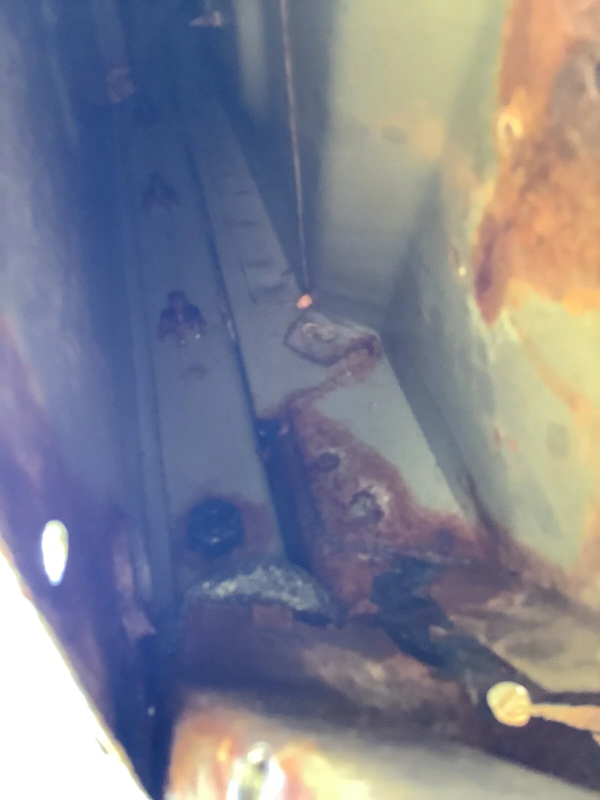

Discovered what I think is a bad seal job which may explain why my driver side rusted out so much worse. I broke off one of the bolts (first one) for the fender at the front before I realized I should have removed the headlights to spray liquid wrench and use heat.
As for the fender bolts into the tub...this was a great time to do that because I had the bottom opened up and could spray liquid wrench into the back of the bolts and heat. It looks like only the bottom one was rusted badly.
Fender moved

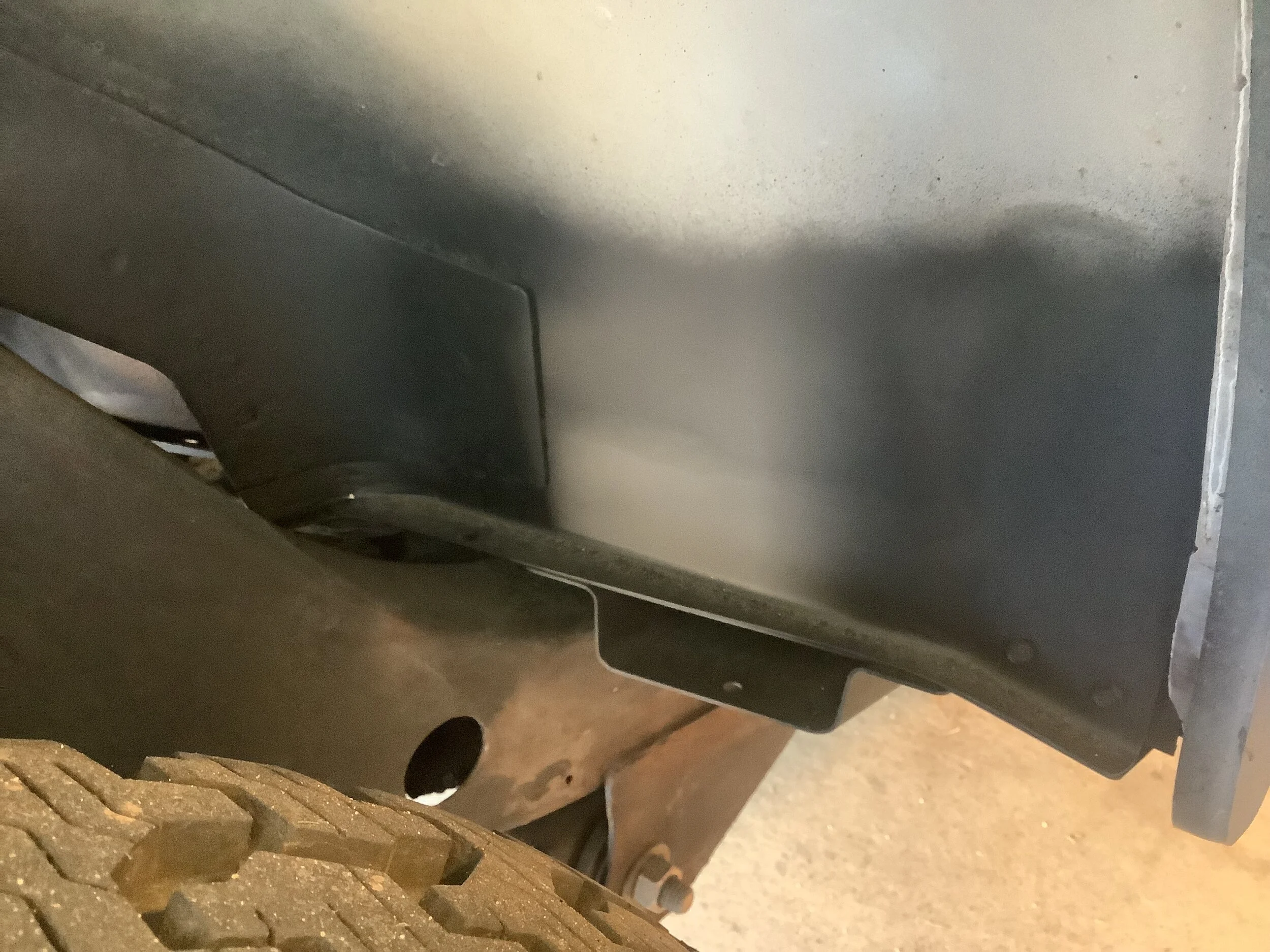

See the gap at the corner where light shines through? I could be wrong but it looks like the sealer didn’t get into the corner like it was supposed to.
The four bolts holding on the fender. Bottom one is rusty but top three look good and came out easily.

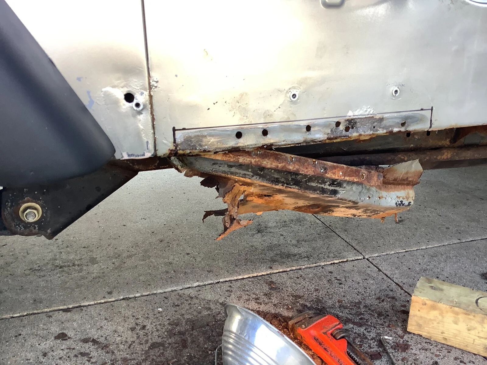

Spot welds removed. It was hard to find them among the rust, bondo, etc (from an earlier bad attempt by me to fix the rocker rust)
I know it’s been a hot minute since you did this but I’m using your “blog” post as a guide…could you have just removed the bracket that connects to the fender and the torque box without taking off the fender?! I’m hoping it’s a yes cause I’m not wanting to keep working on taking off the fender haha

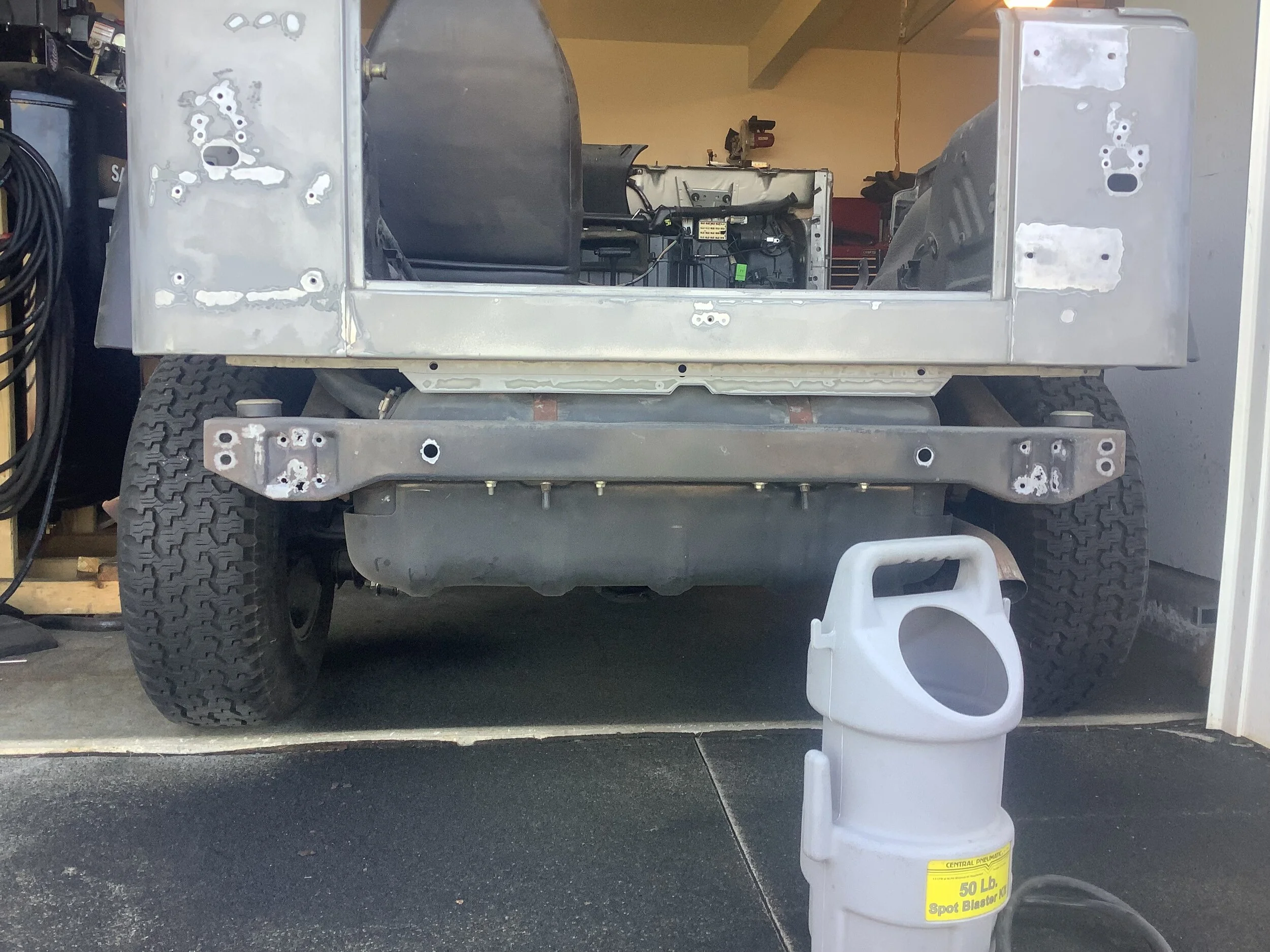

Looking good! I might have missed it but how are you sand blasting it? Do you have an outdoor sandblasting setup that can tackle something the size of a jeep?

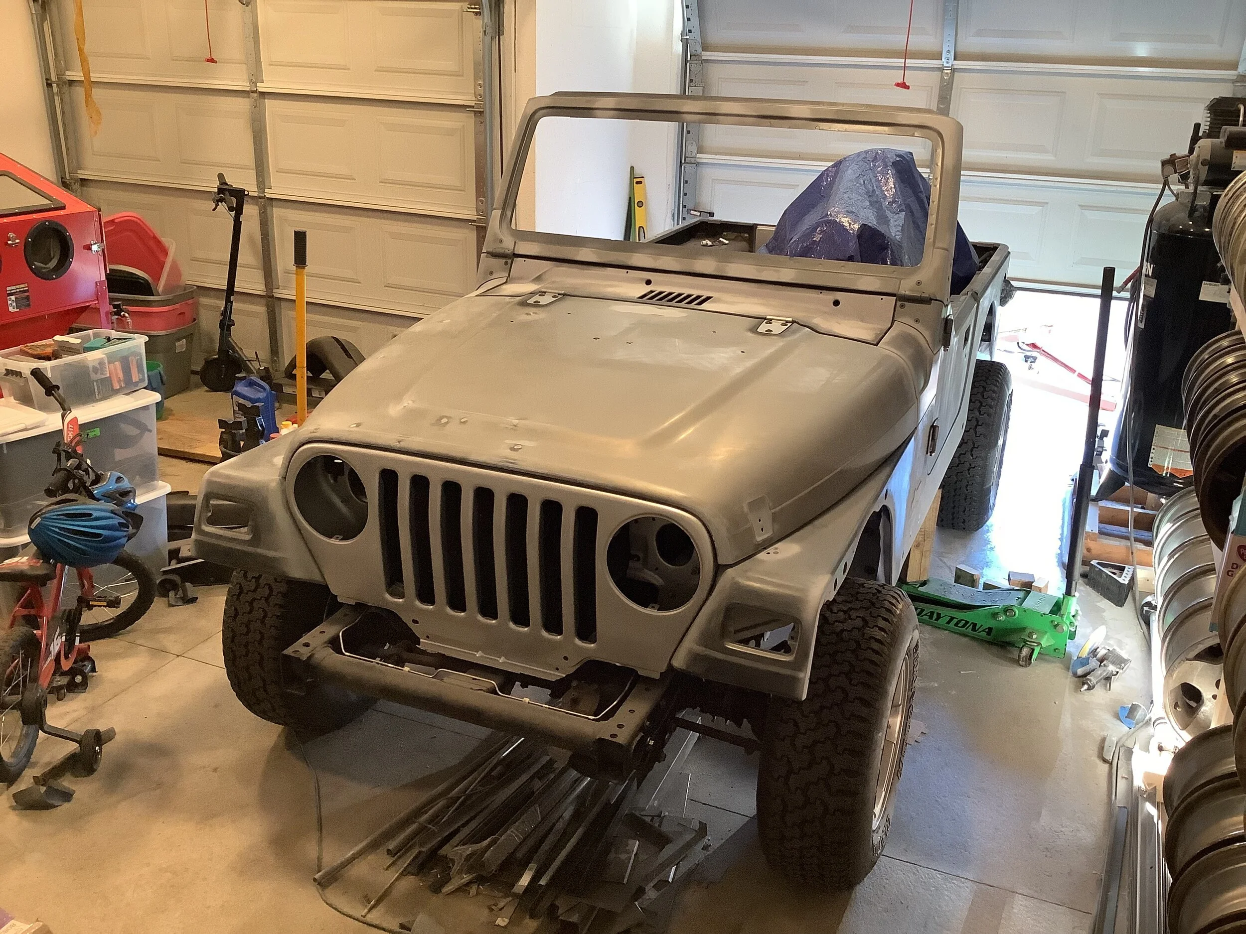

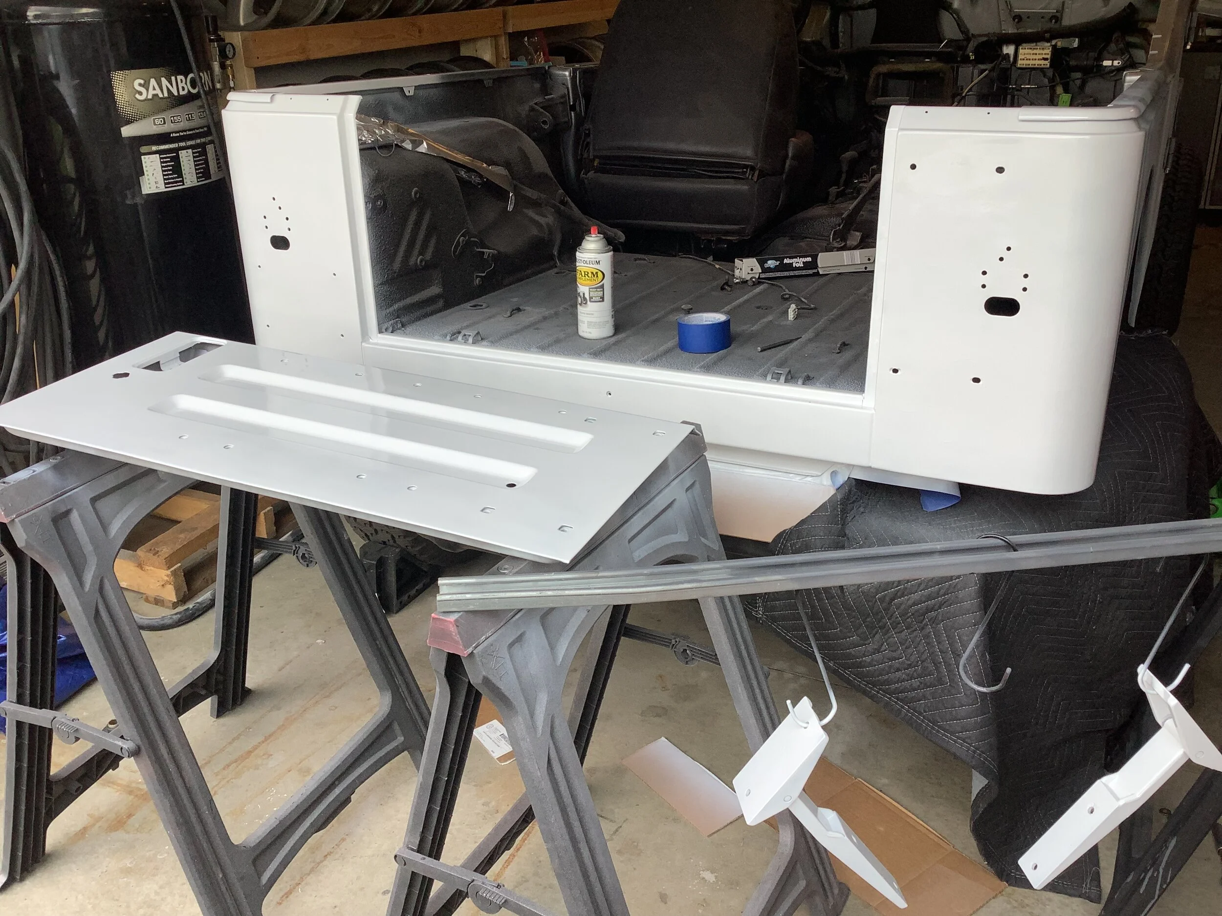

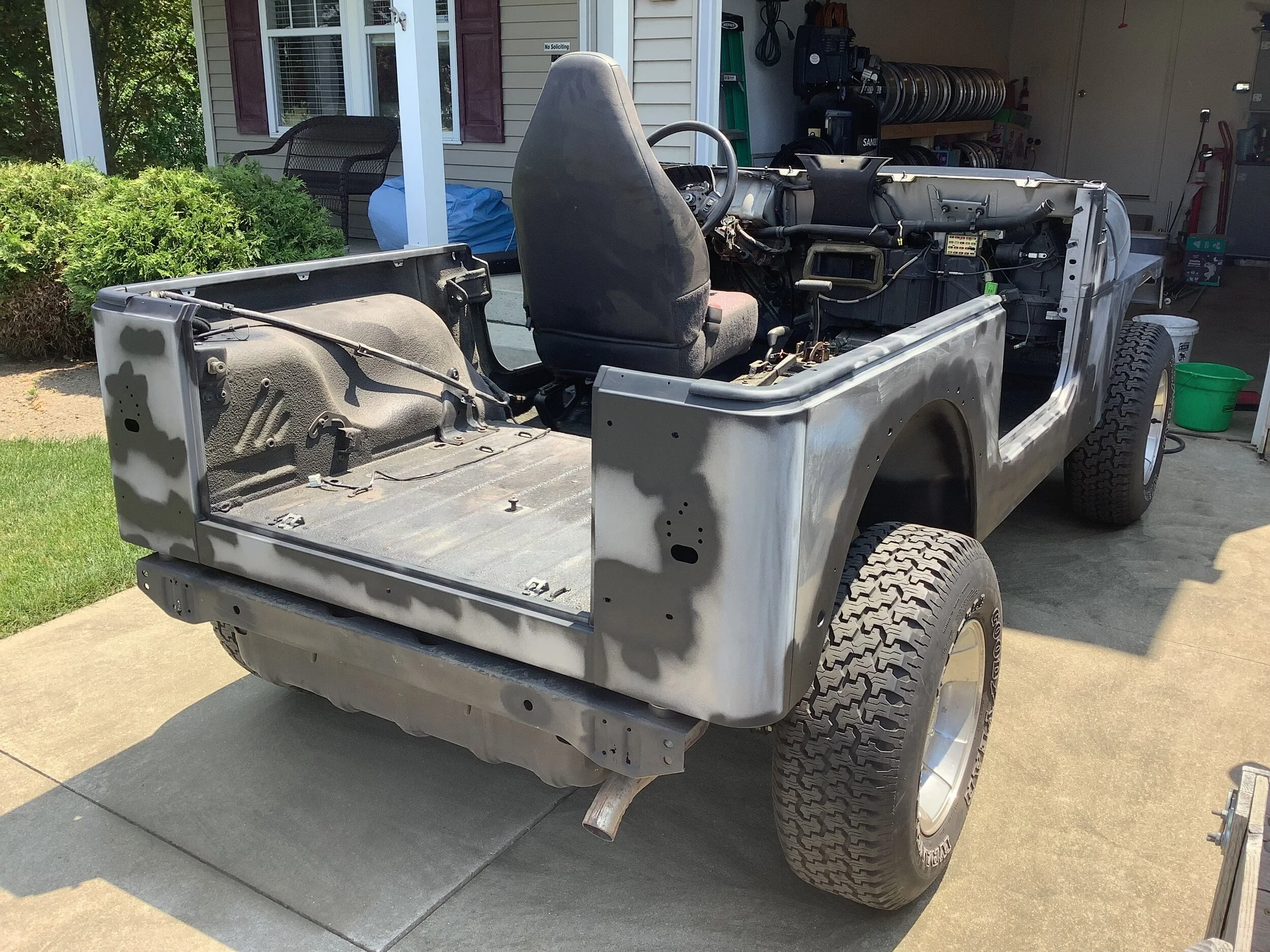

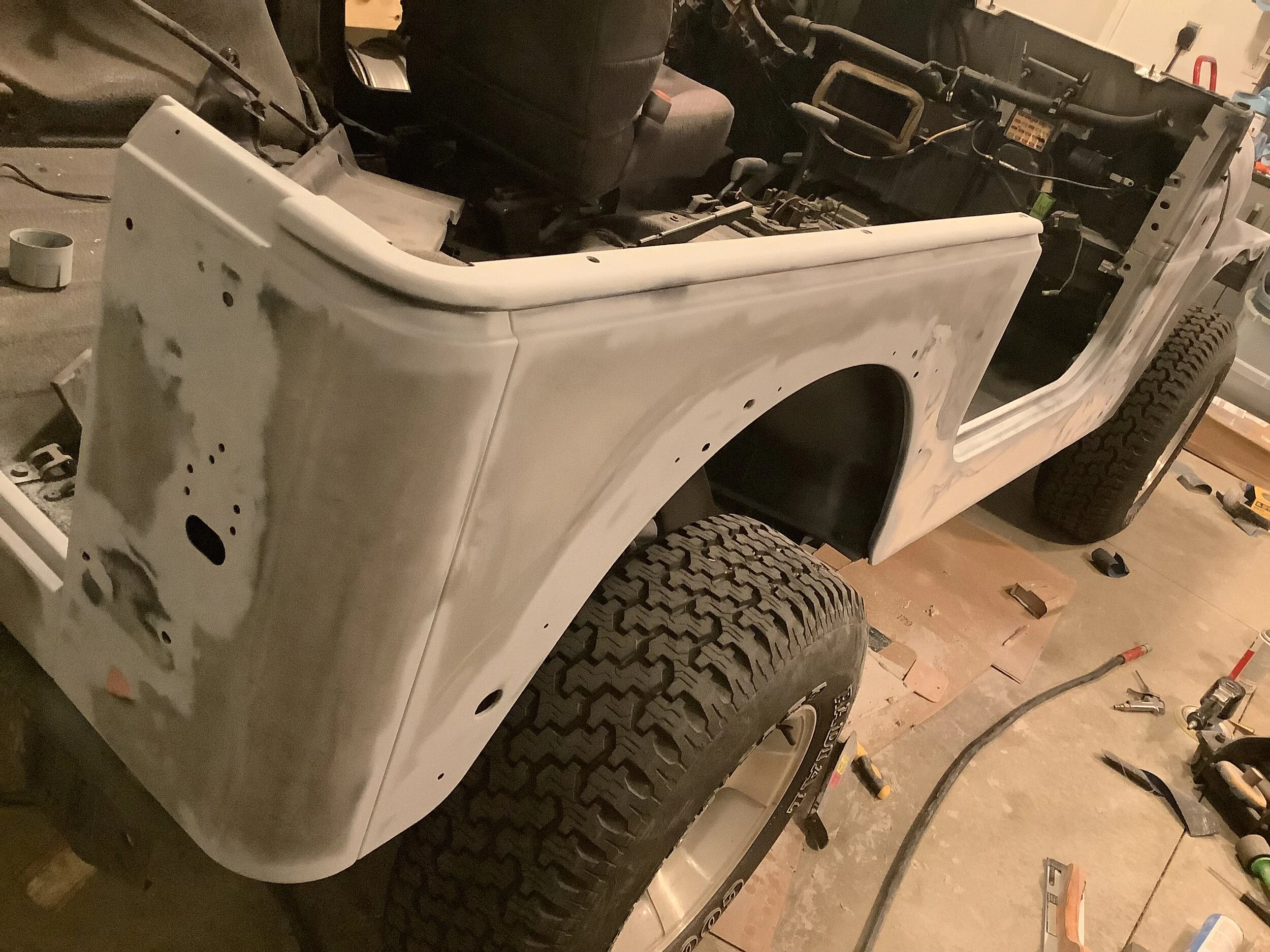

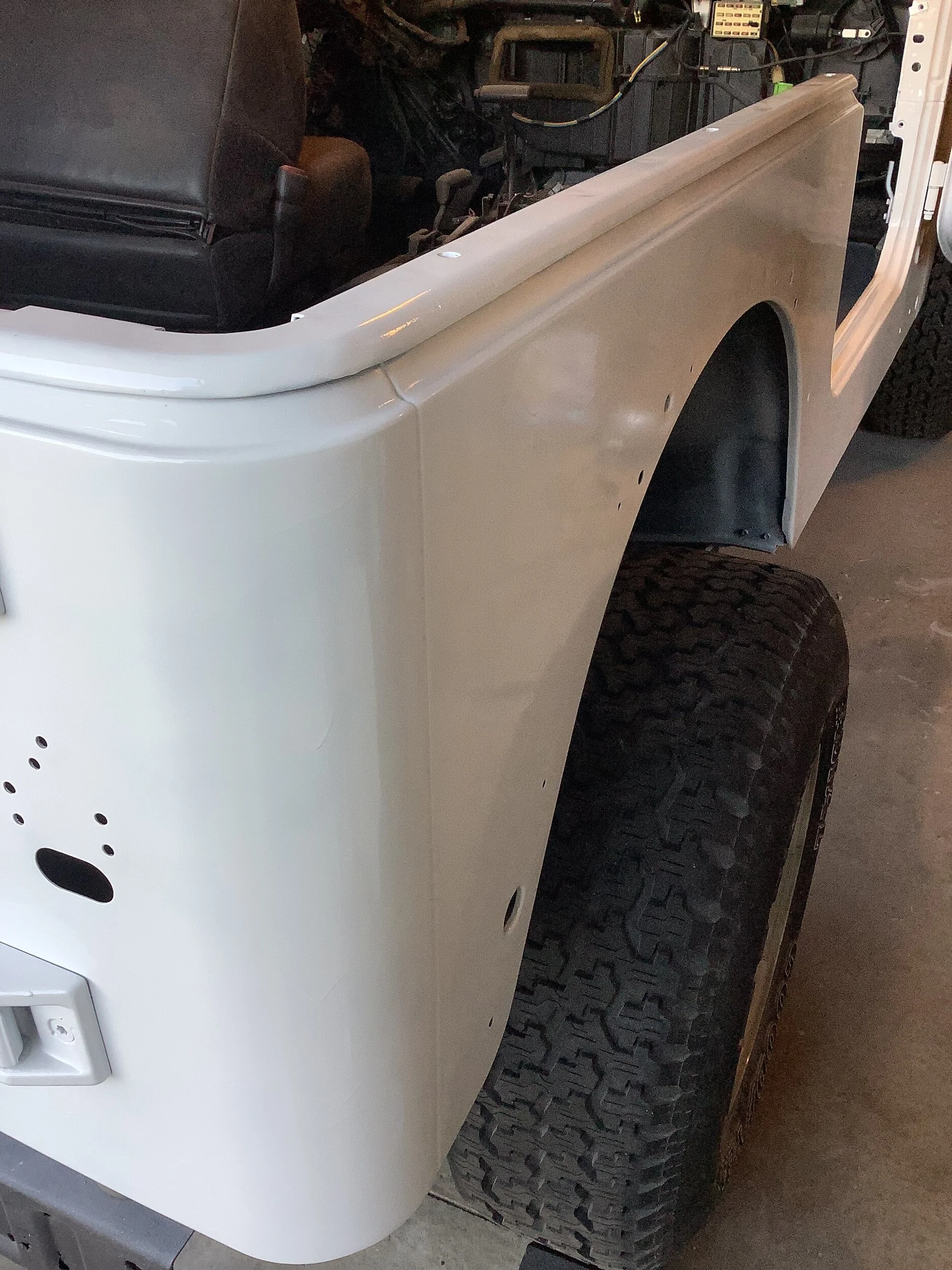

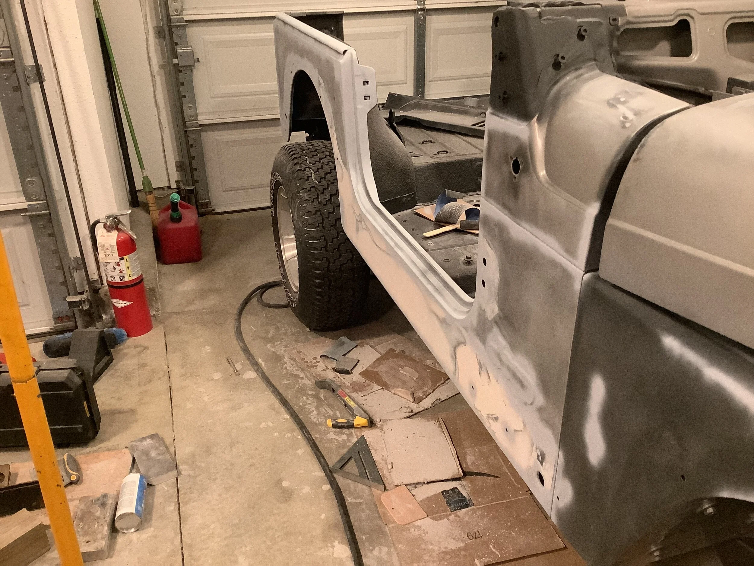

Spent a lot of time on this project the last week. Lots of sanding, filler, glaze, primer, sanding, sanding, sanding.

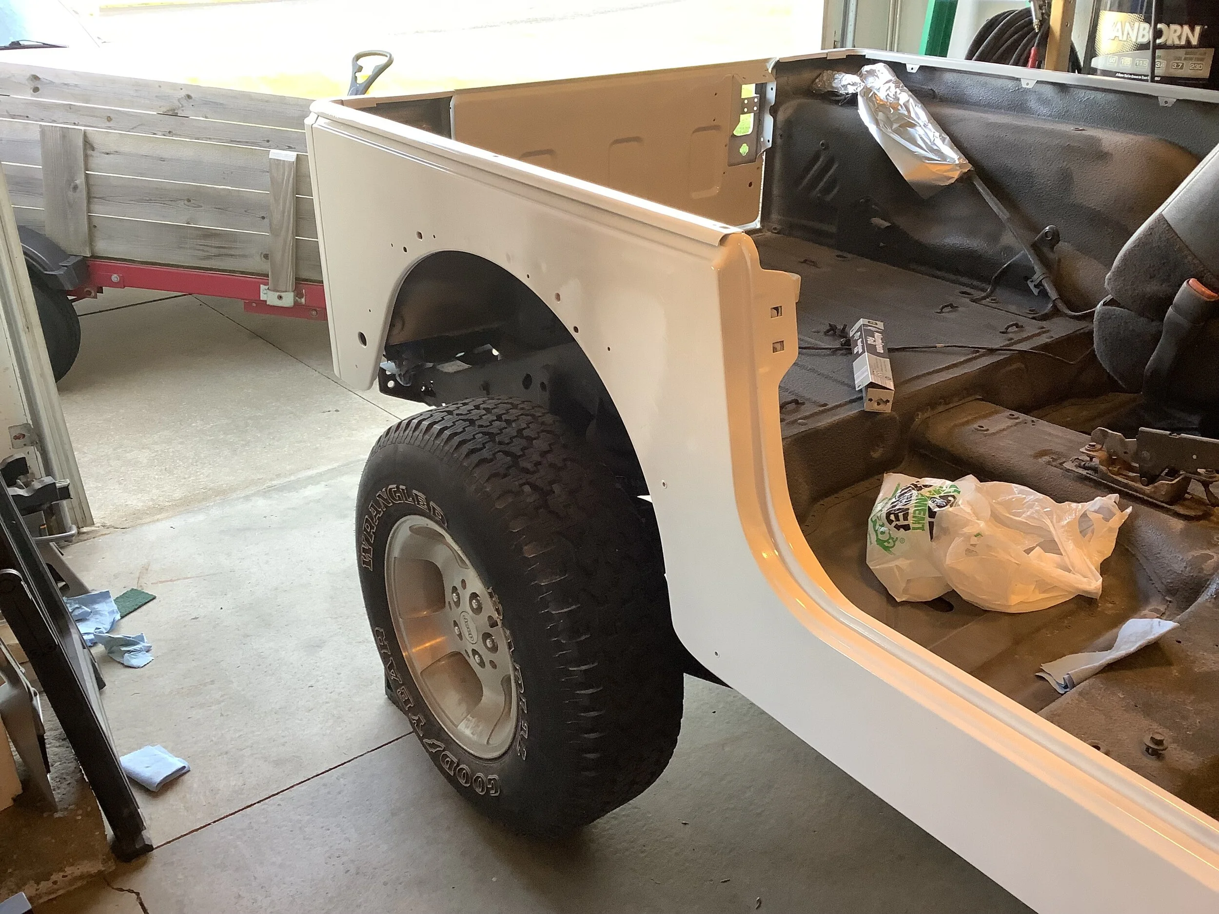

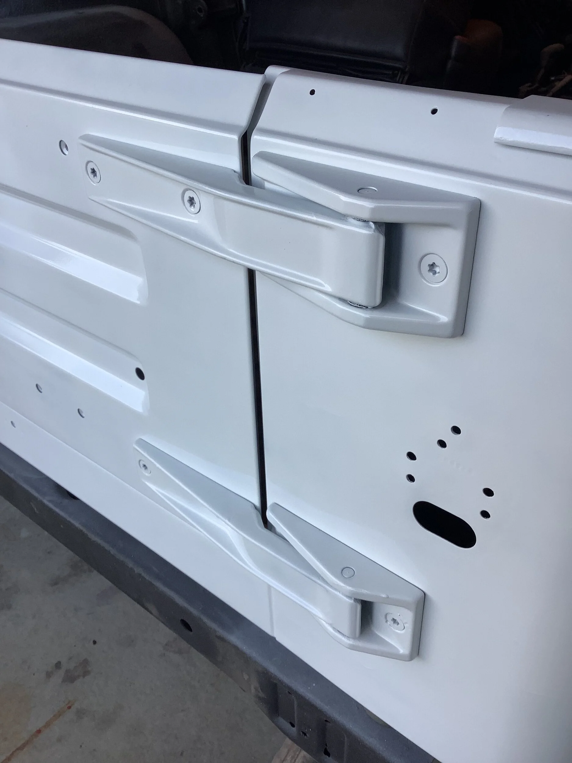

I started putting the pieces back together. Sandblasted and painted all the hinge bolts. Discovered slight dent on tailgate. Fixed dent. Attached and aligned tailgate. Sanded tailgate. Discovered another dent, fixed, sanded.
Attached and aligned hood.
Attached windshield frame.
Attached and aligned doors.
Drilled out holes and installed 10-24 nutserts for flares.
