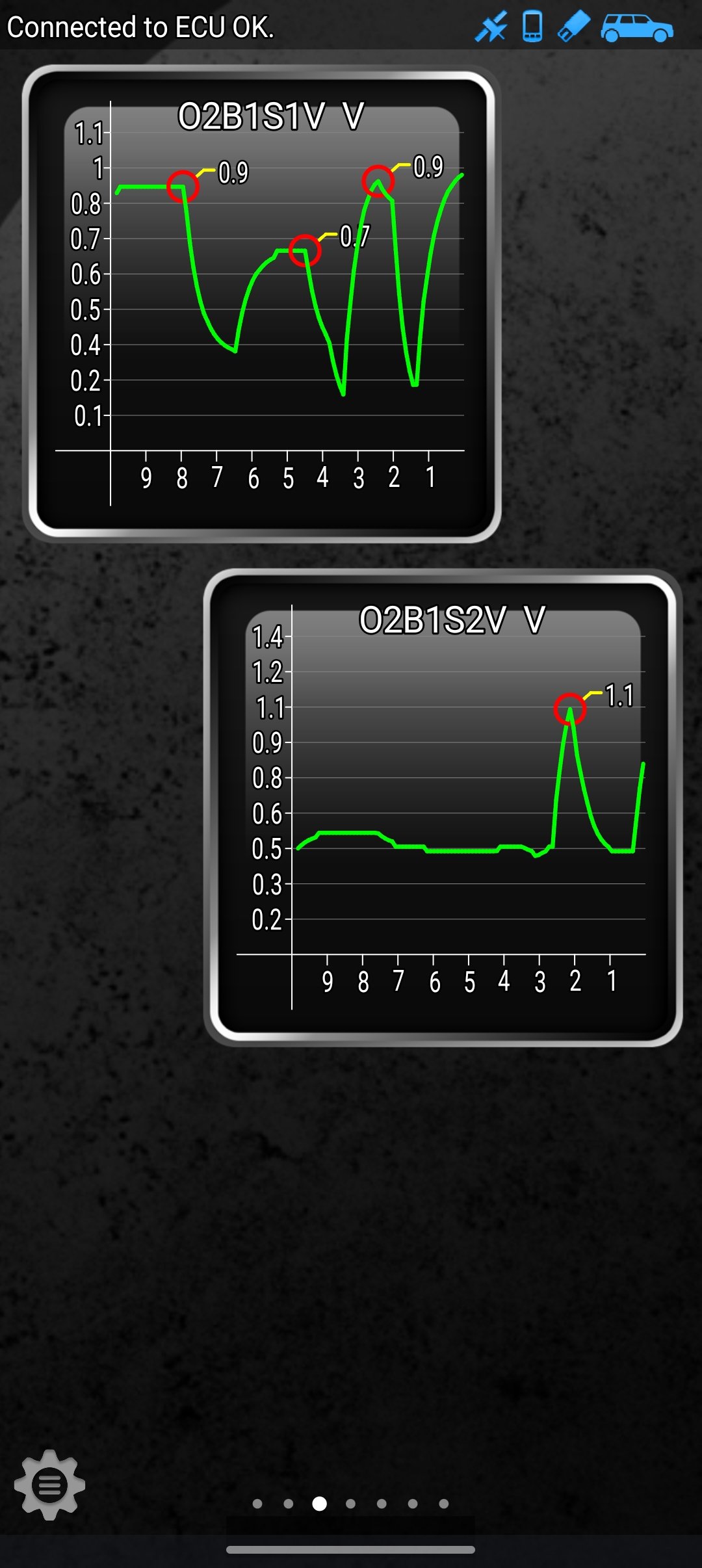

Definitely hop on those issues quickly so you don't melt your new cat. I normally see the S1 above pre-cat sensors in the 0.05-0.85 mV range with the system desired O2 voltage at 0.490V. They oscillate, but the pattern is not like a sine wave. S2 sensors follow a little behind in the scan but in the same ranges.
Above 1V or at 0.0V you've got a bad sensor.
As for the vacuum leak, a pressurized smoke tester is really helpful for this. It's easiest to plug it in to the vacuum line that goes from the intake manifold to the brake booster and then just check everywhere on the intake side. You'll see some smoke come past the IAC valve in the intake which is normal. But anything coming off the manifold, injectors or any of the vacuum tubing needs to be addressed. Don't forget to turn the smoke connection around and check the brake booster for vacuum leaks, though people tend to notice the lack of braking power. Sounds like you're making progress. Good luck.
