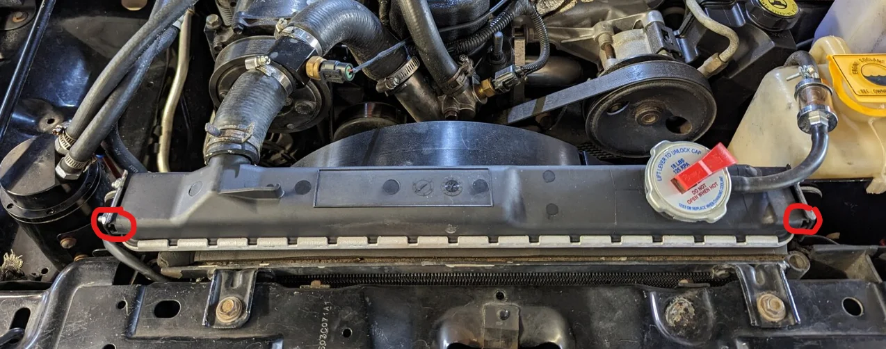

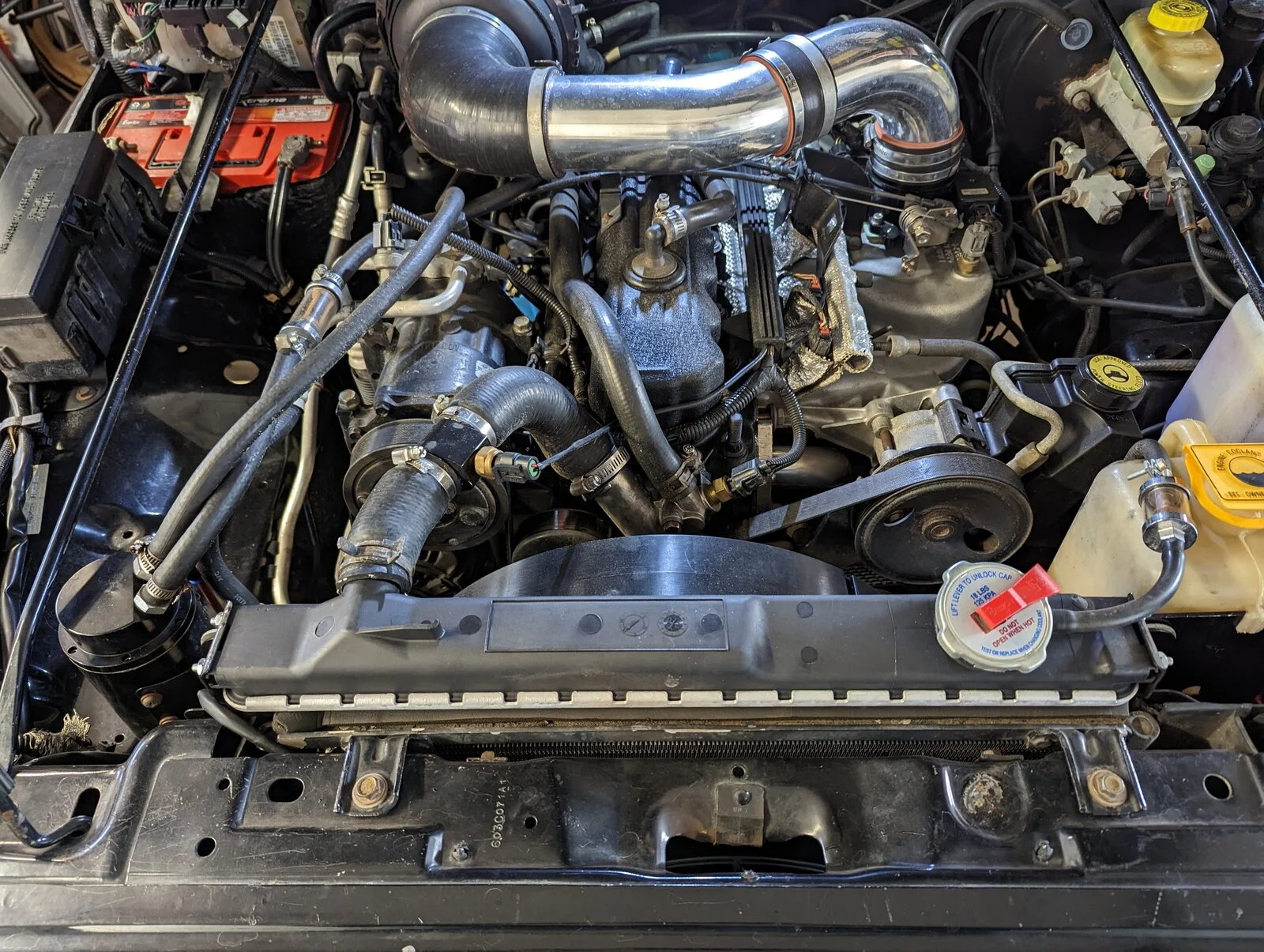

Go out to your TJ, lift the hood and prop it open. Carefully examine how the mounting flanges attach to the radiator. Note the small pocket cast into the plastic tank to stop the head of the fastener from turning, a very small fastener at that. Extrapolate that out to understanding if there was enough flex in the grill shell to hurt a full aluminum radiator, it would rip those little bolts right out of the end tanks.
I'm trying to wrap my head around this. Are you talking about the 2 studs/nuts on the side near the top of tank?
No, I want you to look at how the mounting flanges are attached to the radiator. There are two small slots on each side of the tank that they slide the heads of around 3/16" fasteners into to stop them from turning when they put the nuts on. Once you realize those little molded slots are all that holds your radiator in and they are molded into the plastic, the rest of the crap becomes obvious.
Reactions: Moglocker
Okay, I see what you are talking about. Those bolts are weak links that should break with any significant amount of stress from grill flex, thus there must not be much flex to kill an aluminum rad.
Do you have any guess as to what might make the aftermarket aluminum rads die so quickly in TJs but last forever in street cars?
Precisely. That and I know from removing many grills that they are not at all flexible and they do have that V bar brace in front of the radiator that makes them even less resistant to flex.
The only answer is inconsistent quality. I know for a fact that at least 2 of the problem Griffin versions are in rigs that do not spend much if any time at all offroad so they are seeing no worse vibration than a street car on short suspension and needfully stiff shocks will deliver.
The main point is that anyone that who gets fed that line of bull now knows why it is.
