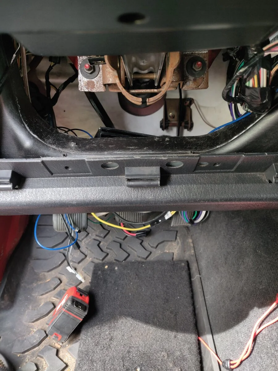

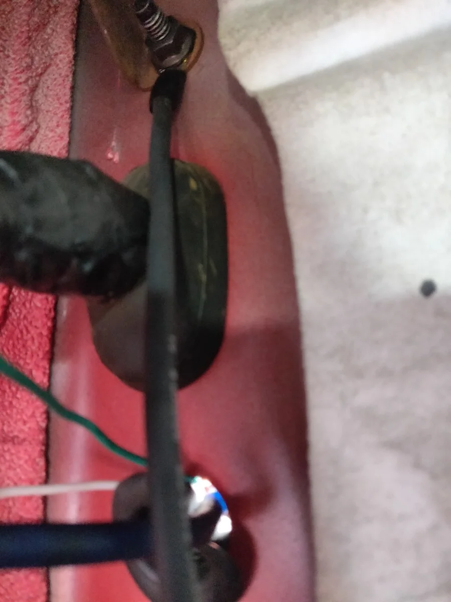

An alternative placement for the amp is behind the dash/steering column, there are a couple good ground locations using pre-existing bolts (scrape some paint off) and a firewall access hole/plug to route the amp's power wire to the battery, both the power wire access hole and grounding point are close to each other.

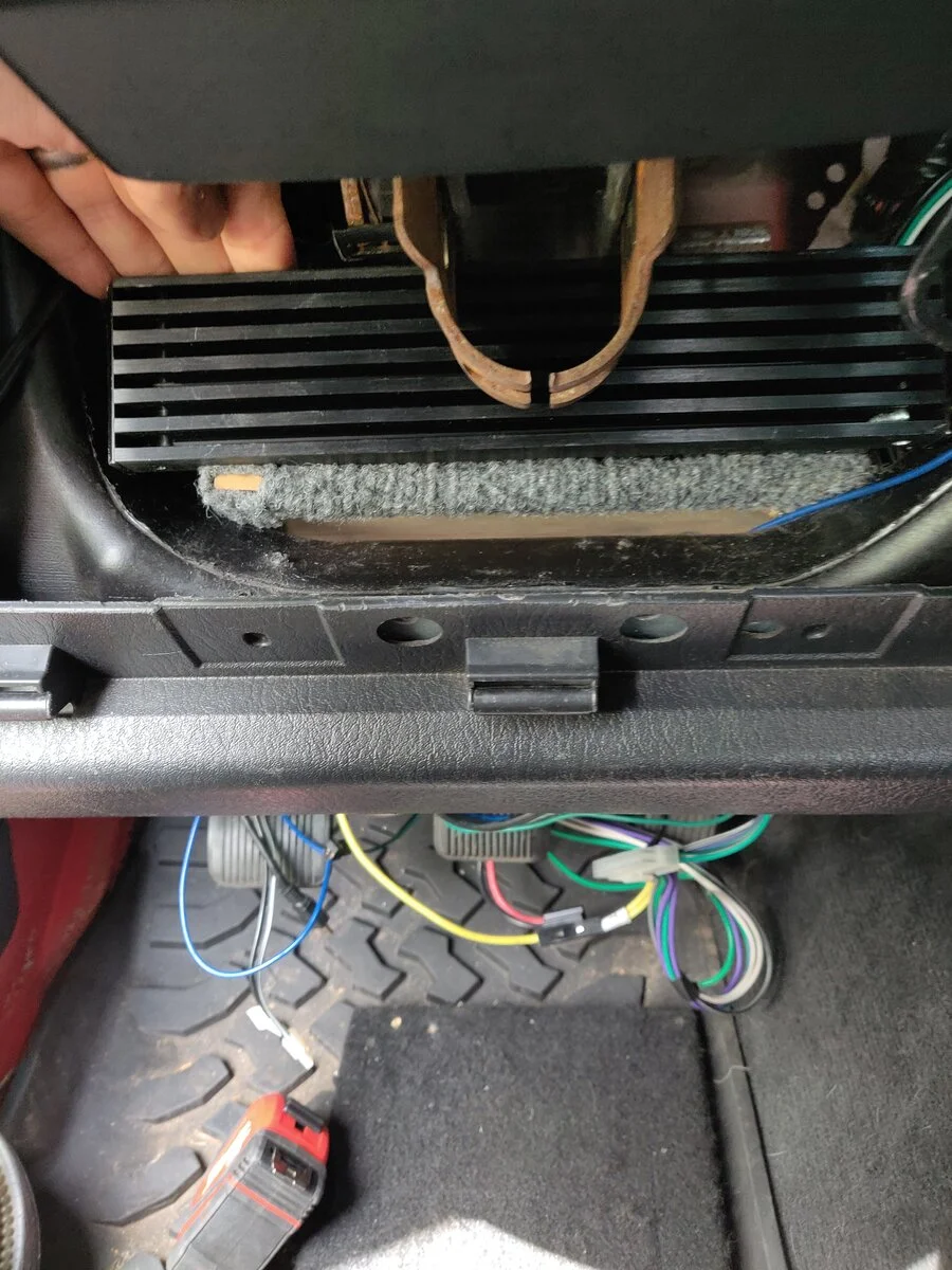

I just installed my amp there on a 7" x 9" board hung to the steering columns brackets using a picture frame hanging kit, and also some Velcro tape for the front. All wires remain behind the dash, and you can run the speaker wire under the carpet below the center console/shifter area.
This was a test board and not my final install board.
Ground location and power access hole, a little light is coming through.
