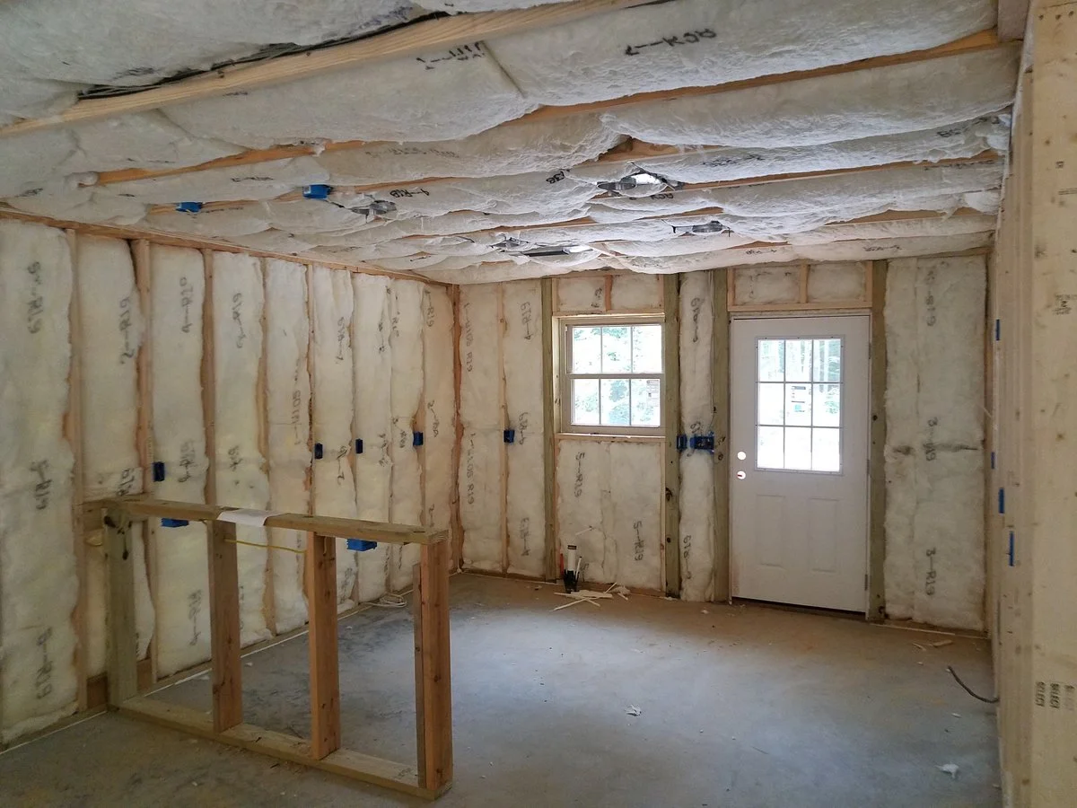

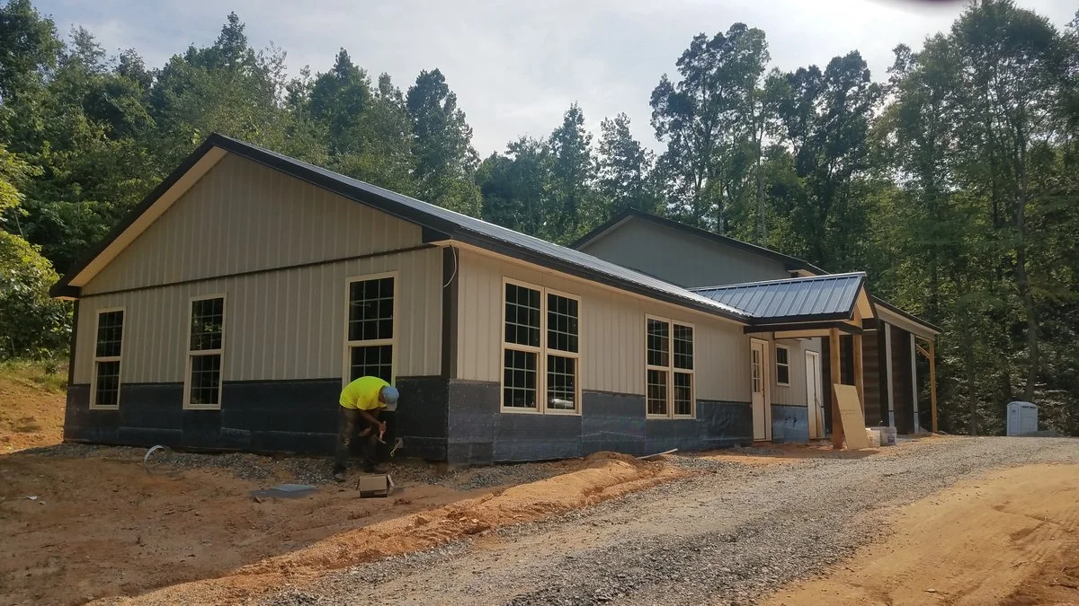

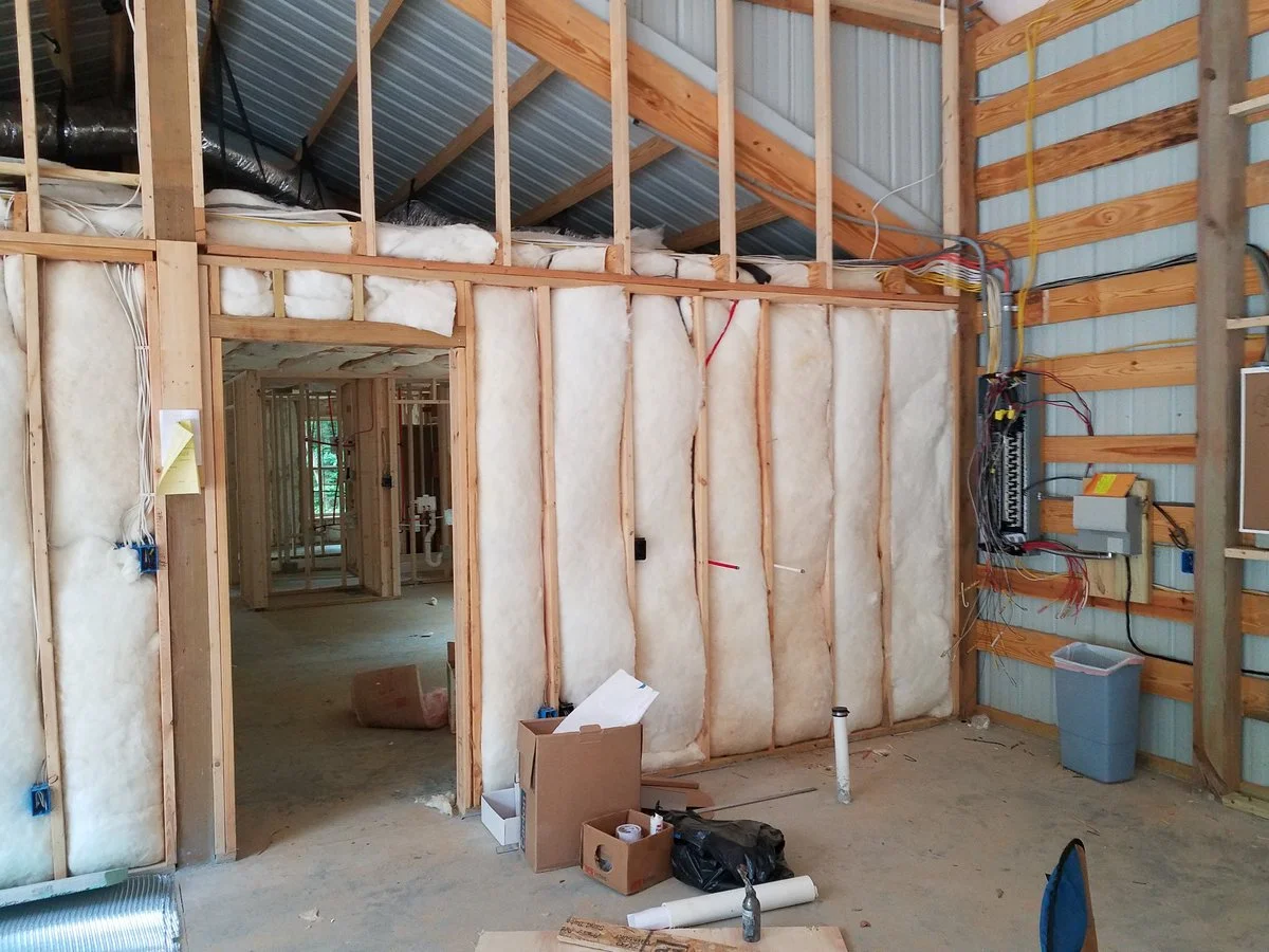

I want to see more pics of the man cave / garage-ma-hol. If my wife an I ever decide to leave our current house (doubtful) I want to do the same thing...Build the barn-a-minium, then build the house.
Sheetrock going up today. Exterior rock goes on next week. The backer board and screening has to dry

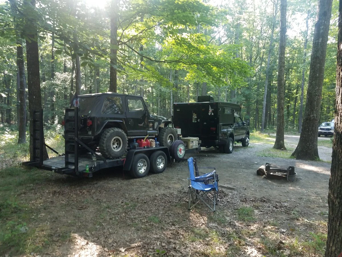

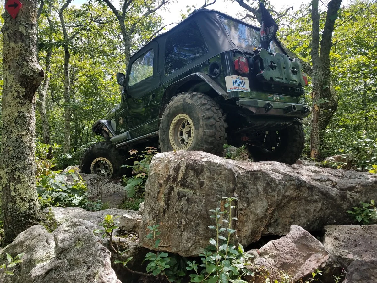

Back on topic however :cool: The club went to Potts Mountain last week...Best camping of the year!!
And I drove over a volkswagon
and a few rocks

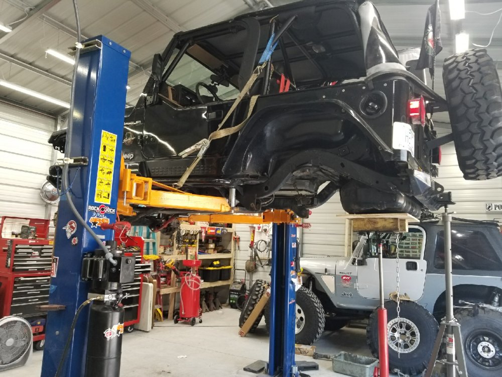

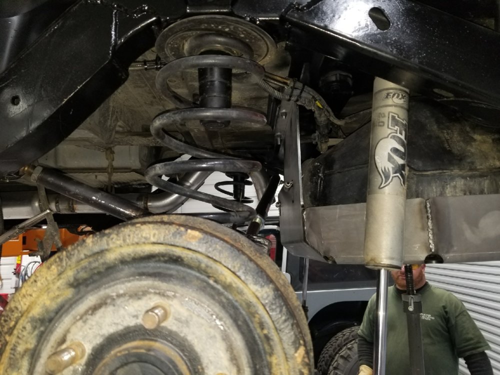

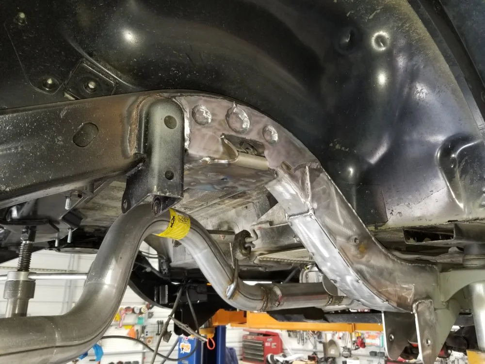

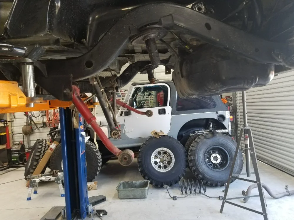

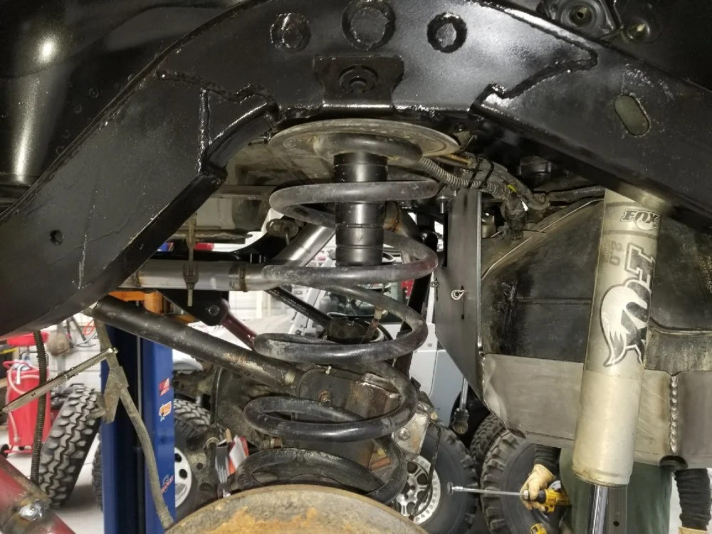

So time for an update. I decided to do a rear coil spring relocation. A couple of buddies of mine did the work. They did a fabulous Job...Now my springs stay in a straight moment as opposed to a constant arc
Reactions: JMT and Chris

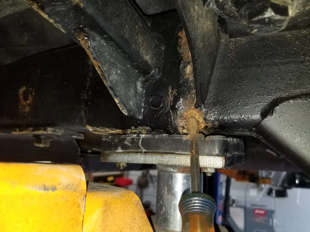

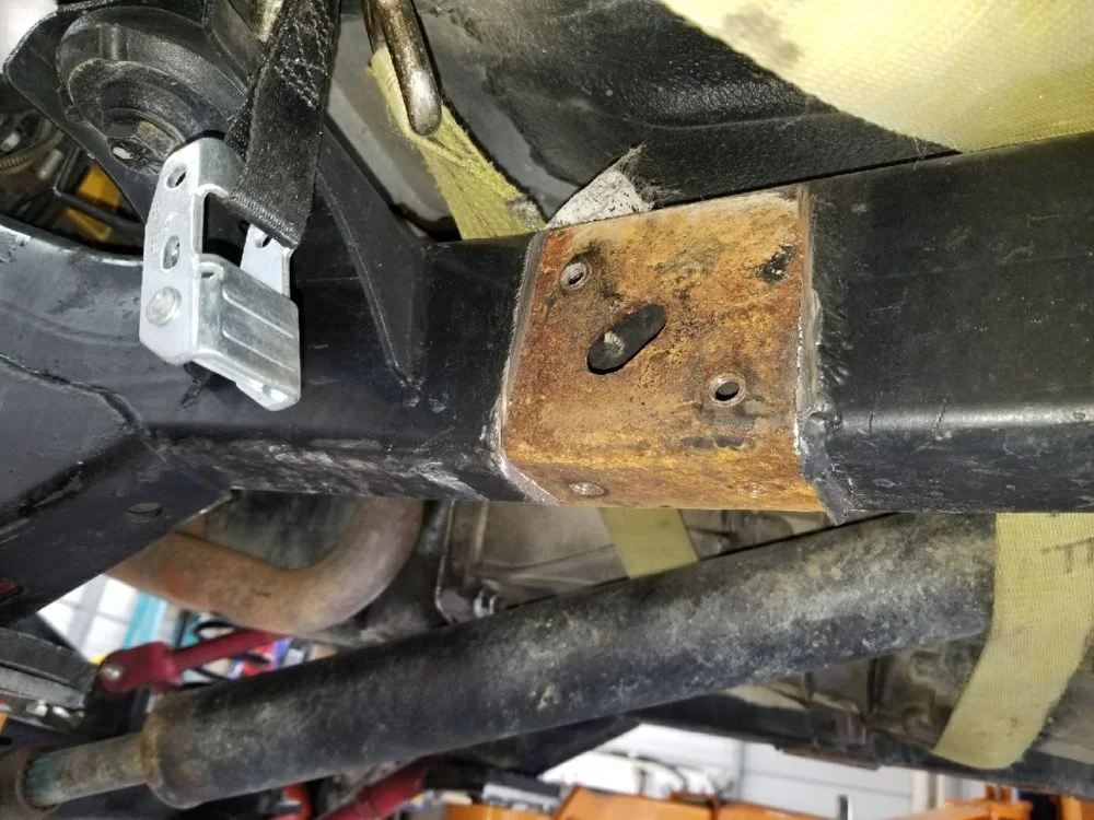

However, while inspecting the underside, something horrible was discovered
That's a screwdriver easily driven up thru the bottom of the frame
Here is the frame behind the slider

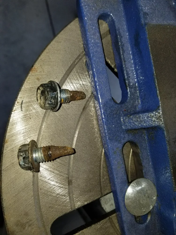

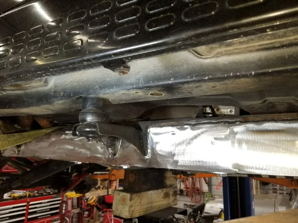

Sliders were bolted on, then taken over to a buddy to weld. These were what were left of the bolts
This is the lower control arm mount on the rear...tearing away from the frame

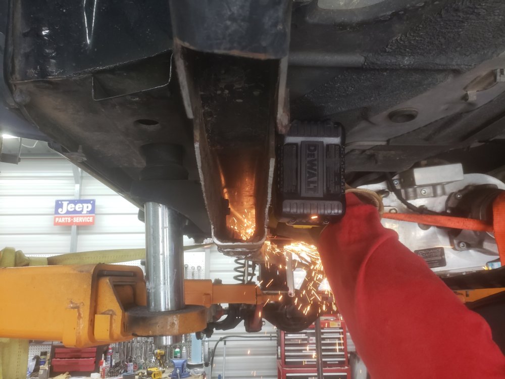

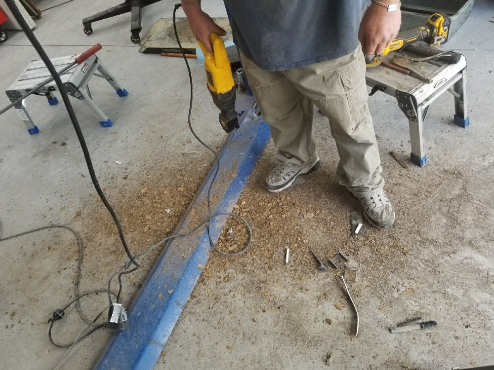

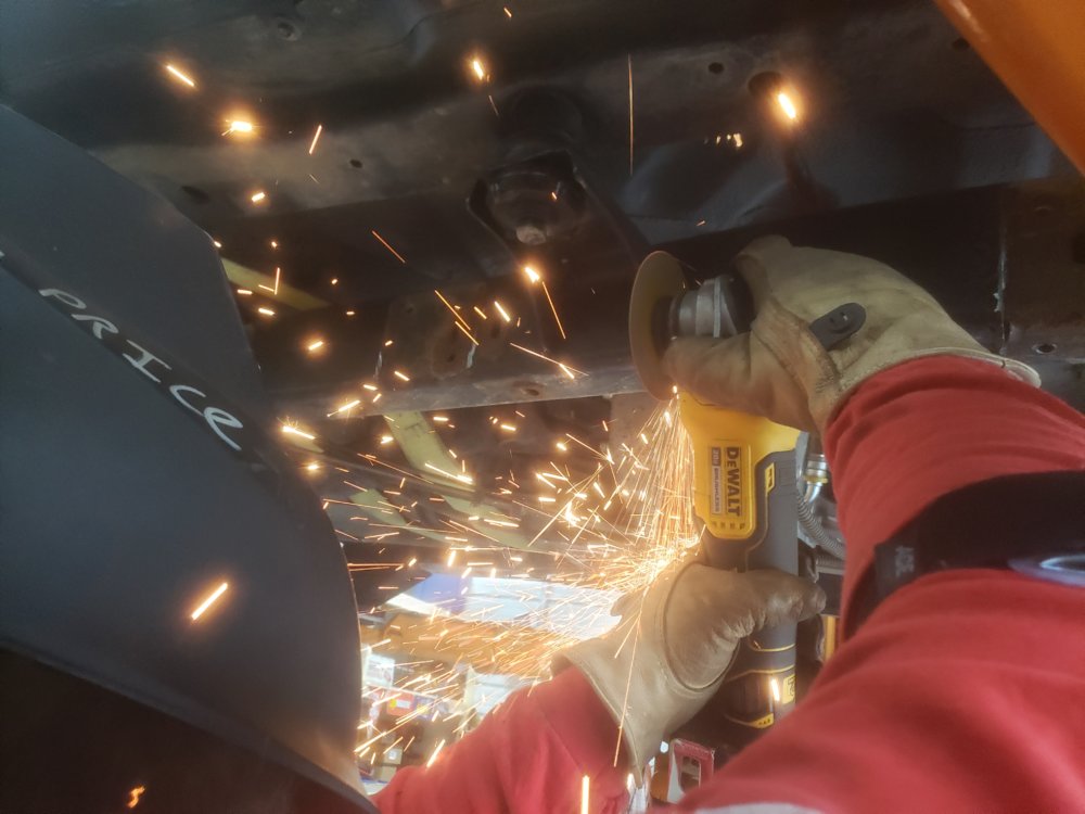

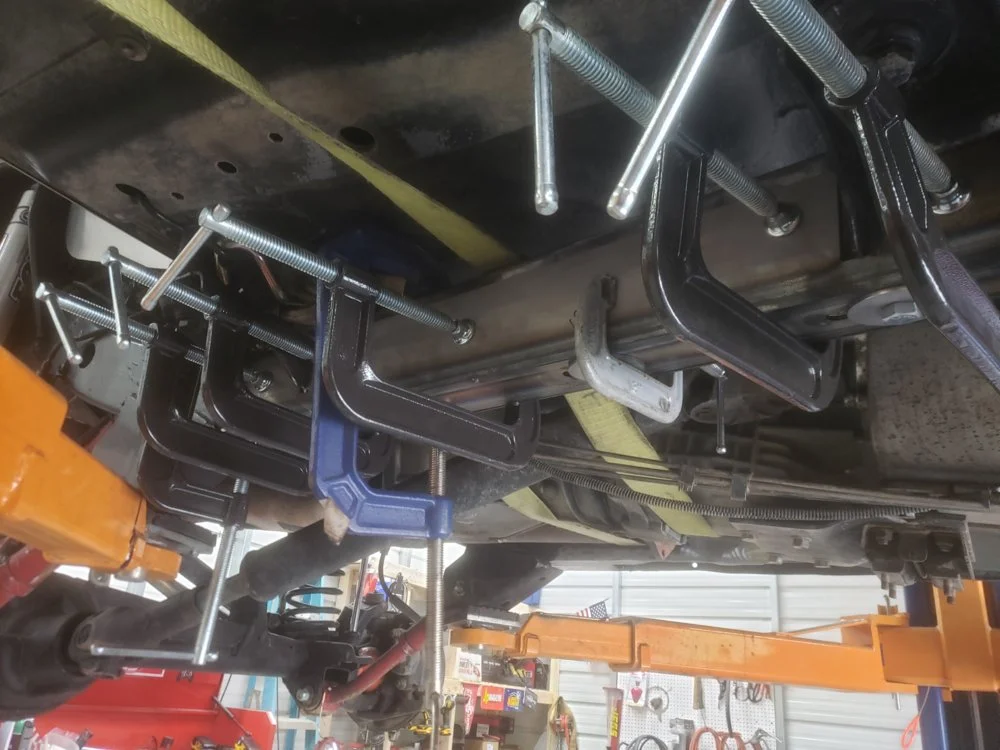

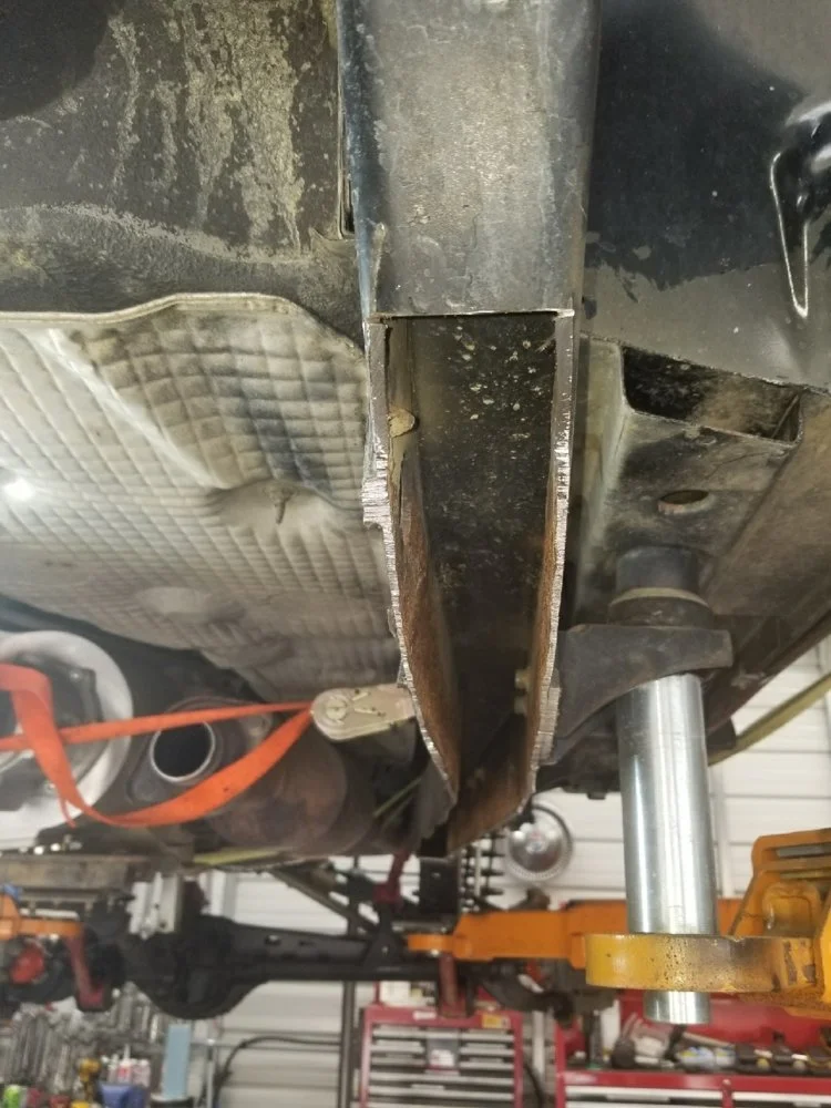

So..we began cutting
And we discovered the secret stash of Nutter Butter waffer bars hidden inside every TJ frame

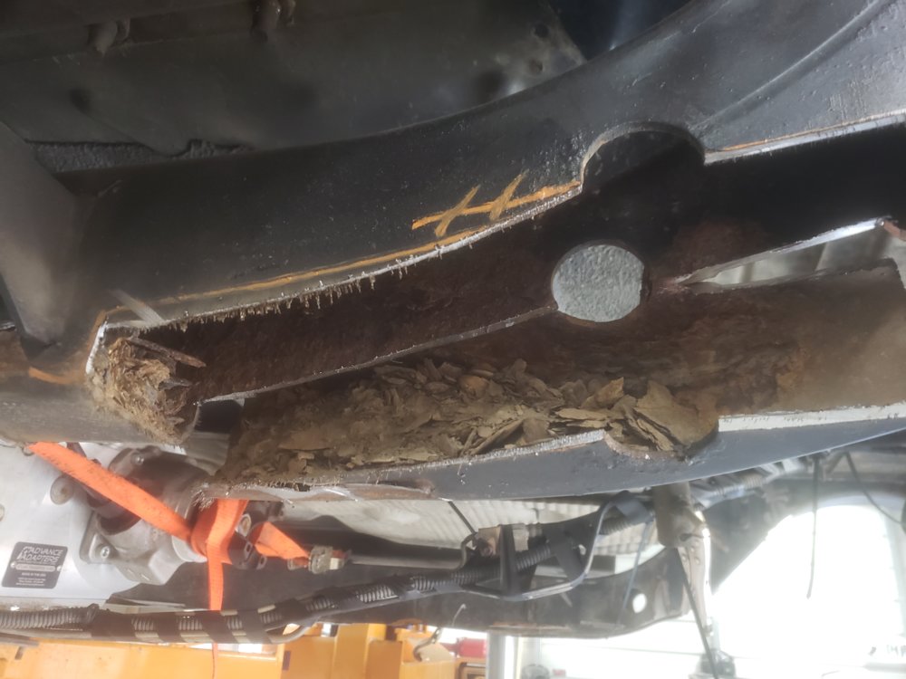

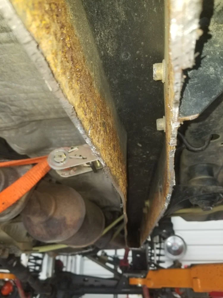

More cutting

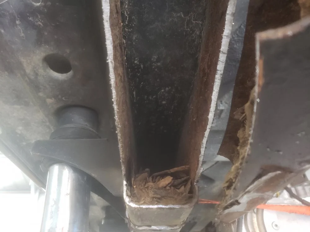

Nutter Butter residue

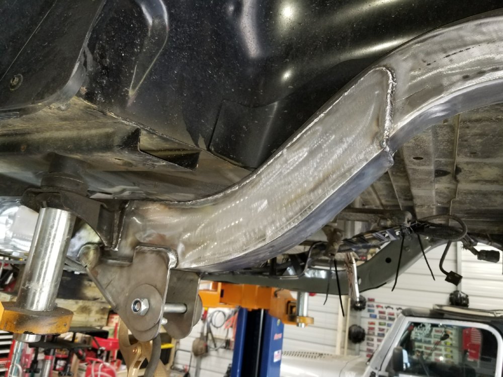

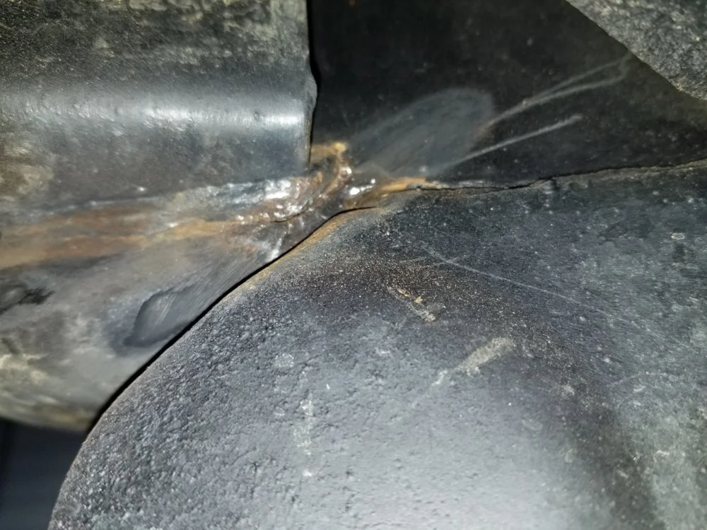

Turns out the entire bottom and 1/3 of the way up the sides of the frame from just behind the fromt lower control arm mounts, all the way PAST the rear control arm mounts was trash. All because of no drain from the factory. In face the transfer case skid bolts came out almost by hand as the threads on the inside of the frame were gone
Below you actually see the waterline where there was zero drainage. This is where water sat until it evaporated.

Frame swap would involve hundreds of hours of labor. Which...I can handle. What I CAN'T handle is buying another TJ frame only to find the same issue. And a new frame is over $4k

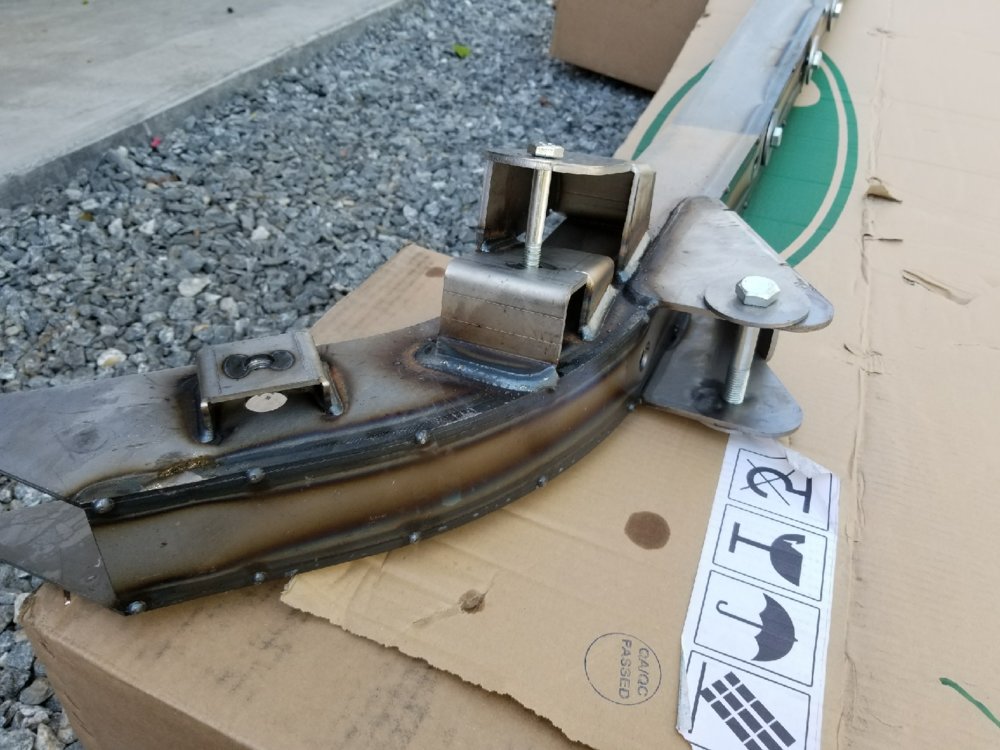

So what are my options?

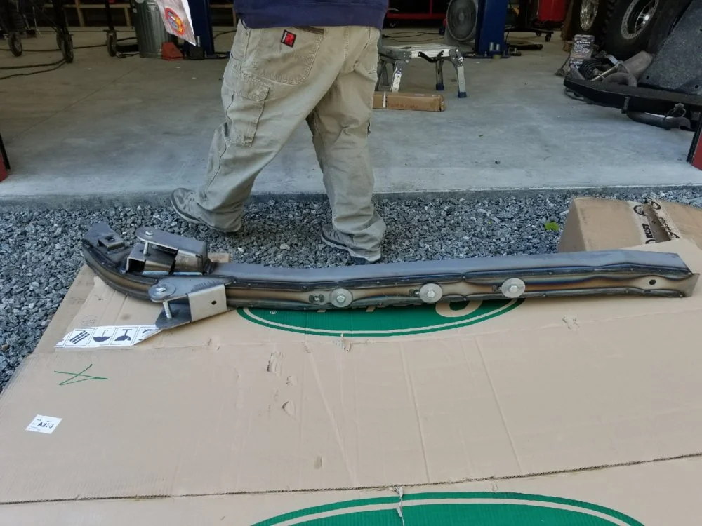

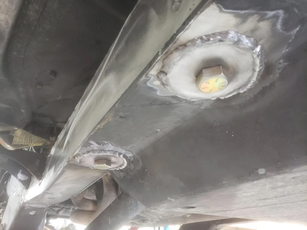

Well, Rust buster make all kinds of solutions for TJ's

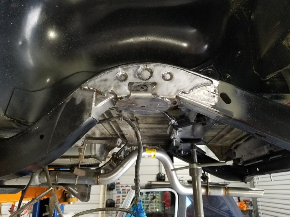

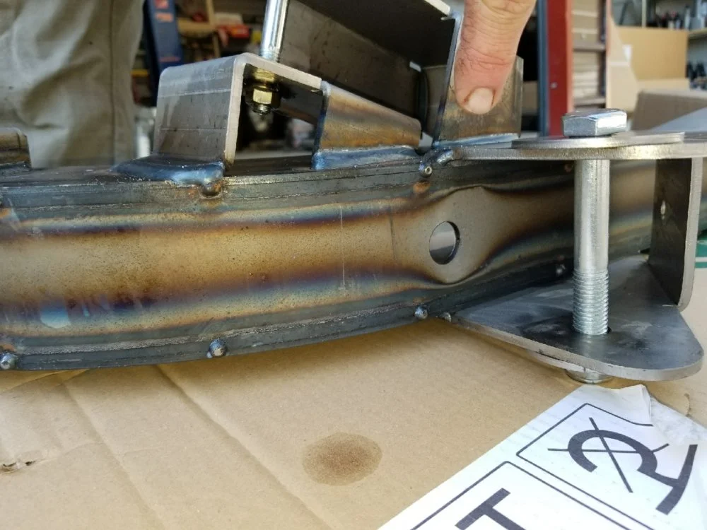

These bad boys come with integrated upper and lower mounts that far exceed the factory
And they come with the drain holes drilled in the proper place
BTW....this is where you go and take a flathead to the bottom of your frame!!!
If you got no penetration, then jack it up, remove the lower control arms at the frame and drill a finger size hole directly above the socket of the lower control arm

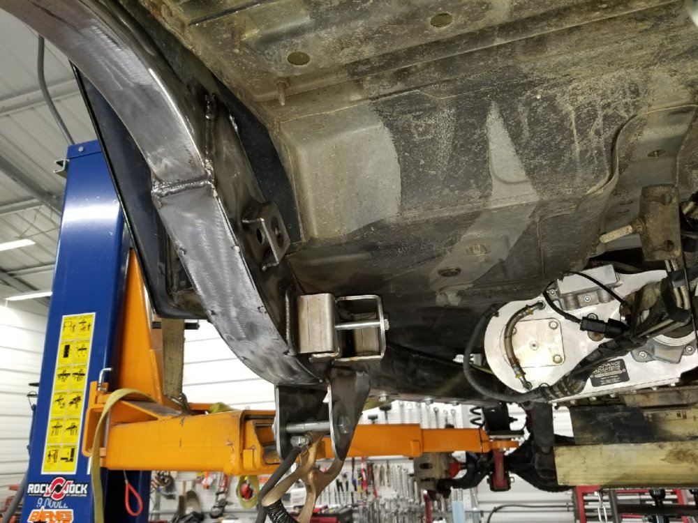

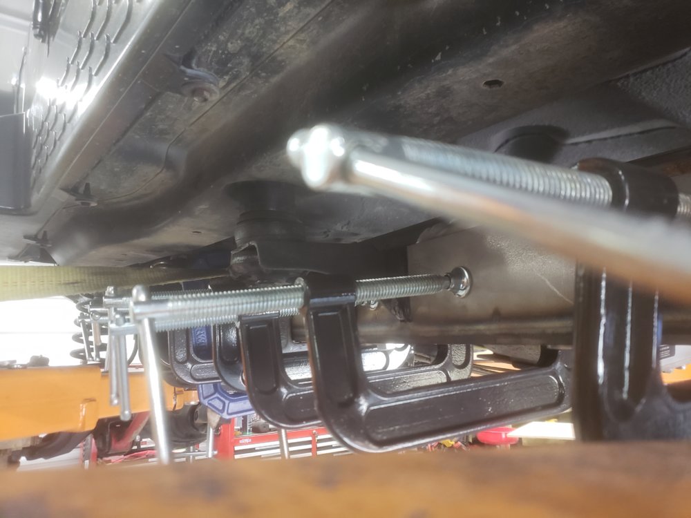

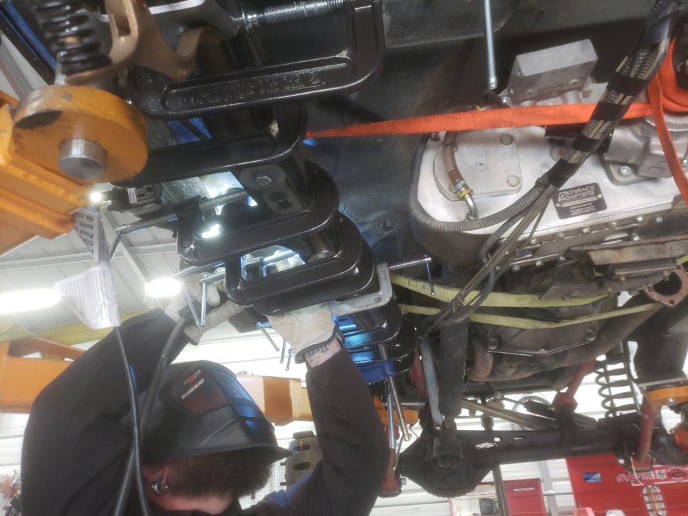

Time to get these monsters mocked up
Starting the agonizingly long task of welding
Improved areola's...err I mean skid mounts
All painted

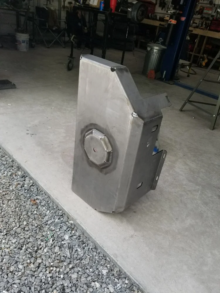

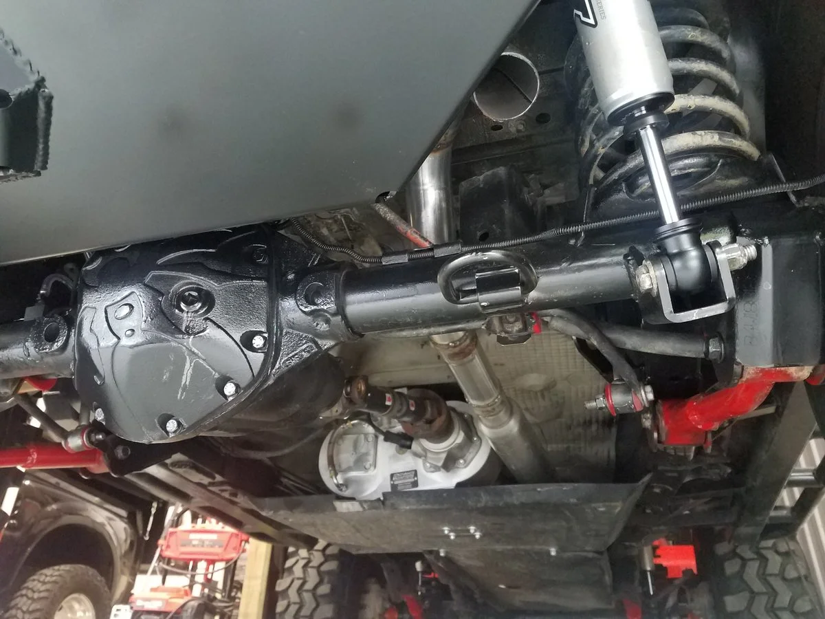

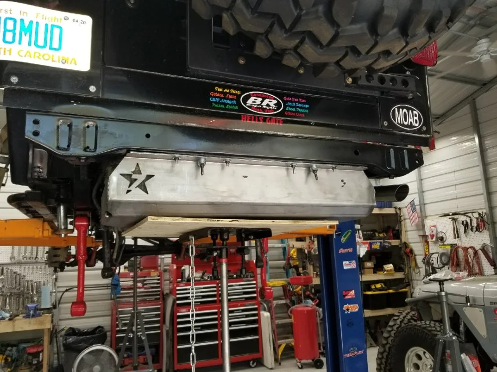

Now..time to add the barns gas tank skid
All mocked up for clearances

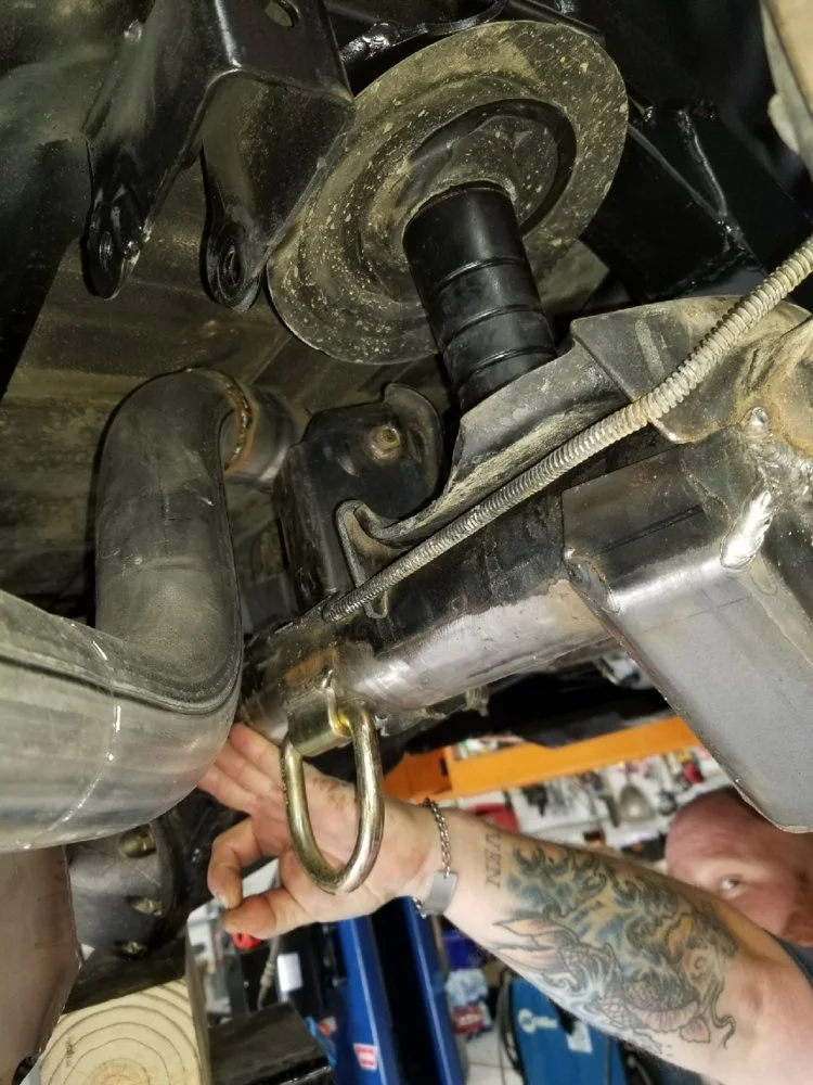

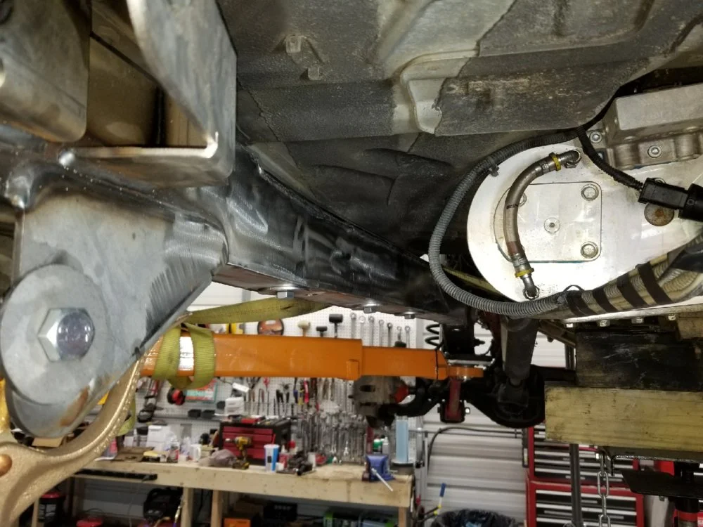

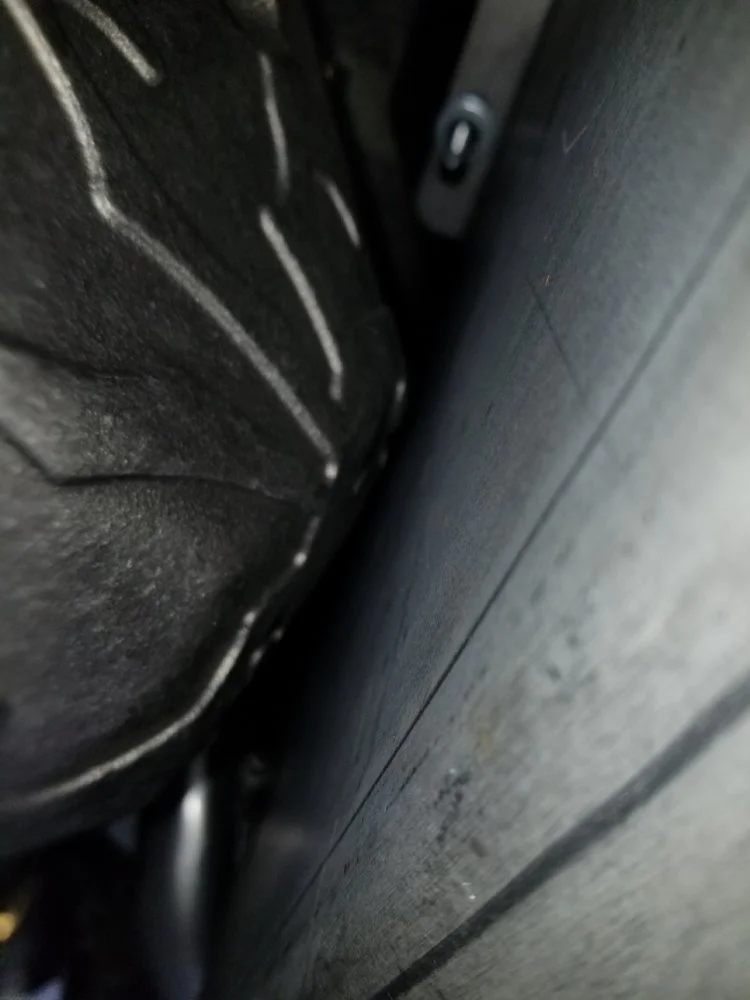

Dang...she tight

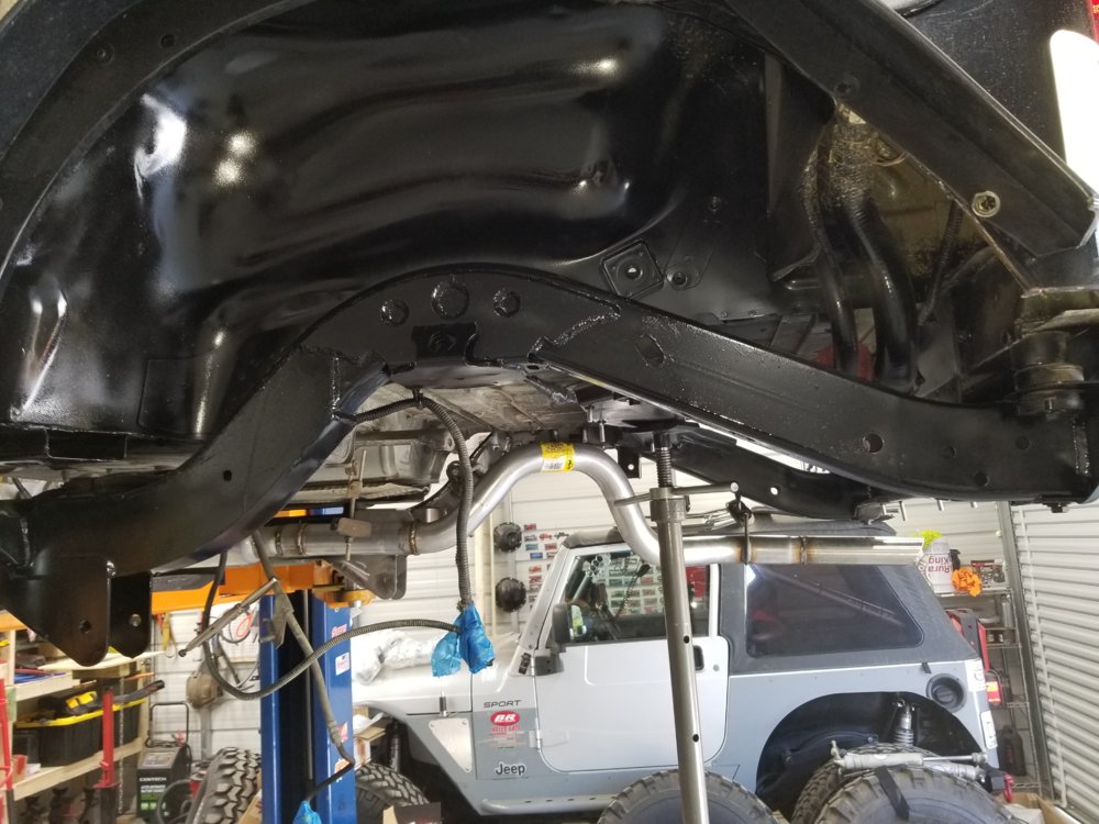

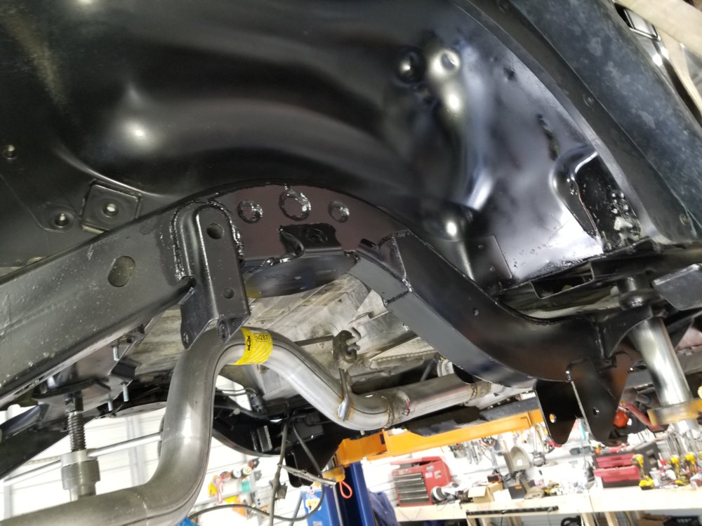

This was AFTER swapping to a poison spyder cover, because the solid was hitting at full press. Decided to tighten down the control arms and give myself more room

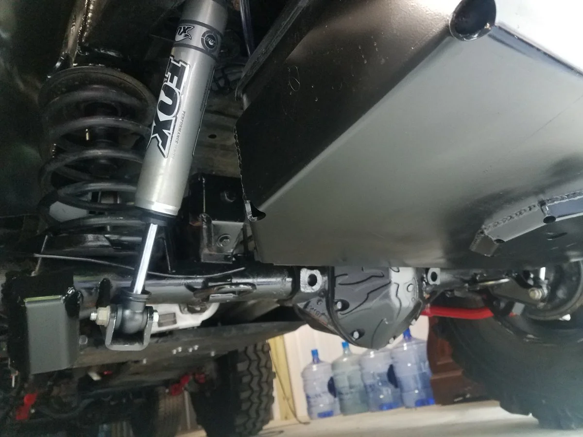

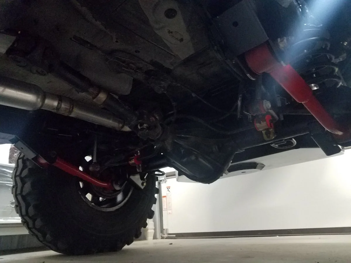

While under there we discovered the stock exhaust was seconds from becoming powder as well. More decisions were made...but the flowmaster wouldn't fit beside the fat ass atlas, and we're not tubing benders....so a glasspack was sourced (sounds like ass.....well...not really, just sounds like a 60's british roadster ...which is pretty badass, but not on the trail droning for hours)
But..it clears everything
All painted and on the ground
