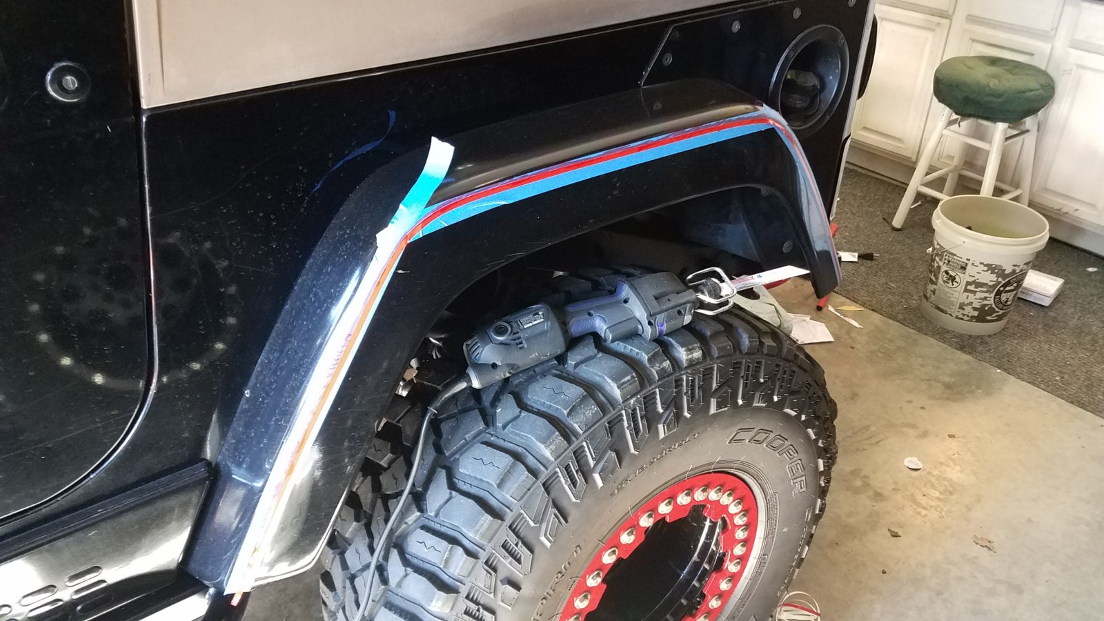

4" front and still the stock rear painted flare, just stretched 3" further back at the very bottom rear
So you cut the tub behind the rear tire and just relocated the stock flare, cut the stock flares to match more with the MC? Looks good
Yes. I unbolted the rear flare. Starting from the very rear, forward. Removed all the rear angle fasteners, and then the back 2 fasteners on the top level part, but did NOT remove any of the front angle bolts. Then I cut an elongated diamond shape out of the steel in that back angle.
What I did, was remove the rear springs and cycle the suspension to the bump stops. I saw the TSL's would dig into that rear angle X amount, then I trimmed and recycled the suspension until the bumpstop was sitting on the spring bowl without the insert to where I had at LEAST an inch of clearance.

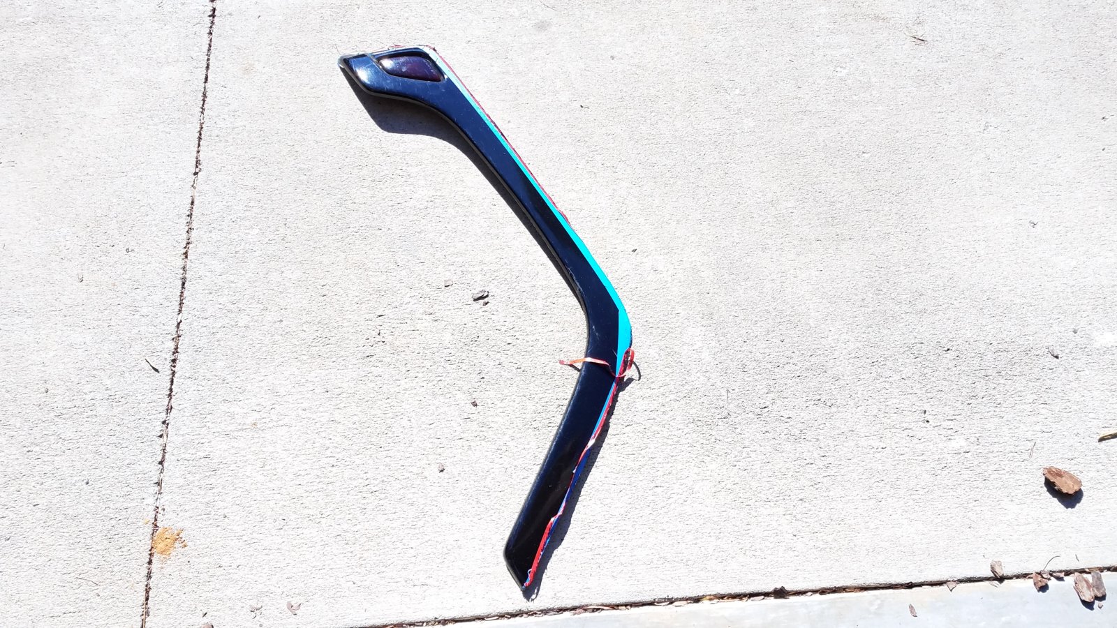

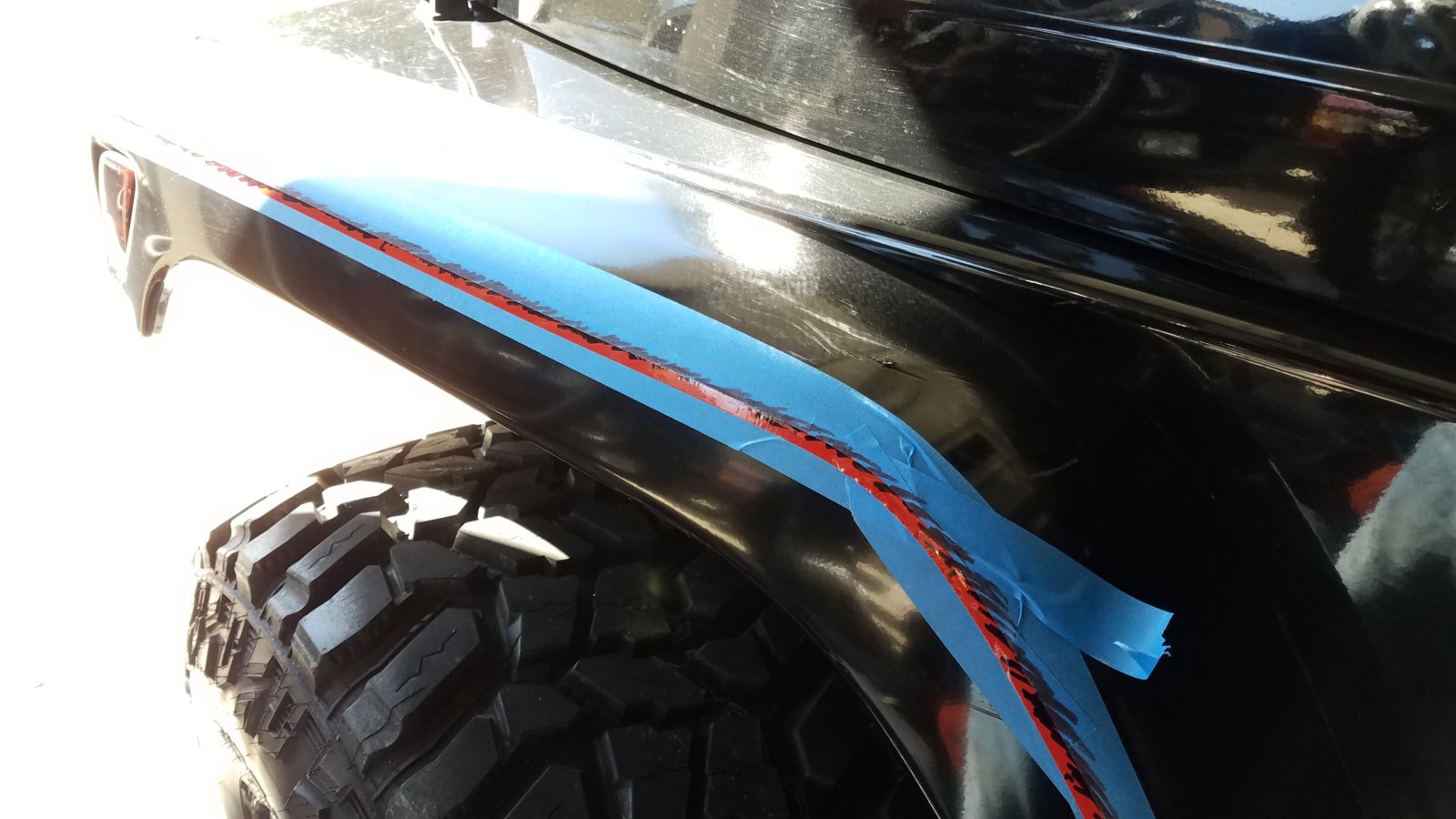

Just the very back angled piece. See here is where it got tricky. I had already trimmed the stock flares. Did that to clear the 35's
so at this point I bolt back the upper level portion of flare, and then pull the very bottom/back over the cut metal and mark NEW mounting holes. I think it moved that back bottom corner about 3" more rearward. Drill a new hole and bolt the bottom corner, then drill the 2 middle, and voila! It's a new angle, and you would NEVER know unless you had seen this post.
View attachment 56068 View attachment 56072 View attachment 56073
Ok, thanks, that was very well explained. I hate to keep asking questions, but with 2" SL and a 1.25" BL, there are questions. Last one I can think of is this, so, when you made the diamond cut on the rear of the tub to clear the TSL's, about 3" further back at the base of the tub, I'm assuming there is some tension on the flare when you stretch the rear of it back to make new mounting holes. Put another way, the flare is hard but flexible, it has a shape, you had to distort that shape to get it into the new configuration, right? Maybe already having trimmed the flares, the tension was less and easier to get the new angle. I think I get it. It looks good, Like you said, you'd never know. I didn't know what the rear flares were, I assumed MC, but I was skeptical.
Exactly. I had smacked the original flares on trees and rocks enough to where the paint was cracking in the corners when I trimmed them. Once I cut them the way I did, it revealed a LOT of the tension that was there and allowed them to fold and flex and return to their natural state. They were under a lot of tension when I bent them back, but I know since they've been contorted it's been super hot and the heat/sun have helped release a lot of that tension. Had I done that in winter a heat gun would have been a must

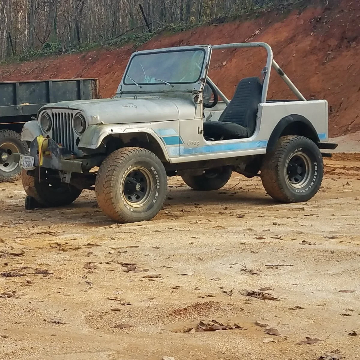

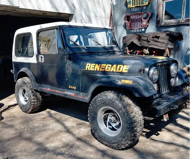

Also picked up a 84 CJ with an immaculate tub that I planned to make a great restoration.
But a buddy called and offered up one of his CJ's. Was willing to build me a 360 with a 4 speed, and gear a pair of axles to my desire for a SONG. Only problem was it had a pretty rusted tub. So now 2 will become 1

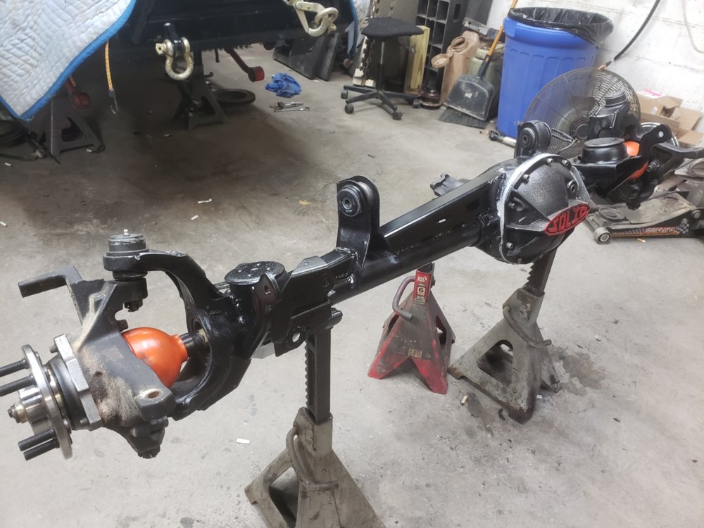

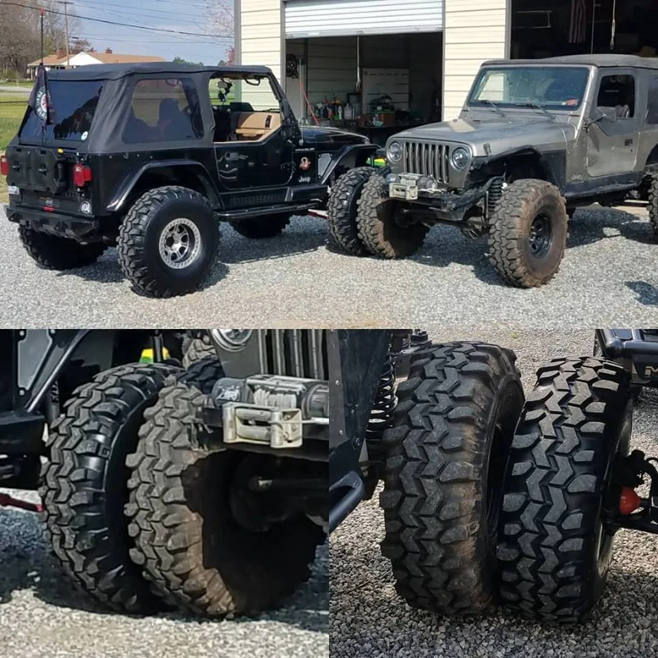

I went to my buddy Chris' house one evening and parked my 36's next to his 38's to compare sizes, and noticed something

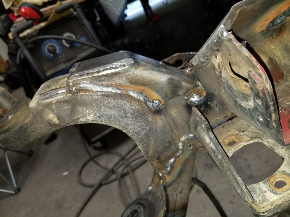

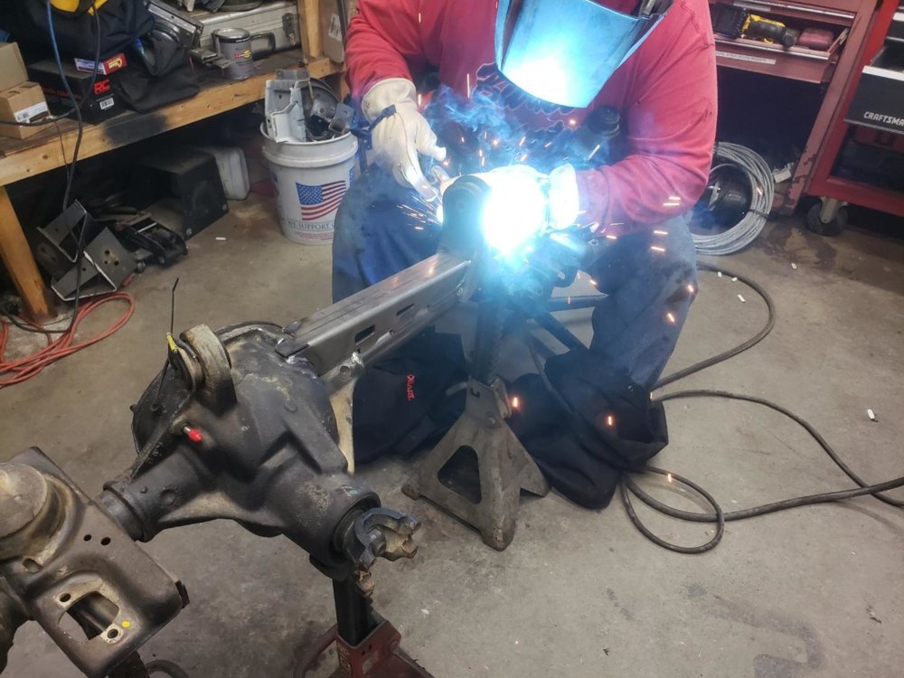

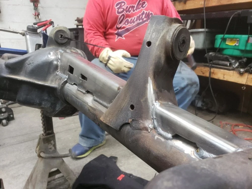

I had a "gangsta lean" going on pretty bad. I first thought my axle tube was bent...so I had a retired marine buddy tear it out and look it over. While he had it out I ordered some gussets and braces that he added.

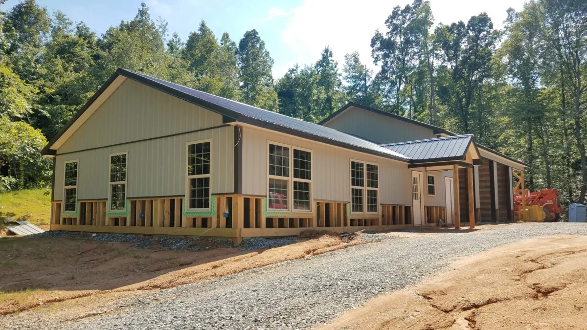

I'm going in reverse. I bought 8 acres about a mile from my house. Building the garage with a 2 bedroom apartment on that land. Once finished we will move into that (my youngest just graduated HS so we're empty nesters) and sell our current home, and begin building the house on the FRONT of the property. Then the apartment will be for our aging parents, and eventually a guest house/man cave for when I spend too long in the garage with too many dog beers and need to crash, not being able to walk the 900 ft to the house :ROFLMAO:
