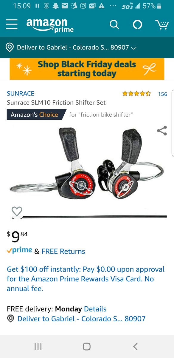

Aren't they adjustable through the screw on the side to determine whether you want to engage the reference points or whether you want it to just return after you let it go, or does that just hold it through tension?
In the bicycle world, the rear shifter is indexed and matches the gear cluster. The front is not indexed, only friction, to allow fine adjustments to a front shift fork so it doesn't rub the chain as you move through the rear gear cluster.
For a hand throttle, you want a friction shifter.
Also, the adjustment screw on the side of the friction shifter of to adjust how stiff the lever action is.
